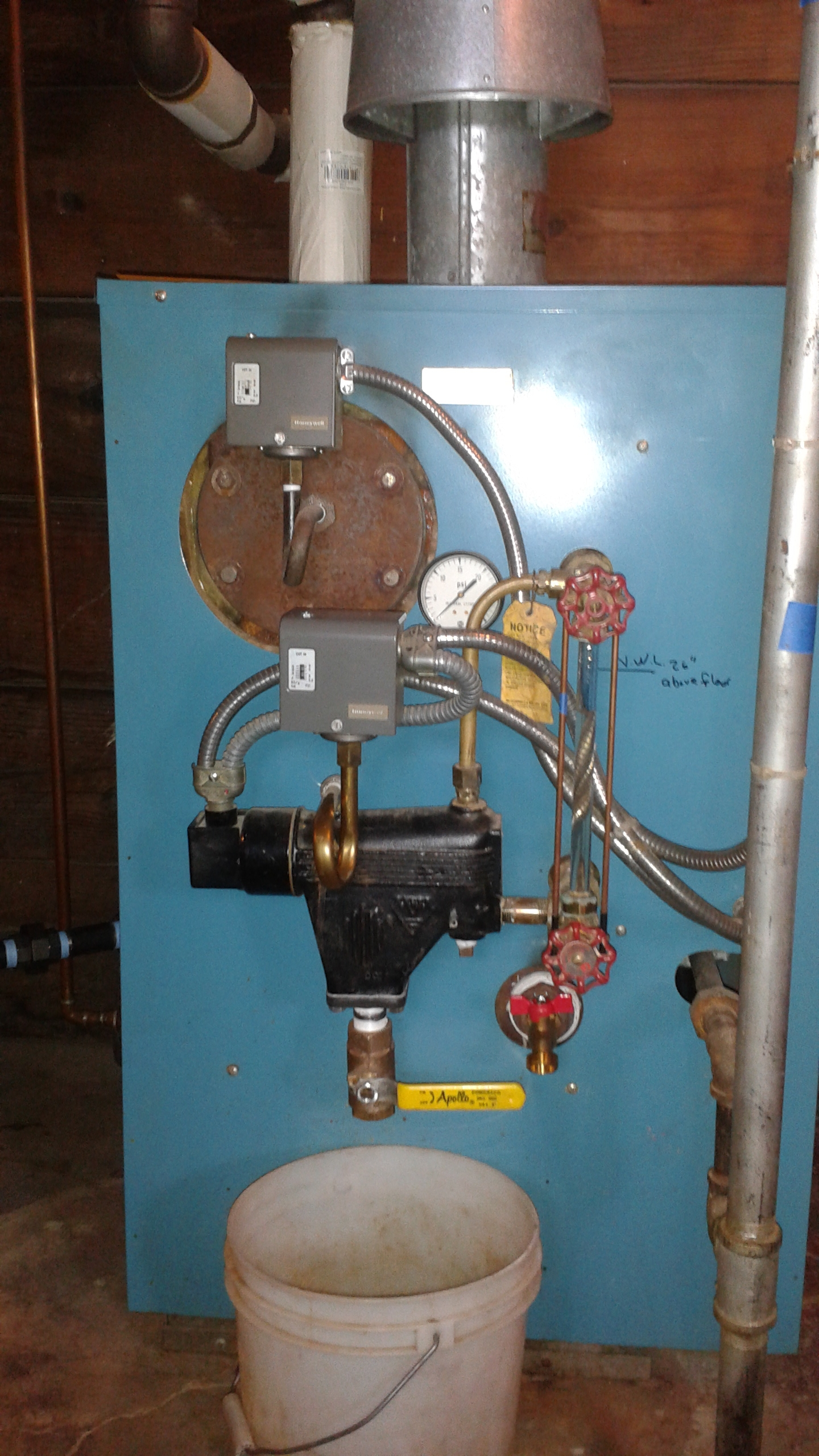

    Here is a picture of one of my 40+ year old Burnham boilers (taken some years ago) with the two pressuretrols in their original configuration. The upper one is for the total shutdown.

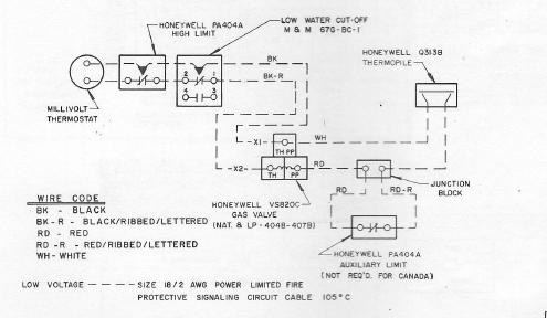

    @EBEBRATT-Ed , if this diagram (or the attached pdf) is legible, you'll see the second pressuretrol ("auxiliary limit") wired between the powerpile and gas valve. If that trips, it shuts off both the gas flow to the burners and the pilot. That shuts down the boiler, and it won't run again until the pilot is relit even if the pressure returns to atmospheric.

    Thanks never seen that done.

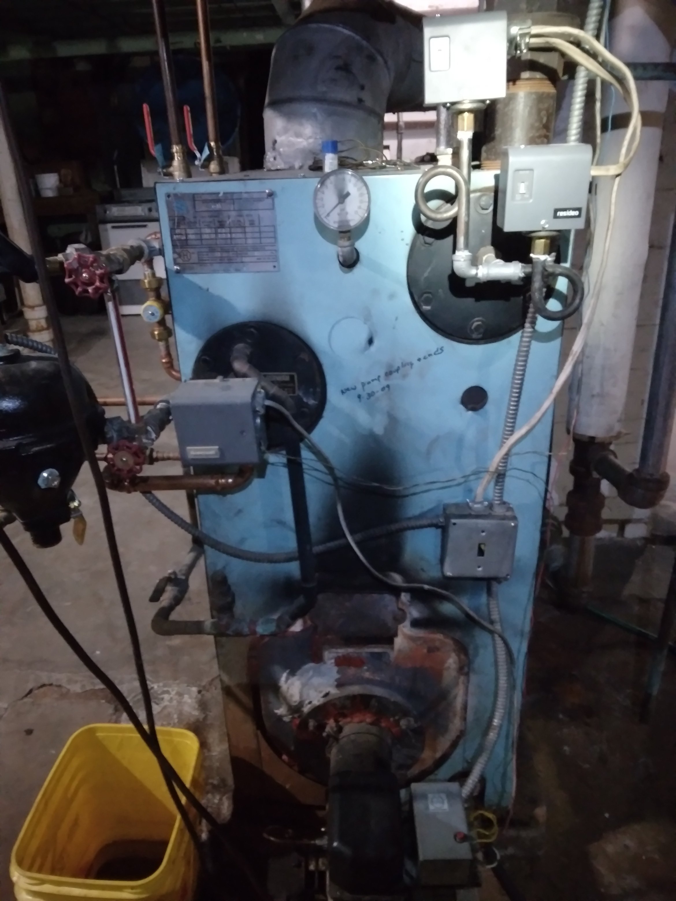

    This is my V35 Burnham boiler with the two pressuretrols highlighted. Because the controls are set at the same cut in and cut out pressures, I won't be able to determine if one of the controls fails. The burner was coming on at 0.5 psi and cutting out at just before 2 psi. The differential for both is set at 1. If one of the two controls is a safety shouldn't it have a different cut out pressure ?

    So would I set up my control pressuretrol cut in @ 0.5 and cut out @ 1.5 psi (using 1 as differential even though my gauge is reading close to 2 psi in operation) ? And my safety pressuretrol cut in @ 2 psi and cut out @ 3 psi (using 1 as the differential ) ?

    The safety pressuretrol needs to be a manual-reset type. It will only trip when something is wrong, like the operating control has failed closed. If it's automatic reset, you'll just switch over to using it as an operating control.
