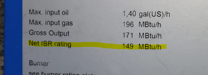

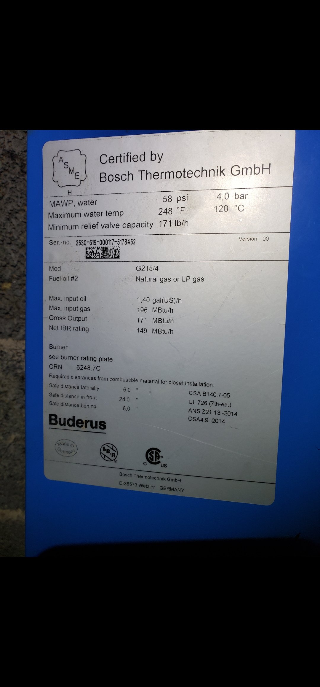

I have a buderus g215 4 section installed
The G215/4 has a net BTU rating of 149,000. That's 49.6 BTU per square foot. Almost double what @Alan (California Radiant) Forbesquoted. Are you near the coast or high elevation? Very poor insulation? That's a lot of BTU's.
1 -
No we are right in Springfield ma, I wouldnt say poor insulation. 1 room does have poor insulation (cinderblock with r6 foamboard).
Im under the impression it's 171 btu?
Where are you getting 140?
