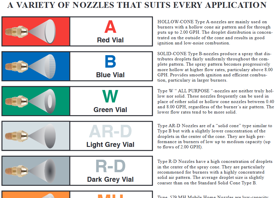

    Delevan nozzles:
    "A" is a hollow spray nozzle
    "B" is a solid spray nozzle
    "W" is a semi solid spray which is a mix of hollow and solid and is considered the "all purpose nozzle"

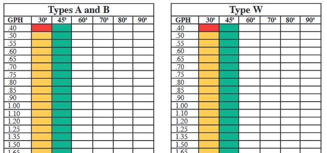

  • Can you take a picture of this 85 degree nozzle? Never seen one, only 80's & 90's
    109A_5 Posts: 4,759
    https://www.sidharvey.com/documents/30609-7.pdf
