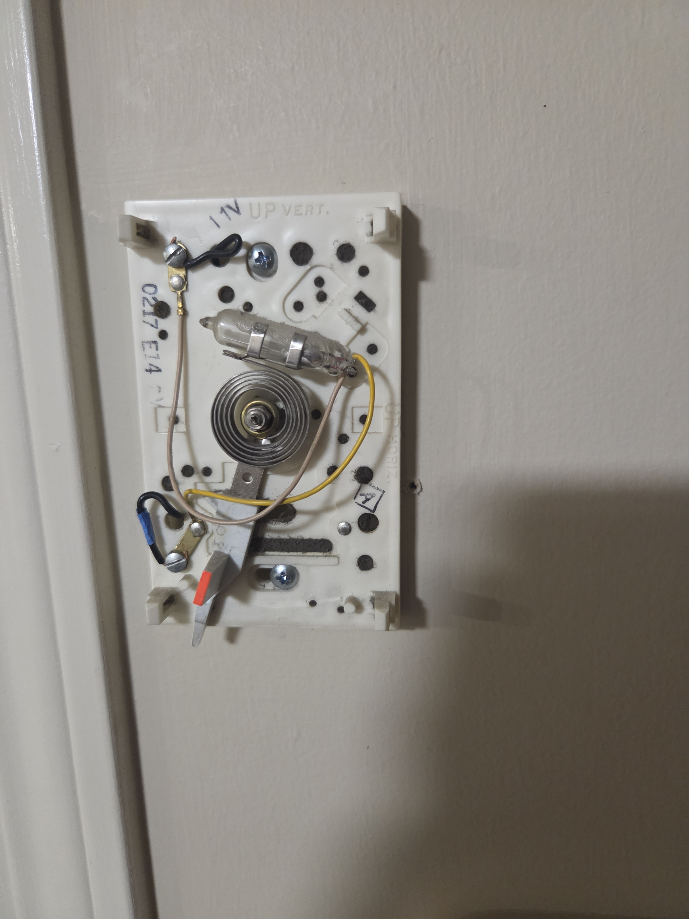

Boiler. Hot water baseboard. Zone valve fails open (the moment I disconnect the wires on the old system it goes full heat). Two black wires.
I tried Rthb20c Honeywell. Two calls to Honeywell and it was still full heat.
Here is the old one. I put the painters tape on the one wire when I was troubleshooting.
It sounds like you have “normally open” zone valve which means they have to be powered shut. That’s the reverse of most.
Any thermostat that has cooling terminals available (R and Y) should work.

You can figure this out by disconnecting the wires from the thermostat. Leave them apart. If the valve goes closed you need a heating thermostat. The wires would go to r or RH and W
If the valve goes open you need a cooling thermostat and would hook the wires to R or Rc and Y
And in either case, a digital thermostat will need to be battery powered.

R+Y
Switch the thermostat to cool.
Works perfect
