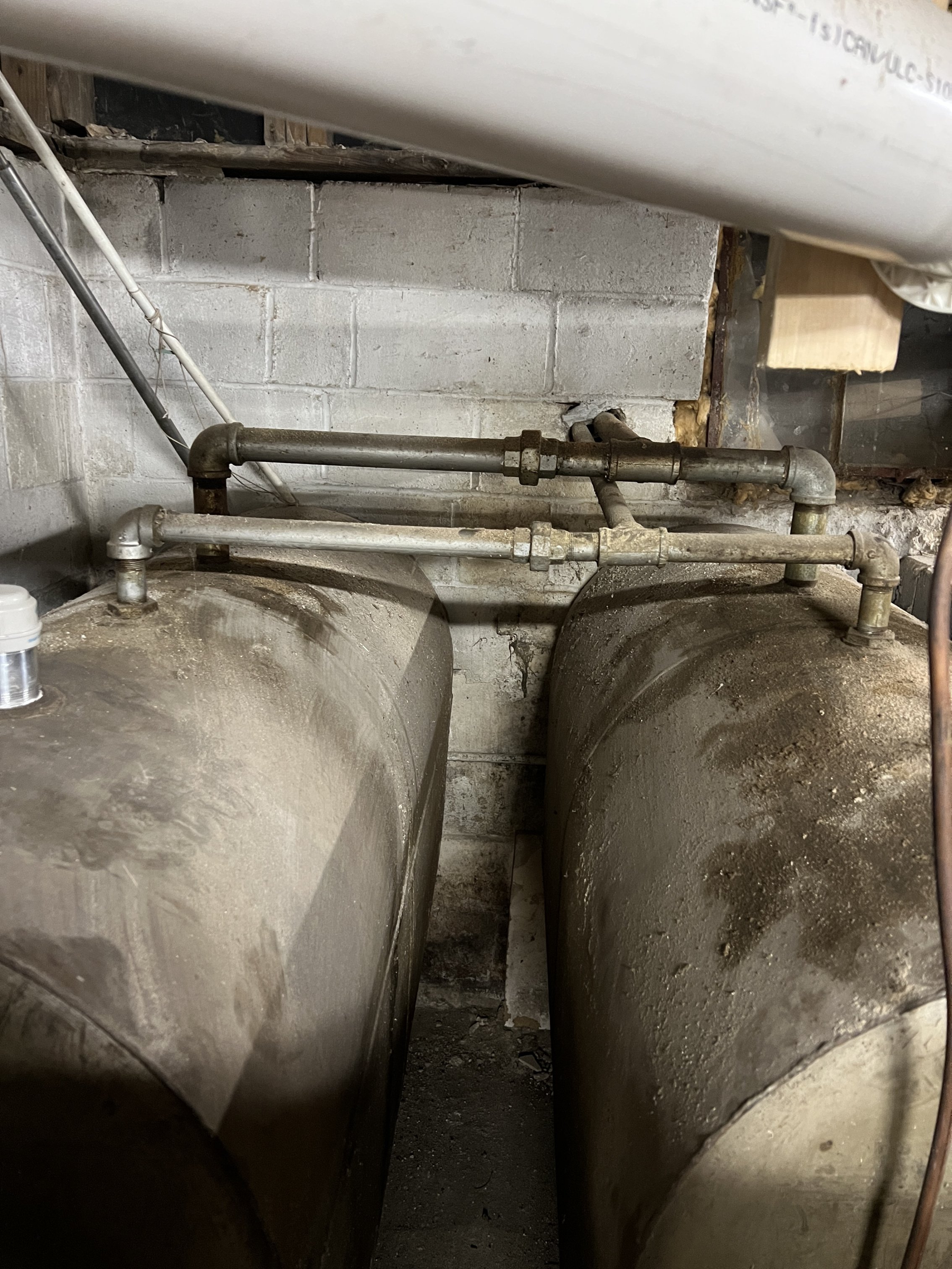

    Potentially very dangerous. Don’t press your luck.
    The possibility of overfilling one tank or the other is pretty height as time goes by. The easiest repair is to separate the fill pipes and keep the vents ganged together, if both vent alarms are working.
    Actually I don’t even see vent alarms, so it appears they will need to be added.
    Virtually ever oil companies insurance policies deny any spill claim where no working vent alarm is present.

    Those tanks are piped illegally. They always were illegal. That was never an approved way to pipe two tanks.
    Ok what is wrong:
    1. No vent alarm whistles on either tank
    2. You can use 1 vent for two tanks but not piped like that. The 2 vents are not hooked together properly. and the vent pipes need pitch
    3. The fill pipes are all wrong. You either need a separate fill to each tank (the best way) or you run the fill to one tank and pipe a separate crossover pipe which must be 2" The fill pipes also need pitch
    4. Since you have to repipe it anyhow the fill and vent have to be the same size.
    5. You can use 1 1/4 or 1 1/2 or 2" pipe but everything has to be the same size. A cross over if used must be 2"
    Since those tanks are obviously very old I would replace them at the same time.
    This is not the oil company's fault. They have insurance and are libel for a spill, but the HO is libel for a spill if the tank fails
    There is a chance your old float is blocking the vent

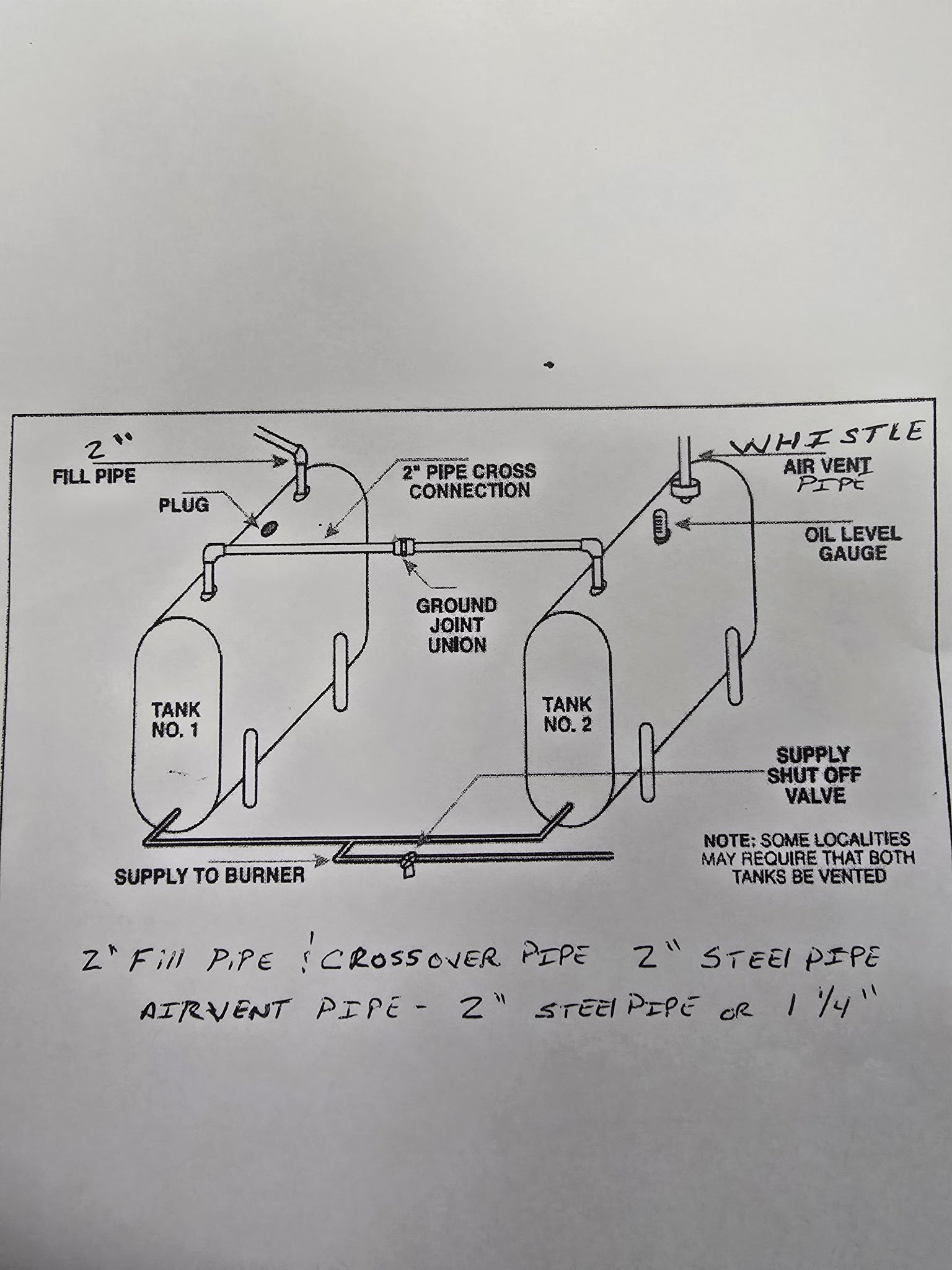

    @gg1
    The drawing he gave you he is correct that the crossover pipe has to be 2" Pipe.
    But the fill and the vent have to be the same size. They can be 1 1/4, 1 1/2 or 2" but they both have to be the same size.
    Tell him to look at the NFPA code #31 section 8.9 for cross connected tanks.

  • I would not do what is suggested here.  For the first part, those two tanks are basement obround type 275 gallon oil tanks.  Many codes have a maximum indoor fuel storage capacity of 660 gallons.   You need to check with the AHJ in your area for that info.   There are other inaccurate statements also.

    Those tanks were never piped right but it worked somehow I suspect the missing float is in the vent pipe and there is no whistle.
    Around here we are allowed (4) 275s or 1100 gallons indoors. I think NFPA allows this as well.

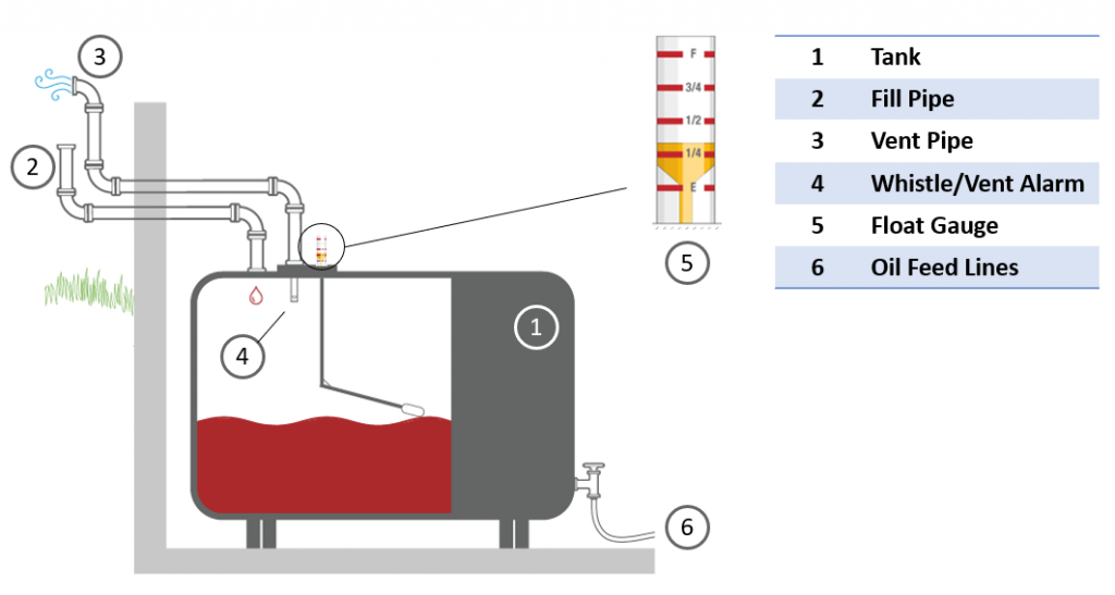

    It is safer to have a separate fill pipe, vent pipe, whistle and gauge for each tank to prevent a possible rupture of the fuel tank being filled first.
    Having one gauge in each tank provides you with an accurate oil level reading at all times and tell you if the one of the bottom draw pipes may have a blockage from sludge in the bottom of the tank and bacterial.
    The reason the fuel truck driver could not continue filling your tanks is because of the back pressure creating enough resistance to close the tank filling nozzles check valve.
    I am not trying to bore you with more information but I have attached files describing how an oil tank works and the Scully fuel delivery systems for residential heating fuel.

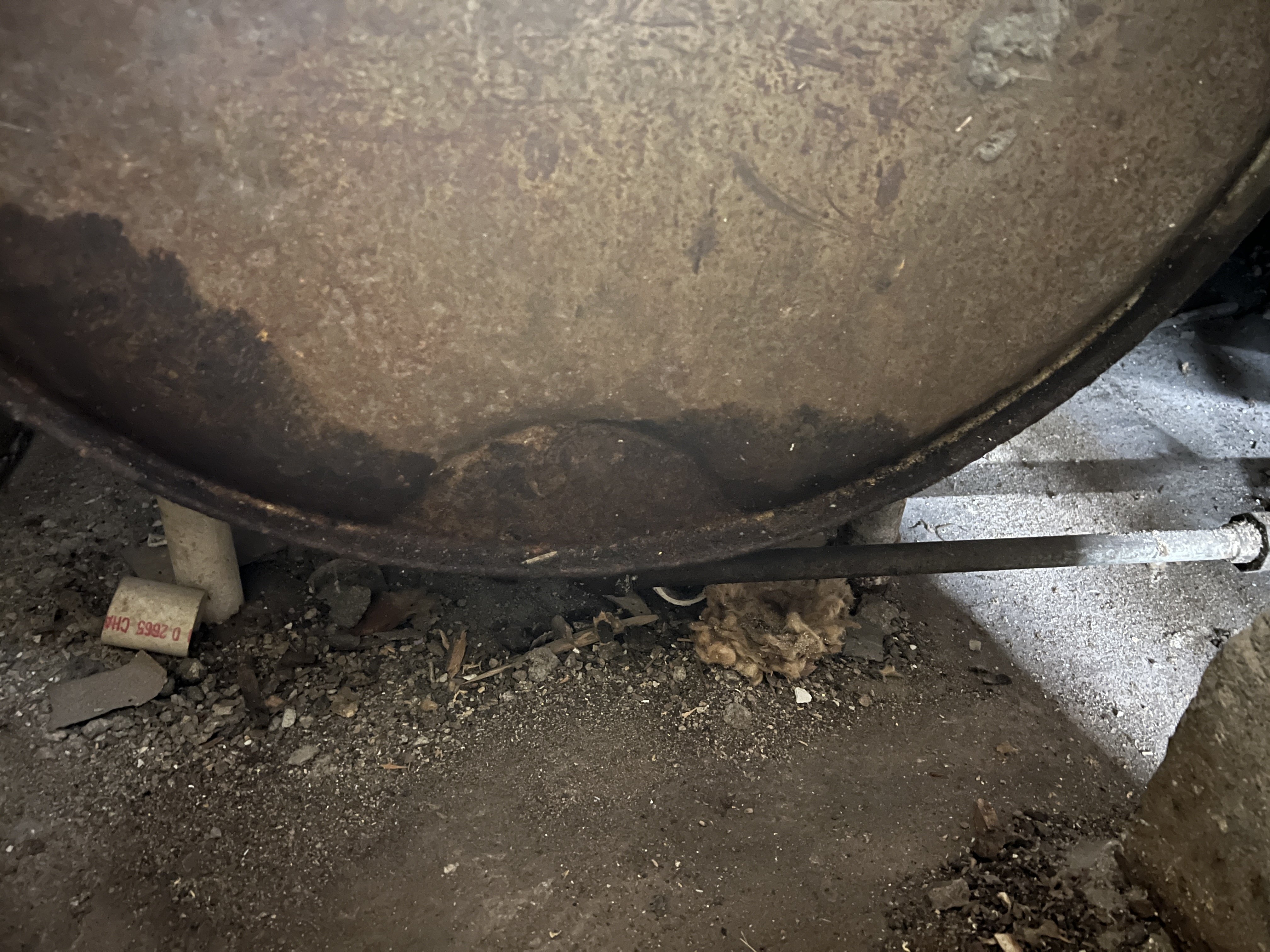

  • leonz
    leonz Posts: 1,994
    Hello and good morning gg1,
    The sludge waste created by the bacteria in your fuel tanks has been consuming the sheet steel in the tanks and that is never good😓.
    Over time the sludge that is created by the bacteria in fuel oil or kerosene in a residential storage tank can cause pinholes to form in the sheet steel the tanks are made of. The pin holes are essentially sealed by the sludge created by the bacteria that grows in a heating oil tank.
    Most all of the double wall tanks designed and welded together for residential heating oil market have double wall ends to protect them to some extent from impact damage, these tanks do not have a secondary envelope shell to protect them unless one is specifically designed for this protection.
    The Roth tanks use a vinyl secondary liner to protect the tank shell from an oil leak.
    The previous owner of your home probably never added a fuel treatment like HEET or Diesel 911 to the fuel in the tanks before they were filled.
    Did the fellow that came to look at your tanks use an ultrasound tester to check the steel thickness of your tanks or did he tap them with a thick welding rod??

    @gg1
    If it was my house I would recipe the tanks with separate fill pipes. You can use 1 vent pipe for 2 tanks. The tanks will still equalize. Put whistles and gauges on both tanks.
    Any plumber can do this. The fill pipes outside need to be 2' away from any window or door. The vent pipe outside needs to end above the fill pipe.
    The fill pipes and vent pipes can all be 1 1/4" pipe or larger but you can't mix sizes. So all 1 1/4. or all 1 1/2 or all 2"
    The fill and vens have to pitch down towards the tank or no worse than level. Any backward pitch is bad
