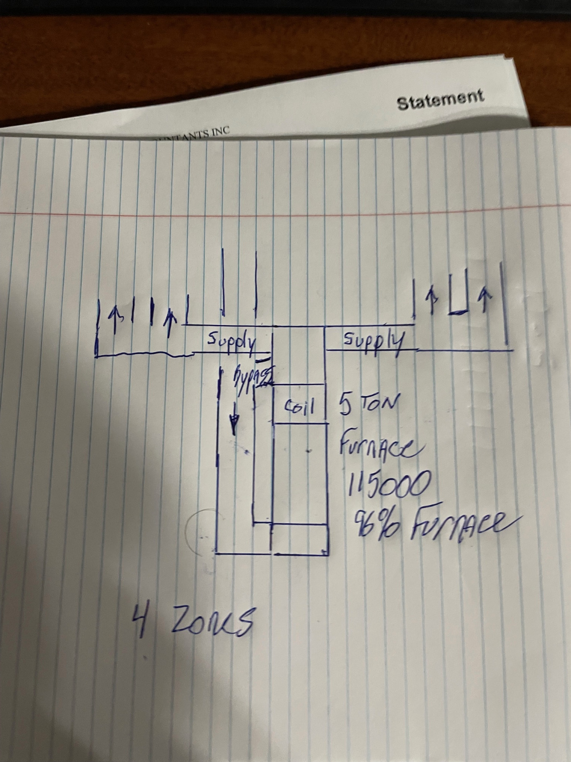

furnace over heating hi return temp
creger.robert
creger.robert Member Posts: 116
furnace return temp over 80 degrees-4 zones blower shuts down any thoughts

    What's the return temp before & after the bypass ties in? That's a pretty big furnace, if just one zone closes you're going to be bypassing more than a bit of hot air. Is it a two-stage unit? Some zone control panels can stage down the unit, or just disable high heat.
    You can also see about adding more minimum air to the zones, so you bypass less, too.

    my return is 83 degrees supply as high as 127-it is a 2 stage furnace with 5 tons of air
    should i try 1st stage only on heat

    that is question zones are running 72 degrees area
    leaking around bypass possibly
    i believe ductwork is undersized 2" of insulation on inside of duct

    There should be a temperature rise listed on the sticker of the furnace. As long as that's not exceeded, the DAT is fine.
    You have to be sucking too much hot (supply) air into the return, that's really the only (sane) way the return temp can get so high. It's just a matter of finding where it's happening. A thermal camera is your friend, but a simple thermometer will work too. Check the air going in to any returns and before & after the bypass
    It sounds to me like one or more of the zones are satisfying and closing down, so the bypass has to open to keep the airflow through the furnace up—which from your drawling seems to feed directly back in to the return. Or, if this is ceiling supplies and returns, it's recirculating.
