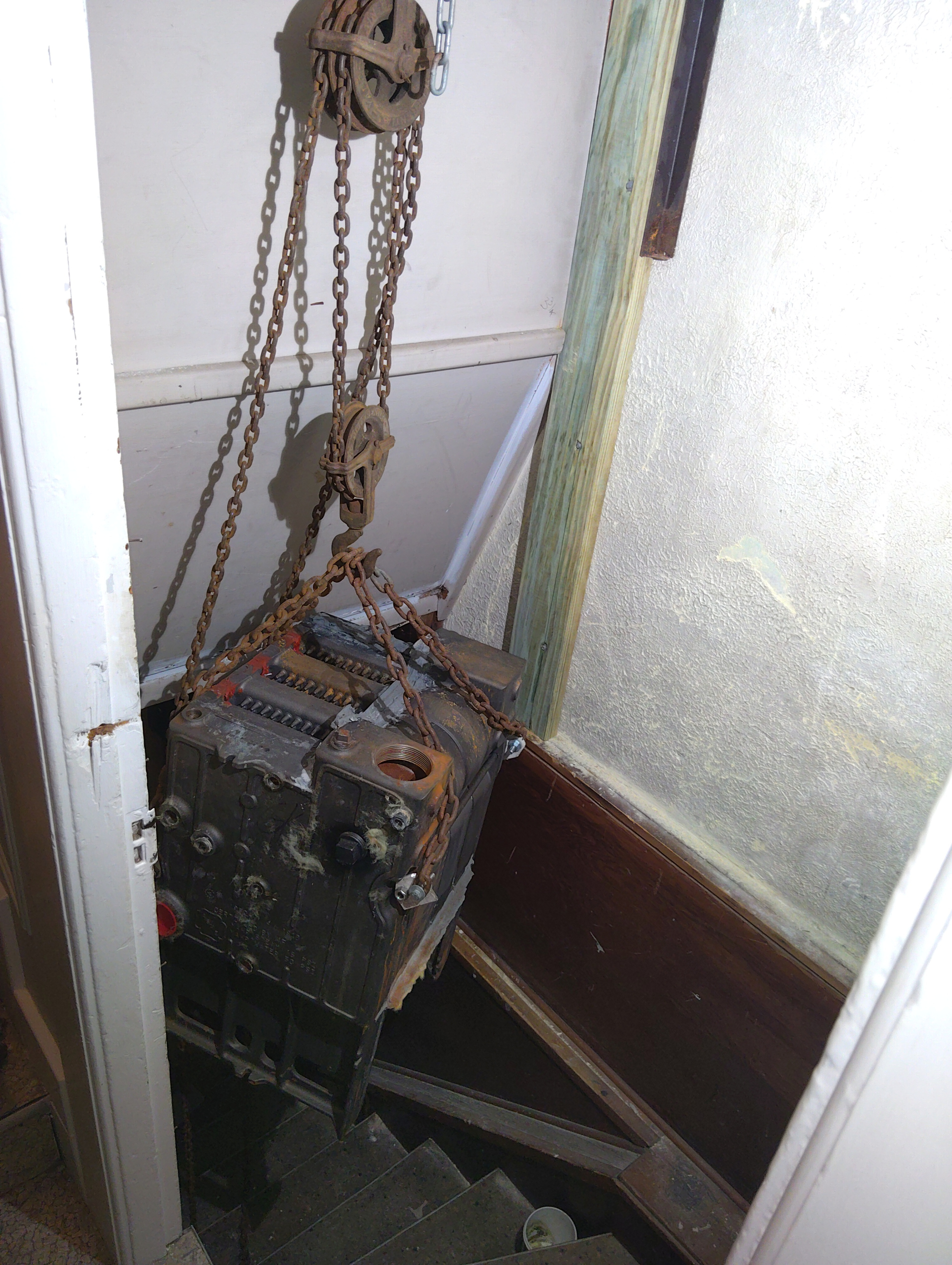

  • @STEAM DOCTOR it had been sitting. it was a scratch and dent. got the casing and firebox bent and dislocated by poor forklift handling in stacking another on top. and it sat until I asked what they had around. no one else wanted to mess with it, but i needed the casing off anyway for placement so a little body work and I saved a grand. I know the second steam tapping has been on again off again.
