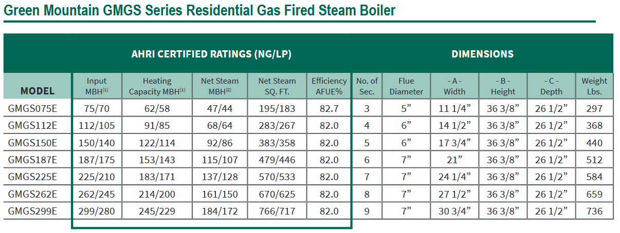

Im thinking of putting in my first Steam Boiler with a side outlet ( Green Mountain Makes one in their GMGS series) for technical reasons. Ive been told it can cause water carry over problems into the Main and steam wont dry out as well.. Has anyone followed manufacturer install instructions and still have bad experience with it? I plan to pipe in using a Drop Header.

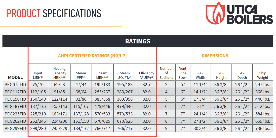

    The boilers look the same too, Utica PEG-F and the GMGS Series. Who made Who…

    Rebranded Dunkirk, just like the Utica PEG-F and Columbia CEG-F. Pipe it right and you won't have issues.
