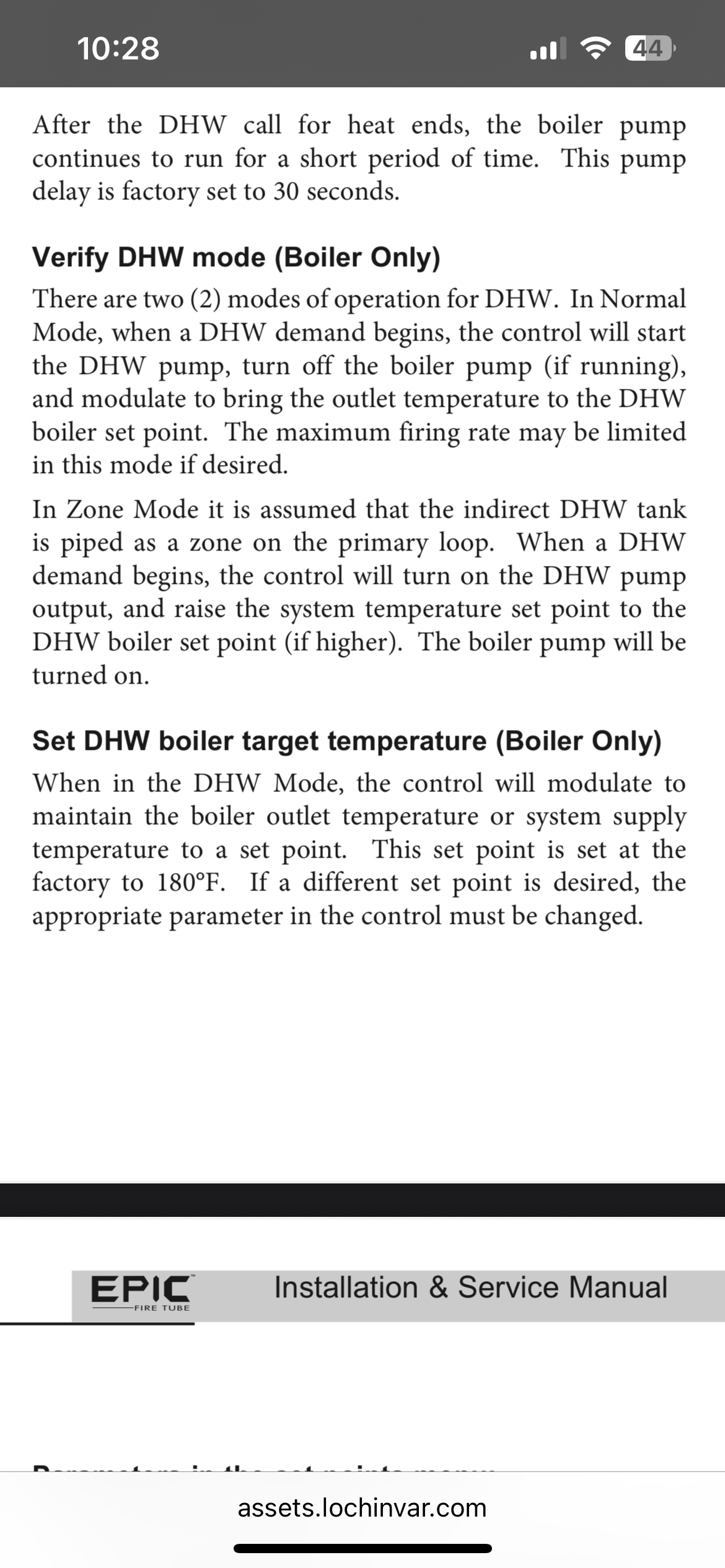

  • its using a tank sensor, tank is set at 60 Celsius. Boiler set point for dhw is 76 Celsius.
  • I was the GC of my house with my brother in law being the technical side of it since he’s built houses for about 15 years. But I left the plumbing work to my plumber and didn’t question his boiler selection, he had put a boiler in my brother in laws place and they haven’t had any issues but they have a walkout bungalow with the same amount of square footage and had gotten a larger boiler due to a lot more concrete floor to heat. So they haven’t had issues with running out of hot water. If I could I would replace the boiler with a larger one but that is money I can’t and won’t spend. Knowing I won’t be able to return the current one.
  • also i have watched the boiler when the dhw is called. It does start heating the hot water, but it doesn’t completely stop heating the infloor right away, sometimes it took quite awhile for the infloor to close the valves. That’s why I turned the times down.

  • I have read the technical manual for this boiler front to back and there are no settings to make dhw the priority, so I agree that it must be standard on it for the dhw to be priority, but from what I was reading elsewhere that the switching times basically told the boiler how long to keep the flow valves open for space heating before completely closing and switching to dhw. Unless im wrong, but that’s why I’m on this forum, to troubleshoot and find out more.
    usually it is the other way around. it immediately switches to the dhw zone on a dhw call and turns off the other zones but there is a timer that if the dhw call lasts more than x minutes it resumes the domestic heating zones in addition to the dhw zone.
    hot_rod Posts: 28,706
    edited December 2025
    this indicates the boiler pump turns off on dhw call
    If it is in zone mode a primary loop pump would also run

    first step is confirm the piping matches the DHW control setting.
    If the indirect is a parallel loop, then just one pump runs, boiler pump shuts off via the boiler control module.
    If it is primary secondary, 2 maybe 3 pumps need to run.
    Also the indirect loop piping should be 1” to move the boilers full output and get fast recovery
    Boiler should go to at least 180 target on DHW call, the control display in view mode tells you all this.
