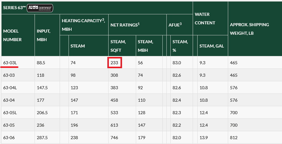

My attached radiation is 337.5 SF, and new Peerless gas steam boiler rated at 233SF. Is this sufficient? Single pipe with separate return.

    My apologies! My EDR is 237.5!!! I chose the one closest to EDR
    109A_5 Member Posts: 4,227
    If the EDR is 237.5 and the boiler Sq.Ft. is 233 the system should work good.

    OK in this case there is no "should" about it, this boiler will perform as good as any boiler you could pick.
    Congratulations for getting one of the last 63 models ever produced
    To quote one of my favorite movies, "it would be a shame to blow it up"
    And congratulations for resisting going to the next larger one "just to be safe". You have somehow, some way, actually purchased the correct sized boiler, making you very rare around here!

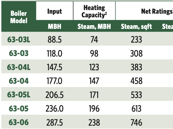

    I have a question on matching EDR to a boiler. Should the boiler sq. ft be equal to the total radiator EDR? If not, how is the pickup factor applied? Can someone write out an equation? For some reason this isn't sticking in my head.
  • ChrisJ
    ChrisJ Member Posts: 17,534
    The EDR rating on a boiler includes the 33% pickup factor.

    Thanks for clearing that up. Umm, the boiler states sq ft of steam, not EDR. They have the same units, correct? Hmm, my current boiler is 450 sq ft, and my EDR is 404. I think the next boiler down was 350 sq ft.

    ethicalpaul Member Posts: 8,933
    They are the same units. Always round down. Always

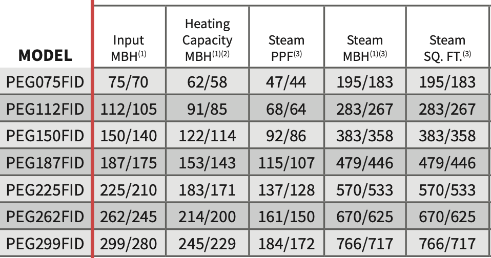

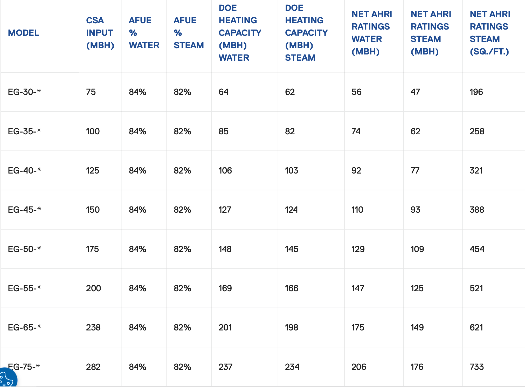

    Well those aren't actual numbers. So if my EDR is 400 I pick Peerless 63-04L
    Here's peerless:
    Here's WM:
    Here's Utica: (I think the first number is NG and the second number is LP)
