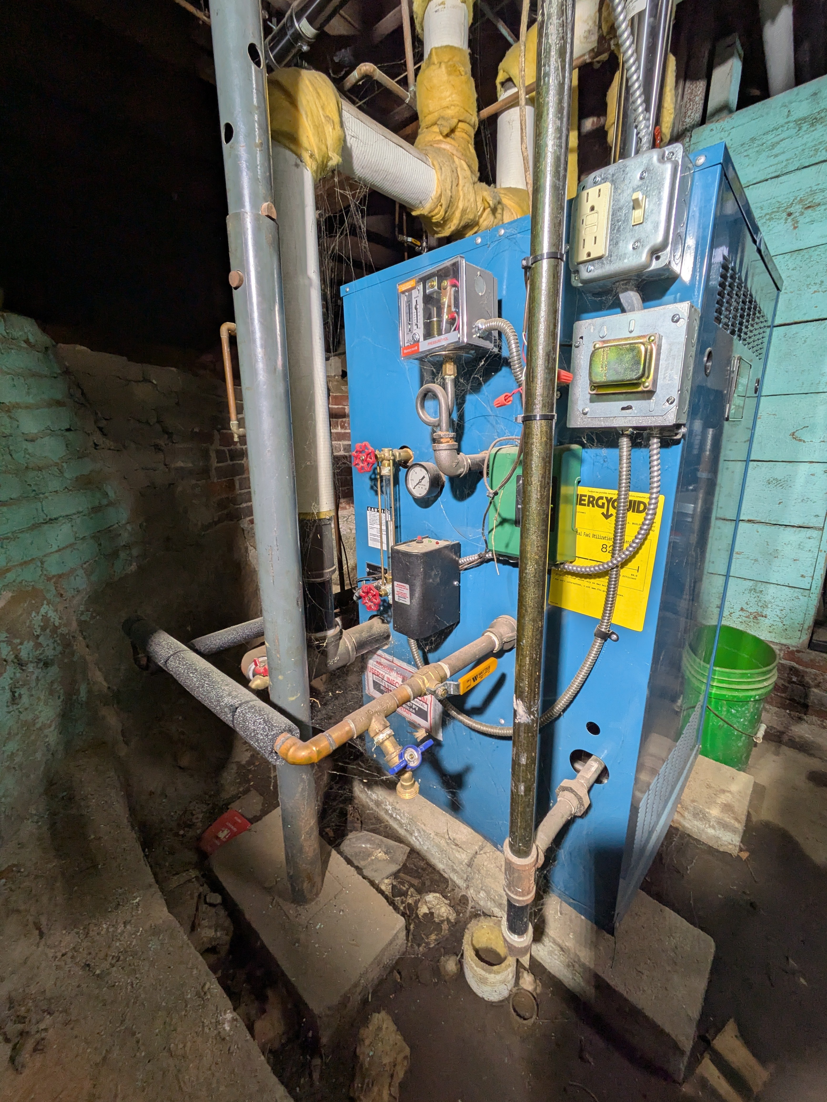

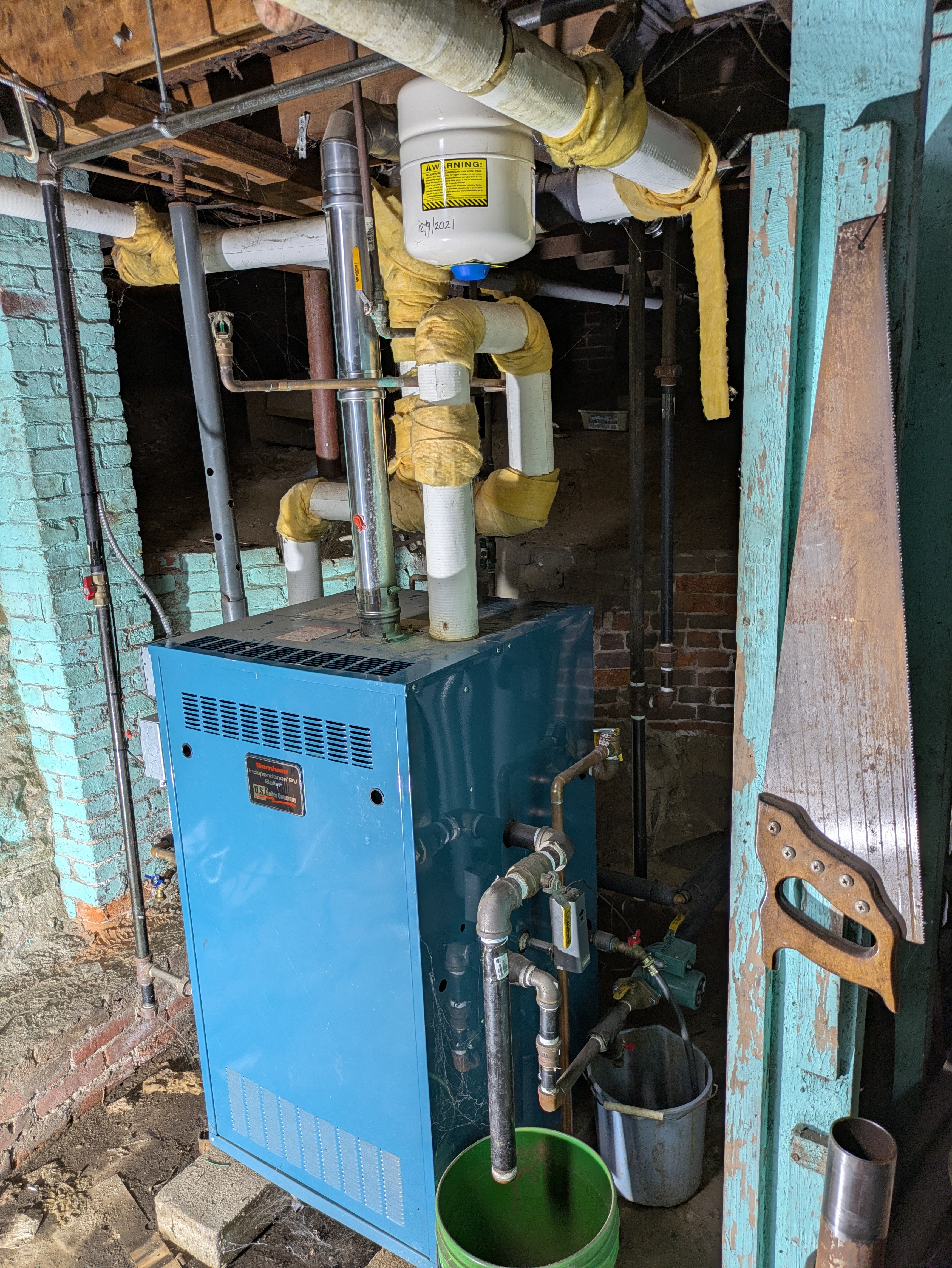

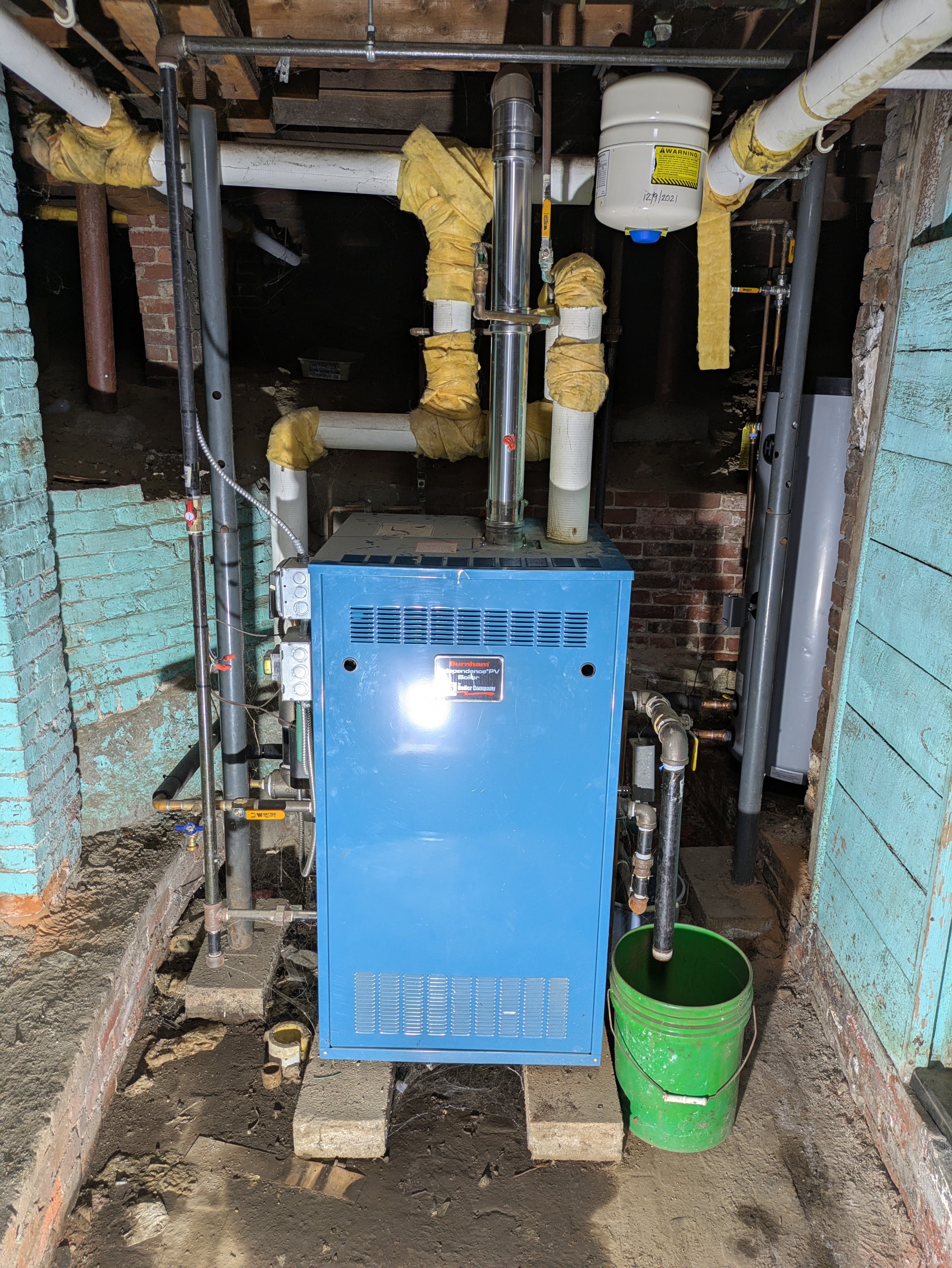

    bdl Member Posts: 122
    Ok, a couple of pics.
    PXL_20251202_170438409.jpg PXL_20251202_170519801.jpg PXL_20251202_170614769.jpg
    Have a few more, if needed.
  • bdl
    Seems one of them doesn't view for me. I did three. I see two.
  • bdl
    Lets try a zip file with all the photos. Don't know if this is over the limit for photos.
    Hope that helps some. It does have a drop header, but it's only in the size of the steam tapping. I think it lost almost one inch in the sight tube that last firing. Has to be a huge leak.

    Those photos are great. It appears that you are properly piped with a drop header. and the swing joint is fine allowing for pipe and boiler expansion to happen separately as the boiler heats, then the header pipes, then the main pipes, then the radiators. The insulation is done properly also so I cant see if the header is copper or steel/iron. I might think that you have a leak in a copper fitting but that doesn't explain the white exhaust smoke. (Perhaps a new Pope?)
    There are vinyl fitting covers available for those insulation elbows and tees. Check this place out https://www.buyinsulationproductstore.com/pvc-fittings/
    I would try to fill the boiler with water as suggested by @Ironman. If there is a leak above the water line that will show you with water spilling out the boiler leak and ending up on the floor. You may need an inspection mirror to find it inside the cast iron block. Or you could remove the metal jacket covers
