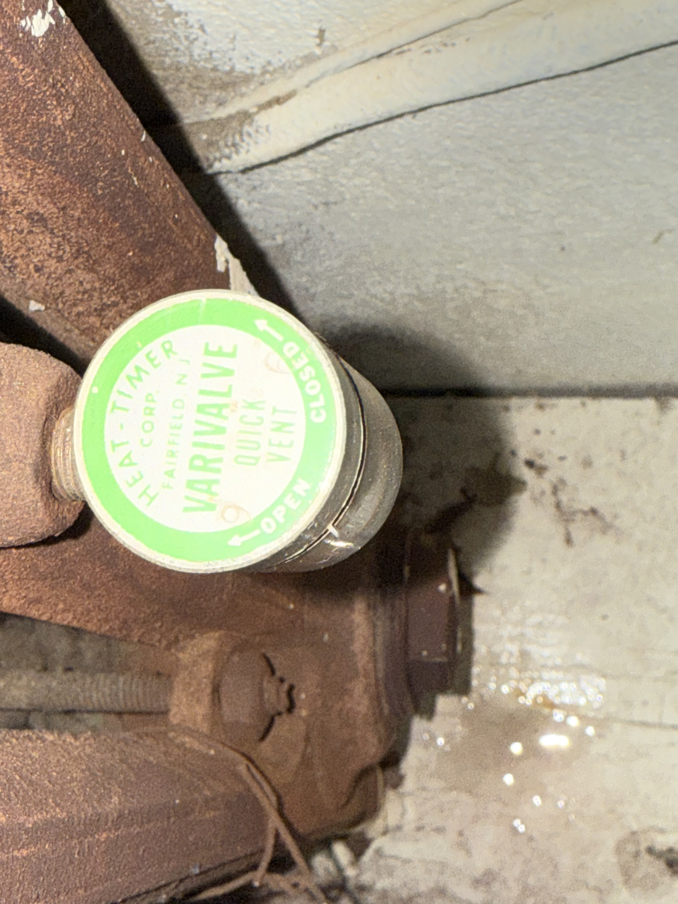

I am new to steam boiler systems and my boiler is losing a good amount of water as I need to add every couple days. I have replaced a couple hissing air vents which I am hoping helps. In the house I have maid o mist and gorton. Then in the garage I came across this one ( see picture). I saw a couple drops of water come out so will attempt to replace but looks much different that my others. Can anybody tell me a bit about this one?

    the Heat timer radiator steam vent is a very fast vent without a float safety .. They were made for buildings where controls sent up steam a few times a day .. Its not a ideal vent to balance an system, I do use them for that far problem radiator…

    But I doubt that that vent is your real problem… you may have a significant leak somewhere.
  • Nothing but trouble from those vents. They vent way too quickly and they have a remarkably short lifespan. Only real benefit is that they can fit into tight spaces. Would not install them in my own home, if someone gave them to me for free.

  • thanks for the responses. Do you think I should just replace with a maid o mist like what I have inside the house? Although I am not sure what size I would use. It is mostly 5 or 6’s inside (I have replaced with whatever the previous owner had in there).
    a bigger leak is what concerns me. I am starting with air vent replacements and will need to get professional help in locating the leak if it doesn’t help.

    Do you have a buried wet return? Do you notice a lot of white "smoke" coming out of your chimney when the boiler is firing? These are two common areas of leaks.
    I want to really like that Vent-Rite Vari-Valve vent because it's made just down the road from me in Fairfield, NJ, and I'm going to test one in my home very soon because I wonder if I may have been too harsh on them in the past. I do see a lot of them in people's homes around here and that's another reason I want to test it myself. The company itself brags that they have a very fast top rate rivaling the massive and expensive Gorton #2 main vent.
    I do like Maid O Mist and Gorton although it seems just about any vent can fail just about any time, while other units of the same model can go for years.
  • I have heard complaints about the Varivalves on this site. 2 years ago I tested all of the popular vents. Unfortunately, the complains about these valves were verified. Two of the 3 I placed in my system failed after two months. They would not open.
