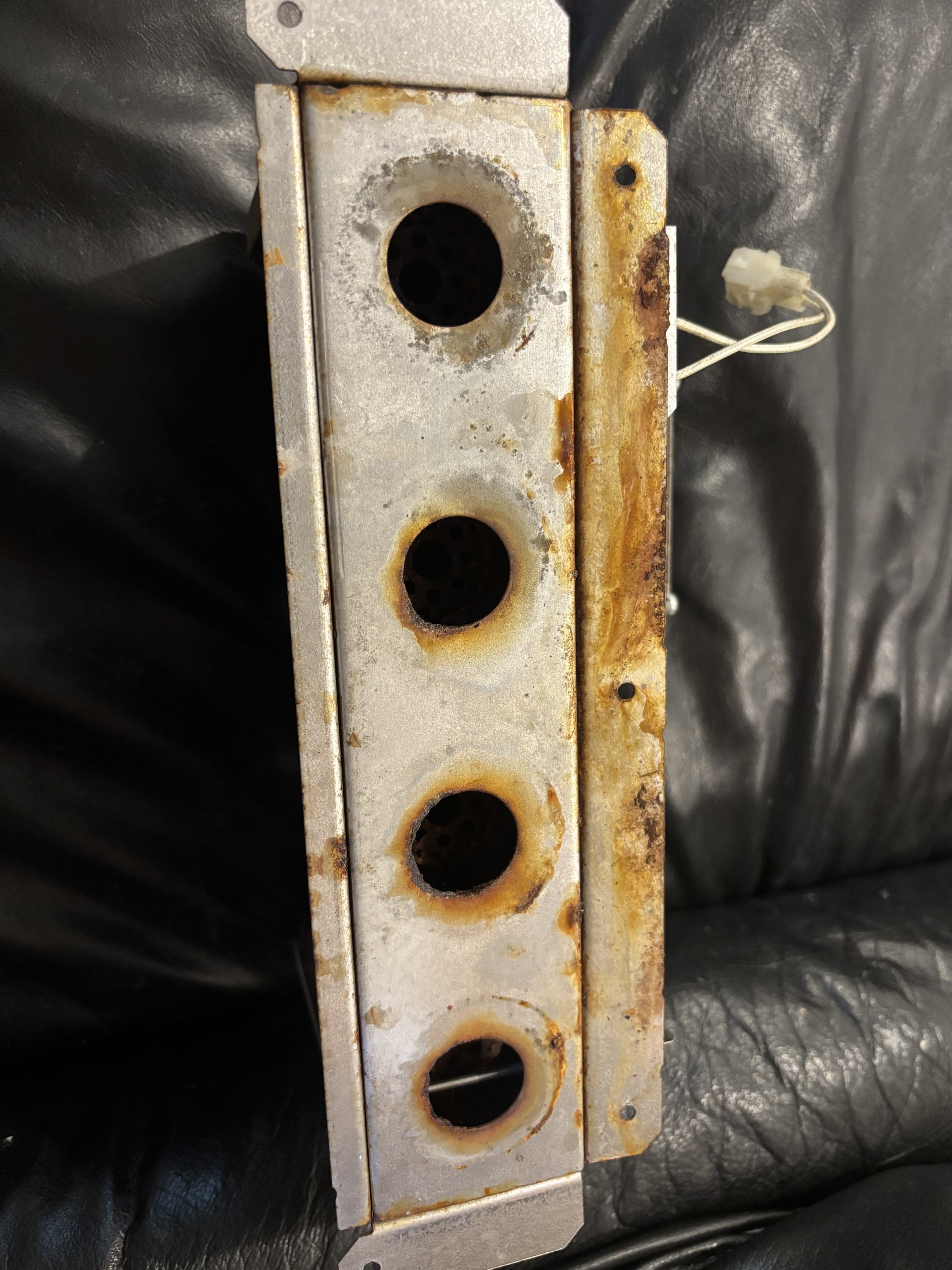

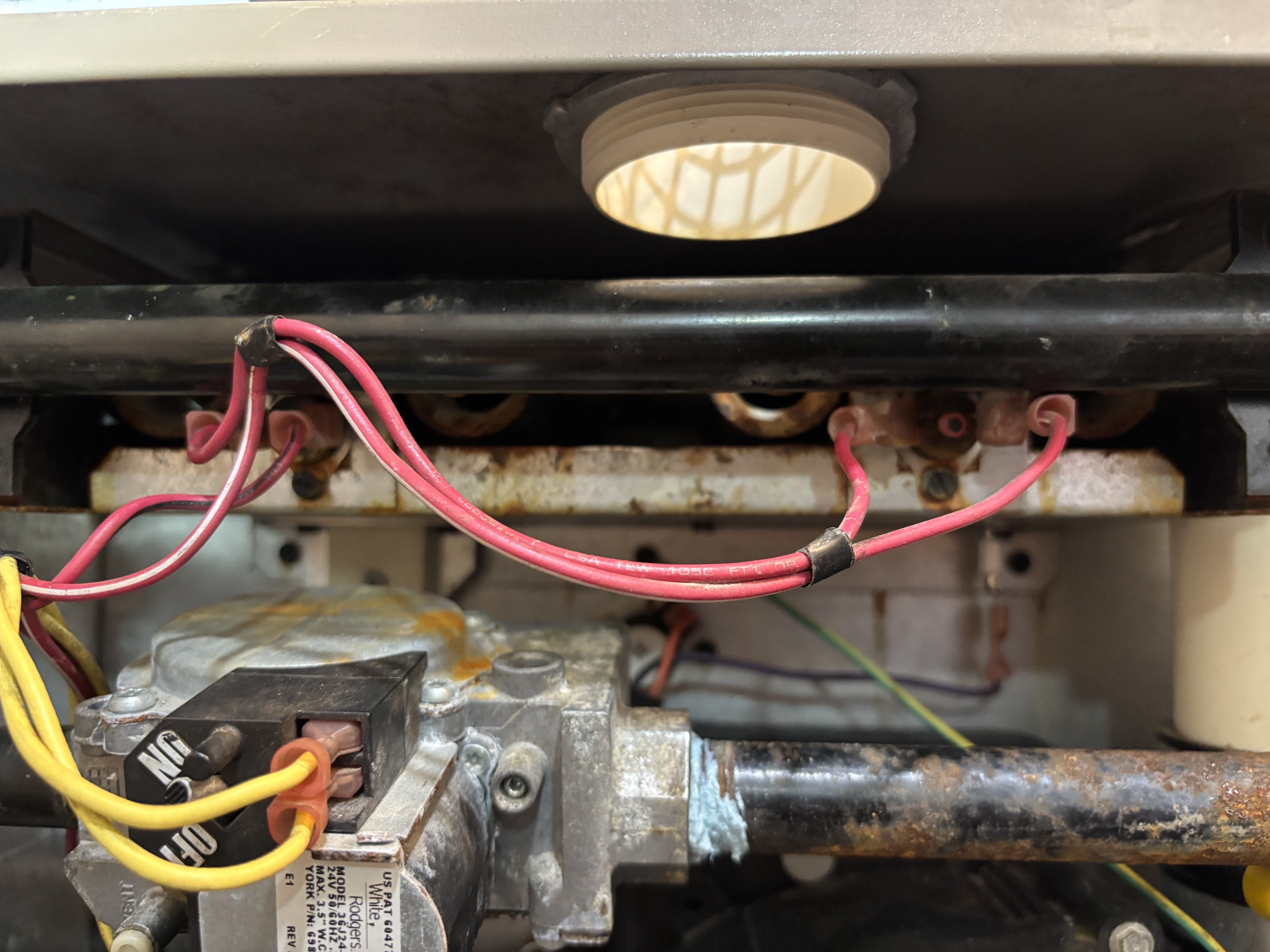

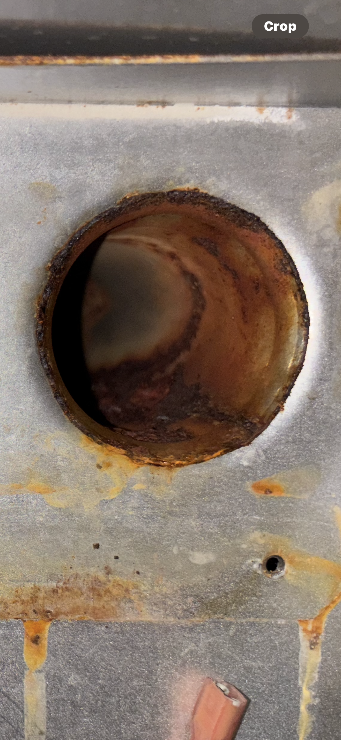

This is a york condensing furnace with air for combustion taken from within the house.
What could cause so much rust?

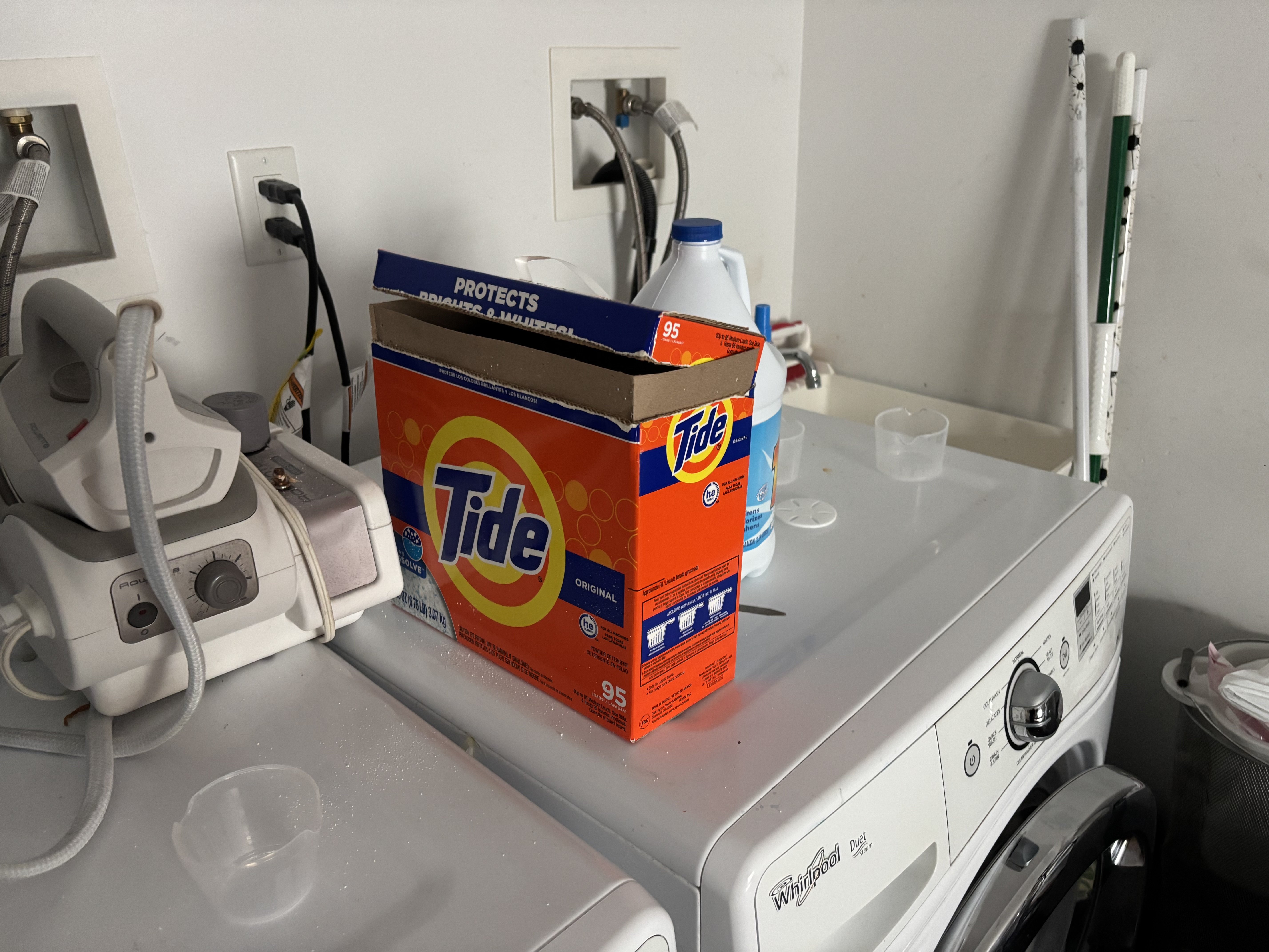

I know chemicals in the house can, but most houses I go to are near the washer/drier and I don't see this.
They said they have a lot of humidity in the summer and have two portable de-humidifiers running.

Hard to see from the last picture but there's light rust by the rollouts and on the burner box, burners, etc

    get the burner supply air from outside the laundry room

    Furnace is not in the laundry room itself. It’s around the corner.
    Taking the air from outside can't hurt. I think a lot of that is from the humidity. However when the furnace runs in the winter the humidity should be low..
    Laundry chemicals "around the corner" still counts if the combustion air comes from indoors.

    I understand that the combustion air will be pulled from the entire basement. It's a finished basement and it would be difficult to install. Obviously, if that's the solution then it has to be done, I just wanted to rule out any and all other possibilities.

    Laundry chemicals + humid air could definitely be causing that.

    is condensate backing up somewhere?

    There was a no heat call because the the flame was not crossing over because the burners were so corroded, then the gas valve stopped working. I an going to replace it Monday and I will get back here with the info.

    That’s a little too lean. Set the manifold pressure to what the manufacturer recommends on the data tag (probably 3.5”).
    But that’s not the main issue. It needs to have the intake run to the outside.
