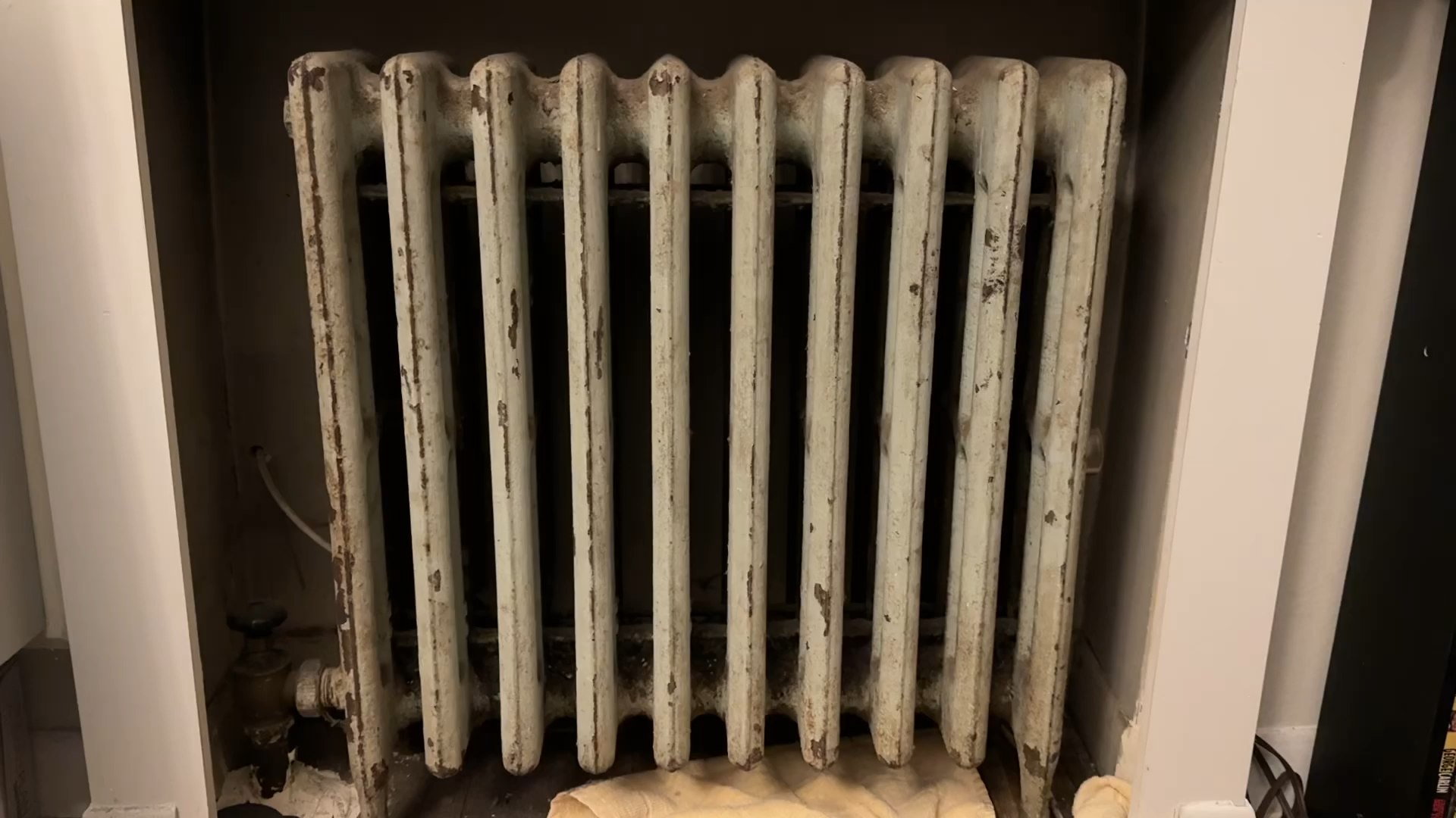

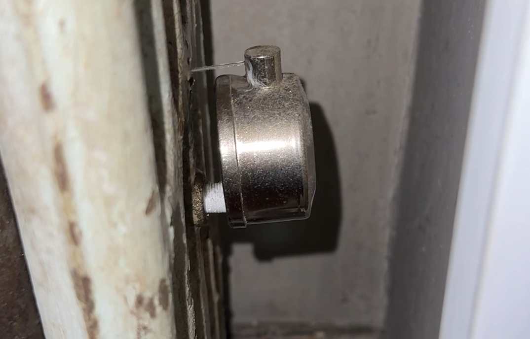

I live in an old New York apartment. Since I moved in 4 years ago, the banging pipes have been an ongoing problem every year. It has now gotten to the point where tonight (Thanksgiving night) the water hammer is so loud and so incessant, it sounds like a construction project. They sound like washing machines because they're so full of water that the air vents to my radiators (both of them) sometimes squirt out water. But the worst part is when this happens, the heat doesn't come on. I'm writing this at 3AM and it's so cold, even after the pipes have been banging for half an hour.
And this is AFTER the landlords replaced the boiler this summer! Apparently they didn't clean it properly or something, I dunno getting information out of my landlords isn't so easy.
The one reprieve I get is that when I call them, they'll send someone over to drain the system and "Treat it" whatever that means (some kind of oil them put in it). Usually that gives the pipes a good 2 weeks of somewhat normalcy, but they just did this last Saturday (when I had to call the landlord's emergency number at home).
I just don't know what to do at this point. I can't live like this. I can tell they're at least trying to fix it, but it just feels like a much bigger problem they're putting a band-aid on when it probably requires a big expensive assessment to take care of the problem. I've even chatted with some experts here and forwarded their information to my landlord, but he says "I don't need someone else to tell me what's wrong with my boiler."

the new boiler and new pipes will have oil in them which will float on the surface of the water in the boiler. this will interfere with the steam erupting from the surface of the water and cause the steam to erupt violently and throw liquid water in to the steam mains. this is likely the banging and the water squirting out of your vents.
the fix is to skim the boiler. it has to be done by slowly floating the surface of the water that contains the oil out of the tapping that the manufacturer specifies that will be near the top of the boiler. it usually has to be done a few times to get all of the oil out.
detergents and other additives aren't a substitute for skimming although they can make it more effective
draining won't remove the oil. the oil will cling to the sides of the boiler as the water level falls and just float right back on to the surface of the new water.

it is very unlikely that the issue is that it "isn't draining", especially if it worked with the old boiler. it is far more likely that liquid water is being thrown in to the piping by the new boiler because the oil from the new boiler and piping hasn't been skimmed off properly or the new piping isn't correct or both.
2 -
Thank you all for the comments! So they did temporarily fix the pipes Friday morning, but we'll see how long that lasts. I did narrow it down slightly. Thursday night (or rather early Friday morning like 2am) the pipes were banging and weren't heating. However, down in the hallway by the front building entrance (my apartment is a floor up at the back of the building) there's a radiator that seemed to be heating up just fine. However, I could hear some serious banging in my downstairs neighbors' place even outside of his door! So It seems to me that whatever pipe is going up the units in the back of the building, or whatever's connected to it, is the culprit. I'm gonna mention it to them, but yes it would be nice if they brought in some professionals.
The location is probably a symptom rather than a cause. The cause is probably that the boiler is throwing liquid water in to the mains and that pipe is where it is collecting.
