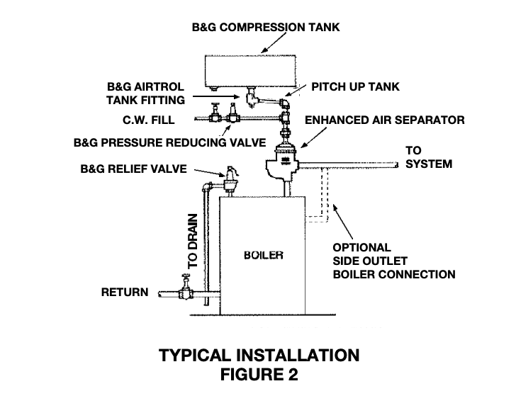

B&G and others devised a couple components to allow air captured in the top of the boiler sections to be placed into the tank via their Airtrol ™ components.

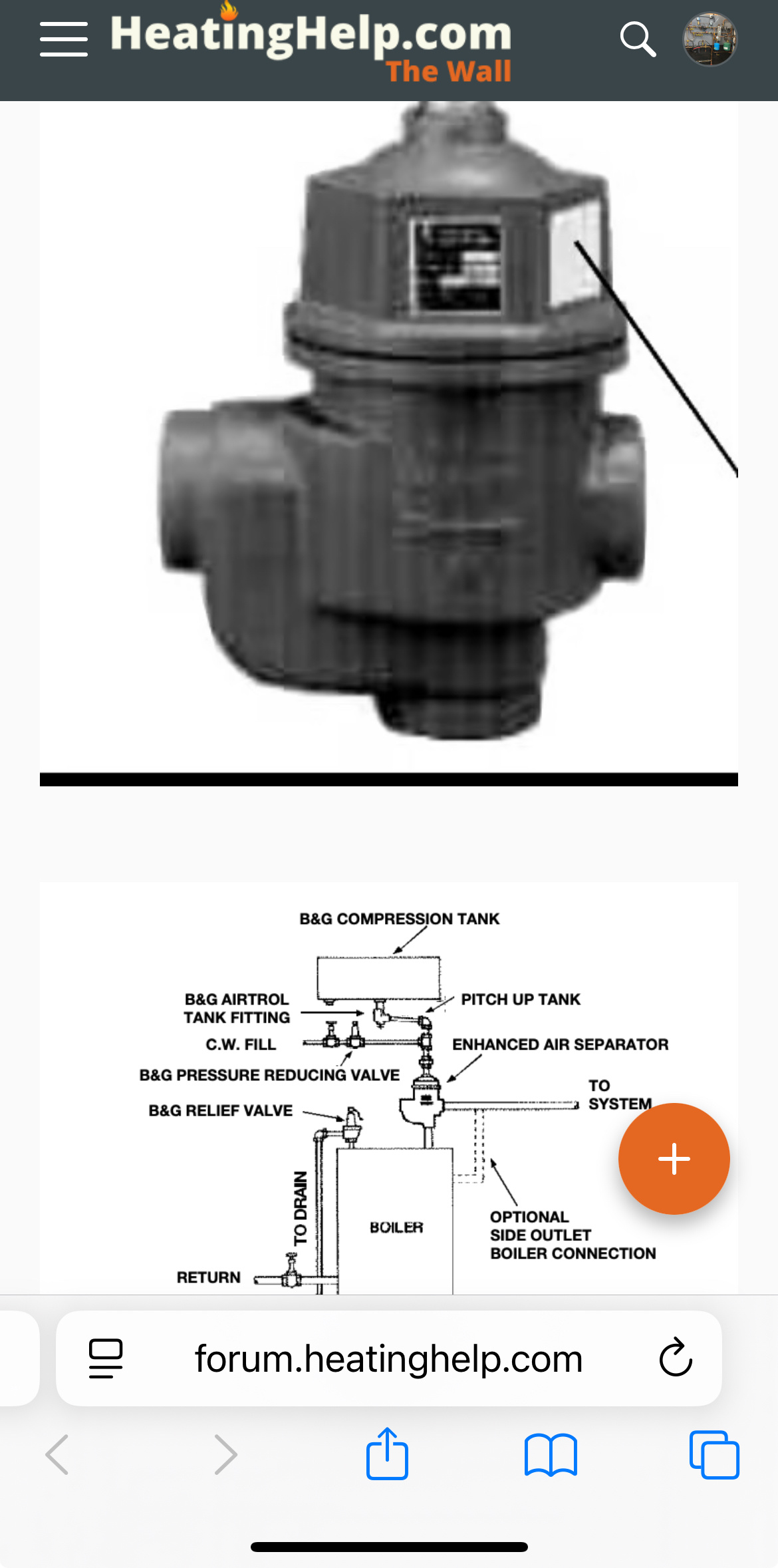

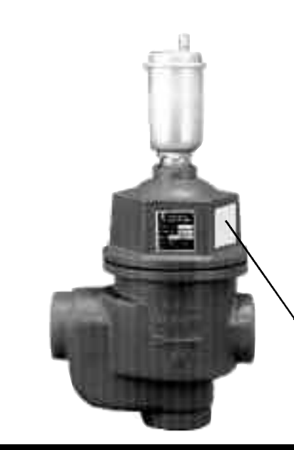

B&G also shows both the IAS inline air separator and the EAS enhanced air separator, a micro bubble type air separator being used instead of the Airtrol fitting into the boiler.
I believe both of these B&G products have been discontinued.

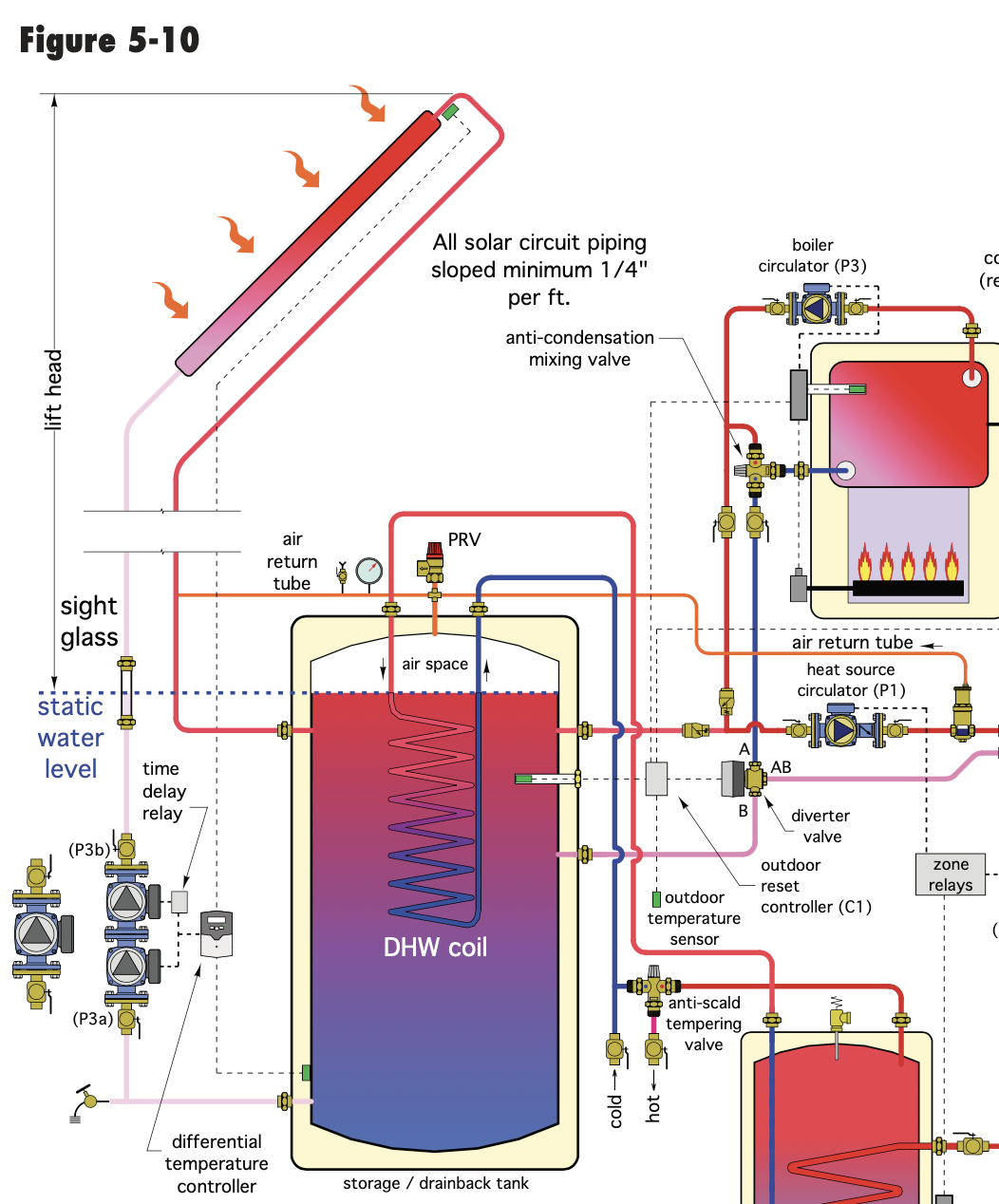

On my solar drainback tank at my last shop I piped the air vent discharge from a Discal up to the air space in the solar tank. In fig 5-10 it shows the Discal piped to the top of the tank at a cross fitting, and the siphon break air tube piped to that cross. So any air removed from the circulation, gets placed in the air bubble at the top of the tank.
I believe any microbubble type purger with a treaded vent connection could be used on a boiler system with the steel compression tank.
Any experiences with this arrangement?

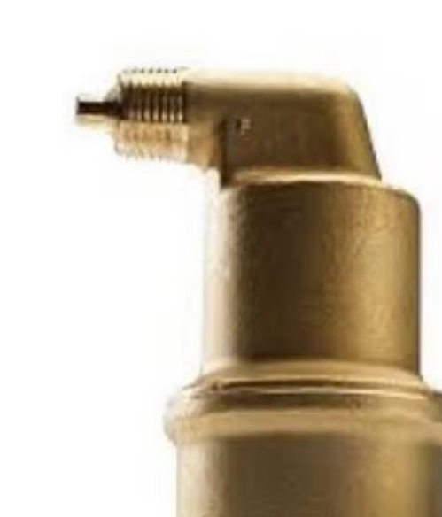

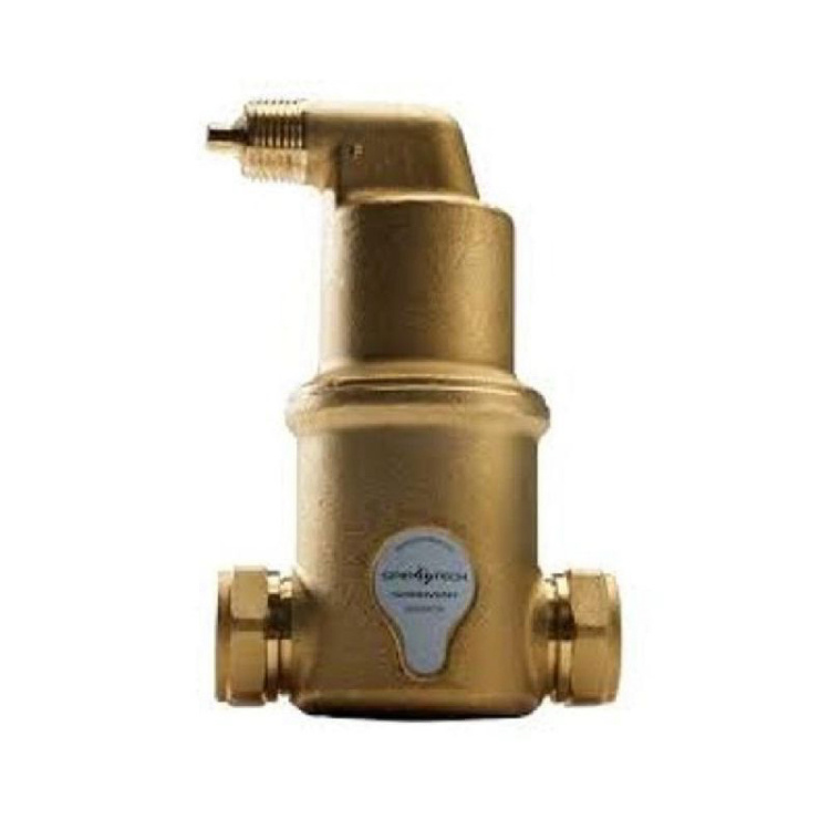

    The air discharge port on a SpiroVent is 1/2”MPT, so that can be piped to a compression tank to maintain the air cushion.
    I’m not aware if any other brands of air separators (MBR) that are made that way.

    this B&G piping shows a basic micro bubble air sep going into a non diaphragm, plain steel compression tank
    I think the airtrol fitting into the boiler is just venting the air into the compression tank also.

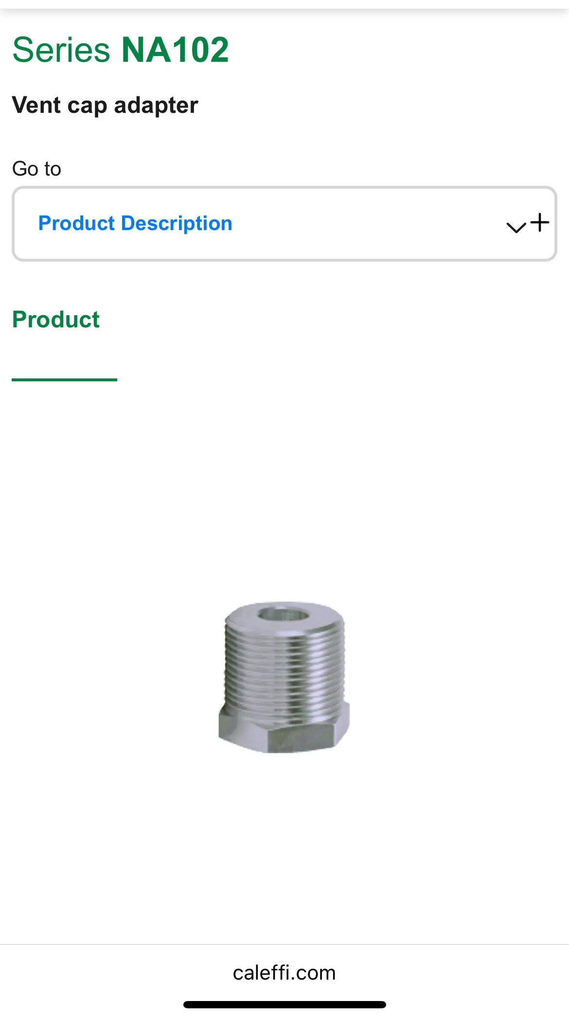

    hot_rod Posts: 28,705
    This thread adapter fits most of the brass air vents, Taco offers them also
    This just converts that metric thread to NPT so you can can put a copper tube on the outlet
    While the spiro has a 1/2 npt, the hole in that stem is around 1/8”, that would be the limiting factor in how much air vents out

    i think if you use a standard microbubble air separator you would either need to remove the float and needle or pipe a second pipe from the system to the tank so that water could flow freely both ways. ideally you would also have a tank fitting or pipe loop to prevent gravity circulation out of the tank too. The schrader cap to npt adapter would make almost any microbubble separator work.

    The B&G has the float vent removed and just the purger part connected to the tank fitting
