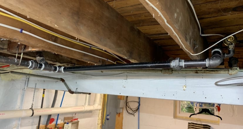

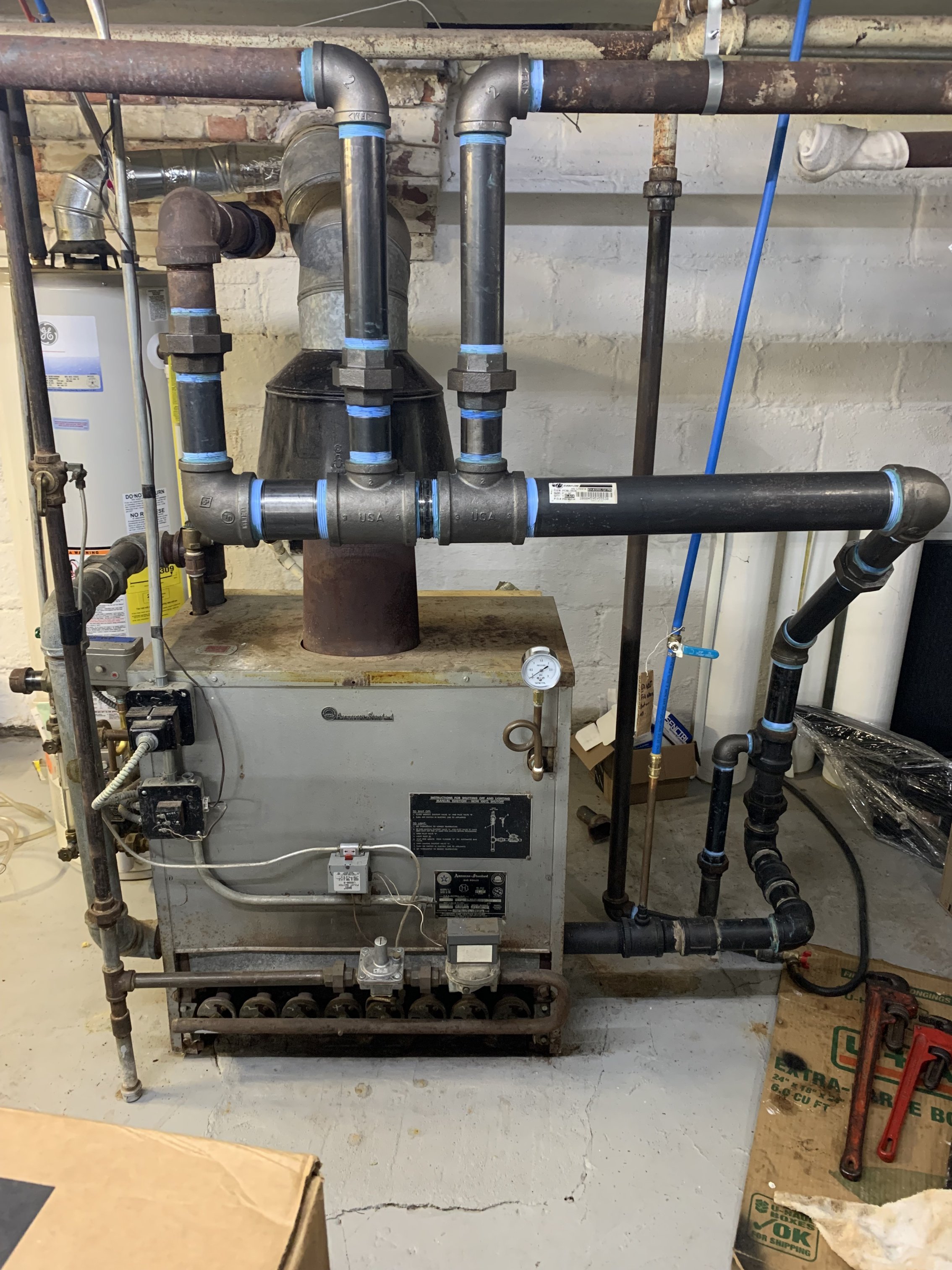

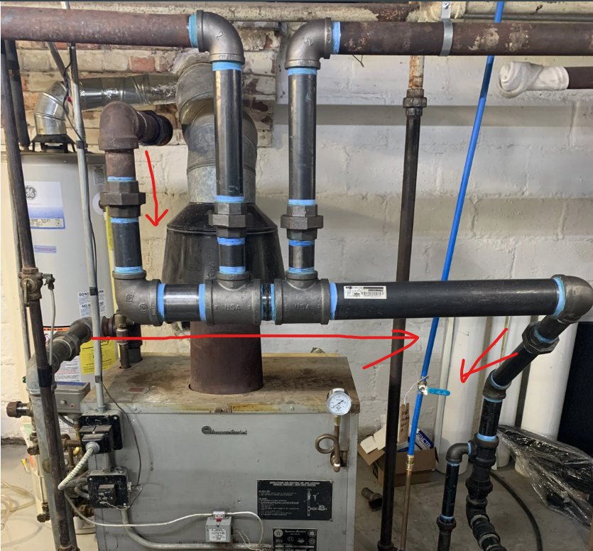

    I agree with @ChrisJ that the new header has a slight pitch problem but is not the issue.

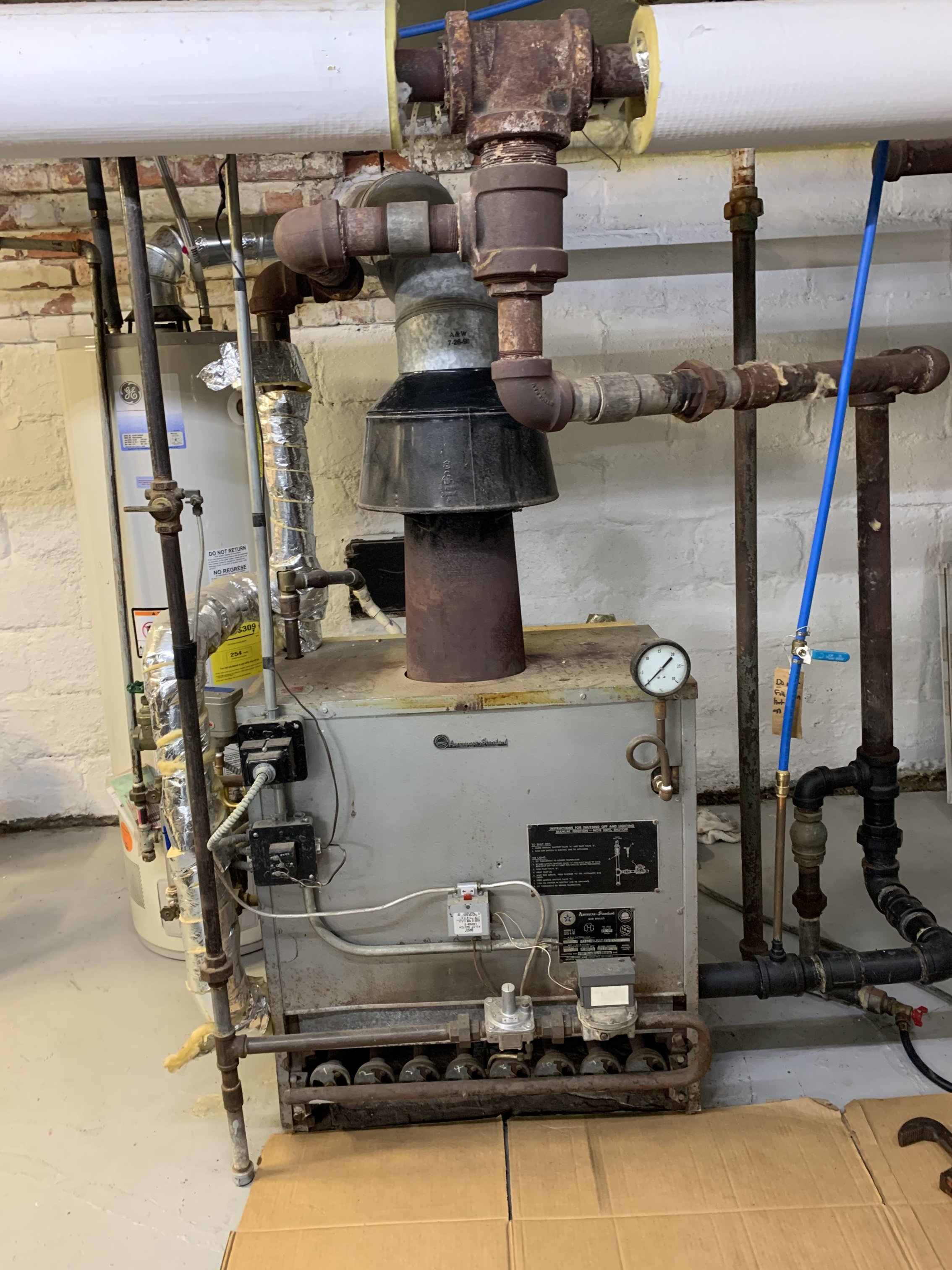

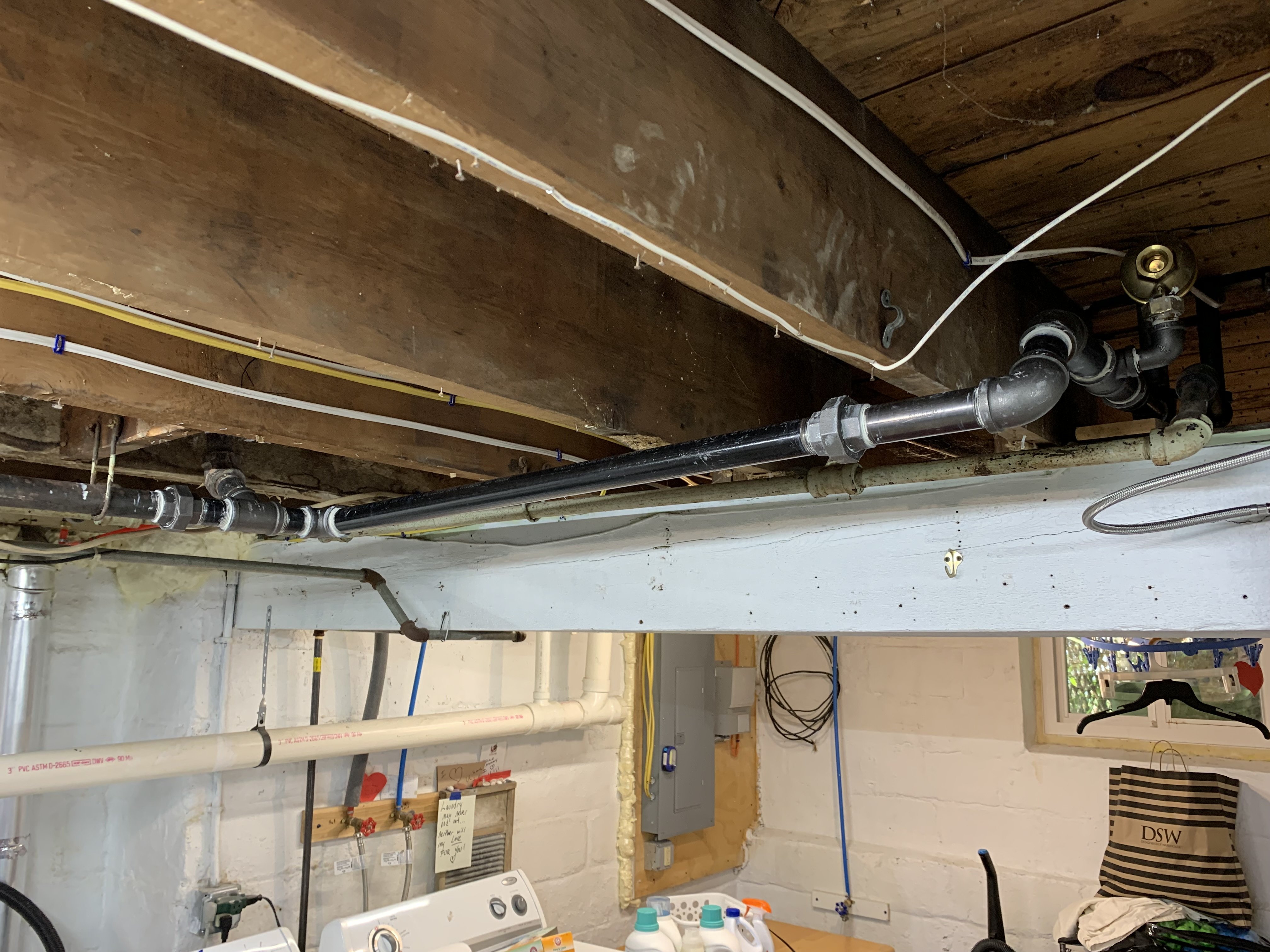

    I also think that if you compare the pictures of the old header and the new header that with the old tee you can clearly see that the main coming out on the left was counterflow with no drip and the end of that pipe had to be cut with a "drunken" or "****" thread to get that pitch. The one on the right is less obvious
    now i want to know what swear word or slur was used to describe an intentionally out of square thread to provide an offset of a pipe to a fitting.

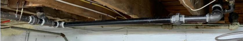

    in the pictures the main looks like it has downward pitch. i would check that with a level and look for reducers that make a lip that keeps the condensate from draining. if i don't find any of that I would take off that vent tree and put a hose thread adapter there and hook up a hose there and flush that main back to the boiler in case there is some mound of sediment that has somehow ended up in that main.
    i also winder if there is a piece of teflon tape stretched over the end of one of those fittings making a dam in the pipe.

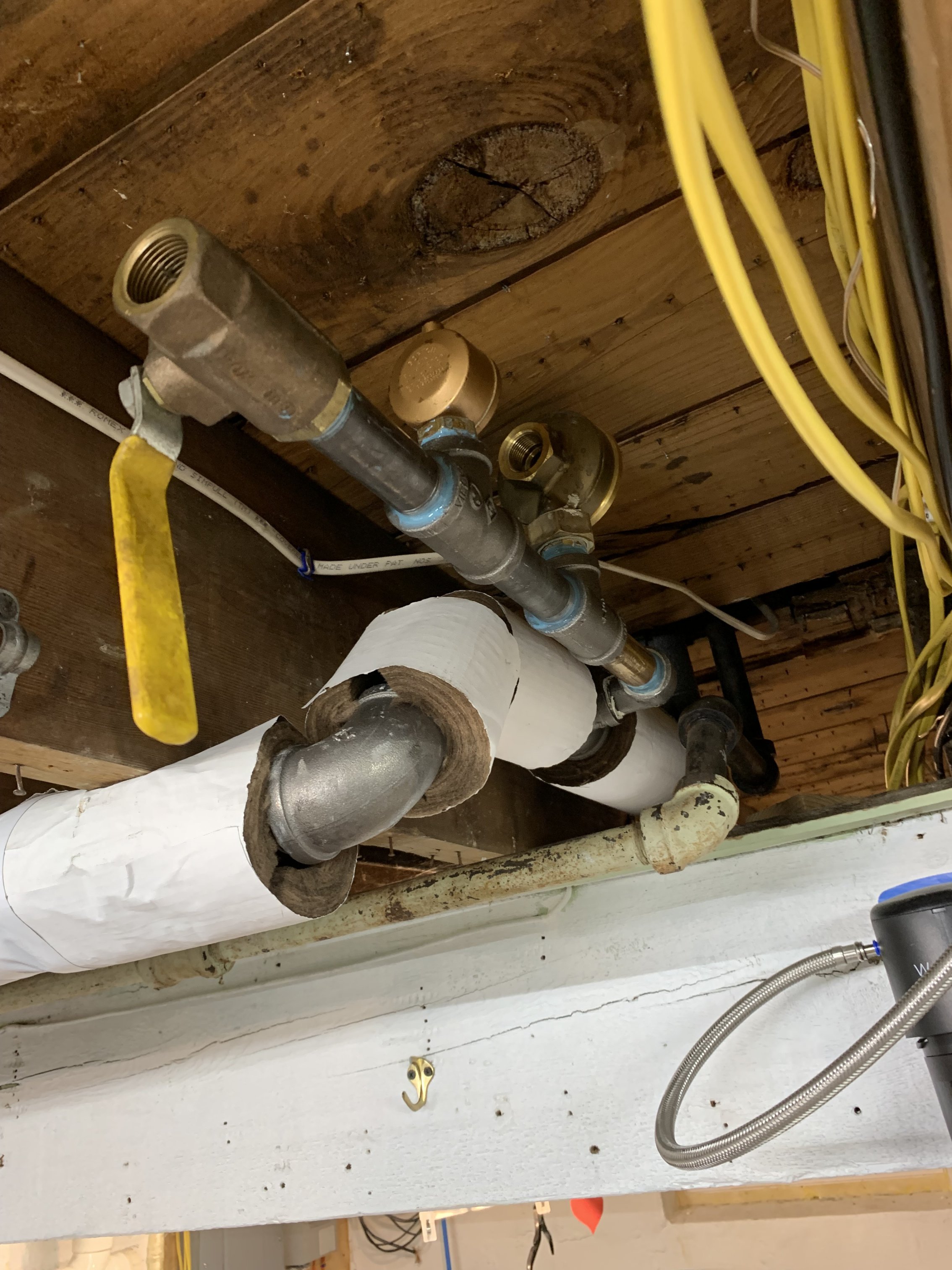

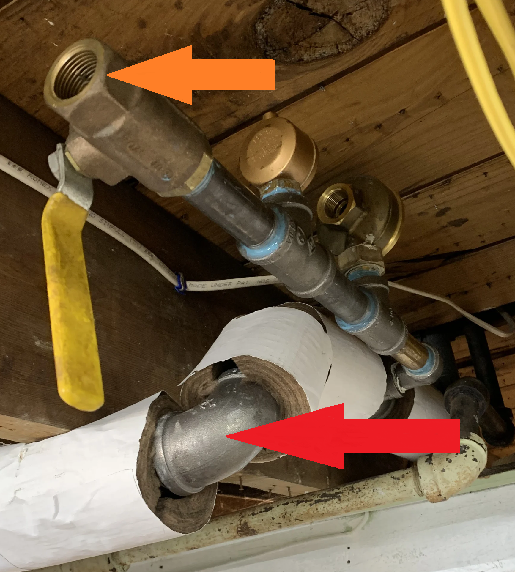

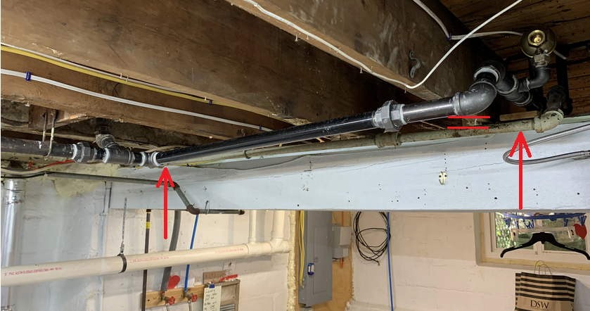

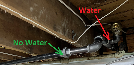

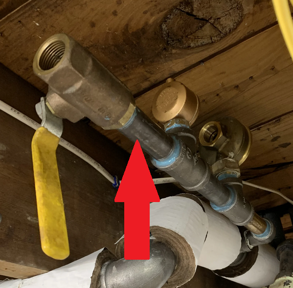

    " I just opened up that valve I added by main vent and dumped out about a quart of water in a bucket which seemed just about all that was in the main and then that radiator heated right up fast and as quiet. "
    You have a huge puddle of water at the end of your steam main. Where water is steam is not. Probably a pipe pitch issue. It needs to drain back to the boiler, continuously. There are various ways to correct this issue, but until you do the puddle will just come back.
    If your are getting significant water at the Orange arrow when you open the valve (should be almost none), the Main at the Red arrow is flooded (it should not be), preventing normal steam flow. There is a pipe pitch issue.
    a string along the main and a level is good for seeing if it has proper pitch.
    reducing fittings that cause a dam are also a possibility
    can you show us that main all the way back to the boiler?
    that valve is pretty far up hill from the main itself. the picture is inconclusive but i would put a level on that lateral that has the vents in the side of it and make sure it has pitch toward the main. i would also make sure that tree of vents has pitch toward the tapping on the lateral. if it pitches toward the valve it could hold water and keep the main from venting.

    if you break this union, does water come out?

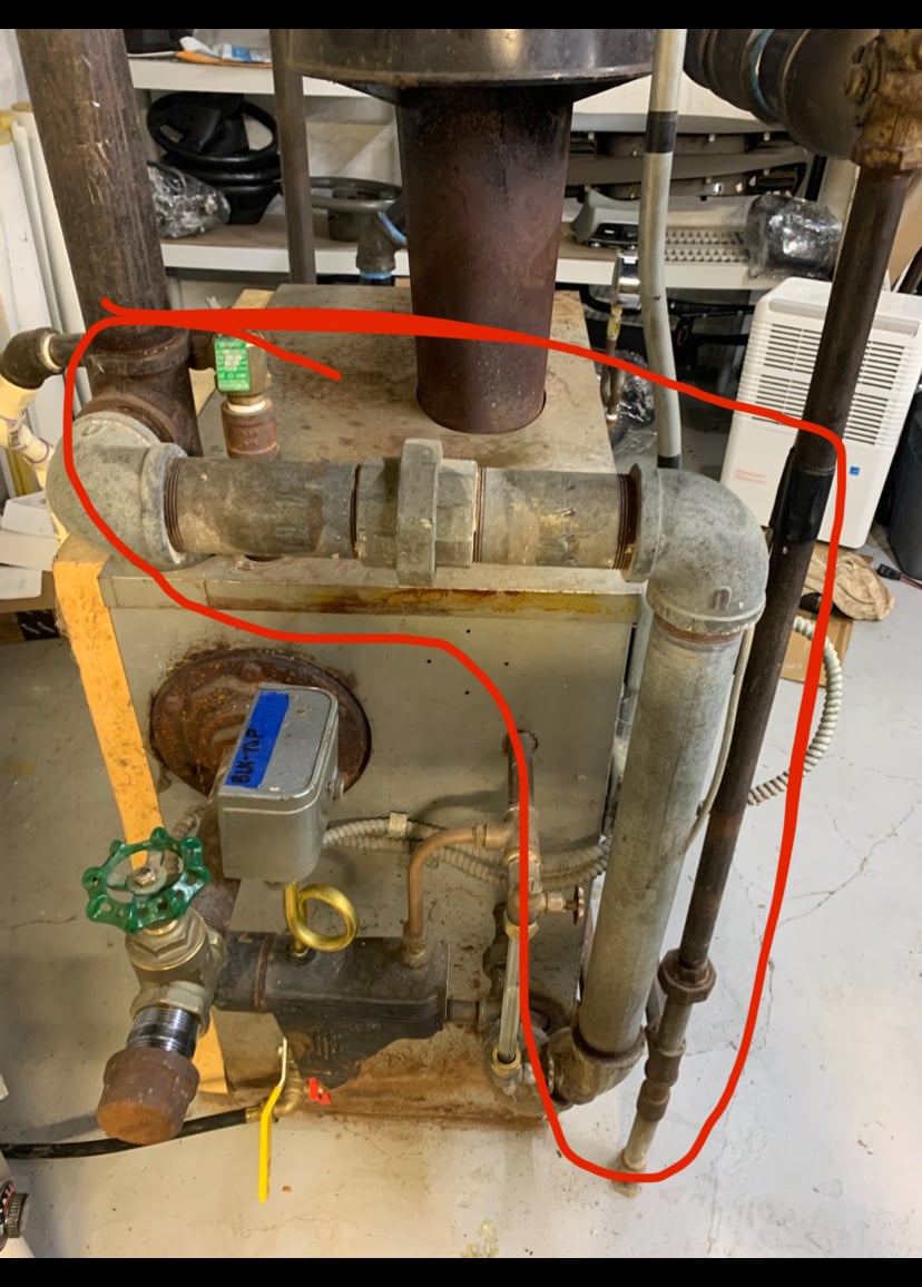

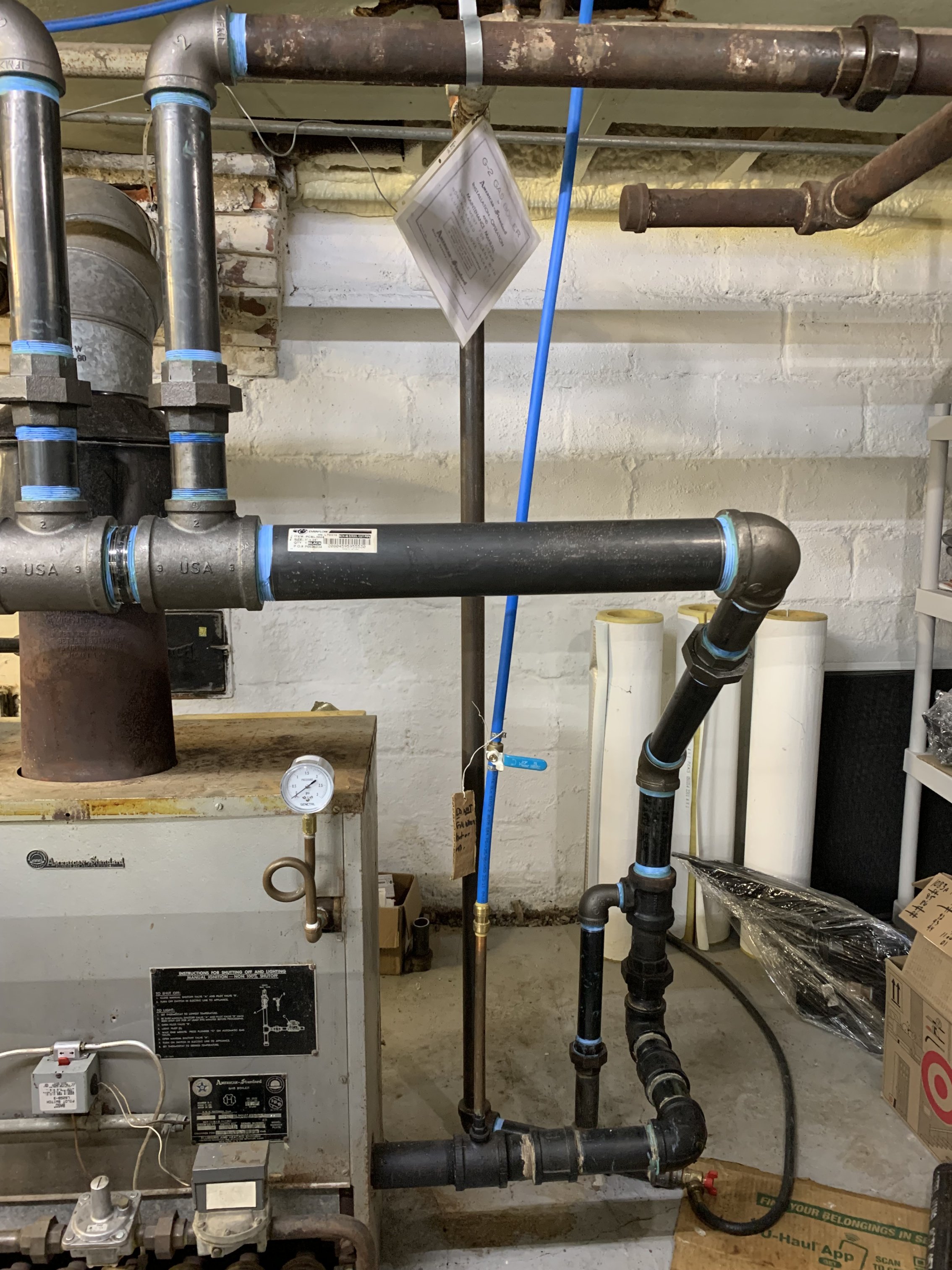

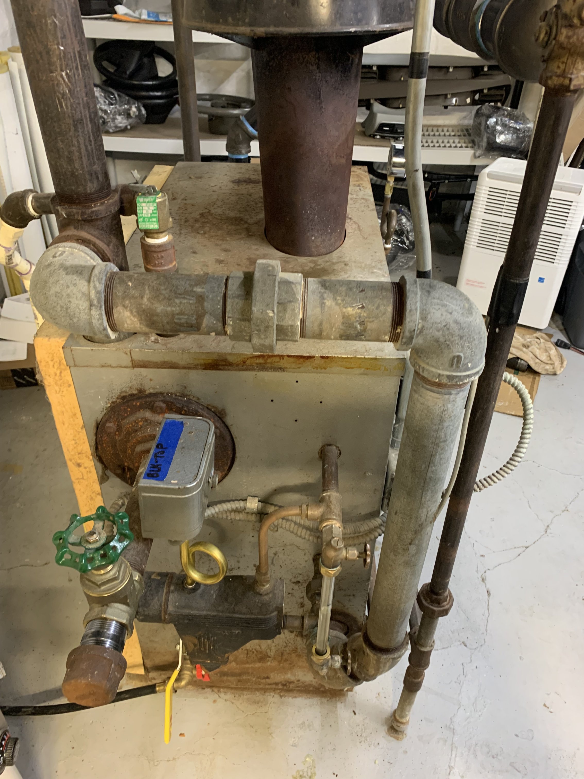

    You don’t think this piping at the boiler , which is also adding to the amount of water in the boiler (since it would be full up to the sight glass level ) is causing any issues?
    the water in the mains from incorrect near boiler piping would only be while the boiler is steaming. the incorrect piping would cause the boiler to throw liquid water up in to the mains and that water would drain back to the boiler when it stops firing. usually when that happens the returns get hot before the mains from that water flowing back through the returns
    if you have water in the mains after the system has been shut down for a few minutes then there isn't a path for the water that condenses in the piping to get back to the boiler. it is an issue with the system piping or a clogged steam trap or something like that, not the near boiler piping.

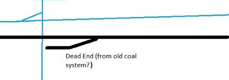

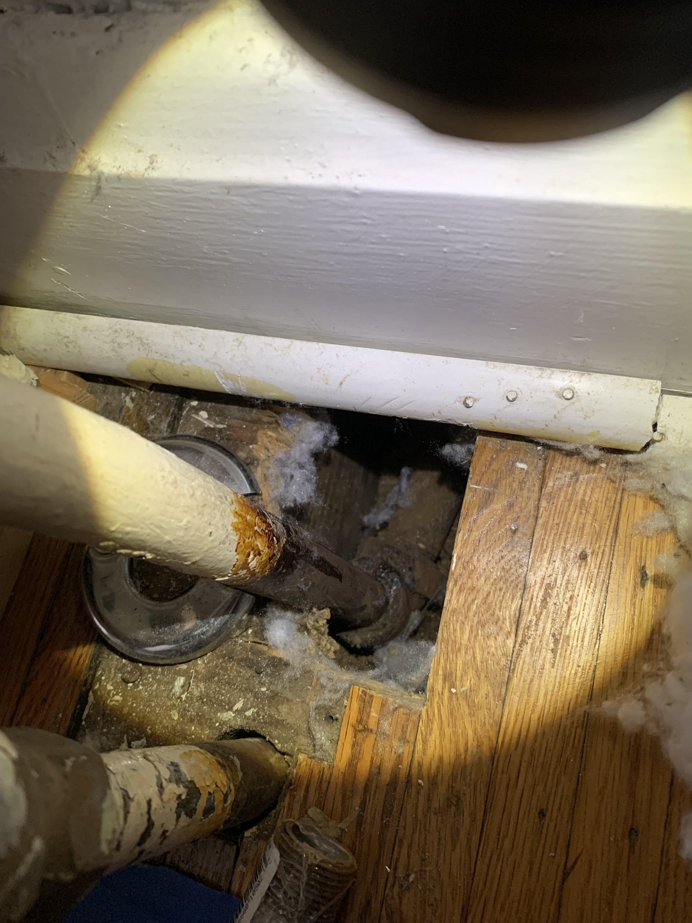

    I can’t get a good pic of it so here is a rough sketch .. near the boiler header is a dead end off the main. I think it was left there from when it was converted from a coal to a gas boiler . It’s about 2’ before the verticals take off from the header. Could condensate from the main be running back into this pipe and sitting there, then get pushed back up the main during the heat cycle ? It’s on the stain side with the problem I’m addressing.
    No. There's nothing to "push" the water in that dead end out.
    Look. As @EBEBRATT-Ed said, and I've said… this isn't rocket science. Either repitch that pipe so it drains to a drain, if you can, or add a drip so the water can leave…

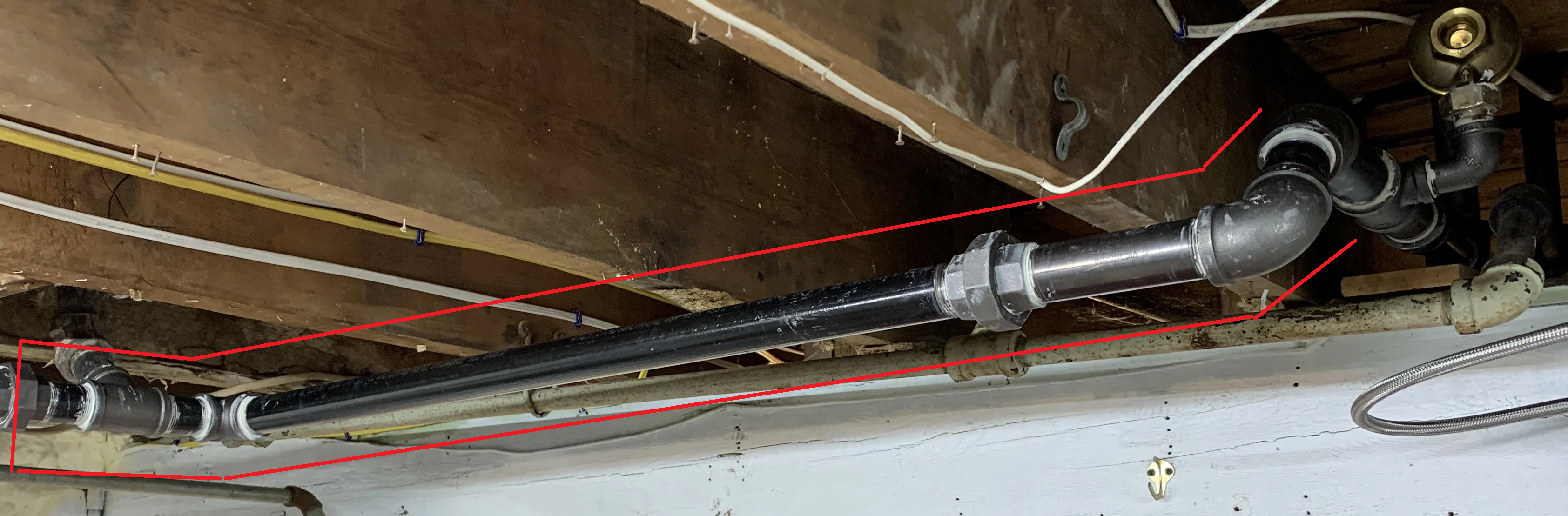

    if that area has water I say open the unions and see how far back toward the boiler you have trapped water, that will tell you which direction of the union to look in. if the union closest the radiator has no water then that runnout and offset has something going on. if it it all the way at the first section of new pipe then look further toward the boiler.

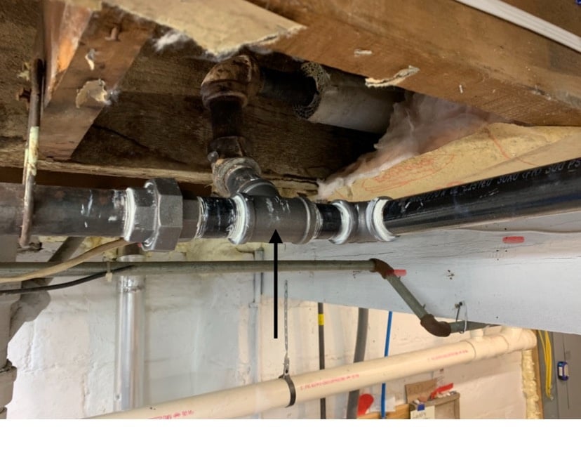

    how do you get from the existing pipe to that new 1.25" pipe?
    if you find it is in the asbestos covered section then maybe you put a drip at the connection to the first section of new pipe instead of getting that abated to find out what someone did 60 years ago.
    @ChrisJ furthermore, there are different types of 2 pipe systems. vapor systems frequently need to have a single vent point in the entire system because many have some sort of device that lets steam in to the returns to equalize the pressure between the mains and returns (usually a loop of some sort but there are other designs). the main vent needs to be near this device so that the steam will reach the main vent and close it and allow the return to equalize without the steam going all over the returns trying to find the vent. there is usually a check valve on the return that prevents the boiler pressure from pushing out in to the return directly.

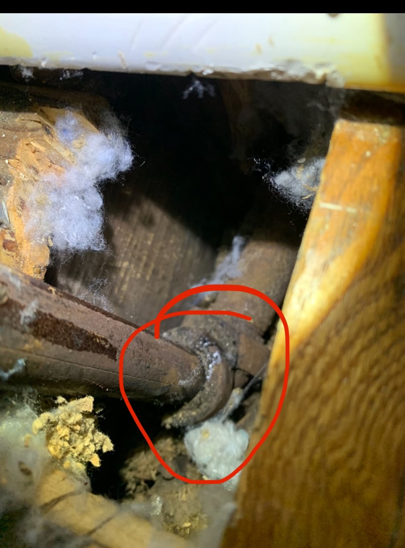

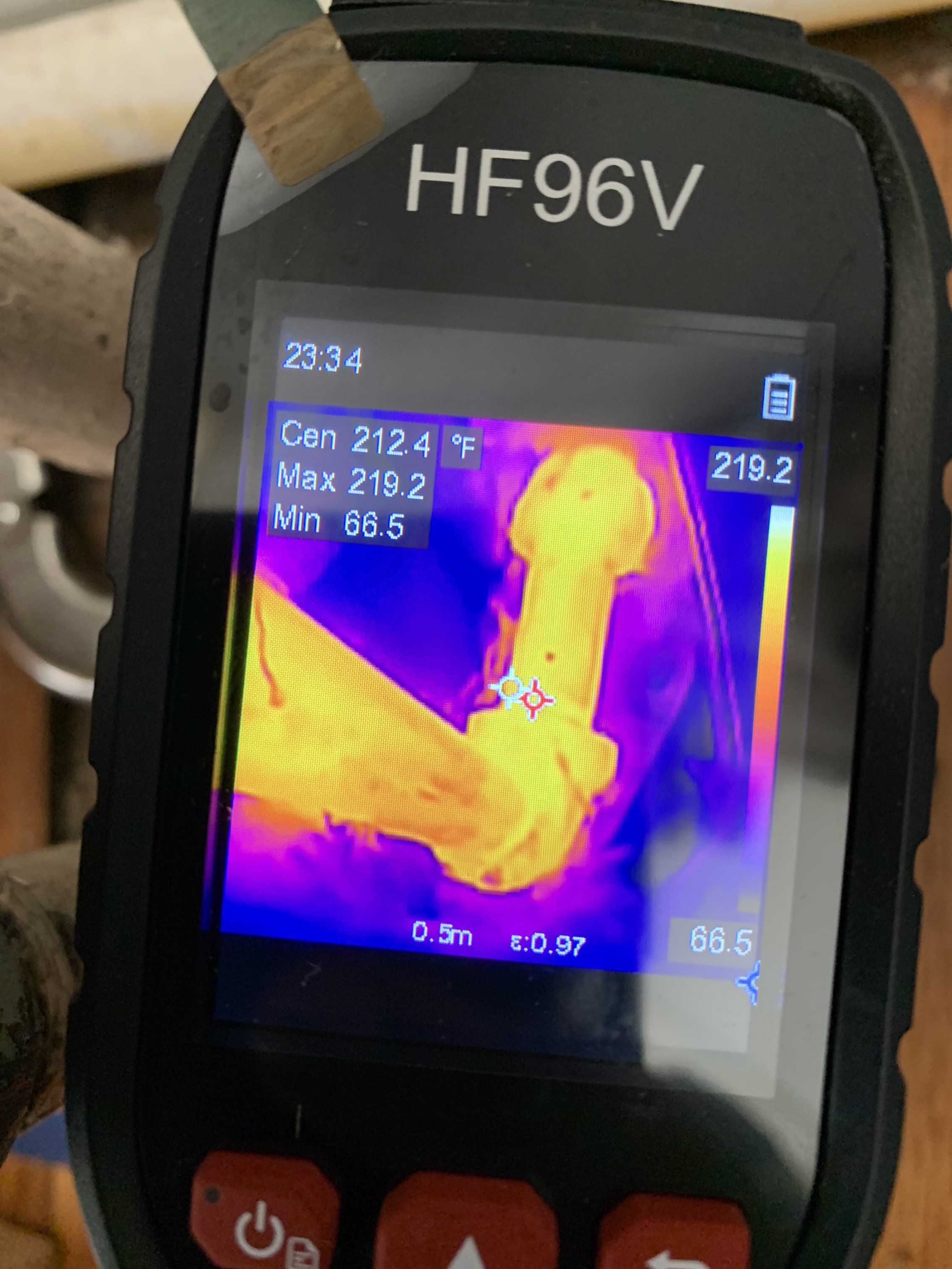

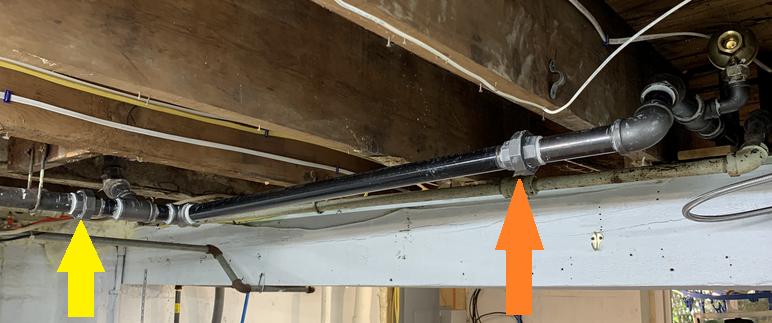

    separated union at runout. No water . Took elbow off end of main. Tan scope camera 8’ down main, no water . Took vent off and ran scope inside that section. No water.
    The end I of the main is 1.25. Somewhere from the boiler to that point it reduces to 1.25 Wherever that is is covered in insulation and I can’t see it unless I pull insulation off.
    edited December 2025
    but water comes out when you open that ball valve teed past the vents?
    109A_5 Posts: 4,761

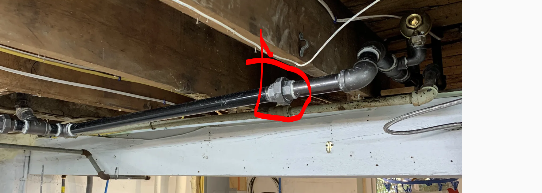

    Which union did you open up, Orange or Yellow ? If you had significant water coming out at the valve near the vent and there was no water at the Orange arrow, that seems odd, unless it drains away slowly over time.
    109A_5 Posts: 4,761

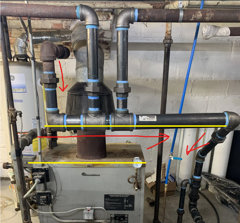

    Which way does this pipe pitch ?
  • JoshP
    JoshP Posts: 133
    I split the orange union and took off the 90 elbow off end of main (over by the yellow one). I ran my scope camera 8 feet into the main and didn’t see any water.

    I have that leg with the main vent pitched back to the vent / main

    That is correct. I can hear the water in the main there just before and just after the vent. If I pull the trap cap off at the radiator you can see it spitting/pushing the water through during the heat cycle . If I open the valve and let it push the water out it’s fine and works as should. I’ve used my scope camera and pushed it 8 feet in the end of the main and see no water. At least not there.
    wait, let me get this clear. the water comes out if you open the valve after the cycle is over, or does it only come out during the cycle?
    109A_5 Posts: 4,761
    So its like this ? Is there a rag or something in the pipe between the Green and Red arrows ?
  • JoshP
    JoshP Posts: 133
    Water spits out during heat cycle. Nothing comes out when open after it shuts off.

    is there a drip connected to that main anywhere? the water line in that boiler looks really low so there might be something that was below the water line with the old boiler that isn't now.

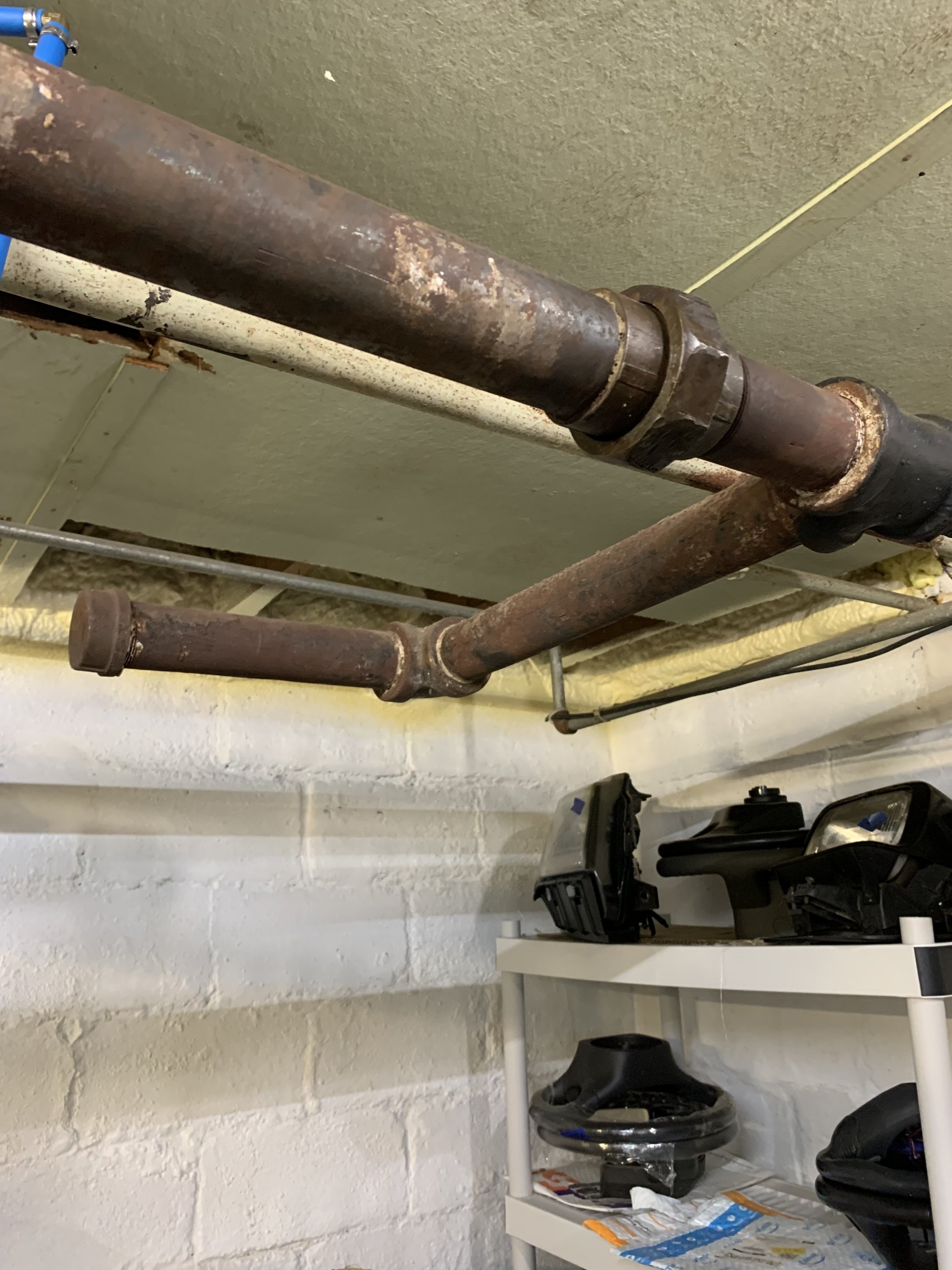

    Regarding piping there is a tee in the main near the boiler with a dead end section of 2” pipe . It’s about 2 feet in total length. Maybe part of an old header?
    if it is a capped pipe and it doesn't connect to something like a return, the pipe itself isn't a problem but how is the header arranged, can any condensate that gets in it drain somewhere?

    Maybe the wrong pipe is being blamed. 2 pipe systems often vent the air from radiators through the return pipes (dry return). If the return pipe is not pitched correctly and the water puddles blocking or reducing the air flow the steam flow into the radiator will suffer. I kind of wonder about the pipe behind the new pipe in the picture, maybe it's just the camera angle or the pipes are actually not parallel. It looks lower on the Right end.
    Are there other vents near the boiler ? How are the rest of the radiators vented ?
    it’s a capped dead end leg. Possibly for the old coal boiler. If water drains back into it , it can’t drain out.
    seems like my problem described. But changing header didn’t help much. It helped but not solve it. So what am I missing ?
