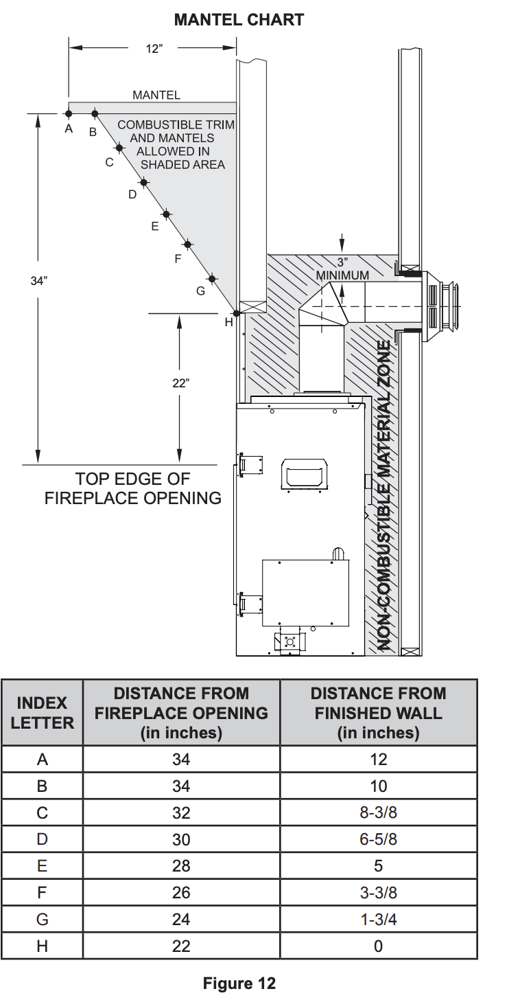

    See the vent directly behind the fireplace in this installation illustrtion?
    Agree with @mattmia2 — if this is a reasonably modern house — concrete foundations — that much separation of a masonry chimney from the firebox indicates some real foundation problems (note that in a much older house, it doesn't). To be safe, the chimney — and firebox — will need to be taken down and rebuilt on a safe foundation. You ask pricing — we don't do pricing here, but it will be into the inexpensive new car range…
