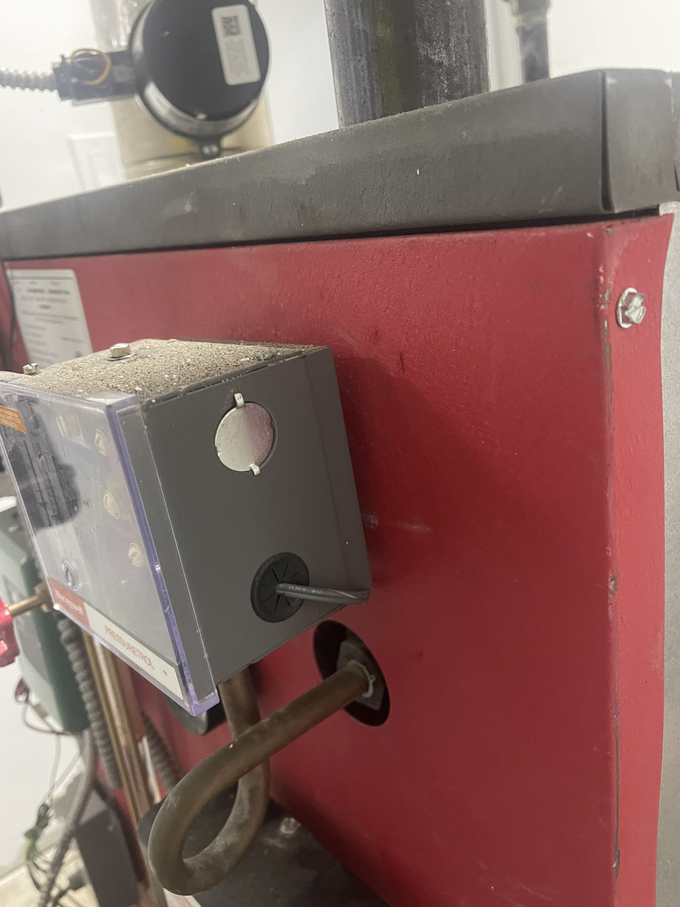

    Make sure the pigtail is clean.

    I’m not sure how I can check whether the pigtail is clear from the pressurepetrol.

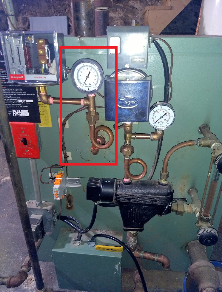

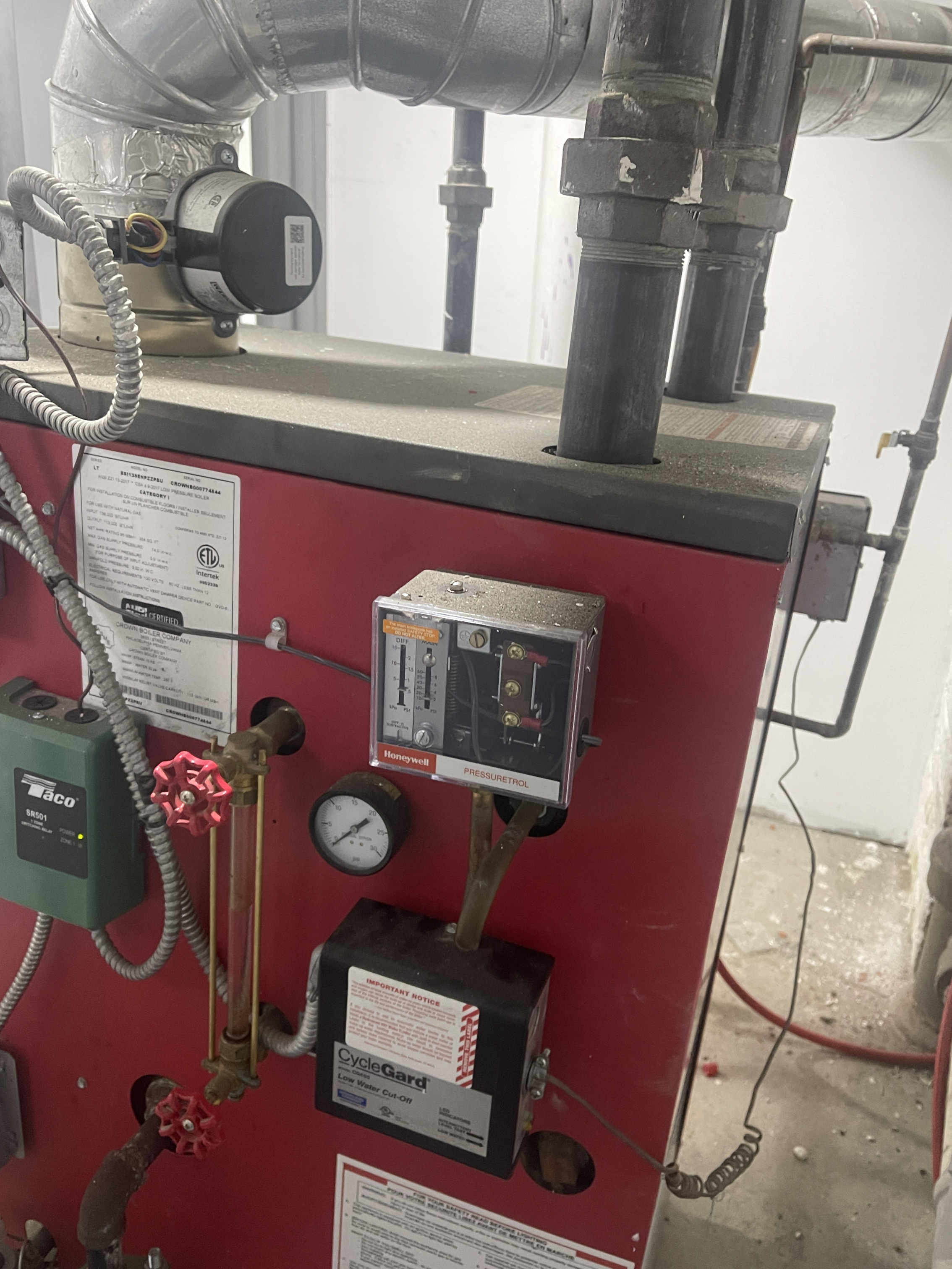

    lots of ''steam pros'' have gotten it wrong on other threads here, let's see what you have, post pictures,
    you shouldn't be adding enough water to change dark dirty water to clear, things are wrong there, either leakage, or leakage, and all the fresh water is not good for boiler, and contributing to leakage,
    let's see a picture of the boiler, floor to ceiling, showing the pipes coming out, floor to ceiling,

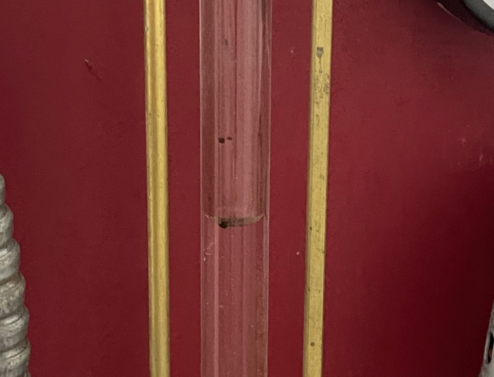

    let's see the sight glass and the dirty water, and the pressure gage, and the pressure control settings,

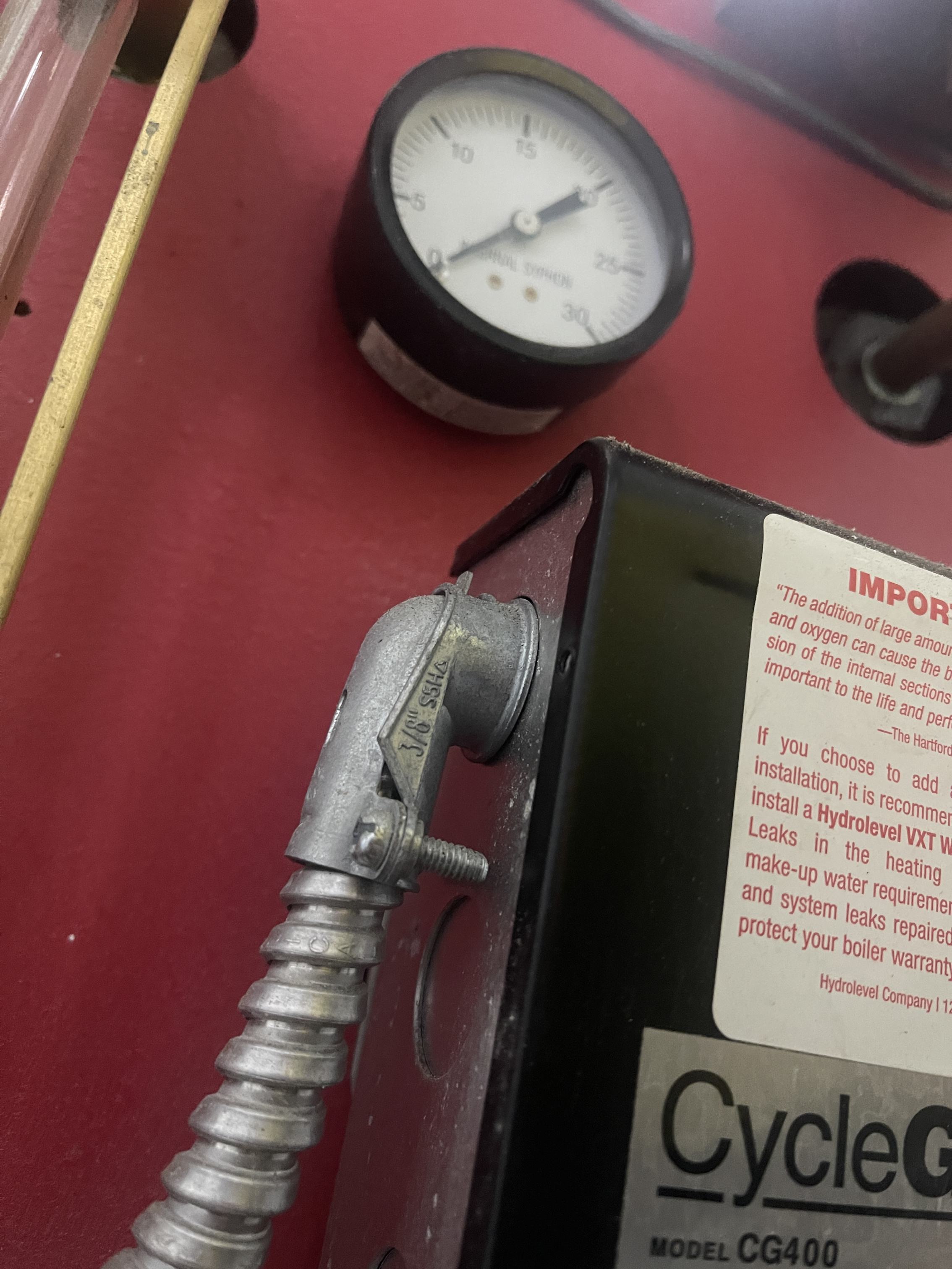

  • Hey Everyone, thanks for all the questions. Here is a link to a Google Drive containing everything that could help you. I have named the pictures to make it easier to identify what you're looking at. I have also included a pre-renovation folder so you get a broader sense of the piping before we cover it up. Note, there are videos in the pre-renovation folder about the hissing main vent and the pipes rattling. Those have been largely fixed; the main vent has a Maid o Mist #1. The pipe banging still occurs but not as much as the video shows, it still happens but it happens here and there.
    The oil-to-gas conversion happened, I would say, more than a year ago. This boiler is relatively new. The sight glass currently shows clear water, as I believe the water was fed to the boiler when it was low on water, but I can't confirm this. What I do know is that when it is running, the water is usually brown or darker in the sightglass, and it's usually 1/4 of the way when it is running, jumping up and down.

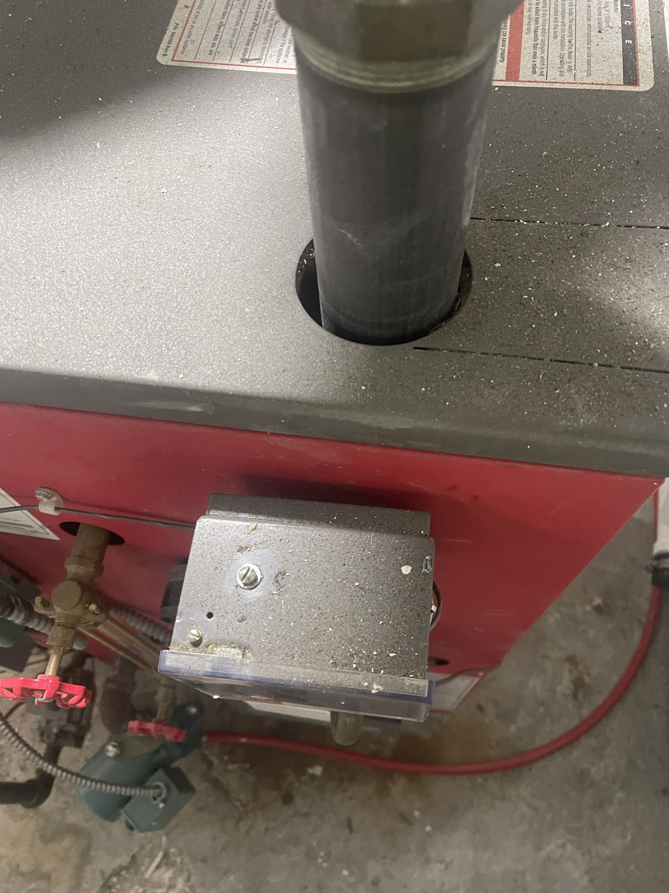

    The near boiler piping looks about right. Was it skimmed? This looks like at least some oil on top of the boiler water. Does it have more say half an hour after a cycle ends?

    The boiler was skimmed after it was installed. The water is usually brown after the cycle ends. It's clear right now since I believe the water was fed to the boiler when it was low but I can't confirm
    How many times was it skimmed? It takes a few times a few days to weeks apart to get all of the oil out.

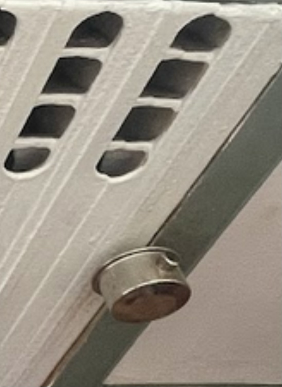

  • I uploaded a new video to the drive. It’s unlabeled for now. But I think I can see steam firing downward. You will also see water droplets falling.

    Replace that vent and check the threads in the radiator, it appears to be leaking at the bottom, or at the threads. Also check the pressure of your system when it is running like this.
  • when it’s running like this, usually between 0-5. The radiator was making a bunch of noise. I’ll replace the vent tomorrow, a Gorton #5

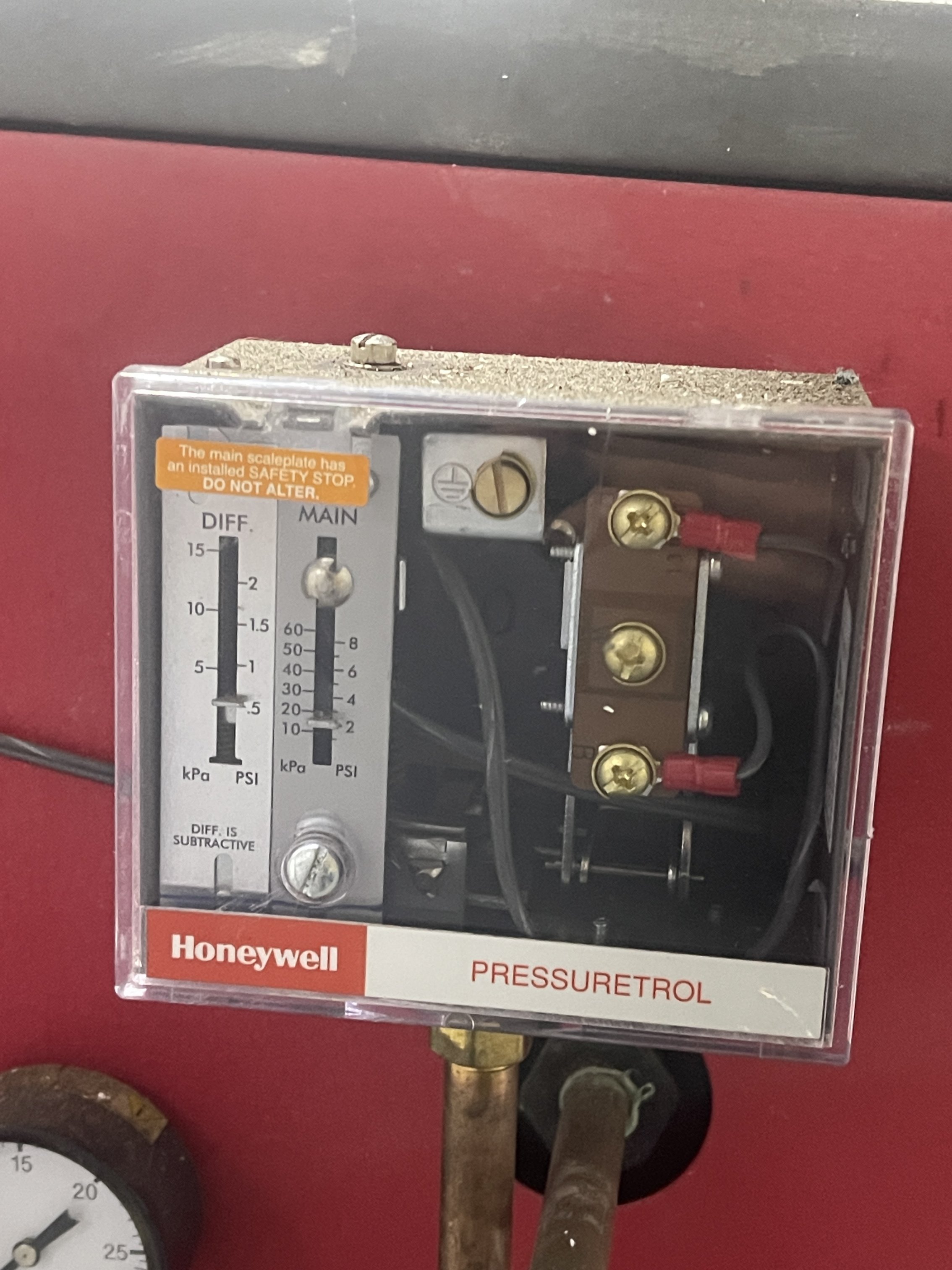

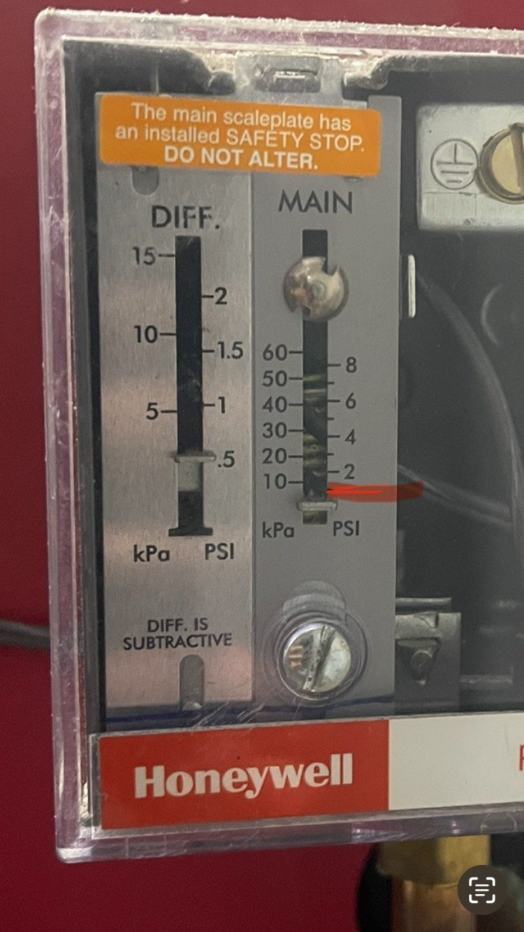

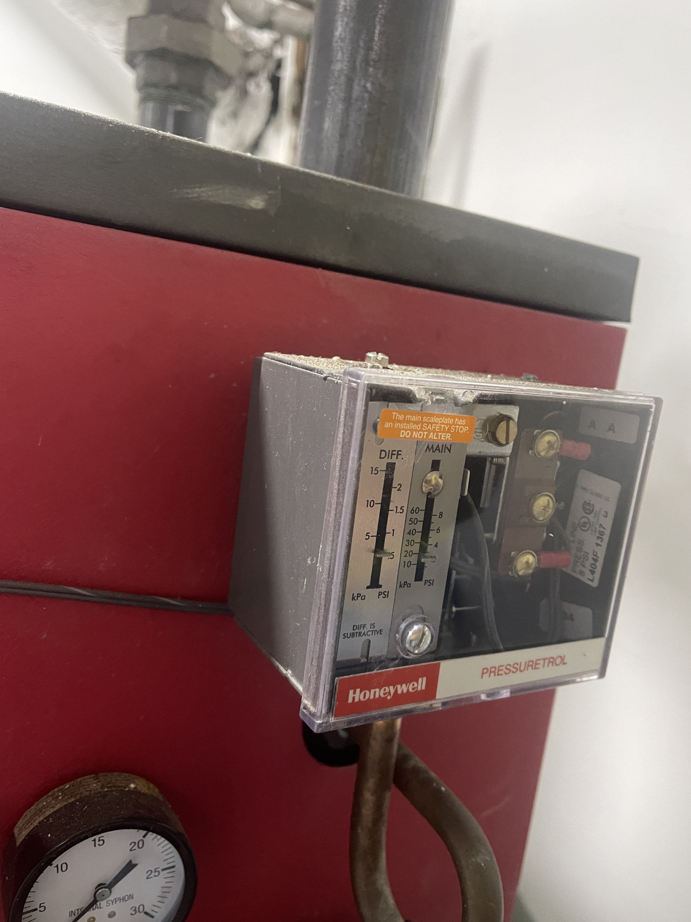

  • main is already at 0.5 with diff at 1 unless I’m wrong, there is a pic of the settings in the drive

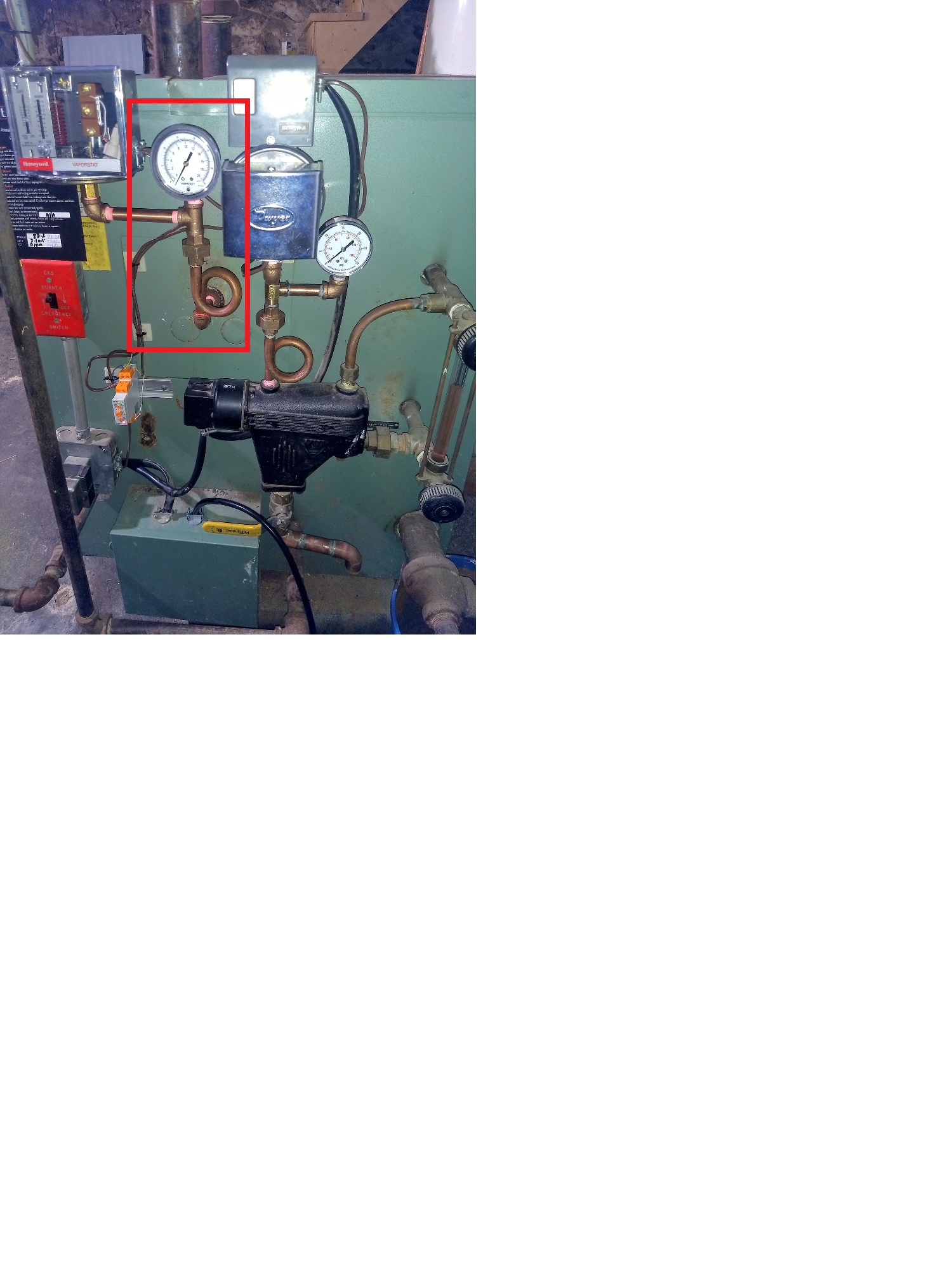

    You shouldn’t set it that though on this model. It goes finicky once you set it below 2. Try putting it where I marked the red line
    ethicalpaul Posts: 9,076
    Fair enough, but you reported it goes up to 5psi so something is amiss. @DanielDAY 's suggestion in the above post is worth trying.

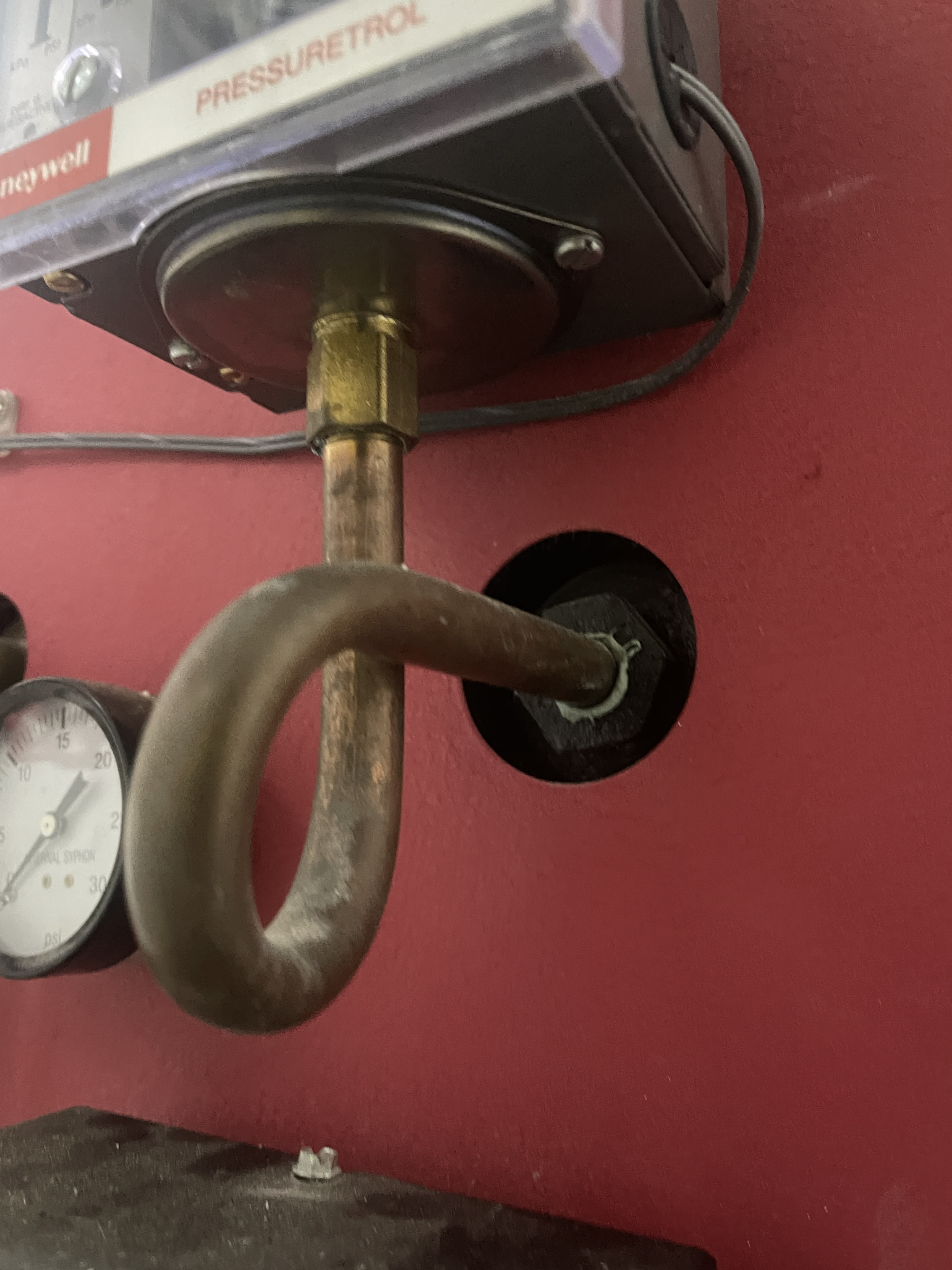

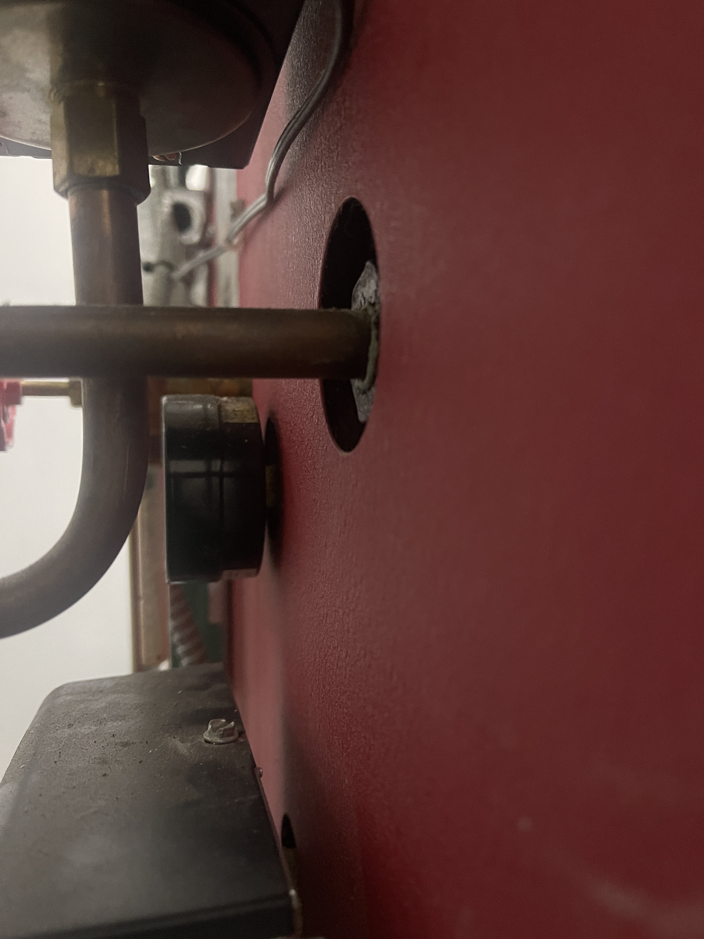

    Might be worth cleaning out the pig tail if that hasn't been done already.

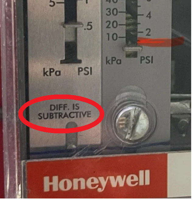

    109A_5 Posts: 4,759
    With a PA404A the Pressuretrol's differential is additive, with this model it is subtractive.
    109A_5 Posts: 4,759
    For the popular PA404A the typical minimum settings are Cut in = 0.5, Diff = 1 for a Cut out of 1.5.
    With that pressuretrol for similar Cut in and Cut out pressures, Main = 1.5, Diff = 1. If it works reliably at lower pressures that may be better.
    Your 5 PSIG is concerning. With your situation you may have an oversized boiler and/or other issues, my house heats fine at no more than 0.07 PSIG (2 inches of Water Column).
  • found out that the vent I replaced with the Gorton 5 that was leaking water was literally cracked at the bottom. No idea how that even happened. I’ll check what the pressure is like with the new vent

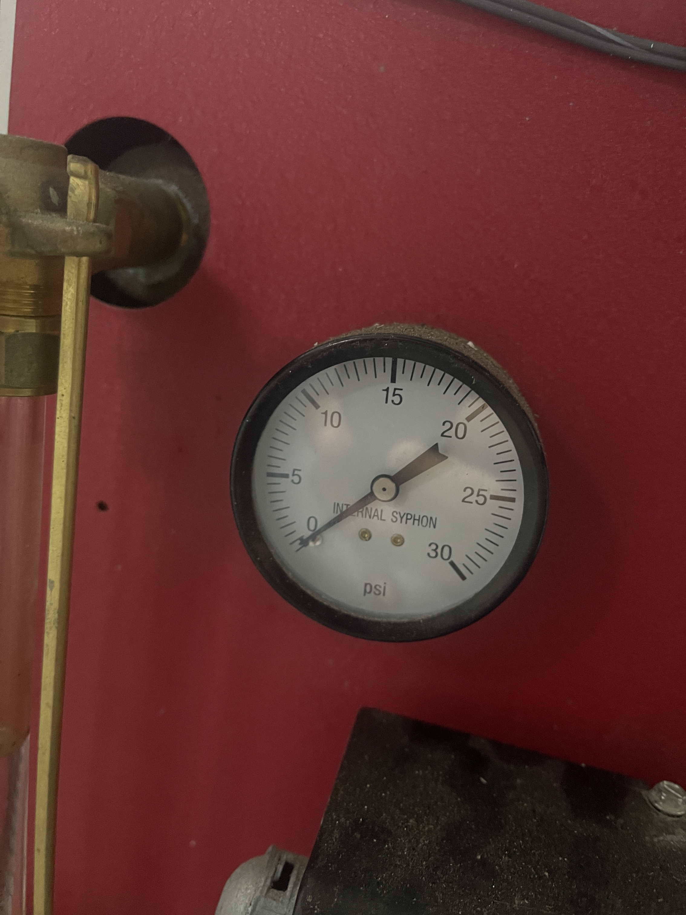

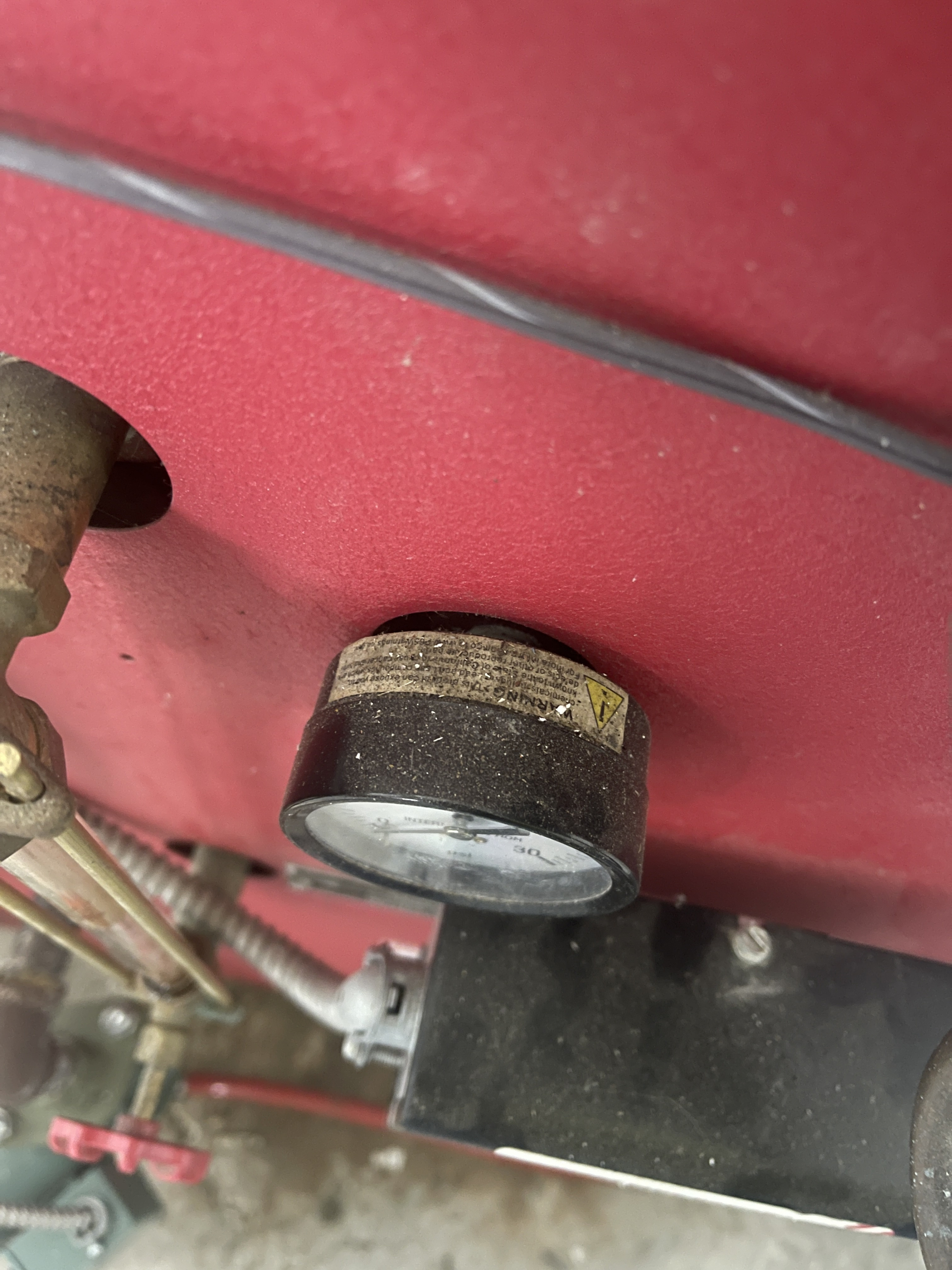

  • I uploaded new pictures of the water level and pressure while the boiler was running. I labeled the pictures for easier use. The pressure is 2 ticks below 5. The radiator I replaced the valve with a Gorton 5 stopped hissing but now gurgles here and there. It stops when the boiler stops and starts gurgling again when it starts. Now, the other living room radiator is hissing (not hissing per se, more like a burning noise). That noise is coming from the radiator itself, not the air valve. Not sure what to do now

    Why is the pressure so high, radiation to boiler mismatch, radiator EDR vs boiler Square Feet rating. Is the gauge accurate ? Does the pressuretrol work ? Pigtail and path back into the boiler clear of any obstructions.
