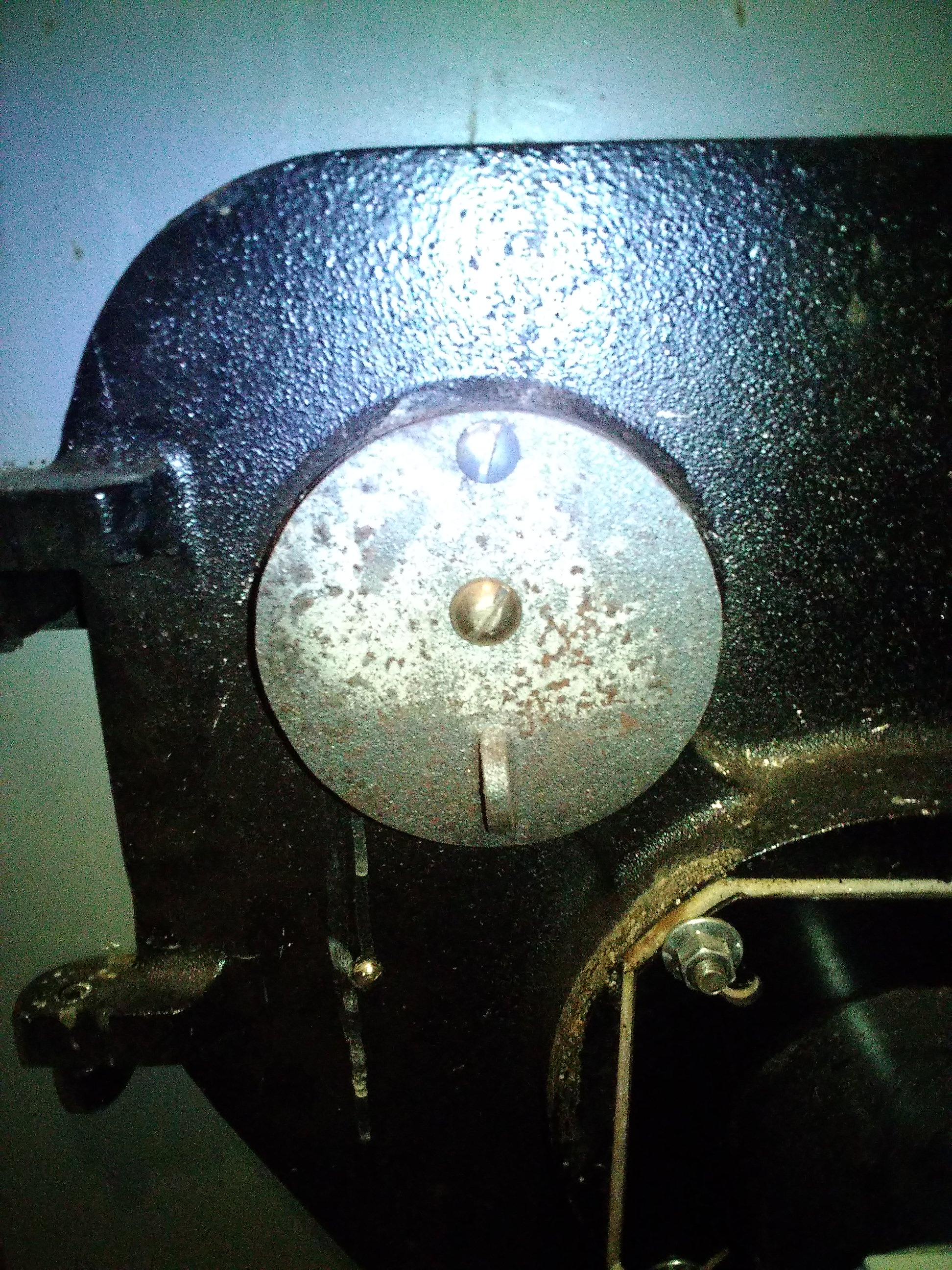

Hello i have white on my peerless boiler cover no where else just on the cast iron cover. Is this a problem? The original black has been i guess burned off during the years is this normal? I just had a clean and tune and it passed with flying colors and the draft was excellent. Just curious thank you. Also i have 2 screws in the boiler cover should these be loose or should i tighten them? Thanks to all for their time i know these might be simplistic questions but im not a HVAC guy.

    If its baked off because its a hot spot, then its far from normal. Borrow a phone for pics and upload to whatever your using.
    Is it gas? Is it oil? Is it rollout? Is it impingement? Dirty burner tube? Postive over fire draft? Old and worn? Let's see.

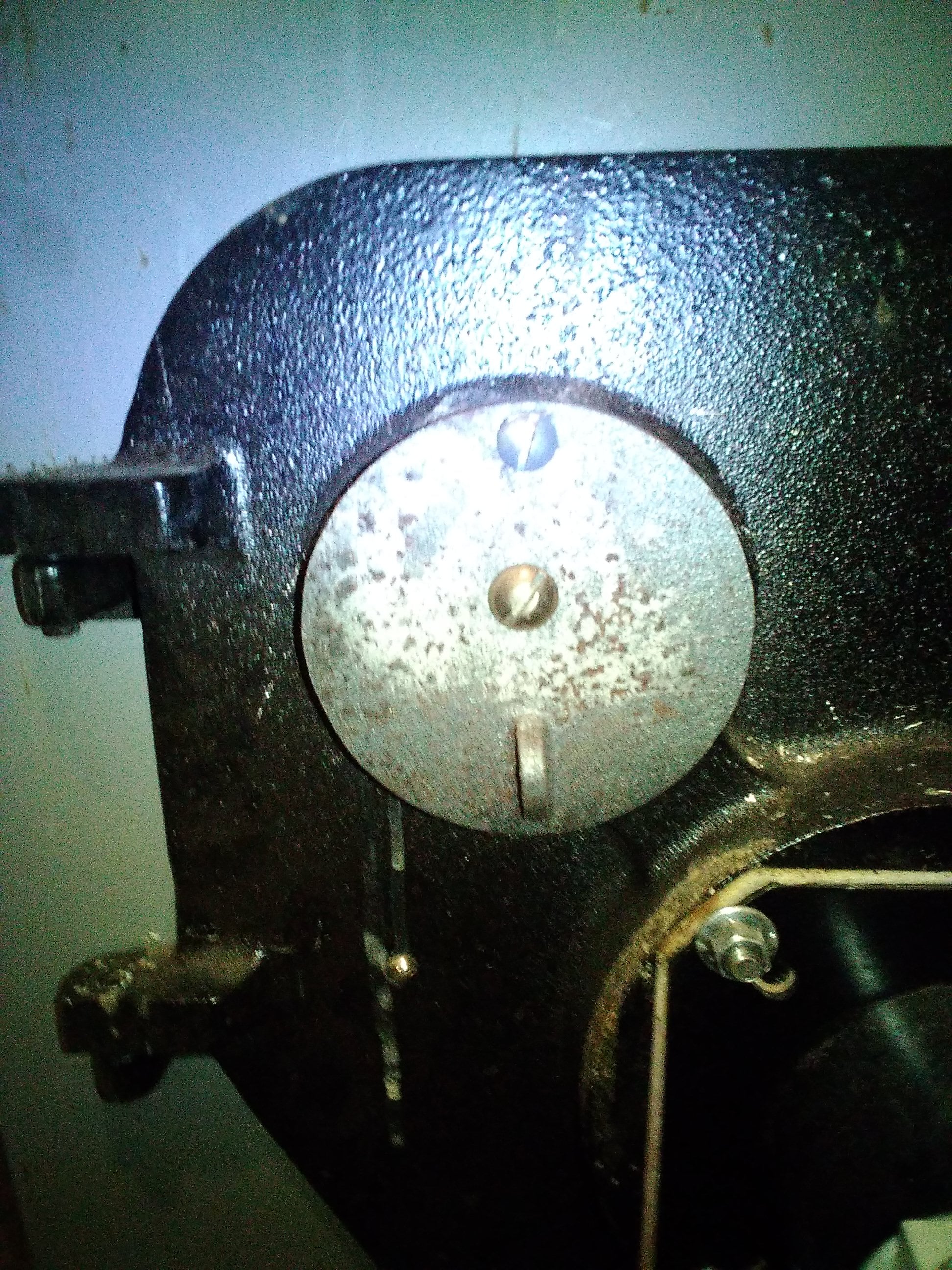

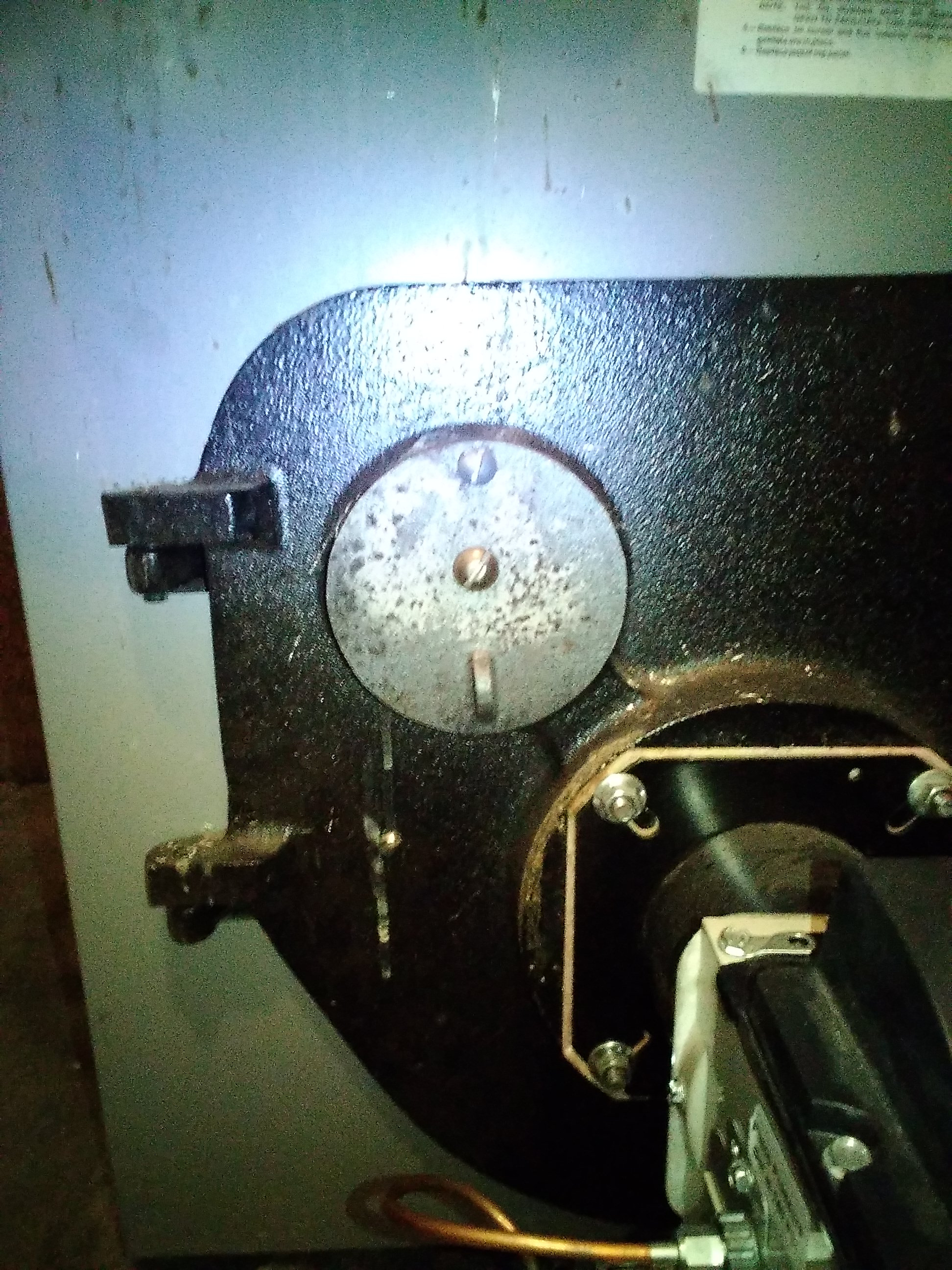

    Can you move back a few inches.

    Best i could do had to give my friends phone back and he left. He worked in the past on boilers and he said its ok but i just wanted some other opinions on it thanks.
    pecmsg Posts: 7,634
    I don't see what your describing.
  • Ok thanks it was black when new now most of the coating has been burned off.
    HVACNUT Posts: 7,784
    That's the inspection door. There's no insulation there so it feels the heat. Its fine. Just make sure the door is tight.

    Yes did people think i was talking about the sheet metal covers? Mine is made of cast iron. Im talking about the black cast iron around the inspection door whats that called? Also both screws in the inspection door they have to be tight but not too tight right? And the top screw on the door keeps it on but what purpose does the second middle screw serve on the inspection door? No answers on this?
  • Does anyone know the answer to the questions above?
    The middle screw gets removed to check over fire draft. Then the screw gets screwed back tight.
