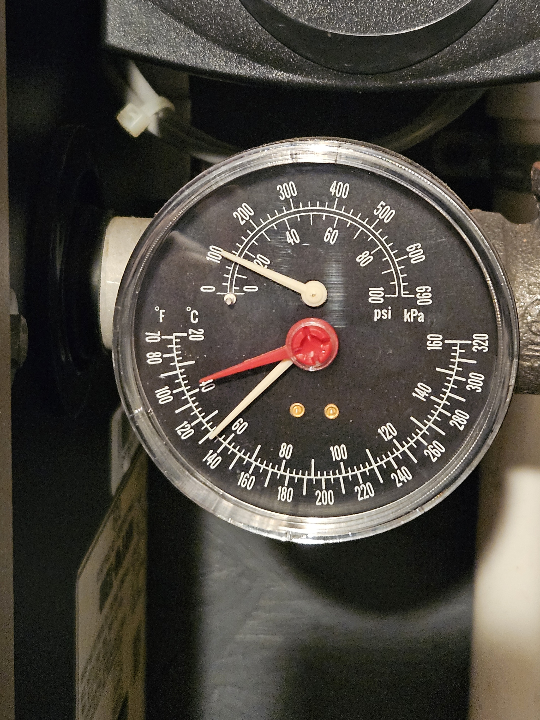

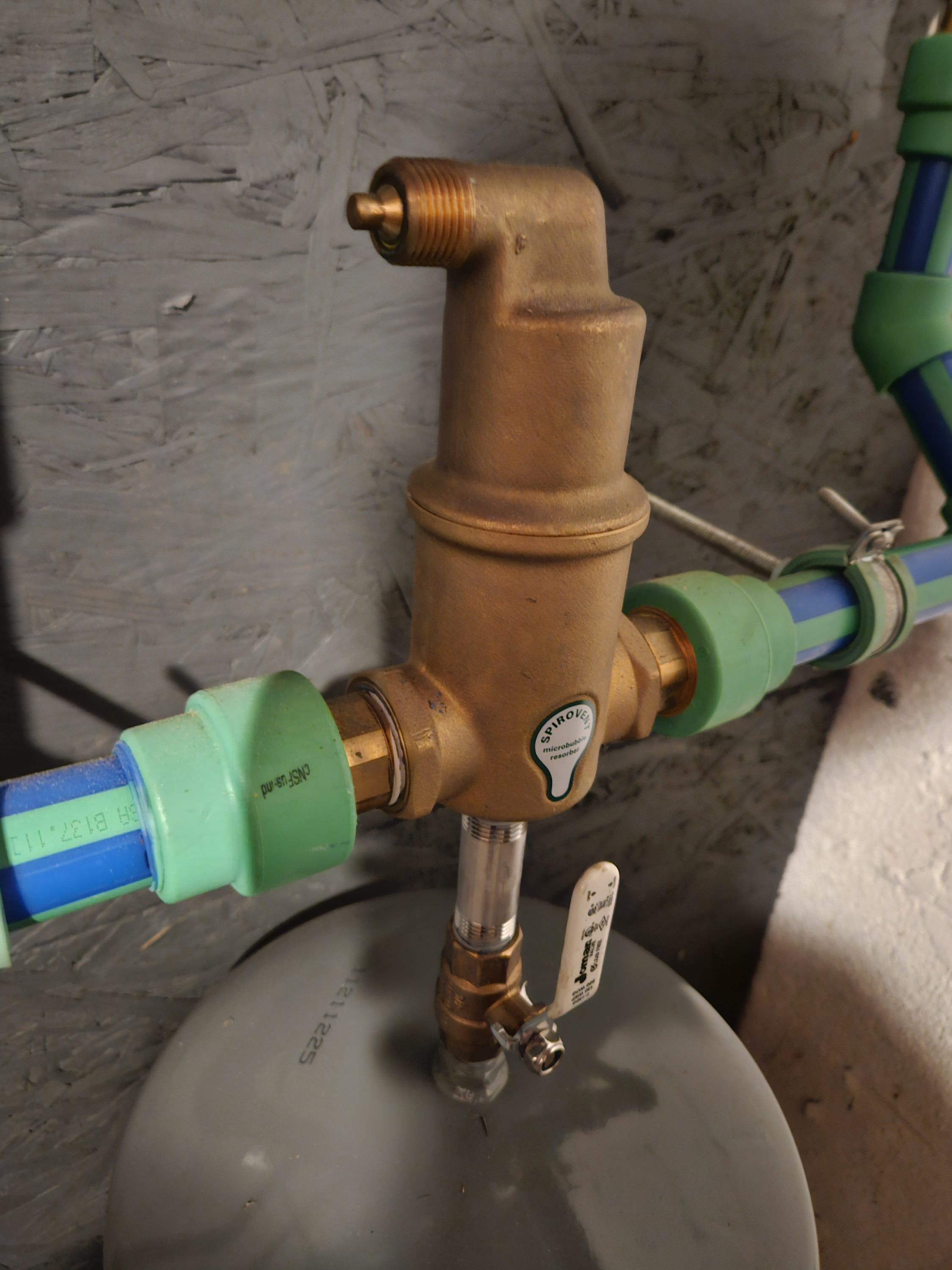

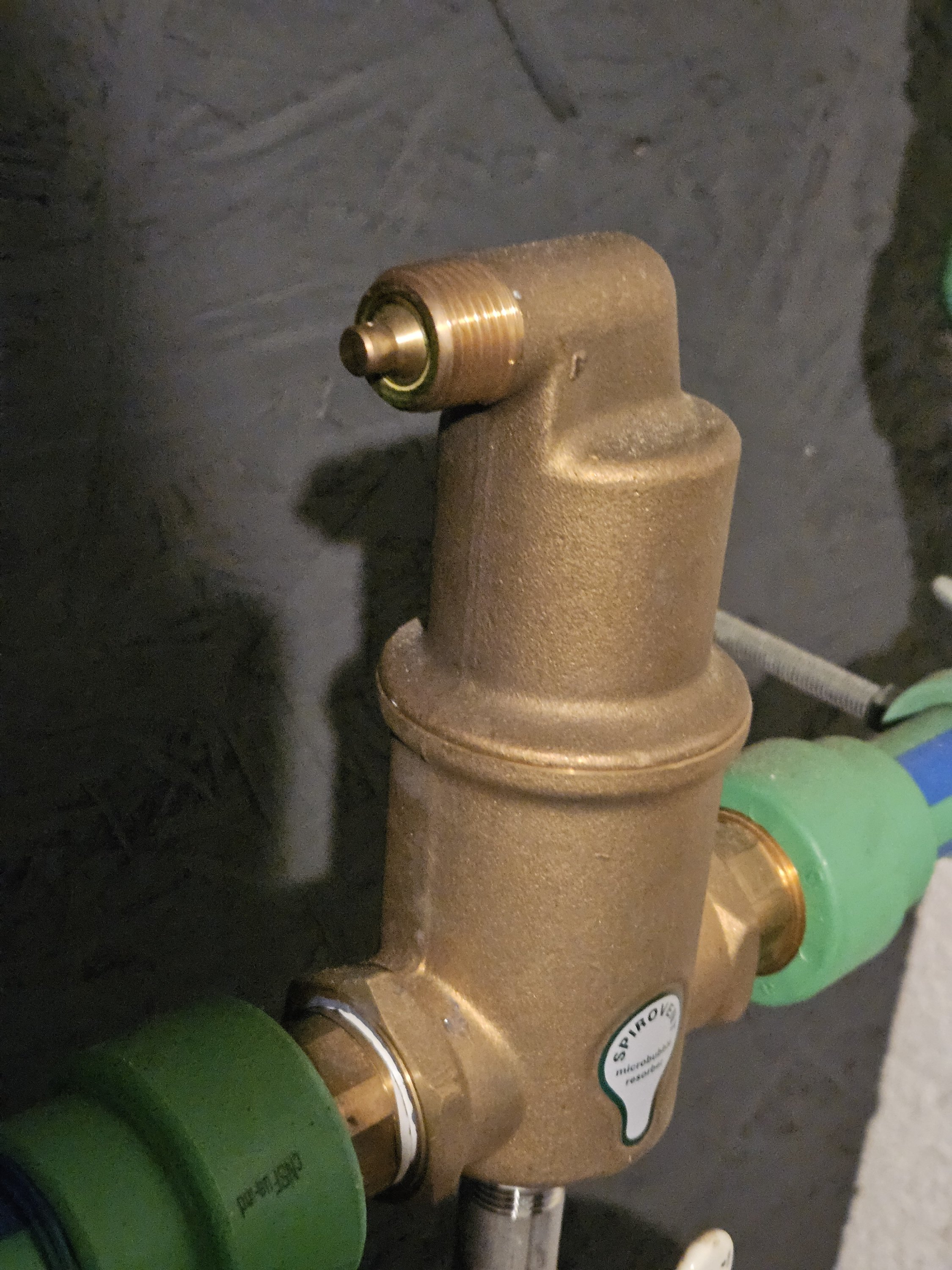

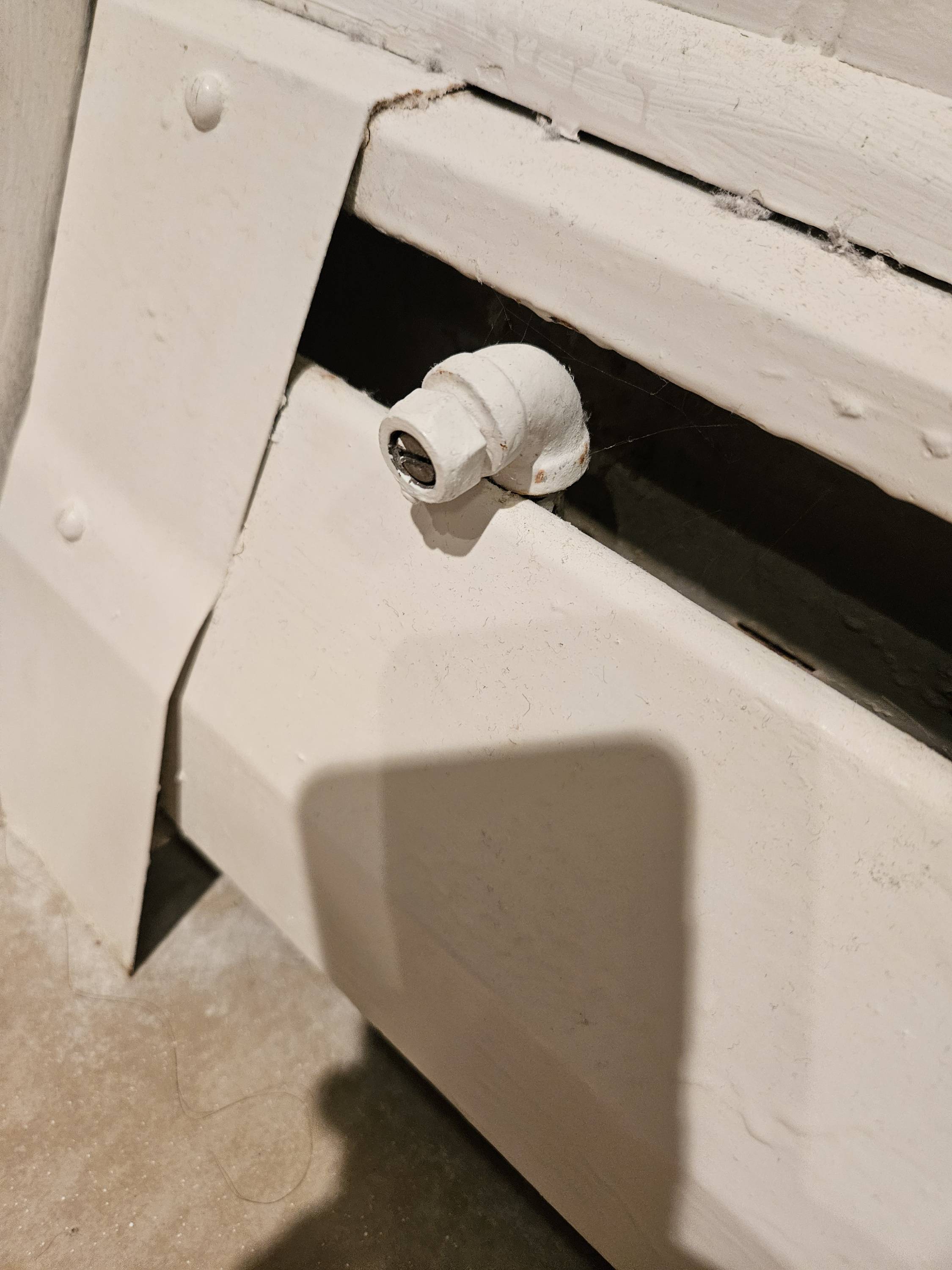

Hi everyone. I have a 10 year old Weil McClain ECO70 hydronic heating system, with one closed loop and a manual water feed. After having the system serviced over the summer, a sound of water trickling through the baseboards on the upper floor of my house has developed. I thing this might be due to trapped air in the system, but I don't know. I thought the brass valve on the top of my expansion tank (picture attached) was supposed to automatically vent excess air... but that doesn't seem to be happening.

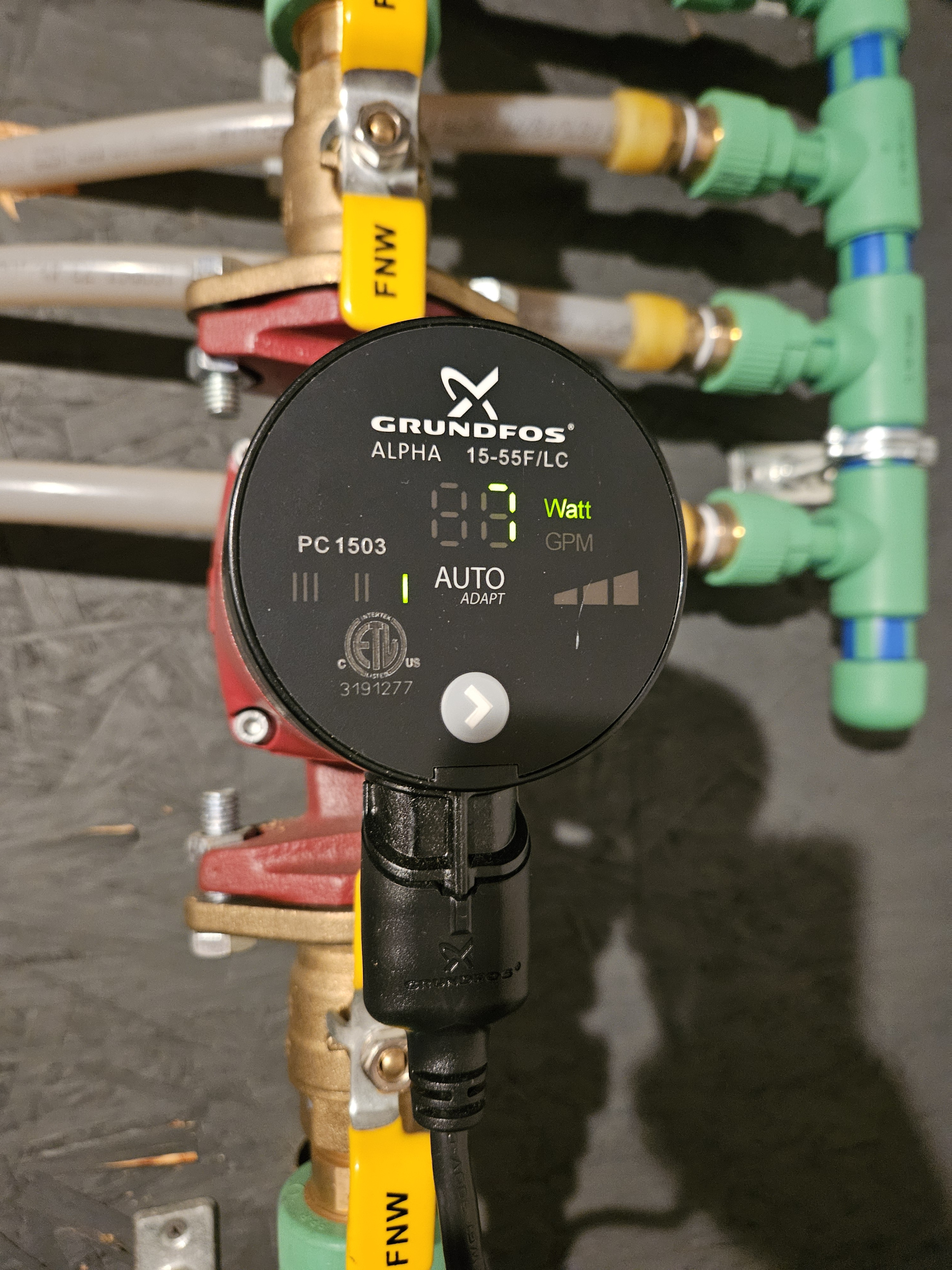

Also, the technician set the circulator pump to level 1, not 2 (where i think it was before) and im wondering if that is a factor. Pressure is abiut 14 or 15 psi when not running, 18 or 19 when running. Any suggestions? Should I open a bleeder valve on the 2nd floor?
Thanks for any help or suggestions you can offer!!
    Pressure should be adequate — but opening a bleeder on the second floor to see if any air came out wouldn't be a bad idea at all.
  • Thanks for the advice. If air doesn't come out, any suggestions? Can I use that brass vent on top of the expansion tank somehow?
    hot_rod Posts: 28,705
    I would bump the pump to speed 3 for a hour or so. The newest Alphas have an air removal function "self venting" built in, basically taking the circ to full speed for a period of time.
    If you hear water trickling it must be moving, but not fast enough, above 2 fps to bring it down to the Spiro.
    Pretty clean looking Spiro, usually you see some staining if they have discharged air. Could be the mfloat or valve is stuck.
    That would take a disassembly to check.
    No harm in opening that bleeder also, take a sponge with you :)

    If you gauge moves from 14- 19 that would indicate the gauge is working, a good thing. A bigger pic would show if a fill valve is connected somewhere else.

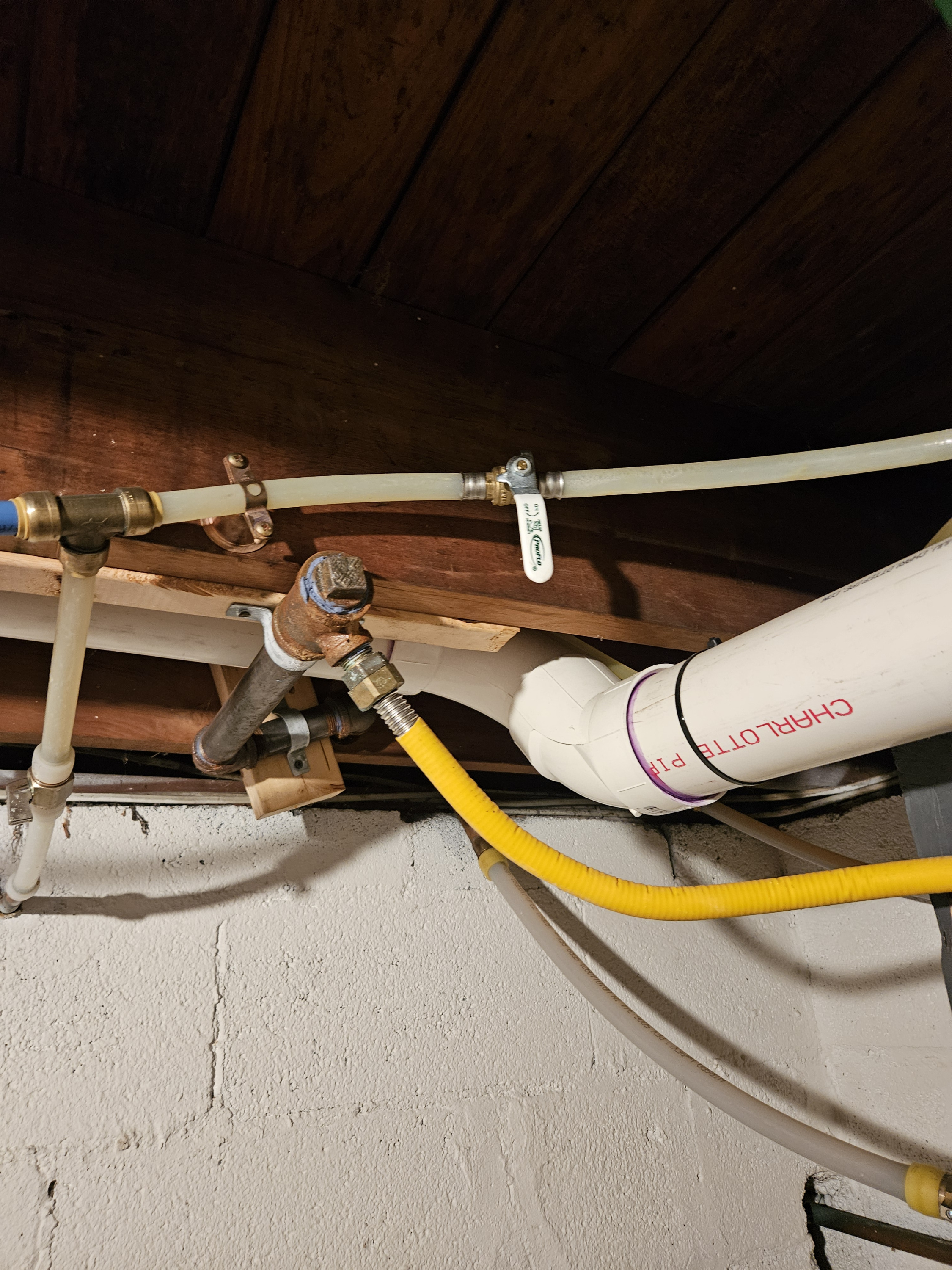

  • Thanks for the replies. The static pressure is about 15 psi. So, should I bleed the 2nd floor valve and then manually add water to return static pressure to 15? Or, increase the circulator pump speed so that the Spiro is more likely to auto vent the air? ( also, as a side point, when the water heats up closer to 170 degrees, it seems like the trickling water sound diminishes). Manual fill valve is pictured below.

    Do both. If you bleed a tiny amount out, no air for example at that bleeder, you probably do not need to add fill water. If you start bleeding a gallon or more to get all air purged out, then you may see a pressure drop, so add some fill.
    The air, if in solution, may not all come out of that small bleeder. That is a "high point" bleeder, usually only needed at start up to catch air that rises to the high points in the system during a long off period, over the summer for example.
    The Spiro really should clear 90% of ALL air within hours of all zones circulating.

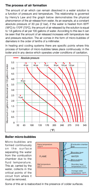

    Can you hear the air going across the Spiro? You shouldn't! That would indicate it is not removing the air. It does take a while to gather a big bubble in the Spiro, allowing the float to drop, then air should hiss for a few seconds or longer.
    Another trick is to boost the boiler temperature for a few hours. The hotter the water the more it give up air.
    It's about Henry Law, friends call him Hank :)

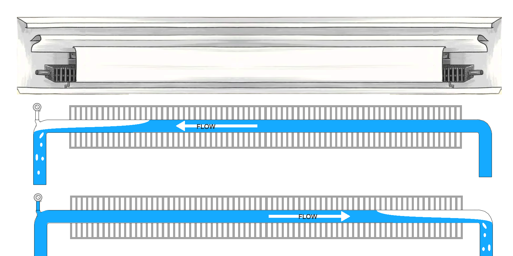

  • Usually the coin air vent at the top of the system will work if the pump is operating or if the pump is off.  So you can try it either way.  There are some instances where operating the pump is better and other instances where operating the pump is problematic.  Every system is different.  Example below:

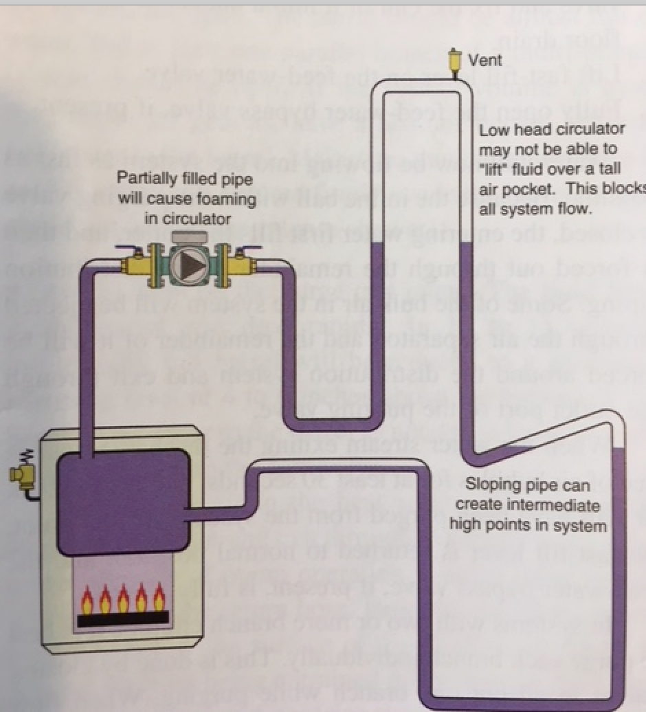

    The small air pocket could be elsewhere in the system, copper tube transmits noise very well
