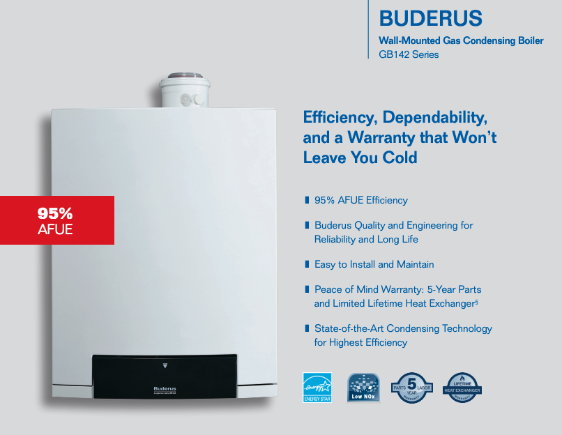

    @hot_rod I think it is a combi mod con though they don't describe what is wrong with it specifically.
    hot_rod Posts: 28,708
    Was the GB offered in a combi version? I've only seen the boiler version.
    I assumed it was a combi because they mentioned dhw but I didn't dig that deep. Anything you replace it will will have significant cost in fittings and labor.
    What is specifically wrong with it?
    Chances are the right guy could get it running. Sounds like the "TECH" that looked at it couldn't be bothered

    When the inspection mirror melts, that would tell me the HX has a nice hole in it. There's no repair for that because there's no more GB-142.
