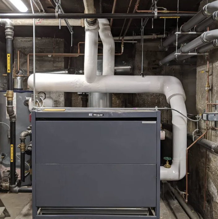

I have pipes in the basement that need insulation. Can I use insulation such as this one:
https://www.homedepot.com/p/Master-Flow-60-sq-ft-R-8-Insulated-Duct-Wrap-INSWRP60R8/302000644
Of course, I will be wrapping this around the pipe and taping it.

    that's duct wrap. I would get pipe insulation rated. at least 1" (preferred)
    mattmia2 Member Posts: 17,760
    that could work but it would be difficult to install such that it is effective. proper fiberglass pipe insulation is fairly rigid so it won't compress just from wrapping around the pipe and maintains its thickness and therefore effectiveness. there are numerous places online where you can buy fiberglass pipe insulation.

    @coby, @mattmia2, thanks for your feedback. I was considering using duct wrap (the one I linked) instead of fiberglass pipe insulation because it is much cheaper. After looking into it further, it looks like duct wrap is not suitable for steam pipes, as the high temperatures (over 200 F) would likely exceed what the material can handle.
    edited November 2025
    It will look like S#** when you are done. This is the fiberglass pipe insulation you want to use. This will look much better. You need to know how to measure the outer diameter of the pipe and select the insulation thickness. If you measure correctly and order the proper insulated fittings the finished product can look like this.
    you can call this company for all the needed sizes and fittings.

    That’s a really nice-looking job, well done. In my case, the pipes are in the basement of a rental property that only I have access to, so appearance isn't really a concern. I have over 40 feet of piping to cover, and at over $10 per 3-foot section, the cost adds up quickly. Sadly, the previous owner, for whatever reason, didn't maintain the old insulation, and most of it is now falling apart.

    About 50% of the pipes are 3 inches, with the remainder being 2 and 4-inch pipes. Looking at what Home Depot carries, the price for 3-foot sections of insulation ranges from $10 to $20. Yes, this is very expansive, thus why I was looking for alternatives.

    First question: is your basement warmer than you want/need it? If not, forget the insulation. If you do decide you want your basement cooler, get it from this place. 1" is fine
    https://www.buyinsulationproductstore.com/Fiberglass-Pipe-Insulation-SSL-ASJ/?srsltid=AfmBOoprNX7wW9un24Ms79QOSKBL8PC6i5PeHSc6K5bxZT7UoG0HIPHc
    Precaud
    Agree with @ethicalpaul. I thought I included that link on my previous post. https://www.buyinsulationproductstore.com/Fiberglass-Pipe-Insulation-SSL-ASJ/ from this company is less than Home Depot. A lot less but you need to measure the pipe properly and select the proper size based on the outside diameter of the pipe.
