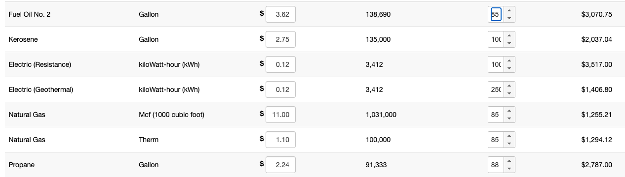

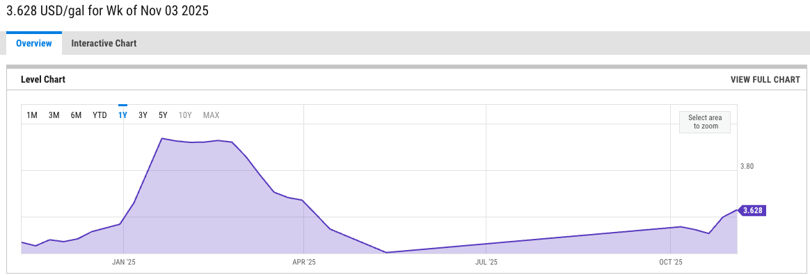

    hot_rod Member Posts: 28,079
    You really need to check pricing in your specific area. Current and historical data is available online for fuel costs.
    I'm seeing fuel oil at $3.62, going up, LP at $2.24.
    Plug those numbers into the calculator at www.coailpail and see what you get.
    Depending on heat emitters you could run 90% efficiency with LP for a portion of the year. Burner modulation on an LP boiler can save fuel also compared to a fixed output oil fired.
