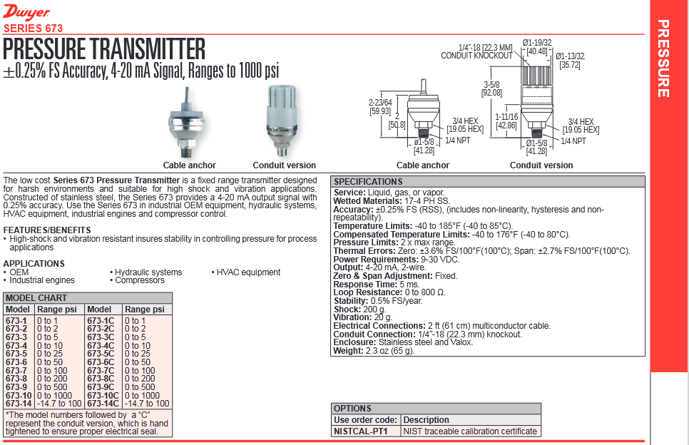

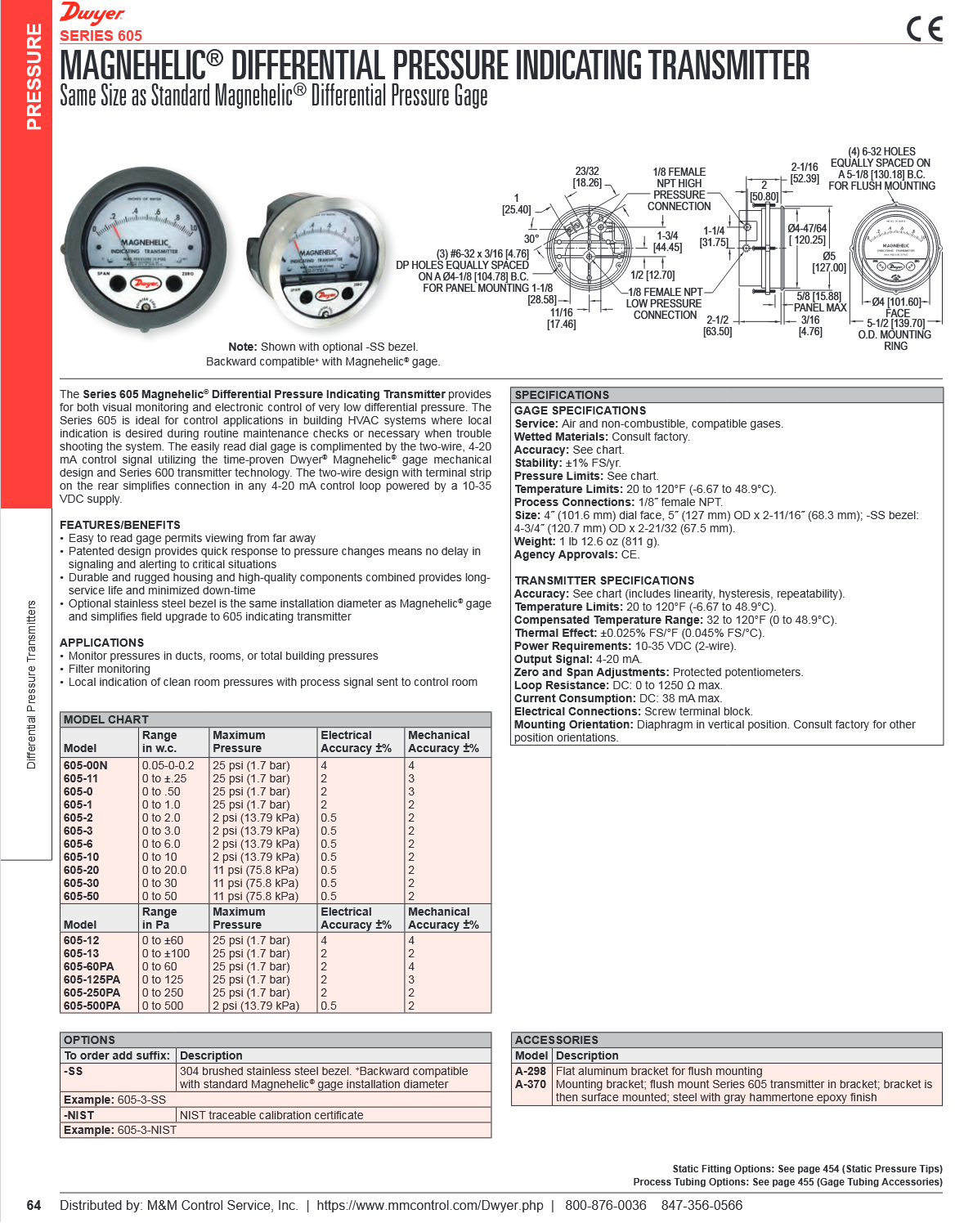

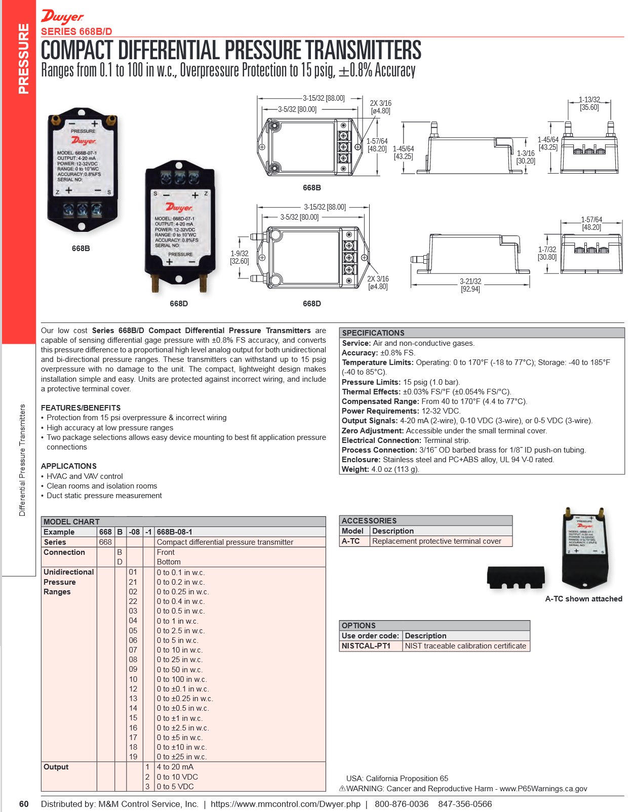

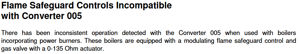

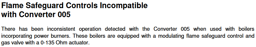

    What about a low pressure sensor transducer that has an 4-20mA output then connect it to a Tekmar 005 or an ACI DRN3.1 or DRN4 to convert it to the 0-135 Ohms control ? The ACI products look like they have relay isolation to the output resistor network.
    ACI DRN3.1 or DRN4:
    PWM/Analog/Floating Point to Resistance Output, 0 to 135 Ohm Resistance Network, Plastic Enclosure
    Tekmar 005:
    The 0 - 135 ohm Converter 005 is designed to convert a 4 - 20 mA modulating signal from a control to a 0 - 135 ohm resistance signal. It can be used in applications where a modulating boiler control is used to operate a boiler that requires a 0 - 135 ohm signal.

    FYI the ACI units on eBay that I looked at appeared not to have the resistor network installed.

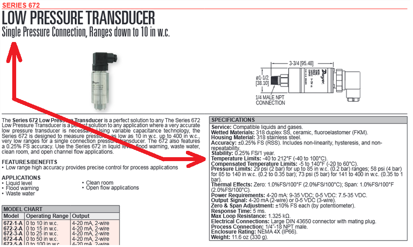

    1095A_5 had some good info, but I think the sensor might not like 210+ degrees.

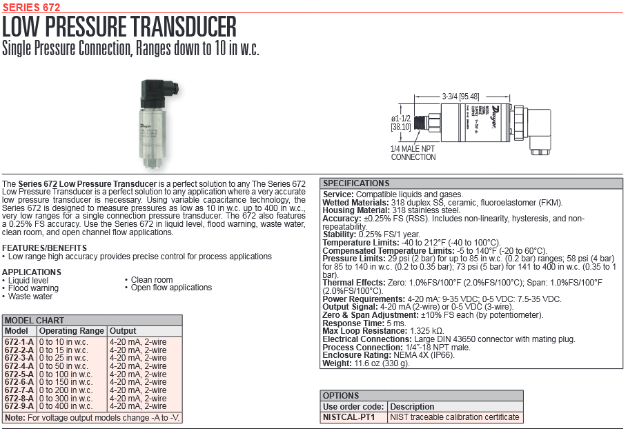

    " but I think the sensor might not like 210+ degrees. "
    The sensor is for pressure, not steam temperature. Why would it have to be exposed to 210+ degrees ??? Although the Series 672 tops out at 212F, why would you do it that way ?
    My Magnehelics are at room temperature.
    The beauty of 4-20mA is it is easy to measure and generate, you could connect a manual variable 4-20mA generator to find the sweet spot.
    " low range sensor maybe 0-5 since we still don’t know where the sweet spot for the building is. "
    0-5 what ??? PSI, inches of water column, Oz ? The sensors above have plenty of range, but you need to pick the correct one.

    So 0 to 5 Oz which would be 0 to 8.65 Inches of Water Column.
    Many of the low pressure sensors are rated in Inches of Water Column so it helps to think in Inches of Water Column instead of other units of measure.
