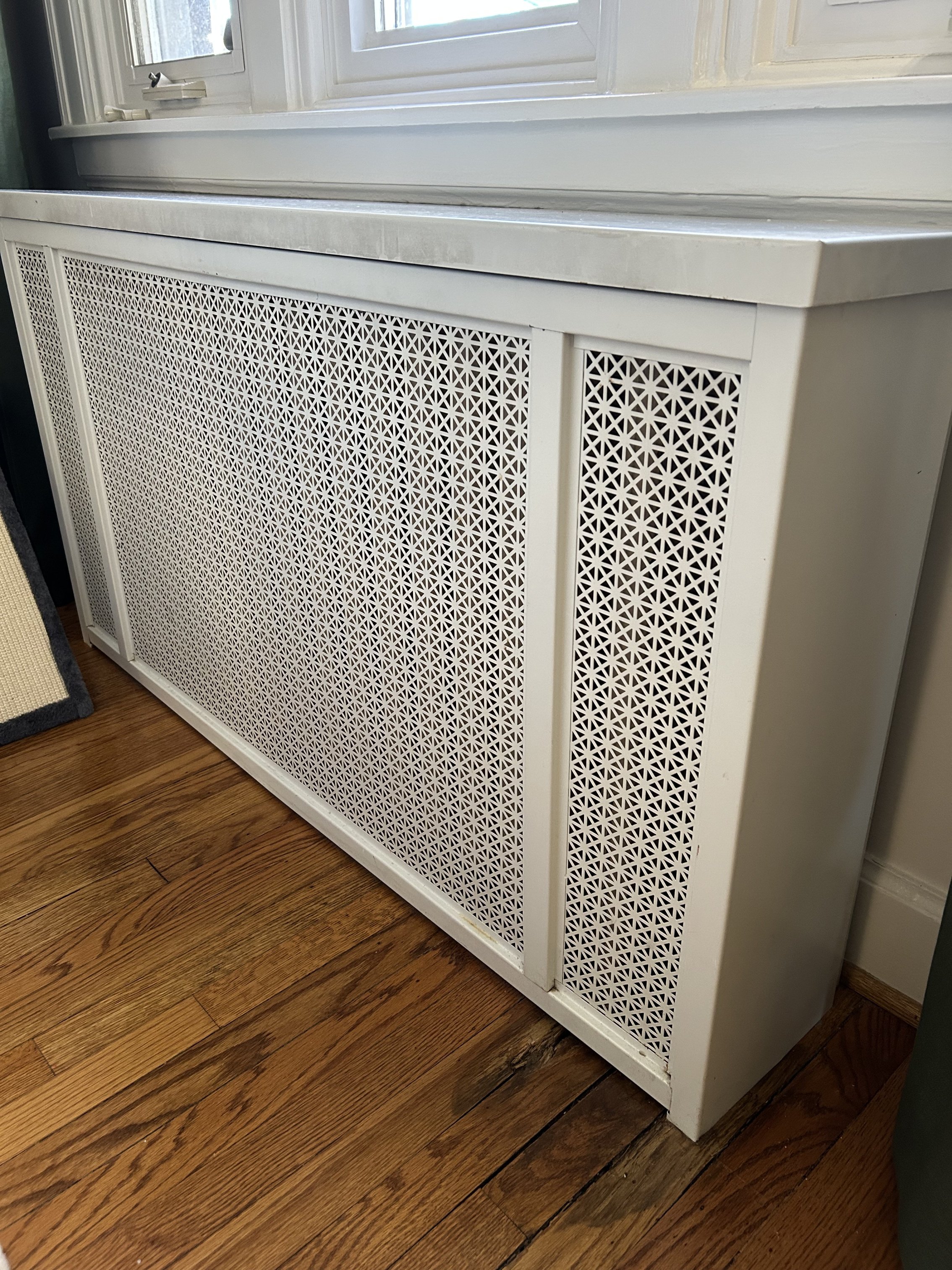

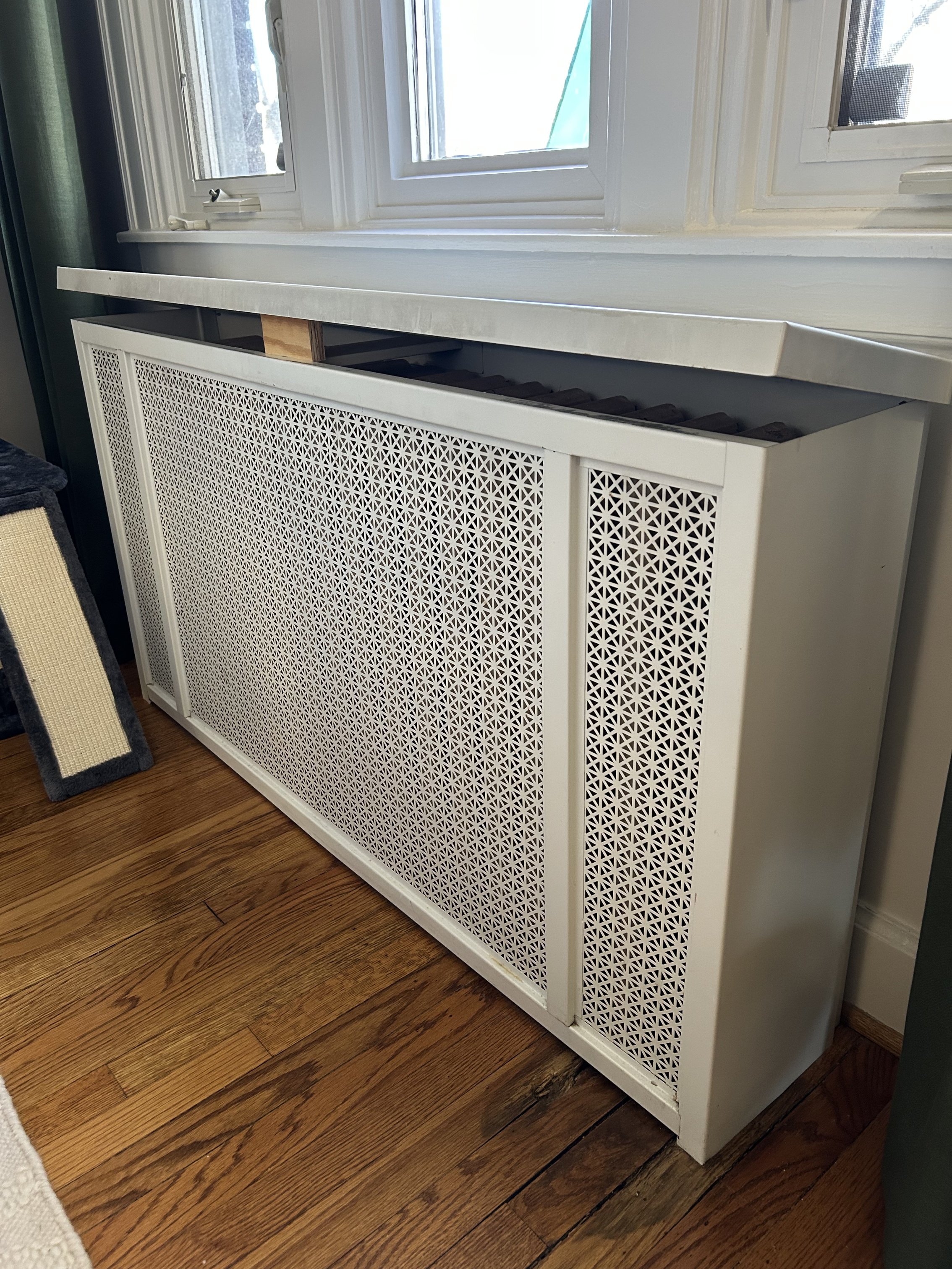

Does metal radiator cover affect performance? Absorbs heat or passes it along?

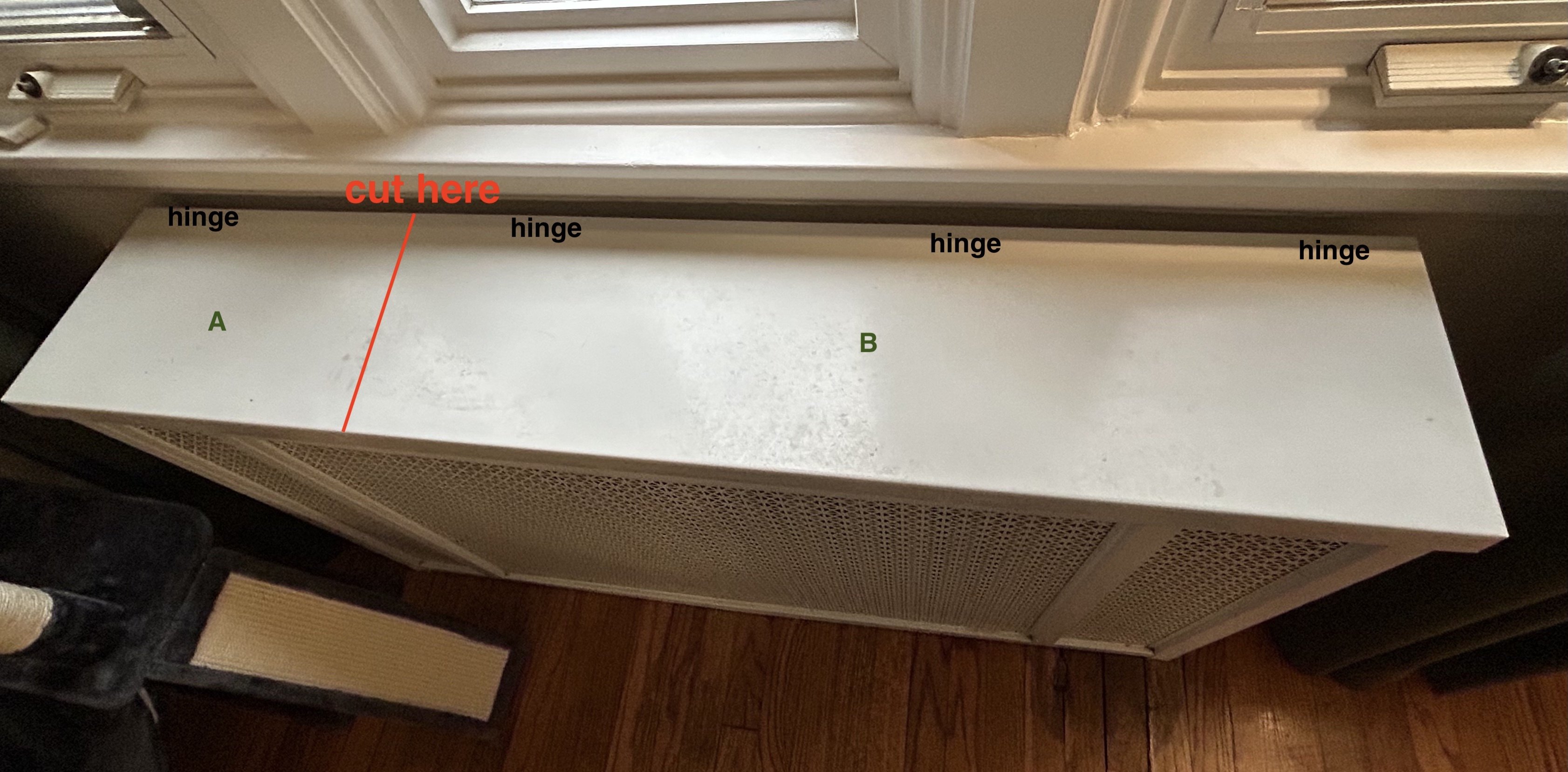

Metal case. Hinged top is open.
Does case absorb heat and just relay it to the room? Net zero impact?
Or does the metal case eat some of the heat?

    well it certainly blocks a portion of the radiant heat transfer. For convection, you need a slot at the bottom and top for the warmed air to pass out.
    Probably not as restrictive as draping a blanket over the radiator but un encumbered would give it the best opportunity to move its output, out😗
    I’m not sure it is being eaten? It just doesn’t make it into the room space.
    Good news, the next radiator down the line has more heat energy available.

    But the cover in the photo has a slot at the bottom and the top is hinged open.
    mattmia2 Member Posts: 17,905
    if the top is left open it probably doesn't affect the convective heat output but some of the radiant heat being reflected back to it by the enclosure will reduce the radiant heat output.

    I guess the cover is just like the radiator metal itself. Just another skin. Obviously, the heat gets thru the thick radiator metal

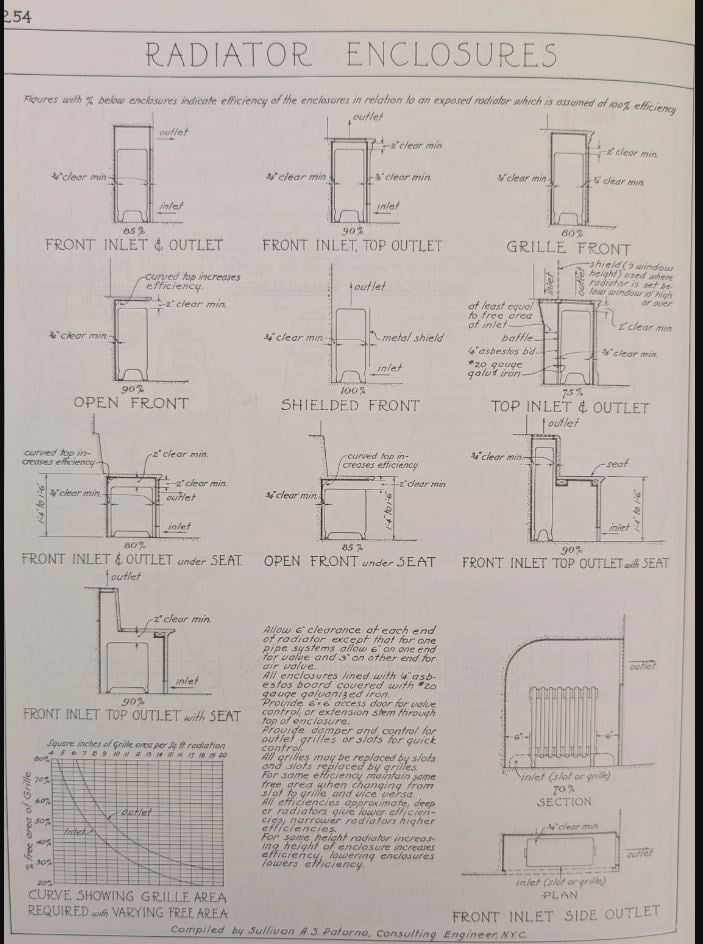

    Steamhead Member Posts: 18,805

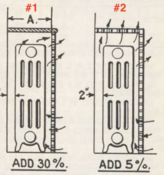

    @CoachBoilermaker , the metal of the radiator stays the same, but if you add a cover you can lose up to a third of the rad's capacity. Read the article linked in the above post for more detail.

    Expanded metal like that is too restrictive. You need opening at the bottom and the top (not the front) to get full capacity.
    It acts like a chimney.
    hot_rod Member Posts: 28,078
    If you have air space between the skin and radiator you no longer have conduction heat transfer and the skin will not get to the temperature of the cast iron. The air space is an insulator.
    Push the sheetmetal skin against the cast and you have a different dynamic.

    The primary mode of heat transfer here is via convection. With the open lid and slotted bottom, the radiator cover is fine.

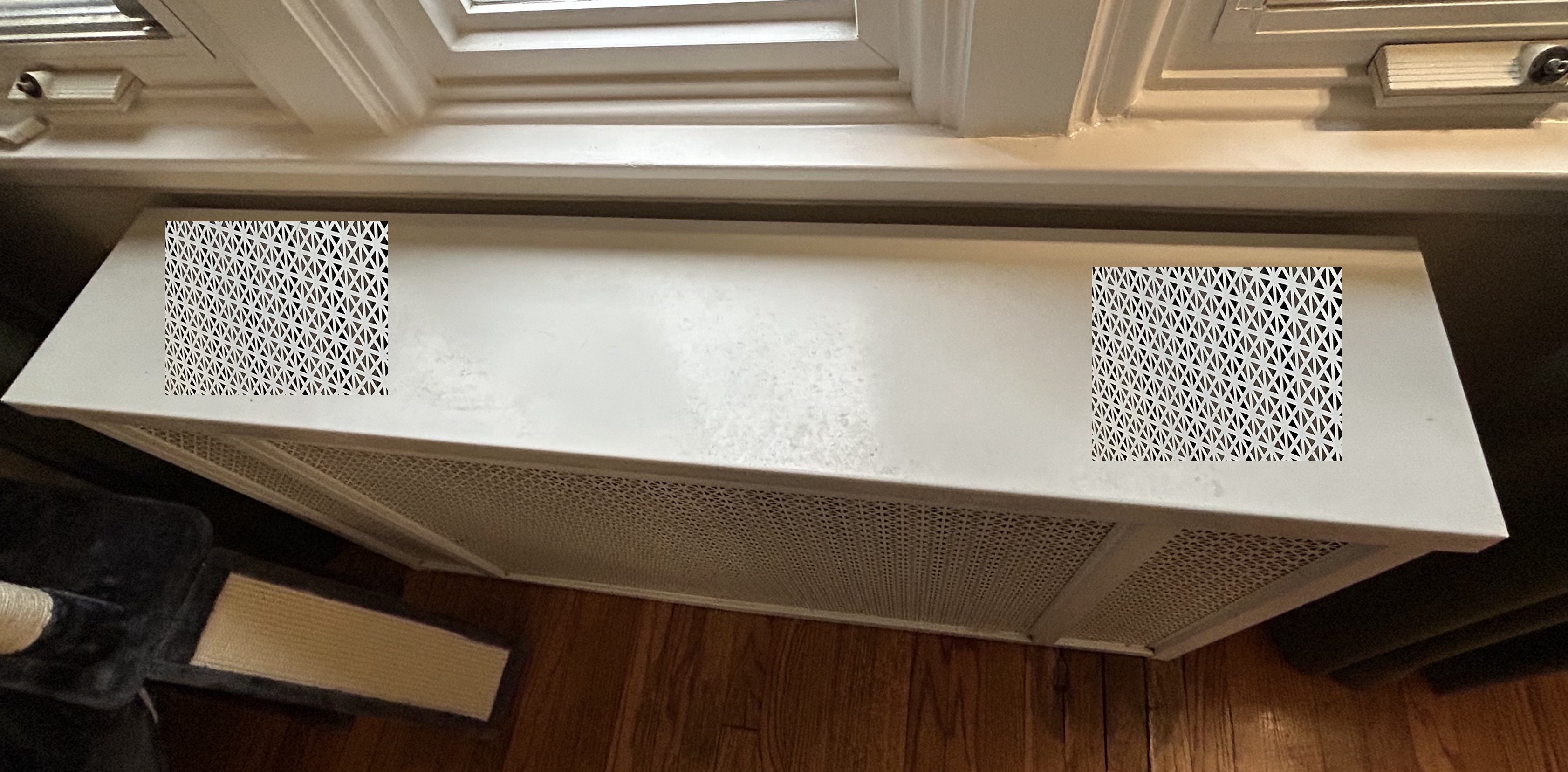

    I have always thought nicely finished radiators were more attractive than the enclosures, but, if indeed you wanted to move toward the configuration you mentioned I guess you could just drill a couple hundred holes in the top or saw off all but the last two hinges worth of the cover at the vent end (for the sake of the cat). If we believe it according to the publication you are referencing adding a mid shield inside the front of the enclosure to enhance the convective flow path would get you another 5%.
    There is a competing enclosure document out there that unlike the one being referenced shows no configuration with "enhanced" output vs naked radiator.

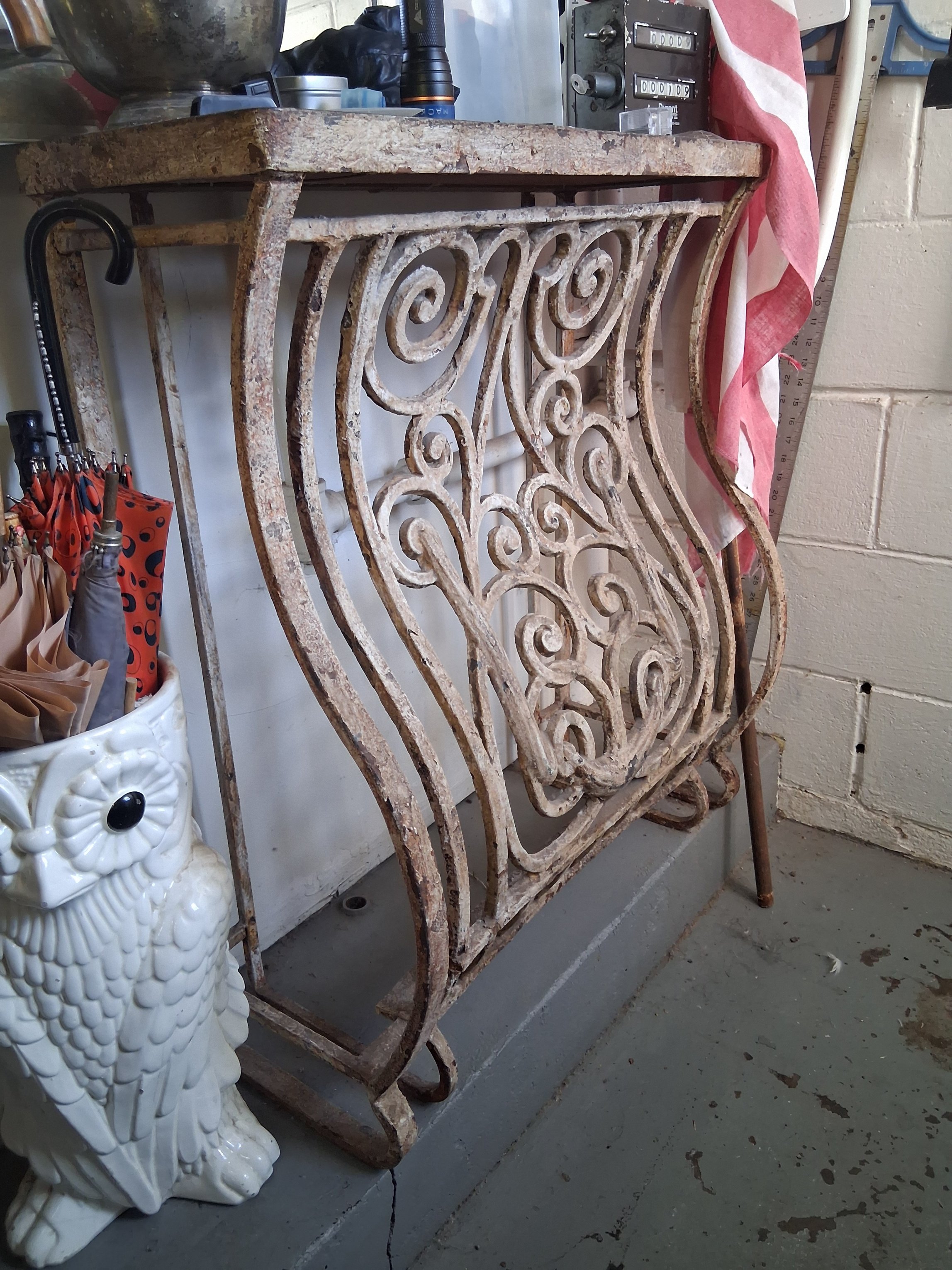

    I bought this old cast iron rad cover over 20 years ago in Miami for a few bucks, the top is poured concrete. I'm still waiting to cover an actual radiator with it.

    Cutting the lid where you marked it seems an easy immediate remedy for cat and masters. Cats are finicky though. He may like to walk the plank to find his optimal temperature zone😁. Obviously which end you leave him will impact the propensity for a warm seat.
    Shield you could probably hook on from the inside. I would lean toward sheet metal or aluminum over an insulating material. Trying to enhance convection, not seriously reduce conduction and radiation.

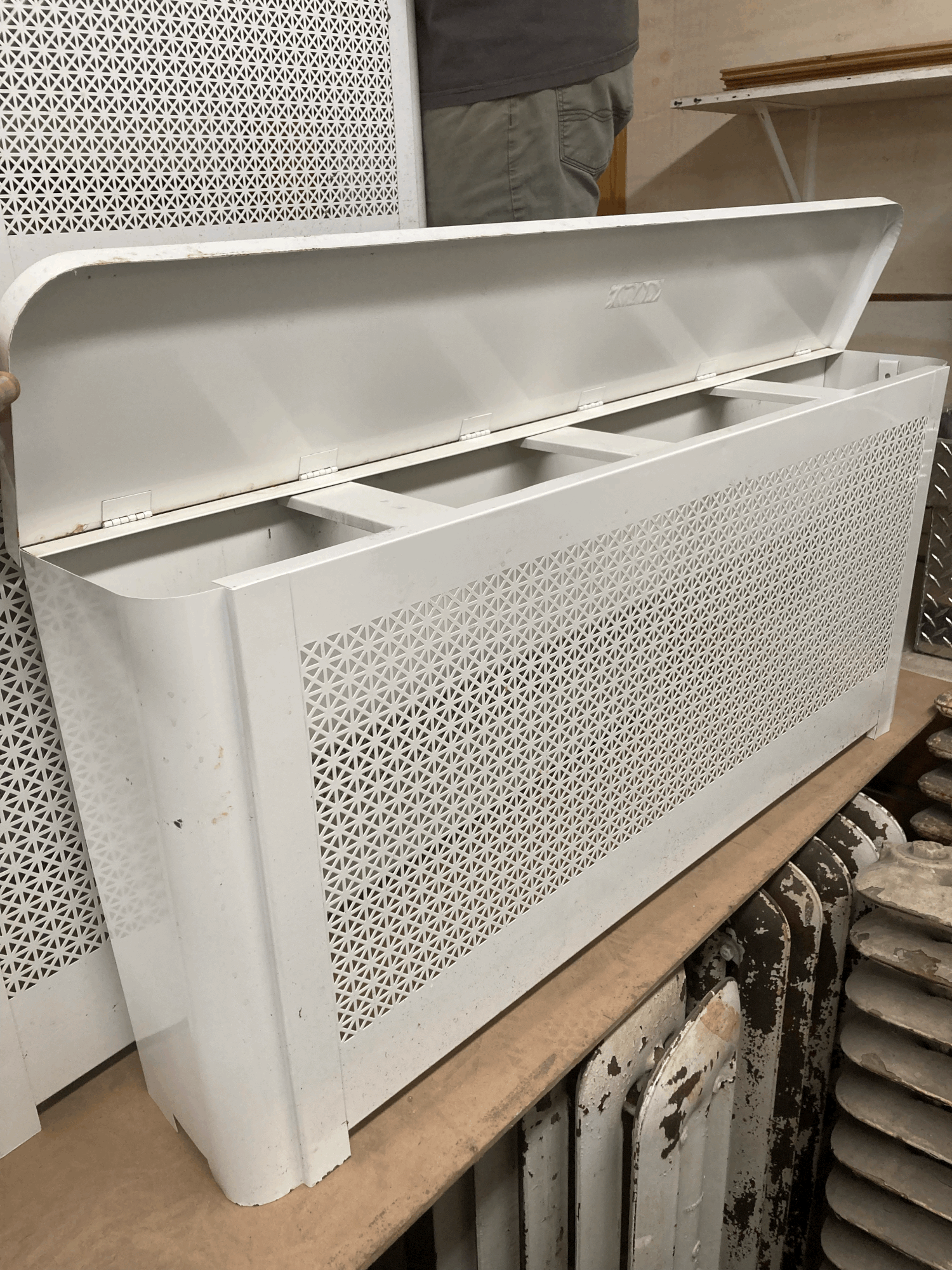

  • CoachBoilermaker
    CoachBoilermaker Member Posts: 462
    Is there a big difference if @Day_Tripper
    keeps the top open one inch (photo)
    vs. keeping the lid all the way open?

    Cant find any examples of an enclosure that blocks some part of the front but with a wide open top. Guess that is because it is not about aesthetics, rather it's all about the cat.
    radiators like that are about 80% convection, 20% convection
    Conduction transfer when the cat is touching the cast iron
    The amount of heat output depends on the square footage of the radiator
    But don’t discount the heat effect of the radiant as you stand in front of a warm surface radiator that is the selling feature if radiant systems
    You may need to play around with grill size on top to make sure you cover the heat load in coldest conditions if you go that way
    In older homes, windy days can be high load days also

    Would make a great window guard if it didn't have the concrete table top.
