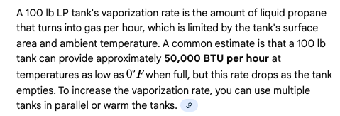

    hot_rod Member Posts: 28,078
    Some info here.
    https://qualitysteelcorporation.com/wp-content/uploads/2021/03/Vaporization-Chart-1.pdf And here.

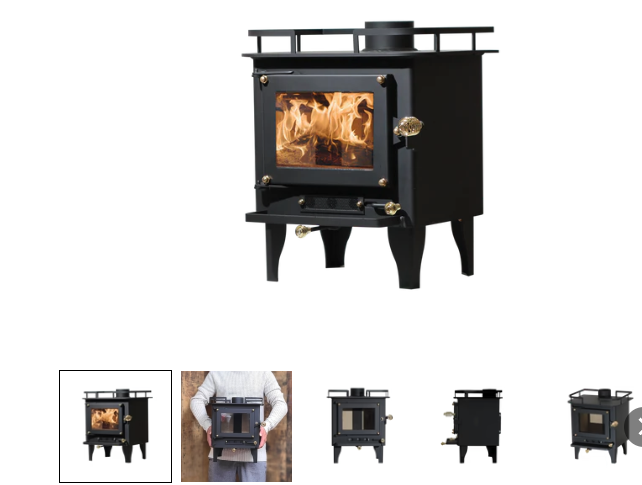

    How big is the cabin? I have the smallest one of these in my truck camper, super simple to install with their double wall flue pipe.

    The cabin is just under 200 square feet, 16x12 exterior dimensions, but has a very tall steep roof and a loft. R19 insulation all around, including under the floor.
    The problem with the wood stove, I'm told, is fourfold. We'll be burning soft wood, at high altitude, through a long flue (more than 20') in very cold temperatures, all of which lead to creosote build up. There may be another small cabin build in the future, and I plan to make wood work for that one, but the snow is already accumulating where this 80% finished cabin is, and I need a near term solution to get it warm enough to finish the interior and use it. Until late June all materials will be brought in by ski or snowmobile, so another point against heavy and bulky wood stoves and their venting. I like that stove you put in your camper, and had seen it while researching for my own cabin. Ultimately I was leaning towards the Hearthstone Lincoln for its ability to burn long, low and clean. Next cabin.
    I think, or at least hope, that a dual tank setup will be enough for at least a low burn setting on the propane furnace. Of course if it's not it'll be on a bitter cold night that we find out. Better have lots of emergency blankets. Another challenge with LP is this furnace vents directly outside, but I'll need to raise the vent above the snow, or at least dig the snow well away before we use it. This area gets in excess of 10' of snow, and often more than 15'.
