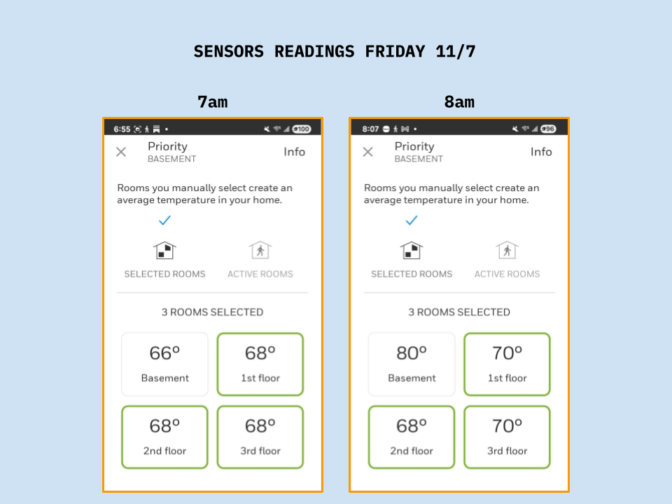

    @Jamie Hall @mattmich @BobC @dabrakeman and anyone else who can spare a minute and some insight:
    Here's an update and a question.
    I spent the week tweaking vents in the two apartments that were running hot. Worked on the hottest one first - 3rd floor. Then moved on to work on the 1st floor.
    We have gone through many heat cycles since I posted here on Monday. Sensor read-outs from this morning show below. In brief, this morning with the heat set to 70:
    1st Floor: 70
    2nd Floor: 68
    3rd Floor: 70
    Progress!
    About the 2nd floor. I hesitate to change this apartment's current state because the tenant runs hot - her words, not mine. To my mind the goal with the heat is to get every single apartment to line up with the set temp (right?). By law in Chicago heat in the apartments has to be 68 during the day and 66 during the night.
    I have a good idea of where to start on the 2nd floor where all of the vents are MoM #4. I have one big rad in the living room in mind to bump from #4 to #5 and that will likely do the trick.
    Once all sensors hit the same target, I'm thinking people can do what they need to do to get their space comfortable - turn on a ceiling fan, crack a window, drink a cold beer - whatever. Just like in summer - some have A/Cs going all day and night, others don't have A/Cs at all.
    I don't like the idea of paying for heat that's just going out of a window, but that's a different concern. Or is there more to that? When it's 10 degrees out, is heat going out of the 2nd floor window going to screw up the heat for the other units?
    The goal is to BALANCE this system and that means get the 2nd floor temp equal to the 1st and 3rd - right? Any other things to consider?
    Thanks!
    Jamie Hall Member Posts: 27,699
    You are certainly making progress! Congratulations!
    In a sense yes, the objective of balancing is to get all the spaces to heat evenly and to the same temperature — all else being equal. But… all else is not equal. So in my mind anyway the objective is to get all the spaces so that most of the time their temperature is what the usage or and occupant in the space are happiest with. Not quite the same thing.

    One new thought on one apartment's open window throwing everything off -
    Since I can select which sensors are used in the thermostat's averaging, once I've got all apartments balanced couldn't I just turn off the sensor for the 2nd floor and use only 1st and 3rd floor sensors to base temps on?
