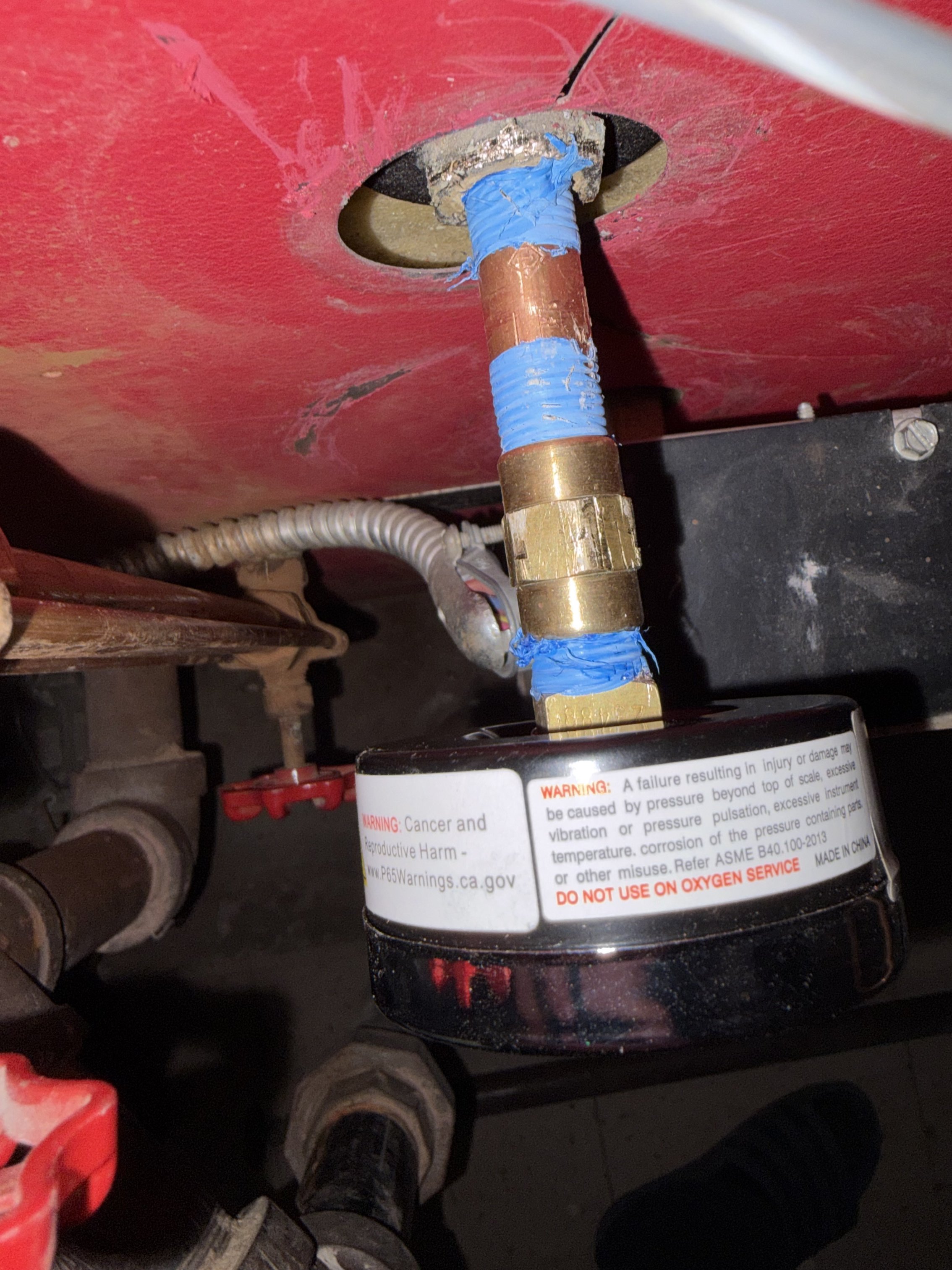

Is it normal to have the boiler pressure gauge die like every season basically? Is it potentially a bad/poorly constructed gauge? I think this is my third one that doesn't work in 5 years. I need to replace it soon.

    Yes. They are typically not well made. Not sure that there is a good reason to replace. Depends
    mattmia2 Member Posts: 17,570
    what kind of gauge is it? a 0-30 psig gauge won't typically register the minute pressure of a properly sized boiler.

    melo Member Posts: 96
    here it is.

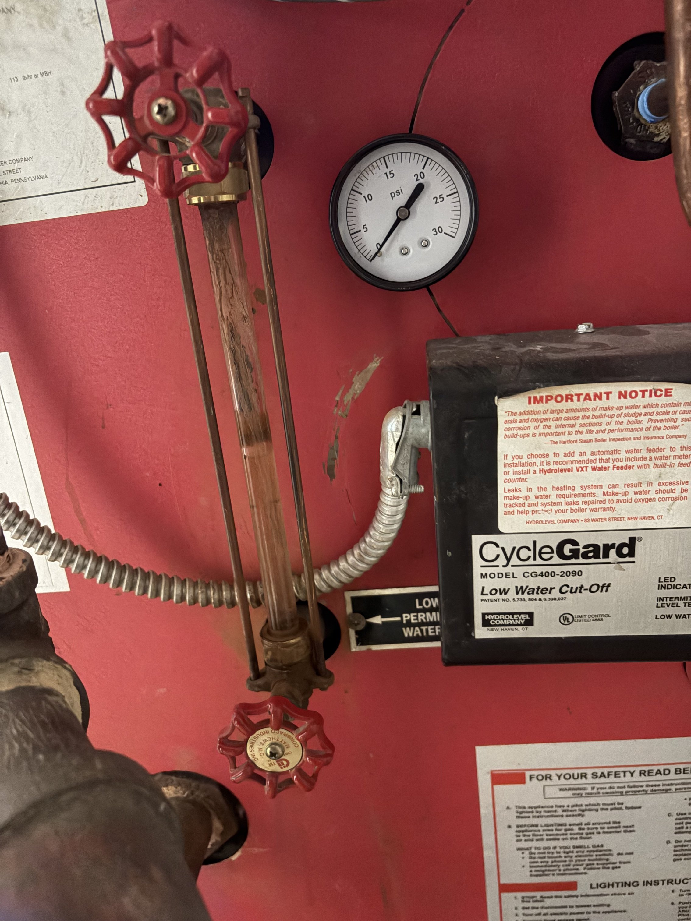

    Also, is ut normal for water glass to have water disappear or go to the bottom limit with boiler running? Both boilers in 2 houses do the same.

    Looks like it could use a good cleaning

    Changing water levels in your steam boilers are normal. Doing the normal maintenance for steam boilers is very important.
    You should visit the heating help bookstore page and purchase several of Mr. Holohans well written books about steam heat, you will lean a great deal from his writing about steam heat.
    Whoever sold you that gauge or the ones before this one should not have sold it to you period.
    You need a high quality guaranteed "low pressure 0-5 PSIG steam pressure gauge".
    You can purchase them from Marsh Instruments or from Dwyer Instruments through one of their retailers in your area.
    I learned the hard way that chinese gauges cannot be trusted UNLESS they were manufactured in Taiwan.

    the water shouldn't exit the boiler
    it looks like there is oil on the water as @STEAM DOCTOR alluded to which will cause surging, it probably needs to be skimmed.

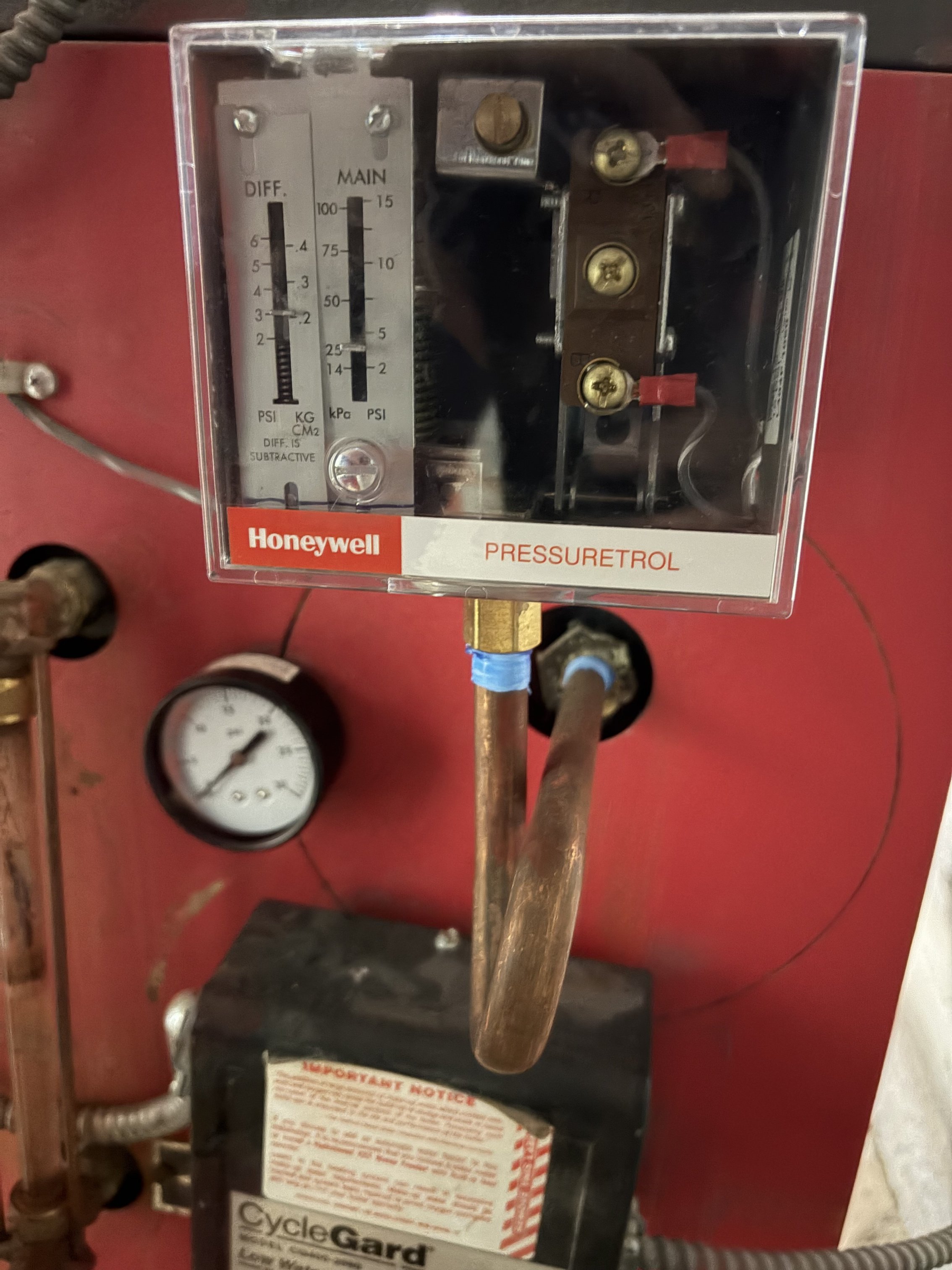

    Is it possible for me to put something in between my boiler and my gauge to make the install a little easier in future? A way to bring it outwards?
    you could put a nipple and a coupler in there. i would also add a tee and a low pressure gauge that is maybe 0-3psig or ~0-50 oz/in^2g off the pigtail to the pressuretrol/vaporstat

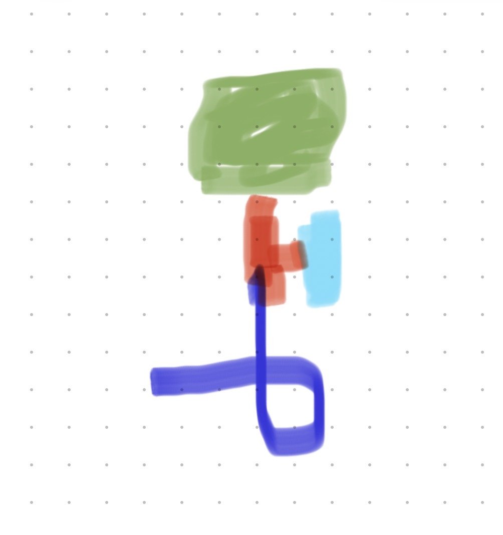

    something like this is acceptable?
    I would have the blue be the gauge, while the pressuretrol is above it.
    Would the extra piping have any impact on the functionality of the pressuretrol?
    that would be fine. you might want to put a valve before the low pressure gauge until you get the surging sorted out, it could potentially damage the gauge, only open the valve when reading the gauge.

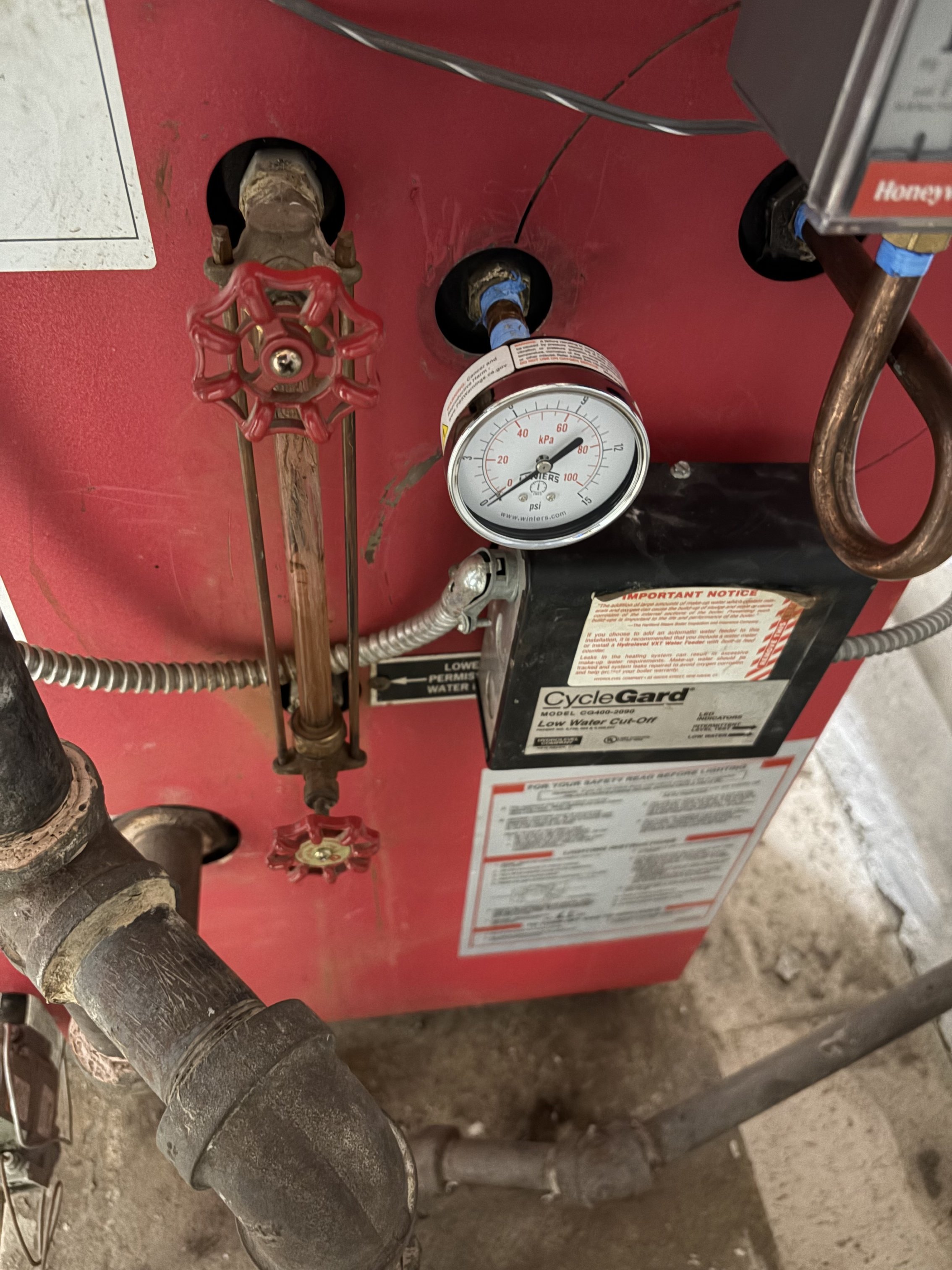

    wait so I can another pigtail to the boiler? Basically another pigtail where the gauge is currently then put the gauge on the pigtail?
    This is my setup now.

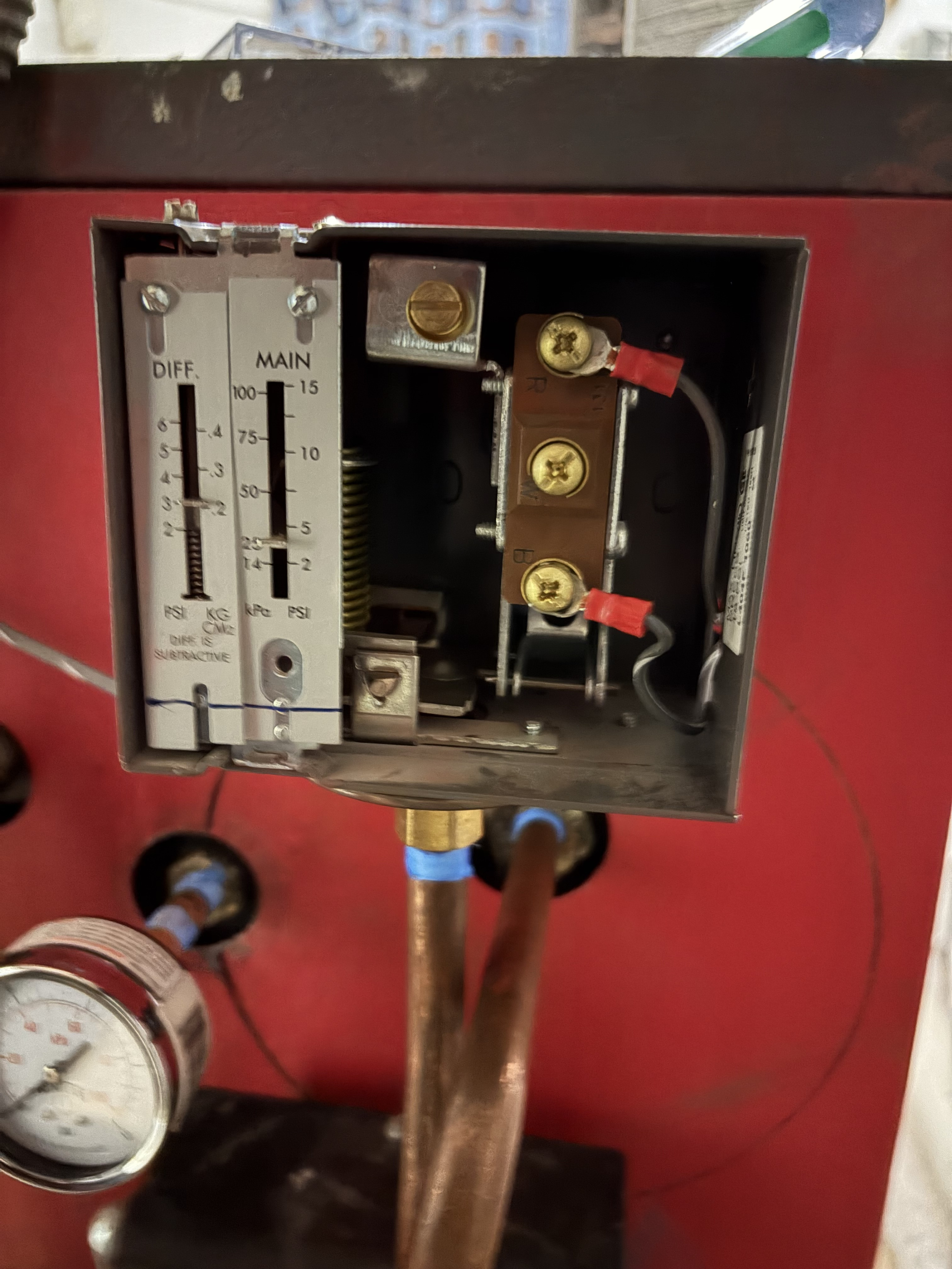

    Do you really need the pressure that high? I very much doubt it. Try lowering the main scale to 2 and the differential to 1…
    Also, if you add a low pressure gauge, you need to be aware that you ADD it. Your insurance and building codes rquire that a 0 to 30 psi gauge be in the system and connected at all times.

    how does this look? Added a stem of sorts to build the gauge away from the boiler and also got a winter 15 psi gauge.
    Also what is the screw on the top middle of the pressuretroll? Doesnt seem to be doing anything.

    Using pipe tape is never good because it affects the gauge's ability to correctly sense the pressure.
    109A_5 Member Posts: 4,228
    edited November 2025
    I'd like to read an explanation of that. Since the tape just helps seal the tapered pipe threads, maintaining containment of the pressure.
    just don't put the tape on the first thread or 2

    When I replaced the chinese made junk that came with my coal stoker, The Marsh Instruments instructions were not to use any teflon tape or paste on the threads of the 4 inch Tridicator that I purchased from them because it will affect the gauges ability to sense temperature changes.
