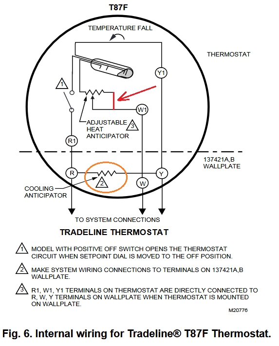

I have a 2-pipe vapor steam system. I've kept the anticipator on the T87F all the way to the left (longest cycle) for many years, basically off. When I try to move it even only a fraction of a mm to the right, I get a super short cycle, ~4 min.
I've tried to clean it. Removed from wall and sprayed electronic cleaner on it, swabbed it. Nothing changed. It is perfectly level on the wall. Any ideas on how to fix it or diagnose it further? Thanks.

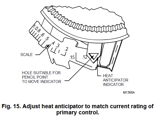

    In fact the Honeywell instructions include a little noticed warning to not move the wiper too far to the right. I suspect that's because contacting too close to the winding start creates such a short wire (low resistance) that it might burn and break.

    @109A_5 , Nice image. I am envious. However, you have the resistor inline with the switch; on my T87F (I think circa 1955), If I lift the wiper from the winding when the tstat is on, the boiler does not shut off. Apparently, the resistor is in parallel with the switch wire.
    It seems to me that the anticipator is just a variable resistor that turns on and off with the tstat switch. It just heats up a little bit while the tstat is on. That's all. Various article online give it credit for controlling this and that; I think they are incorrect.

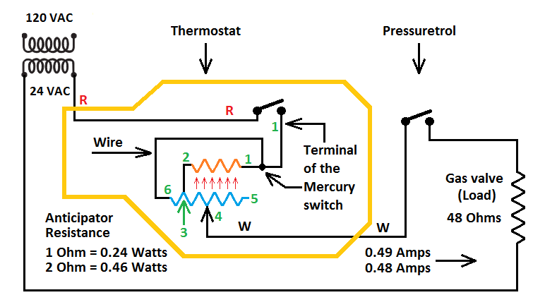

    109A_5 Member Posts: 4,346
    edited November 2025
    Something seems wrong, or maybe different due to age. As Honeywell drew it, if the wiper is lifted off the variable resistor the boiler should shut off. If there was an added connection (Red Annotation), that I believe does not exist the boiler may stay running and the resistor may warm up excessively and cause short cycling.
    I'd carefully examine the whole circuit inside the thermostat, maybe the anticiptor resistor is connected wrong. On mine there is clearly a wire connected to the Left (small end) side of the anticipator resistor.
    Possibly (but unlikely) the (Orange Annotation) if it even exists on your system is wired wrong, but I think that may keep the boiler running after the switch opens and it is in the wall plate and not inside the thermostat housing.

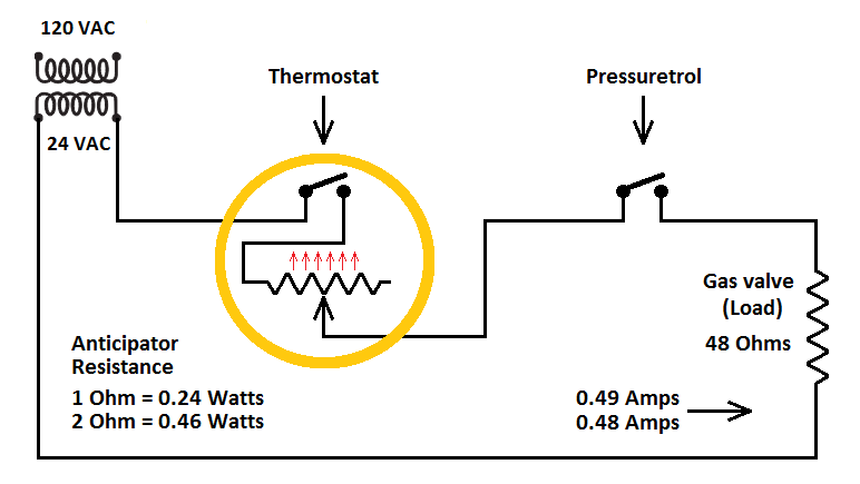

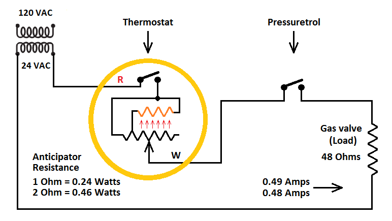

    " Apparently, the resistor is in parallel with the switch wire. "
    If a resistor of the low resistance value of the anticipator's resistor was in parallel with the actual thermostat's switch the boiler would never turn off with the thermostat's switch opening.
    The anticipator resistor is in series with the mercury switch as the wiring diagram shows. So it only heats up during a call for heat and cools down when there is no call for heat.
    Normally the small amount of added heat simply causes the thermostat to open just a bit sooner, anticipating the heat to come briefly after the call is terminated. This provides better comfort and tighter temperature control.

  • pacoit
    pacoit Member Posts: 124
    " Apparently, the resistor is in parallel with the switch wire. " i.e, not in parallel with the switch itself—-which, if it were, I see it would be as you say.
    But, I should have ruled out what I was thinking because a resistor in parallel to a wire would I think do nothing, as the current would follow the path of least resistance: the wire. Pretty dumb, though my experience in circuitry is limited.
    Well fool me! The resistor is in series. Honeywell does not lie. Though, I don't know why sliding a piece of card stock under the wiper doesn't turn off the boiler. Ah, my T87F must be special…

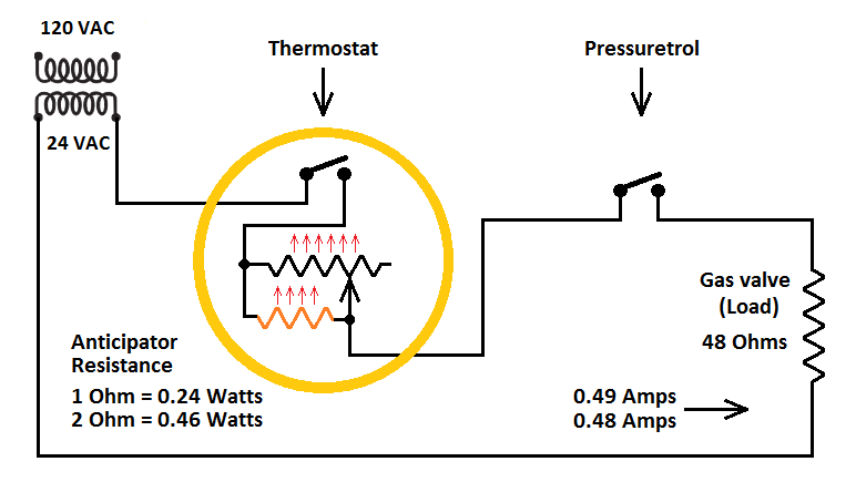

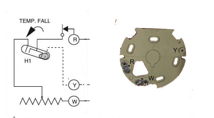

    I would inspect it closely. Is your resistor orientation as it is pictured in this picture ? By the way I believe the white annotation in this picture is wrong the current path is from the Left side to the wiper. The Right end of the resistor is not electrically connected to anything else.

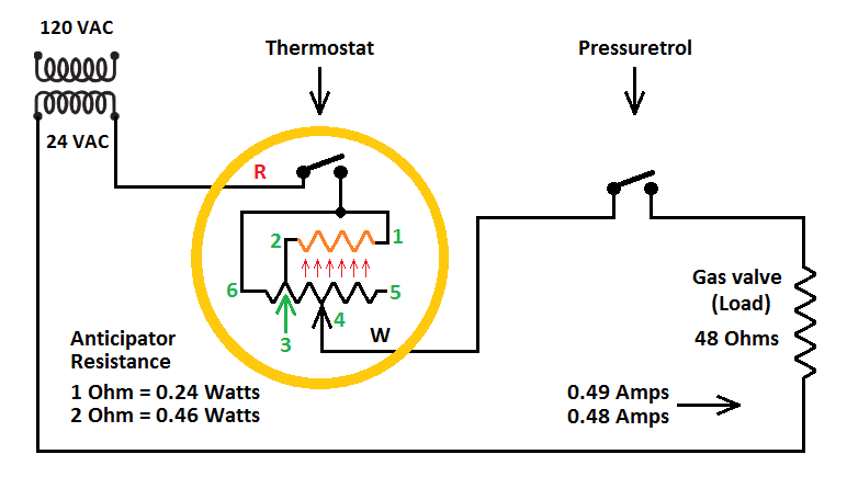

    Jamie Hall Member Posts: 27,699
    Neat diagram there @109A_5 ! Thank you.
    Which illustrates, or at least helps to understand, two things. First, the resistance of the anticipator, even at the high resistance end, is very small in relation to the controller load. Therefore the controller sees the combined anticipator and mercury switch as a nice closed circuit. What you want. Second, I believe there is in deed a missing wire in the diagram. I haven't taken any of mine apart, and I'm not about to, but fo rat least one of them the documentation mentions a 1.2 ohm bypass resistor, so that when the anticipator contact is at the highest resistance end — or lifted from the windings entirely — that bypass resistor is still in the circuit in parallel.

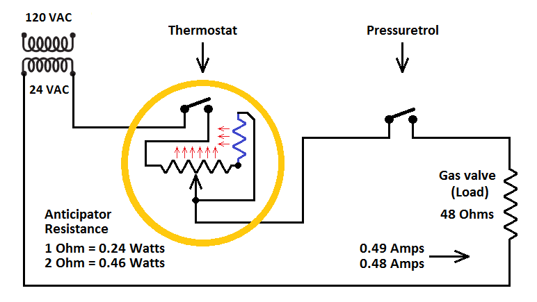

    OK @Jamie Hall I'm not going to take mine apart either, its in use now and it is awkward to get to. With your comment I have made some modifications to the drawing. Here are two examples. Either way with the wiper open the system may still work. The second, I would expect, would have a great amount of anticipation.
    Or with this copper leaf spring on the axle of the bimetallic spring, maybe the other 1.2 Ohm mystery resistor (that I have not located) is actually the bimetallic spring ? The Blue resistor below. I have one more theory that the variable resistor has a tap i'll try to draw it and post later.

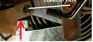

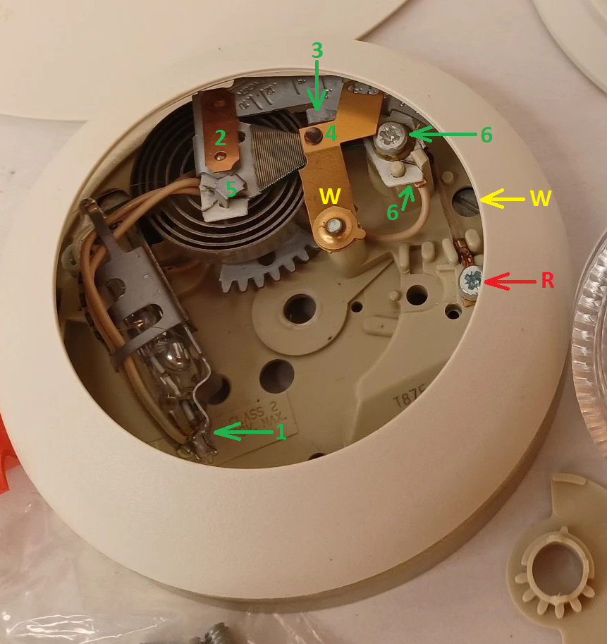

    OK. I removed my T87F 2055 from the wall, cleaned and then inspected it closely. The heat anticipator resistor's wiper is the 'W' wire. The common terminal of the SPDT Mercury switch is the 'R' wire.
    The heat anticipator resistor is actually two windings with a flying connection as a tap. That tap barely seen here (Red arrow) is connected to the metal of the adjustment scale.
    The Right end of the anticipator resistor is open, no connection to anything. The Left end of the anticipator resistor has a wire connected that goes to the 'Heat' terminal of the Mercury switch.
    The anticipator resistor's flying connection to the metal scale then via the copper leaf spring is connected to the axle of the coiled bimetallic spring. The SPDT Mercury switch is mounted to the other end of the bimetallic spring. The Mercury switch end of the bimetallic spring has an electrical connection that connects the 'Heat' terminal of the Mercury switch to the bimetallic spring. The Orange resistor in the image below is the bimetallic spring.
    I'd be very curious if @pacoit's T87F is wired the same way, since I'm having a hard time envisioning what possible defect in the way my T87F is wired would cause the symptoms @pacoit has described with his T87F.
