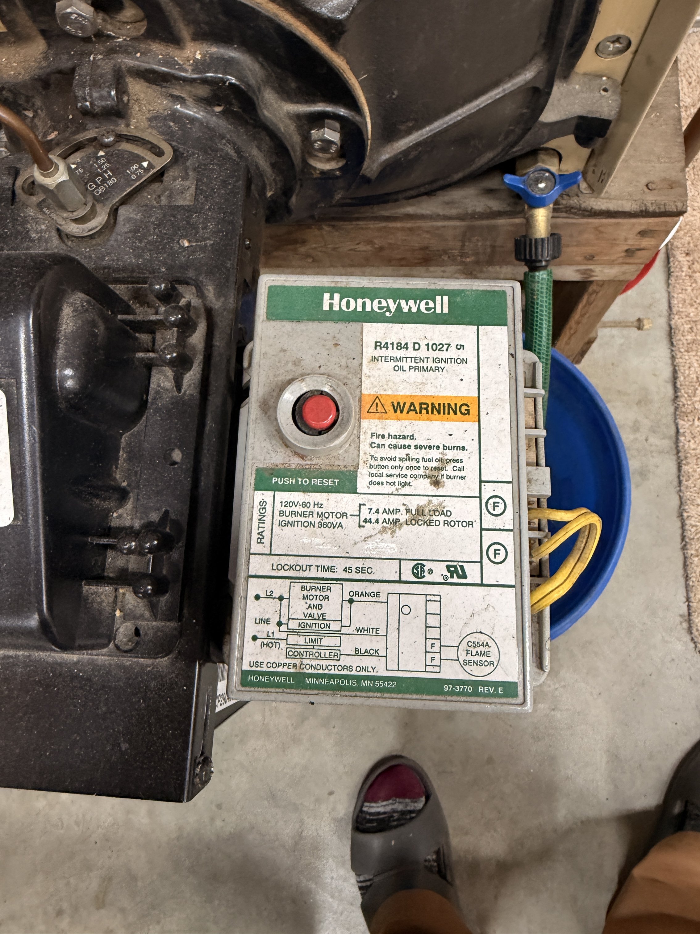

    As mentioned previously the only problem I've had with our boiler over the years is the need to manually reset occasionally.
    Do any of the newer models allow you to remotely monitor the boiler itself (i.e. temperature and pressure etc.) and reset remotely if required?

    what needs to be reset? most of the controls that lock out try a couple times before locking out, if they get to the point that they lock out, something isn't right.
    Here's a picture of the Reset button. If it trips it can only be reset manually.
    something is wrong if that is locking out. get a good oil burner tech to fix it.
  • It is not currently locking out…. hasn't in years.

    You can reset that button remotely with something called a fingerbot button pressing device. It’s basically a tiny Wi-Fi connected actuator that you mount next to the button. You can then press it remotely with your phone and an app.
