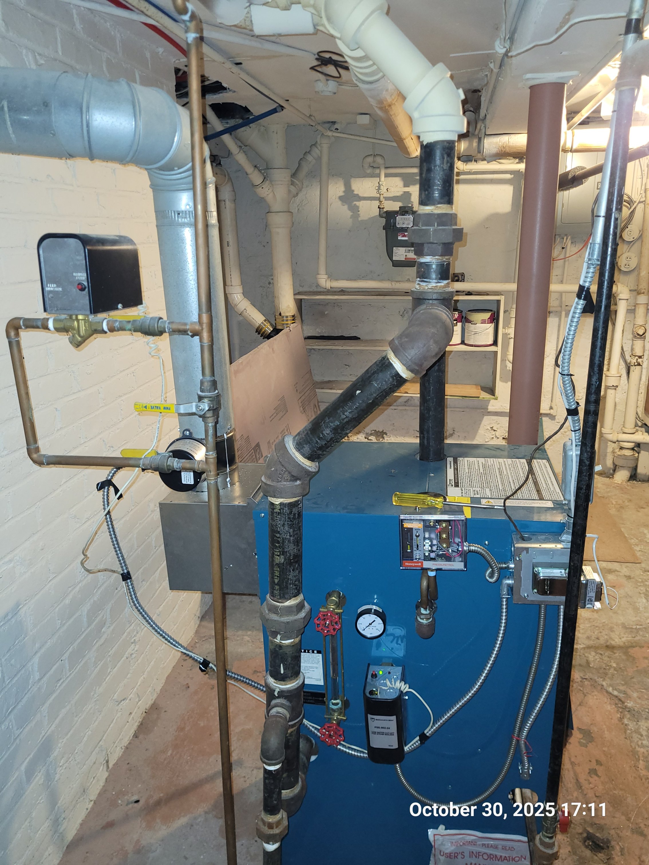

steam radiators are hissing loudly and spraying hot water/steam
I have steam radiators.
I have replaced all of the vents but some of them are hissing very loudly and some are letting out so much steam that the room feels like a sauna.
It seems to me that there is too much pressure in the system (based on internet research)

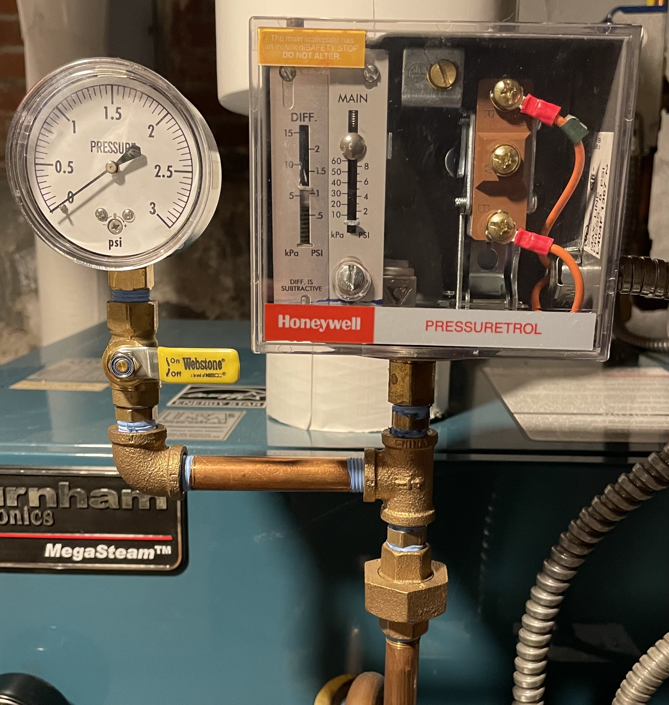

I checked the pressuretrol and the MAIN was at 2PSI and the DIFF (subtract) was at 1.5PSI. I lowered the main to 1.5 but now the whole system will not start. When I turn up the MAIN almost to 2 it starts.
does this mean there is too much pressure in the system even when it is off?
what is my next step? Is there a way to tell the boiler to burn slower/lower? i have Burnham boiler.
thank you for your help

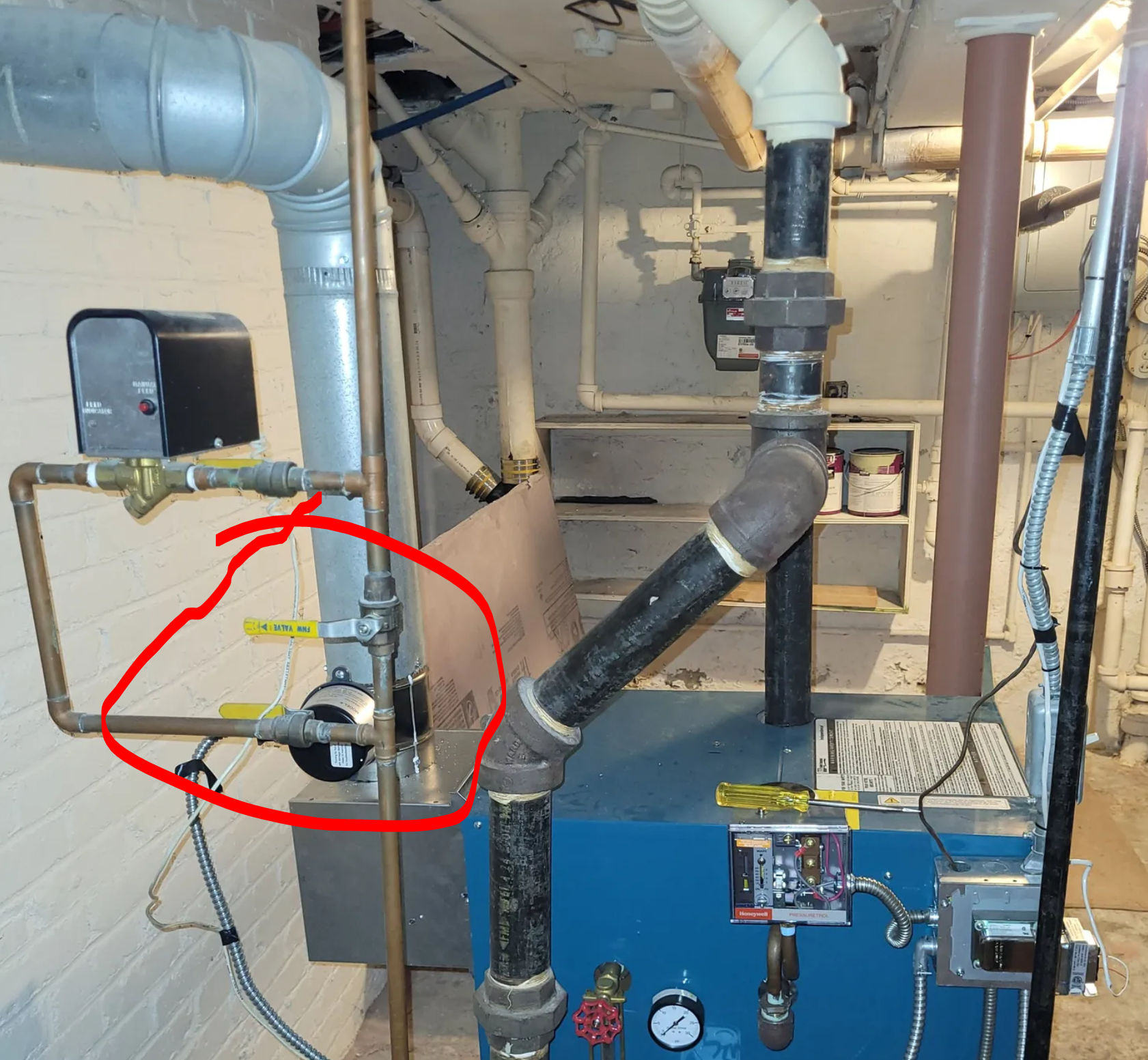

    We need pictures. In particular of the boiler piping. Try to stand back so we can get an overall view. How does the boiler water behave, when boiler is firing?
    No. there is no pressure above atmosphere in a residential steam system when it has been off for a few minutes
    You can't tell the boiler to boil slower but you can make it boil slower but it is not really a user-modifiable thing usually
    Include a closeup picture of your pressure control with the pictures that @STEAM DOCTOR asked for

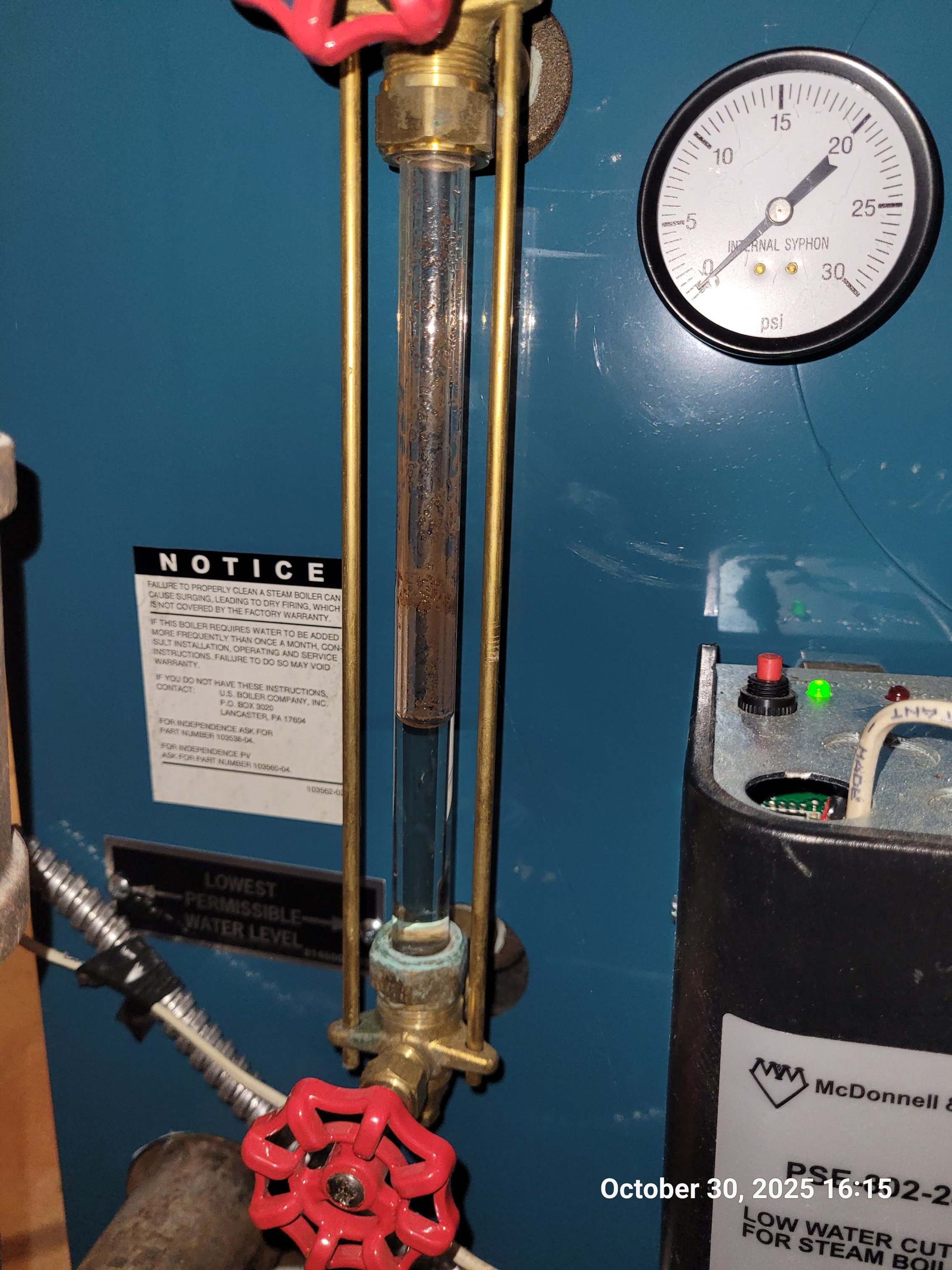

    "How does the boiler water behave, when boiler is firing?"
    Where do I see the boiler water? In the pipe in 2nd pic?
    Miringanes
  • mspsh31415
    mspsh31415 Member Posts: 12
    Wheen the main is up and the boiler is on the water in the pipe is going up and down by about 5mm=0.2 inch.

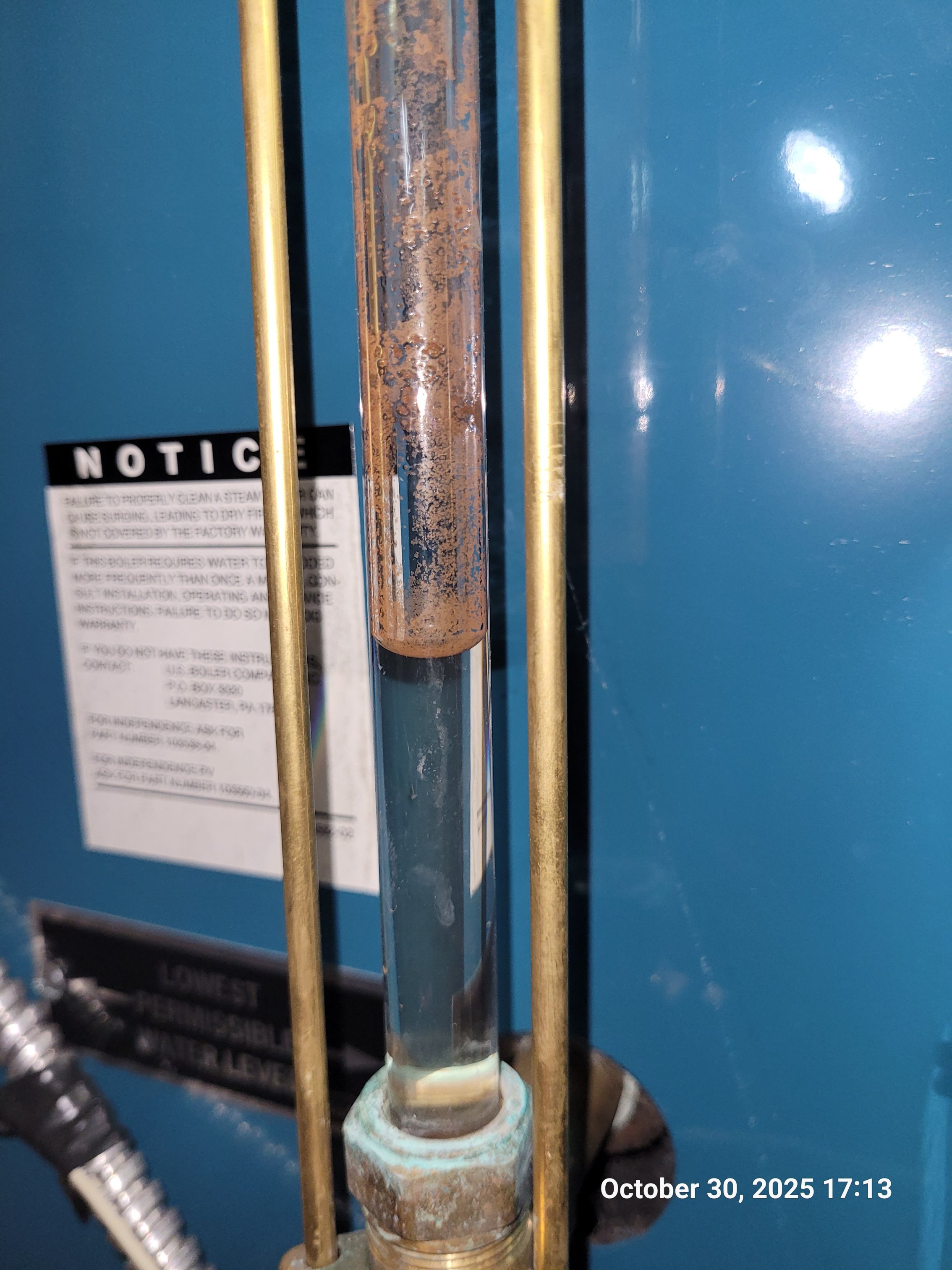

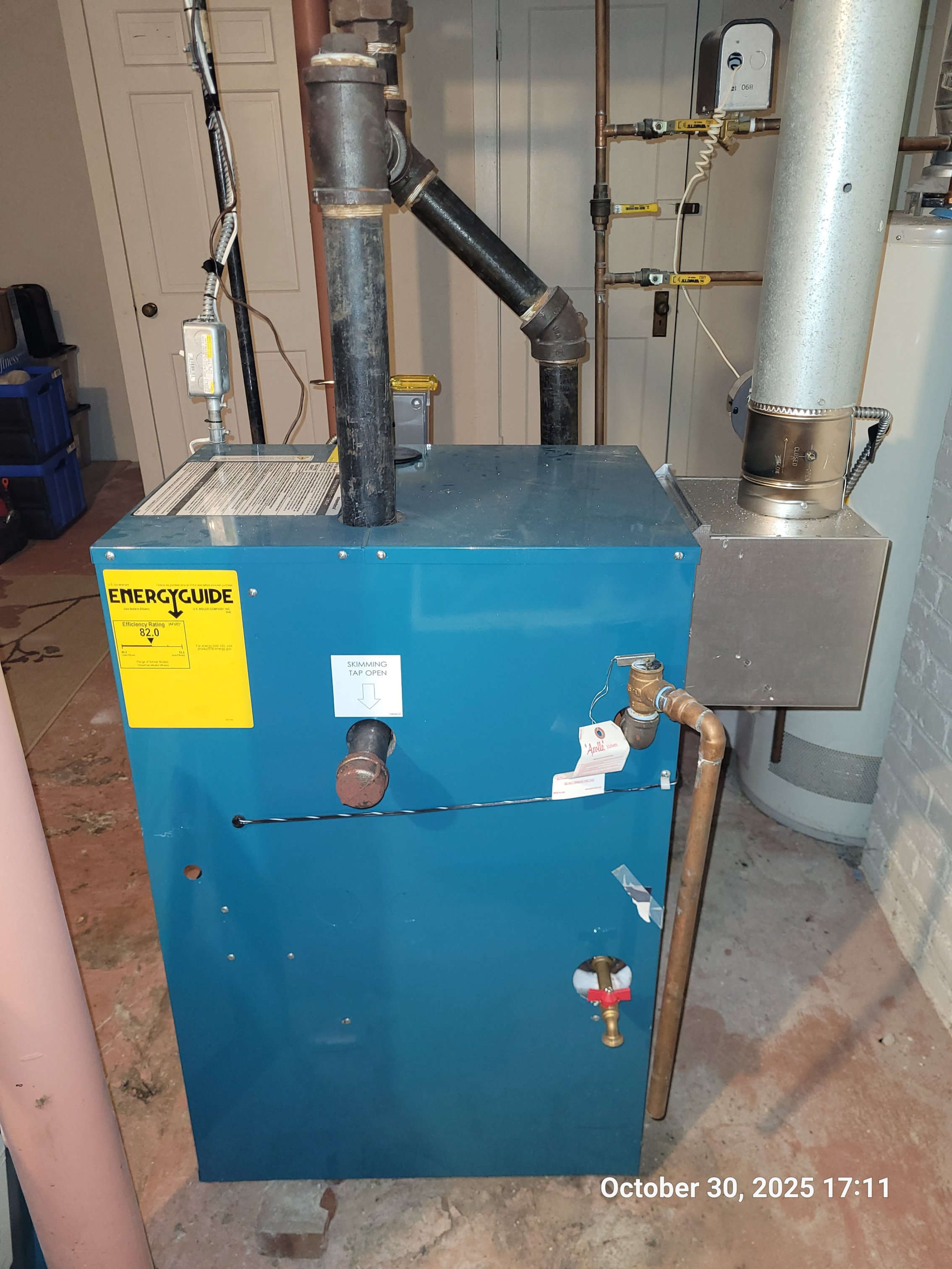

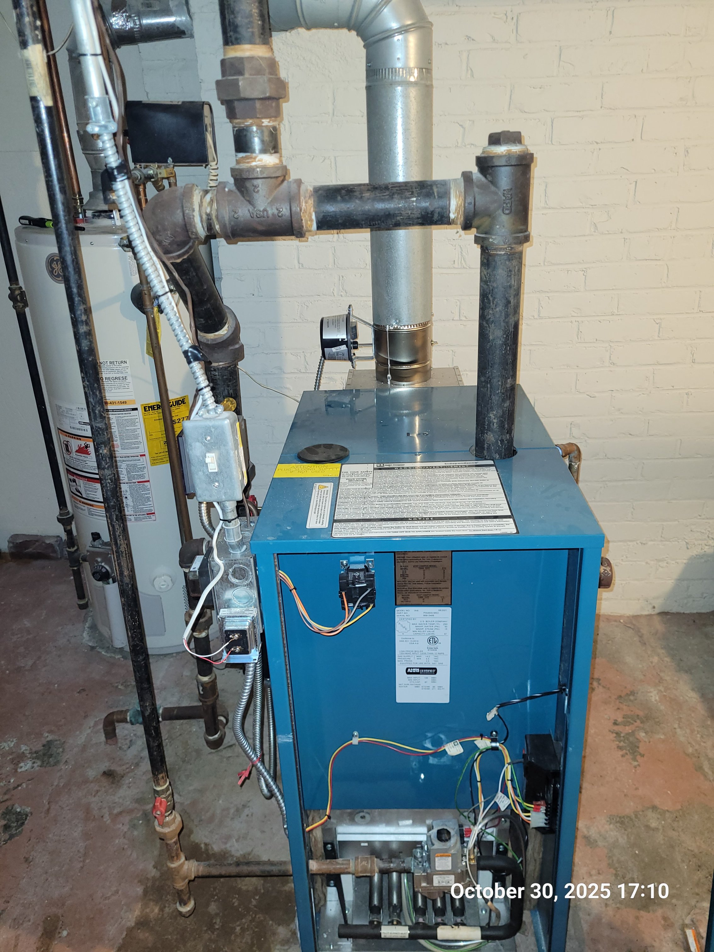

    Water definitely looks dirty. Can you take pictures of the piping on top of the boiler? Stand back so we can get an overall look
  • STEAM DOCTOR
    STEAM DOCTOR Member Posts: 2,642

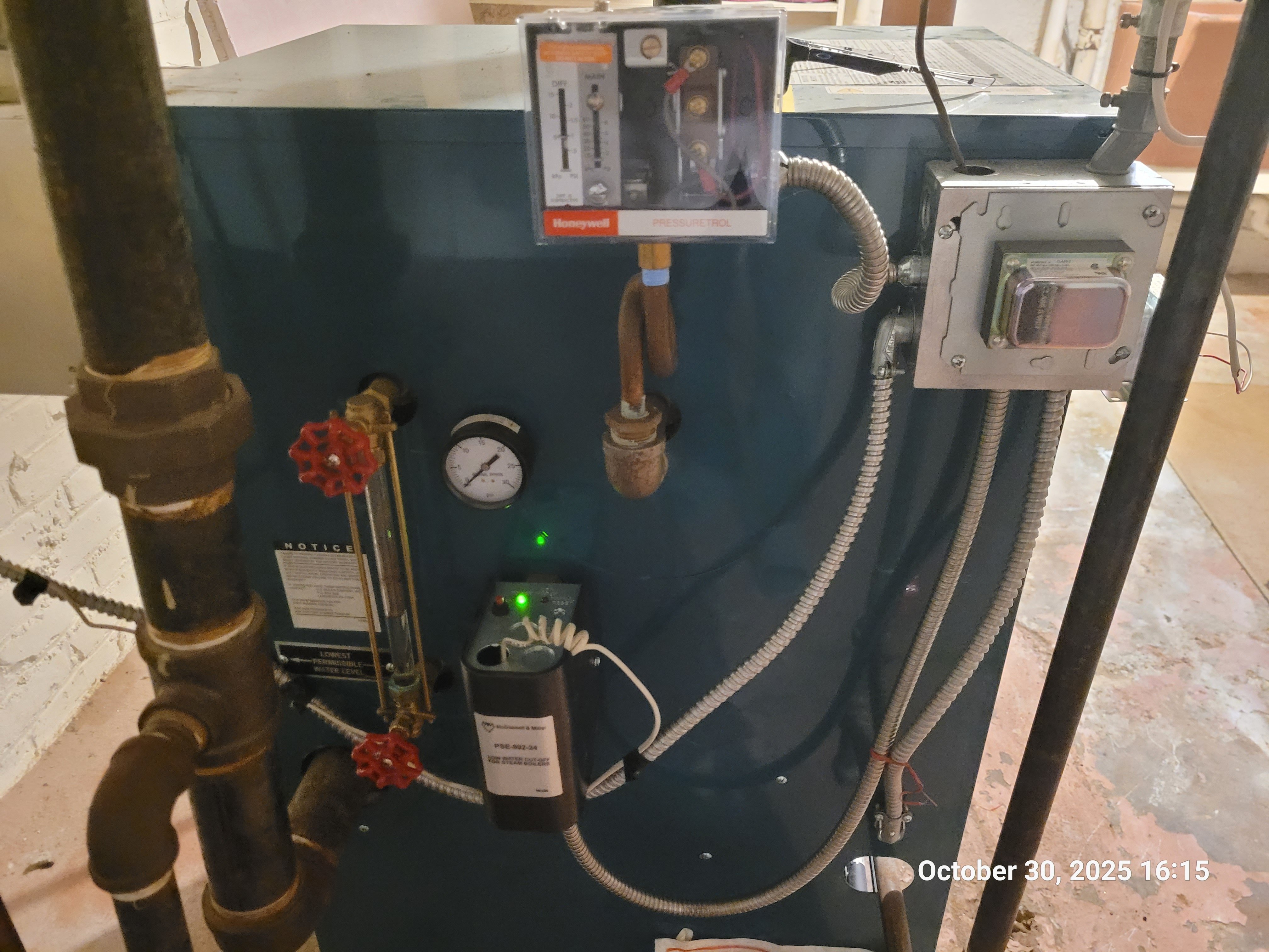

    Piping does not look bad. Water might need a good cleaning for starts
    I've seen worse. The hartford loop is MIA but none of the piping choices would cause steam to hiss
    The addition of a low-pressure gauge on the pigtail along with the pressure control would tell the truth about what your pressure is.
    As nasty as that water looks the pigtail could be clogged and "hiding" the actual pressure from the pressure control.

    I suspect the pigtail is clogged and the pressuretrol is not seeing pressure beyond what air is trapped behind the clog.
    Jamie Hall Member Posts: 27,699
    On the boiler won't restart. Double check the settings on the pressuretrol. The main scale should be set about 1.7 psi with that control. The differential scale should be set at not more than 0.6 psi
    mattmia2 Member Posts: 17,905
    sediment would sink, i'm pretty sure that is oil in the sight glass which will cause surging which will throw liquid water in to the system which can get pushed out the vents. if the water bounces around while it is steaming we can tell you how to skim it to get rid of what i really think is oil.
    the hissing may be bad or missing or severely undersized main vents
    since it is cycling when you play with the pressuretrol settings I don't think the pigtail is clogged.
    New England SteamWorks
    109A_5 Member Posts: 4,346
    Some pictures of the problematic vents ?
    The actual water looks clean to me, the bottom 1/3 of the sight glass. The other junk upper 2/3 (probably rust) may have been there for a long time and accumulated over time. So when the boiler is boiling the water in the sight glass only deviates about 5mm or 0.2 inch and no other violent level changes.
    The pigtail should be verified that it is not blocked.
    Does the gauge ever move when " hissing very loudly and some are letting out so much steam that the room feels like a sauna "
    Skim port if you choose to do a bit of skimming to see if there is any residual oil is still in the system.
    Looks like a Hartford loop to me.

    yep you’re right, Hartford loop is there. I must have been looking at a different thread just before this one

    The pressuretrol settings are an example of why one needs a low pressure gauge to get the settings correct because the Honeywell’s factory calibration is a joke. There’s no way I would have ever achieved .5psi cut in and 1.5psi cut out relying on the markings alone without a gauge to witness the real operating pressure.

    Actually the OP's pressuretrol is the other type — not the one with the clear cover. But the principle is the same. Odds are it's the pigtail is clogged. they do that.
    The only real caution is to mark — and possibly photograph — how the wires are connected!
    The reason yours doesn't reset when you try too set it too low is just that — when you go to, never mind below, the bottom marking on the scale, that often happens.

    1. I checked the pigtal - clean as a whistle. Also the elbow bellow is clean and water runs through it easily. When is stick a wire in it has a bit of goo on it.
    2. skimming: I couldn't unscrew the skimming port so i opened the valve below and black water came out. When the flow slowed (stopped) I opened the manual fill valve. I kept it open until clear water was coming out. Closed both in and out valves and restarted the system to get it hot. Then repeat. I plan to do this a few more times. I assume that the water should be clean. Is there some chemical to use to clean it better/faster?
  • STEAM DOCTOR
    8-way boiler cleaner

    Am I reading this wrong, I have a Pressuretrol subtractive I had it set at 2psi with a 1.5 cut out and I lowered it to 1.5PSI with a 1.5 cut out. So you set the pressuretrol to cut out at 0psi. You will never see steam at that setting. try 1psi with a .5 cut out. Your pressuretrol is likely malfunctioning based on your settings.
    Ah … close, but no. A subtractive pressuretrol has two scales. The main scale sets the cutout pressure — in this case, apparently originally 2 psig but rest to 1.5 psig. The differential, left hand scale, is subtractive, and subtracting its setting from the main scle gives you the cutin pressure. In this instance, apparently the differential was set a 1.5 psi, which gave a 0.5 psig cutin . However, the main scale was reset to 1.5 psig and the differential left at 1.5, which gave a cutin pressure of 0.
    And that is the problem. A cutin pressure of 0 psig is, at best, unreliable, and with even slight errors in setting may not work at all. This, however, is not a problem with the pressuretrol, but is operator error. Sorry.
    As a general rule, I would never set the differential pressure to more than half the main scale cutout pressure on a subtractive pressuretrol.
