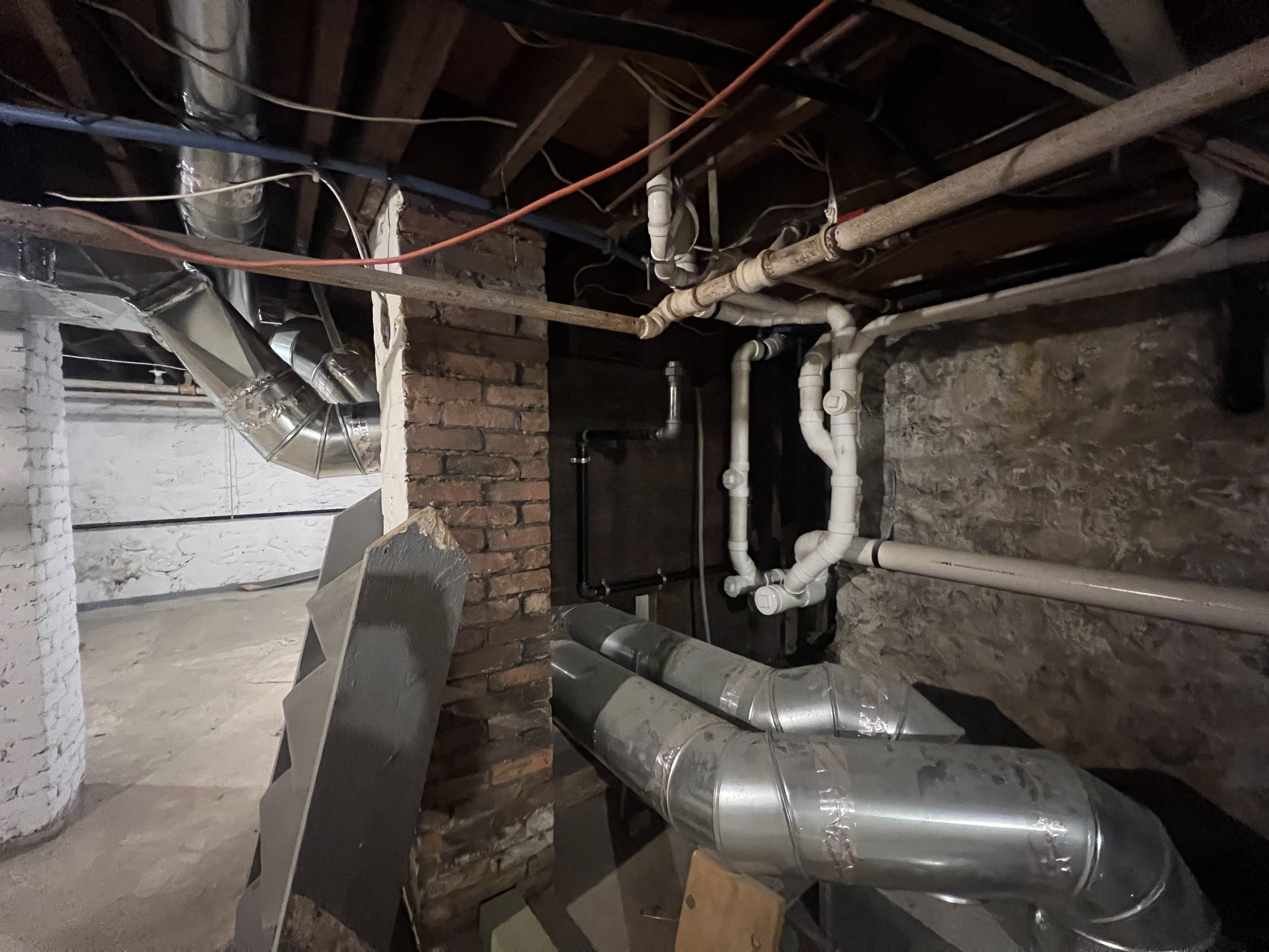

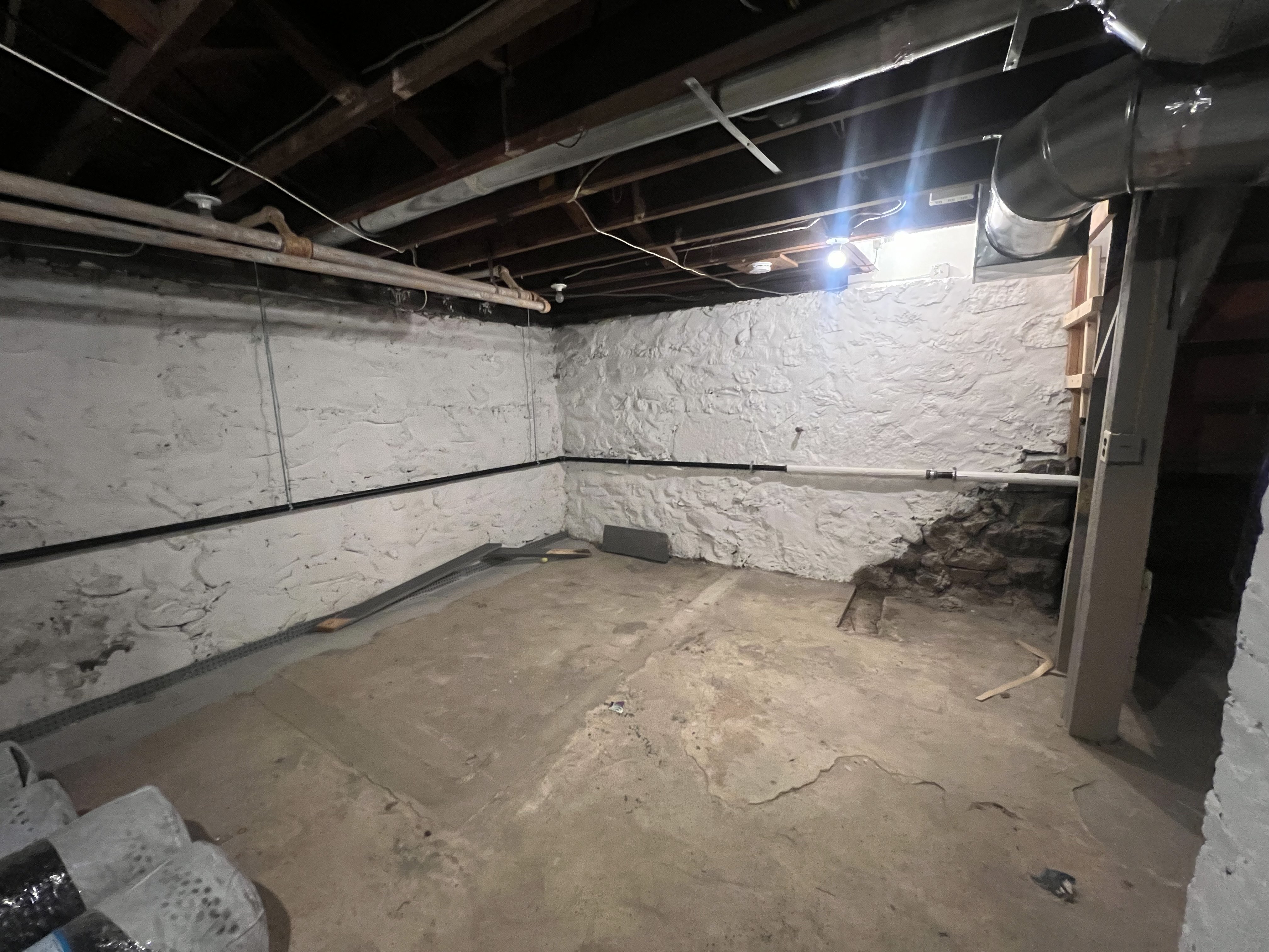

Hi, I have a return pipe in the middle of my basement that is head level but runs across entire width of home.
My plumber said he can remove that return and relocate it so goes around the perimeter snaking under the stairs along the wall and making a left against the front wall and back to the boiler.
Should I be concerned it will mess with the entire system or since it’s a return it’s not as big a deal as the other pipes to the various radiators.
looking for advice sorry no pictures.

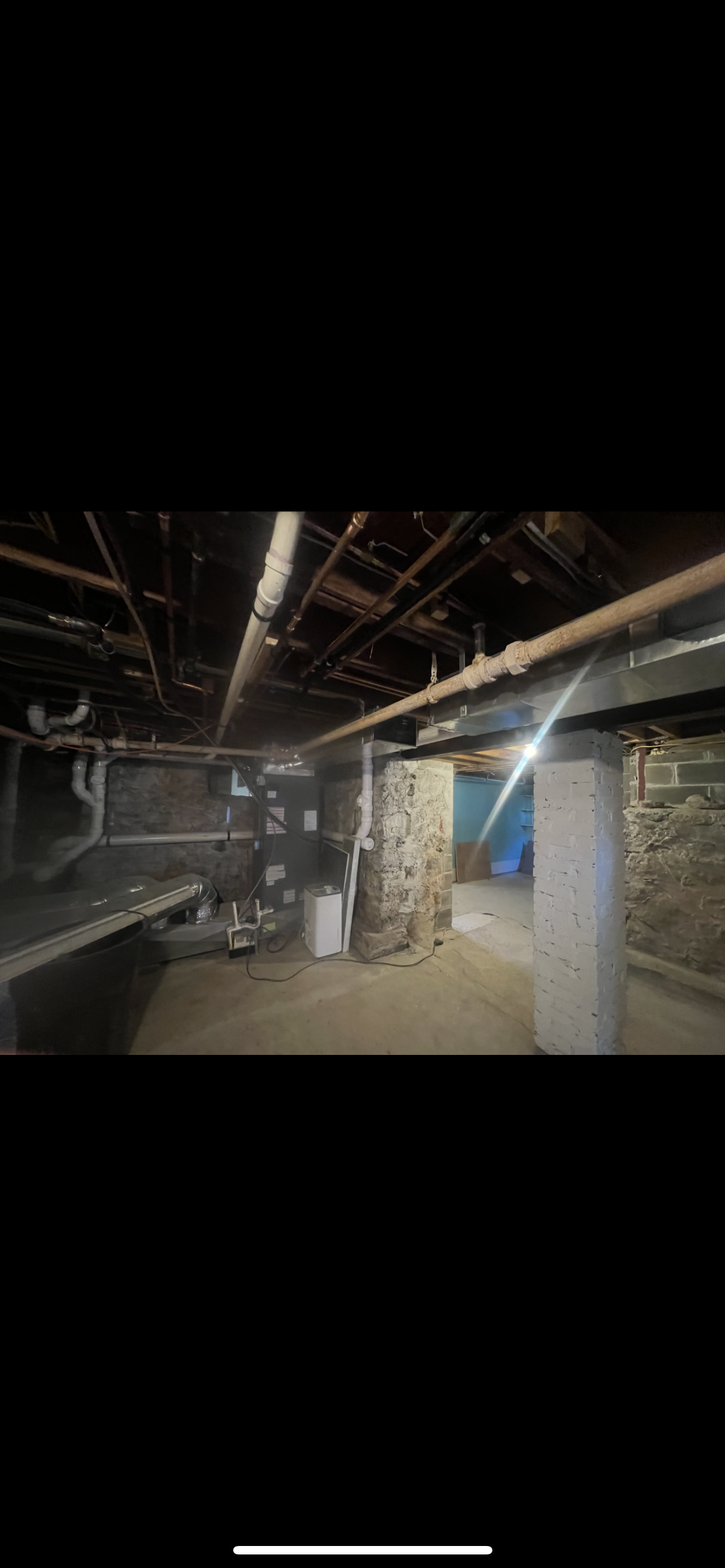

  • ok attached the pictures!
    That is a single dry return. If it were to drop to the floor and run along the floor to the boiler, it needs that vent that is at the boiler to be moved to where it drops to the floor.
    The condensate that forms in the radiators and in the main itself runs toward the end of the main because it is all pitched that way then it follows that dry return below the main back to the boiler.
    The air in the main also follows that dry return toward the vent at the boiler where it is vented out.
    You might want to get "We Got Steam Heat" to learn the basics of how steam systems work.

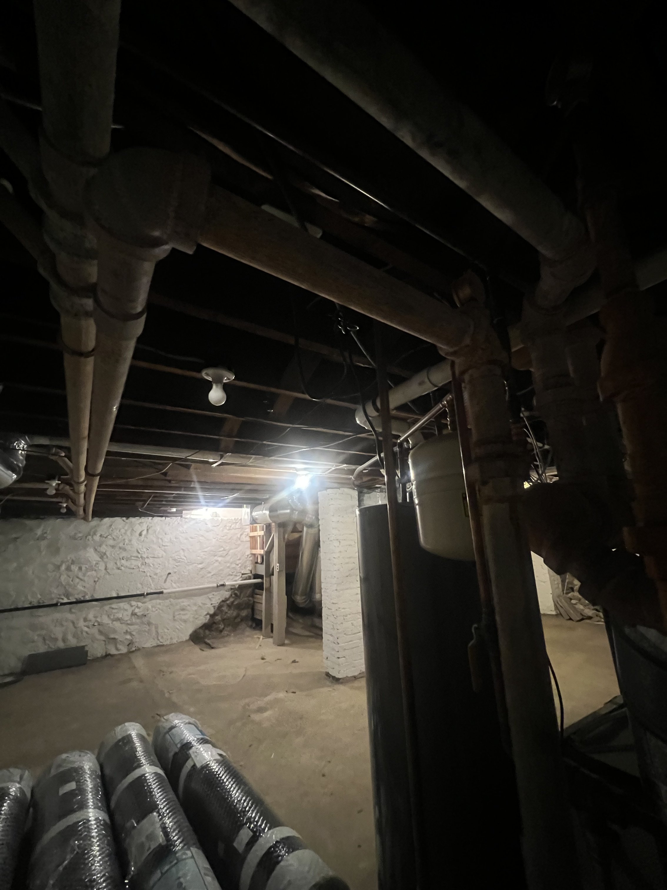

    This is how he is going to run it, it’s all prepped but how do we feel about the location
    Hmmm… that is the boiler over in the far corner? That will probably be OK, but ONLY, repeat ONLY, if the pipe has a definite slope of not less than 1 inch in 10 feet towards the boiler end. If it's set with any less slope, it will give you trouble.
    I'd be much happier if it were set an inch or two above the floor level…

    You want it to be filled with water so that steam can't get in to it and collide with the water and cause water hammer.
    Why do you want it half way up the wall? Near the ceiling tucked over to follow the wall or anywhere near the floor would be fine.
    steam1916dabrakeman
  • I don’t think it can go upwards where the stairs and wall are, I’ll ask if we can lower it

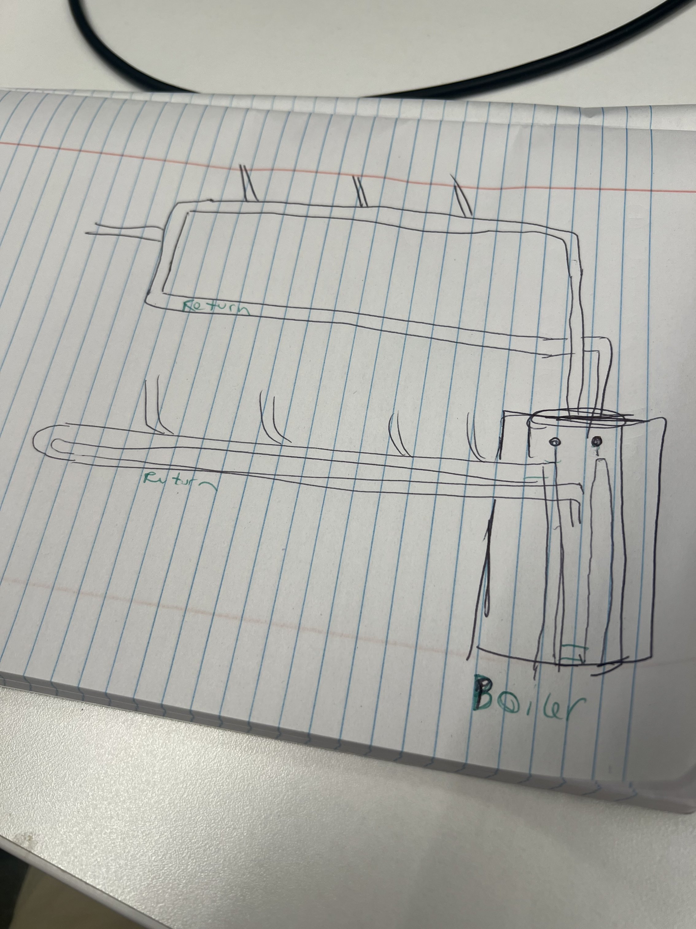

    I see possibly 2 different dry returns in those pictures. Which one are you trying to move and what are you trying to accomplish by moving it?
  • oh my. Those pipes are hot, I think one is the third floor and other is for the first
  • which two?!

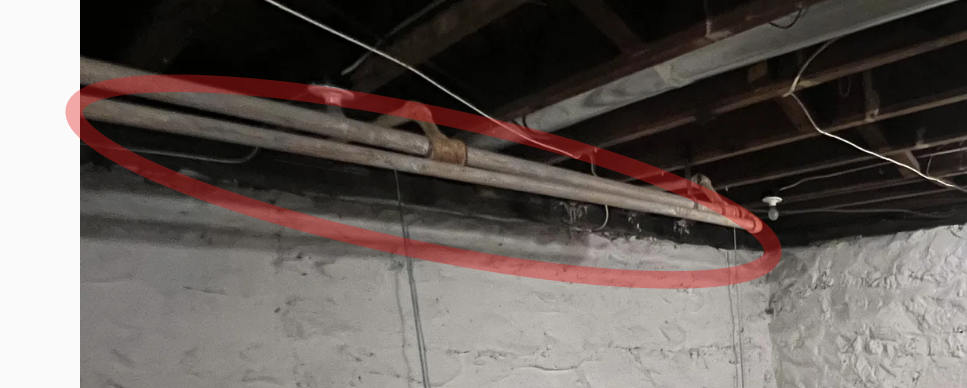

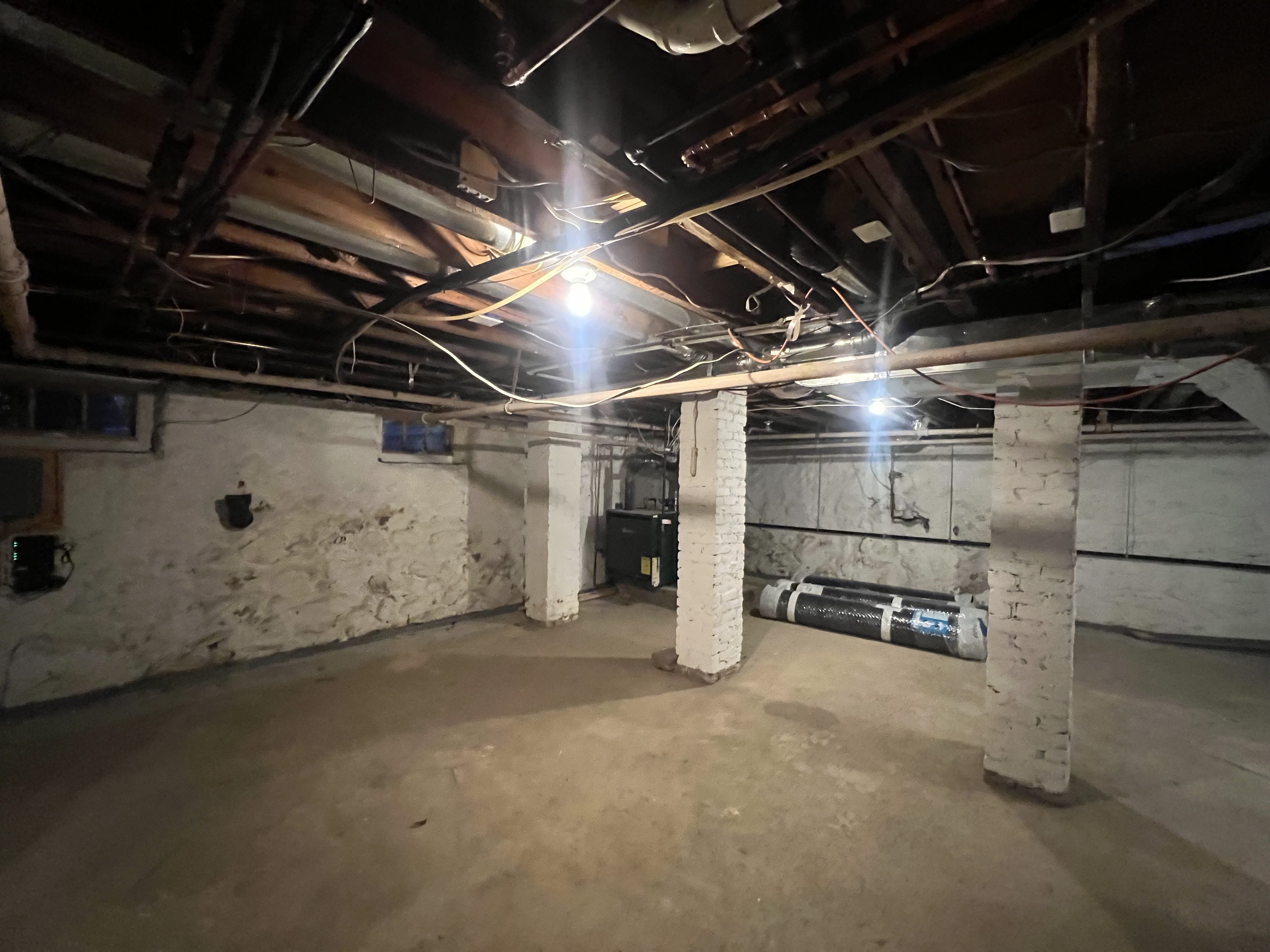

  • we are try to gain the space where it ran across middle of room lol
    I think sketching a rough floor plan would help. I thought this was one return
    And this is another
    But now I think yo might just be showing different segments of the same pipe.
    You could bring the pipe around the perimeter near floor or ceiling level in the opposite direction and avoid the stairs altogether. If you do it at floor level you can use copper.
  • The two pipes together is near the front of the house and the one you circled is in the middle. I don’t think we’re touching the two ganged together and to be honest I’m not sure it’s like that, but any information would be helpful

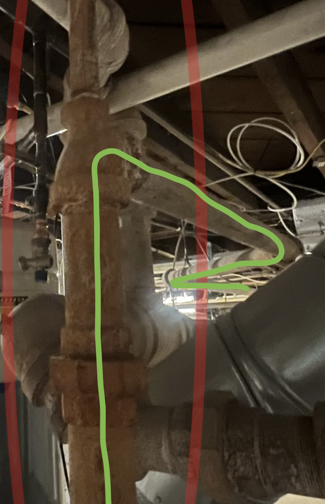

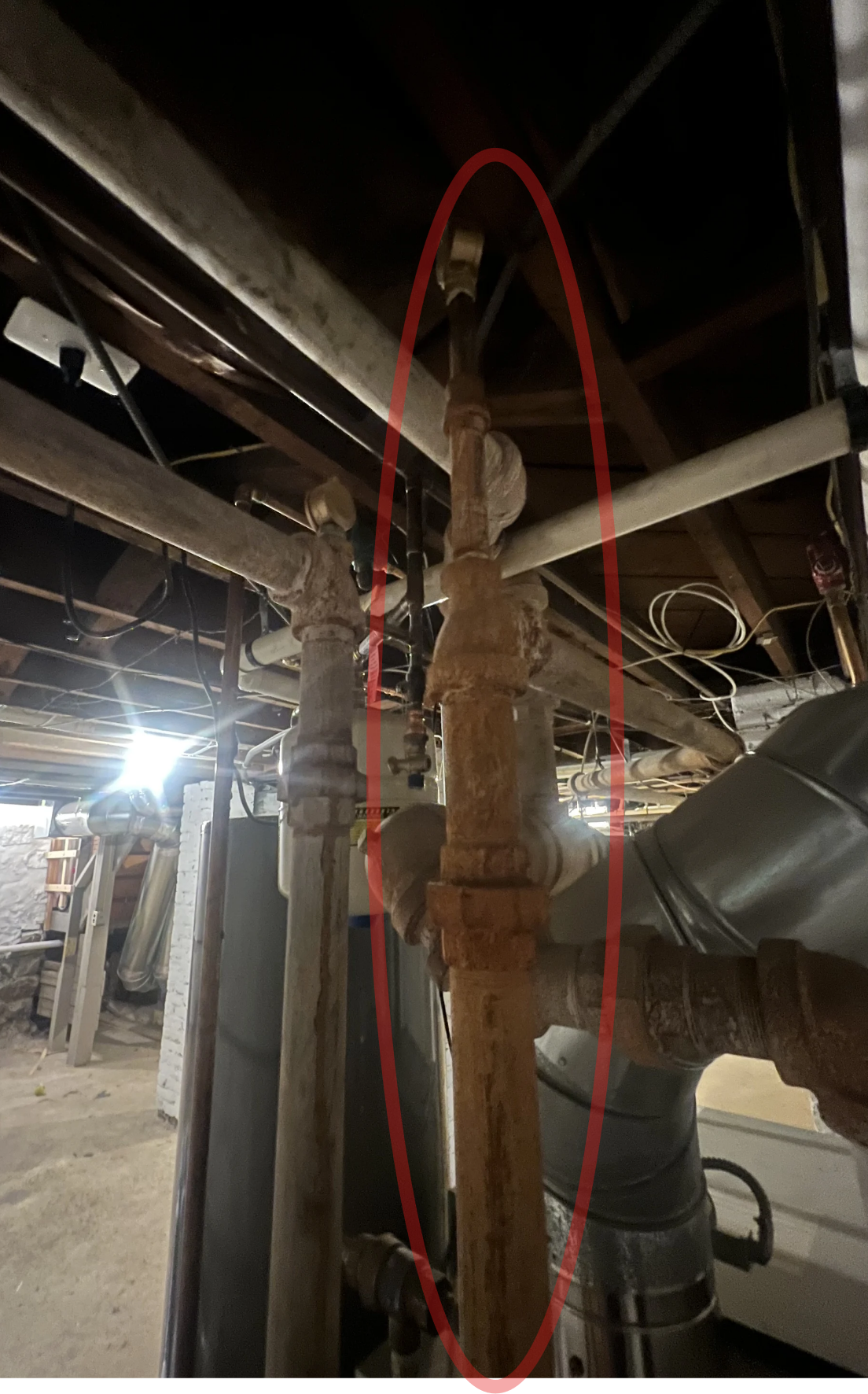

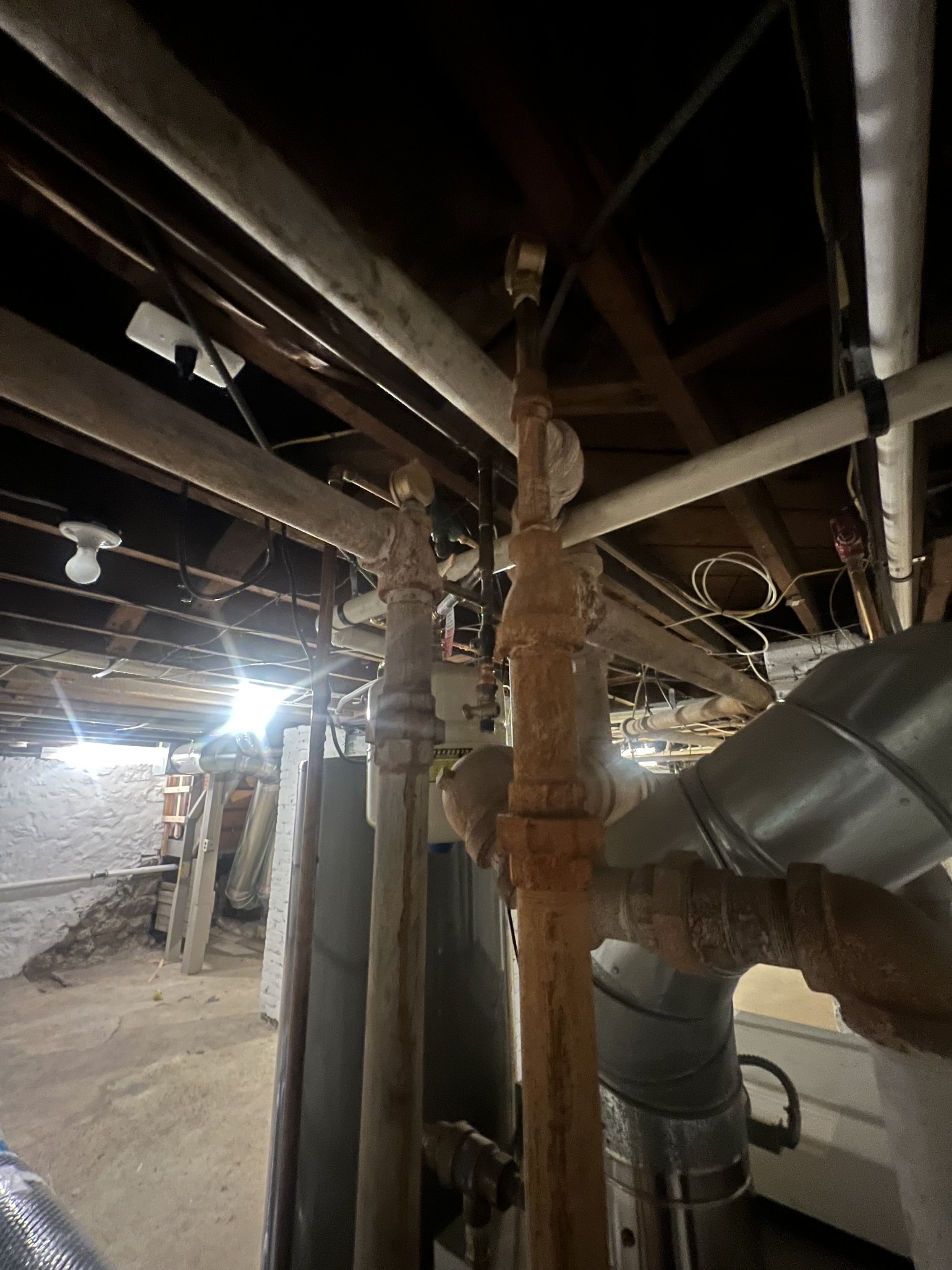

  • @mattmia2 and you may be right there are two returns?? I noticed two vents here in the pictures where it loops back
    I can't tell what connects to this pipe:
  • they both connect below into the same pipe
    What connects to it from above?
  • @mattmia2 one has a vent gauge thing and another has a vent gauge thing.
  • it’s something like this I guess lol
    edited October 2025
    it has to have another pipe connecting to it above the water line for there to be something for it to vent. That doesn't mean that someone that didn't know what they were doing didn't stick a vent on it. You may want to find a steam expert unless you want to learn yourself and micromanage the plumber(or they should find one or look at what we said if they are open to learning.)
    ethicalpaul Posts: 9,076
    edited October 2025
    It's kinda hard to see in the photo, but that's a reducing tee at the top with the other main coming into it, I think. Crusty!
