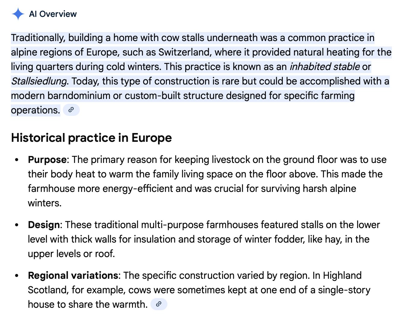

    Kind of an interesting twist on your idea of radiant floors in the barn is using the barn as the radiant floor of your house. I saw these in Iceland:
    The heat energy gained into the living space is measured in "B-T-Moo"
