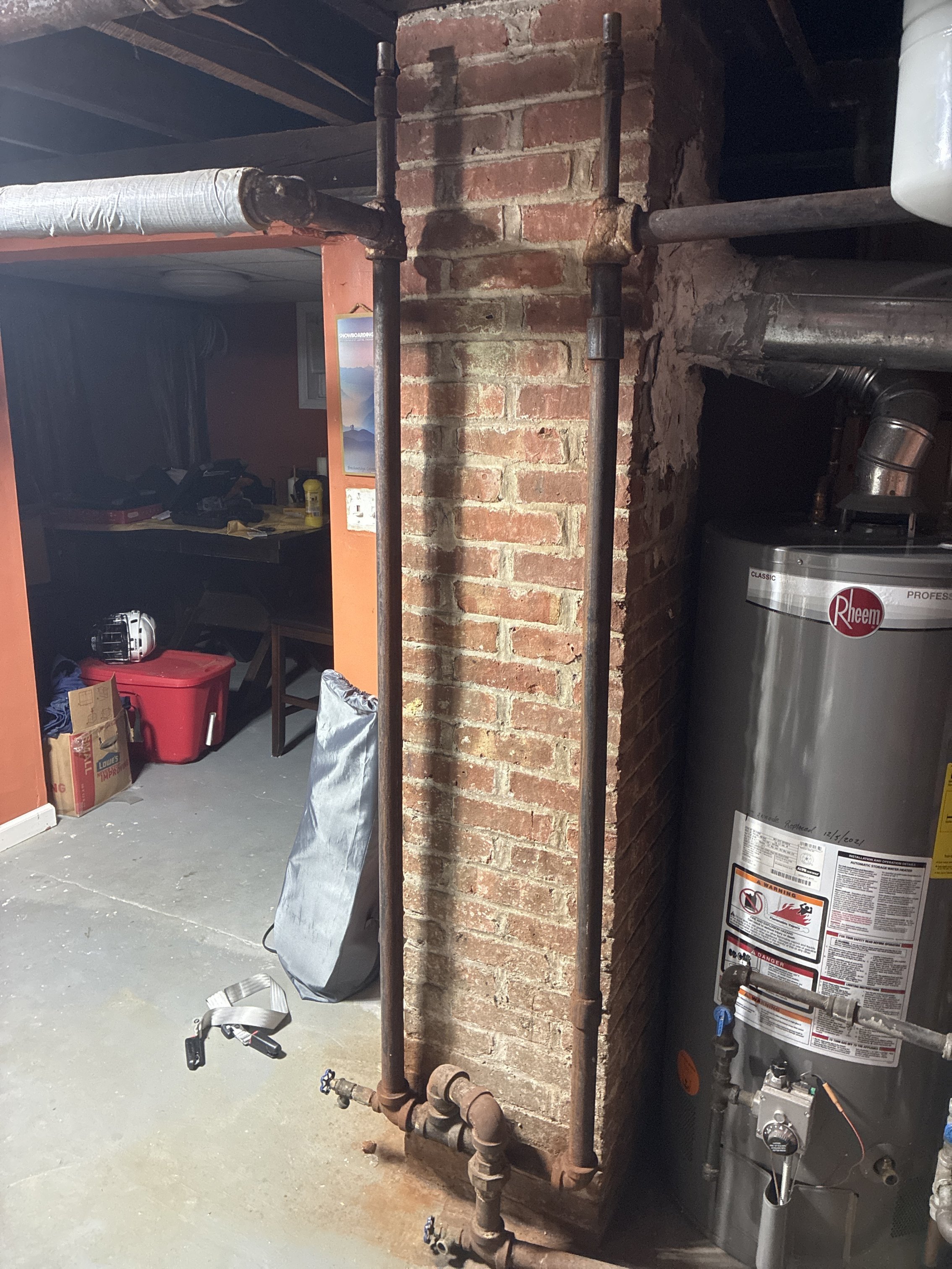

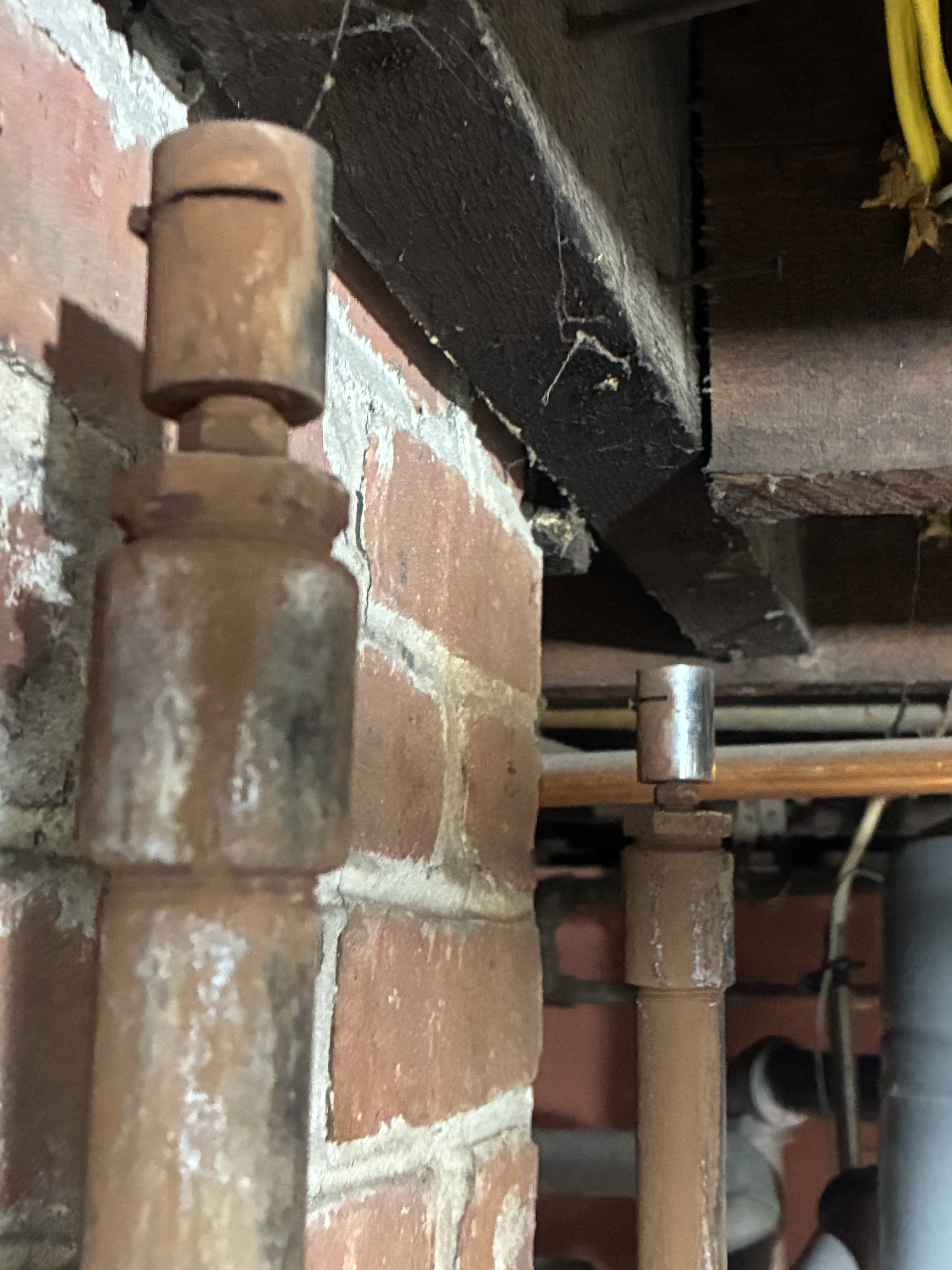

What type of vent should go on top of pipe near boiler in basement. Thanks thinking I need to replace what is on it now.

    Those look like Varivalve adjustable straight valves. They are not appropriate for main venting. They are intended to be used on steam radiators. You will want to remove those and the reducing bushings they are piped into. A Gorton #1, Gorton #2, Hoffman 75, or a Barnes and Jones Big Mouth would be appropriate main vents among others. You can find them at SupplyHouse. How long are your steam mains? Can you provide us a picture further out, maybe someone here can give you a better idea of what size vent you need.

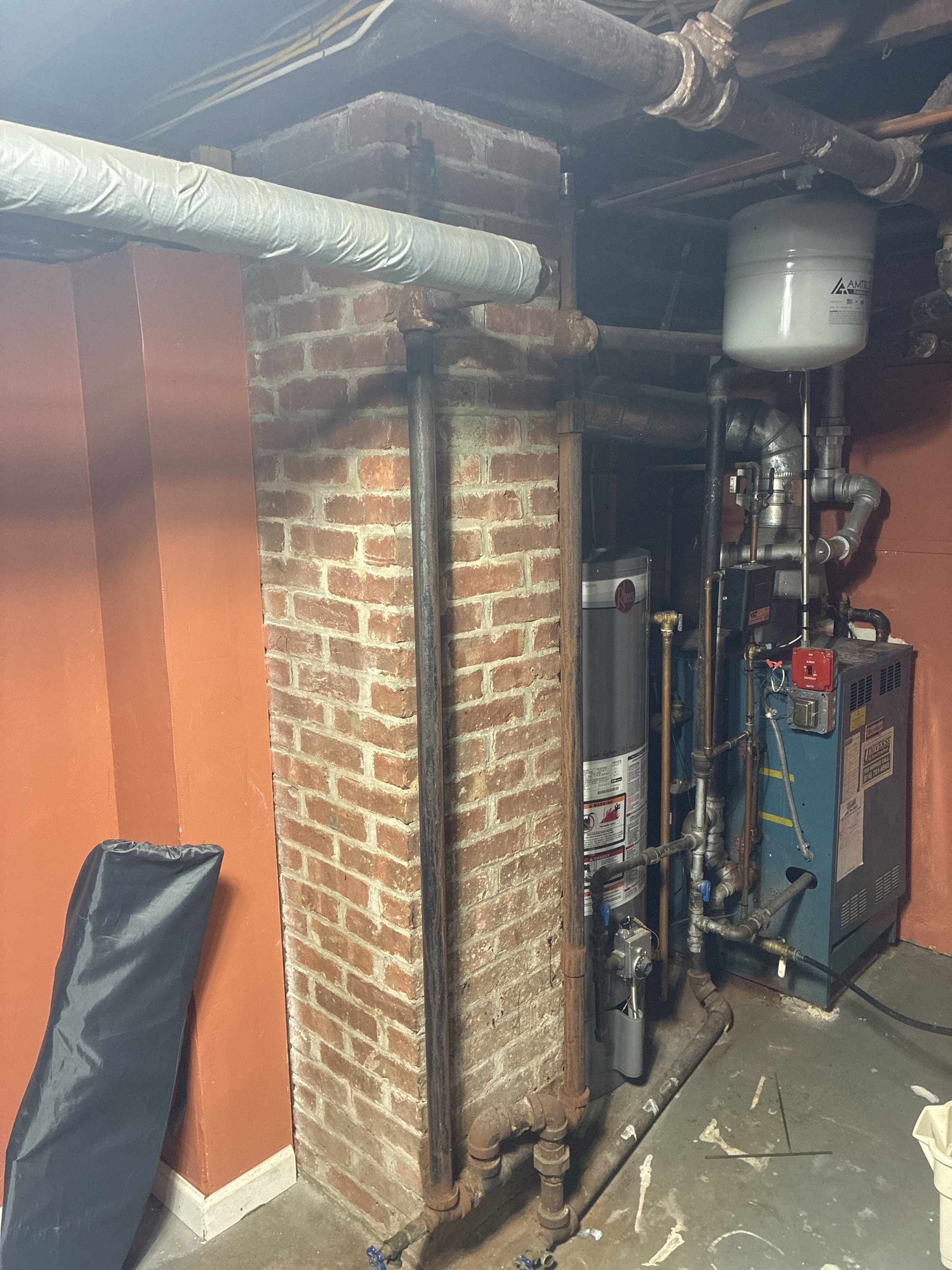

    Updated photos anyone have any ideas of what size vent. Probably 6’-7’ pipe

    We need to know the total length and size (diameter) of the steam mains in your basement, not counting the radiator takeoffs or risers to upper floors, to tell you what size main vents you need.

    probably about 1.5”-2” reduced down to 1“ where the wrong valve is.
    Steamhead Member Posts: 18,735
    And how long is each steam main, from the boiler all the way around to the vent?

    10-12 feet total length to vent
    ethicalpaul Member Posts: 8,933
    edited October 2025
    that seems very short, but if true, then you're fine with Gorton #1 vents
