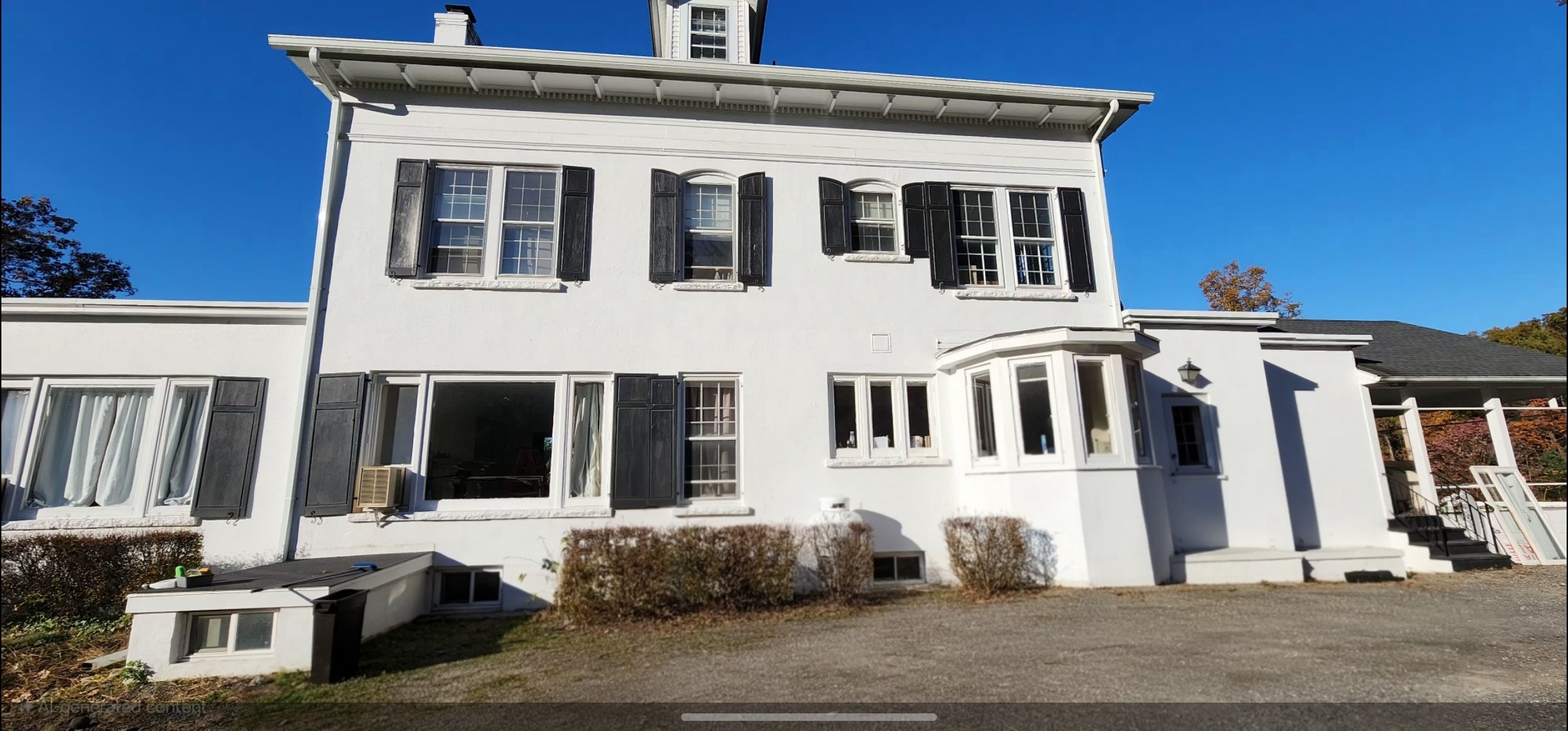

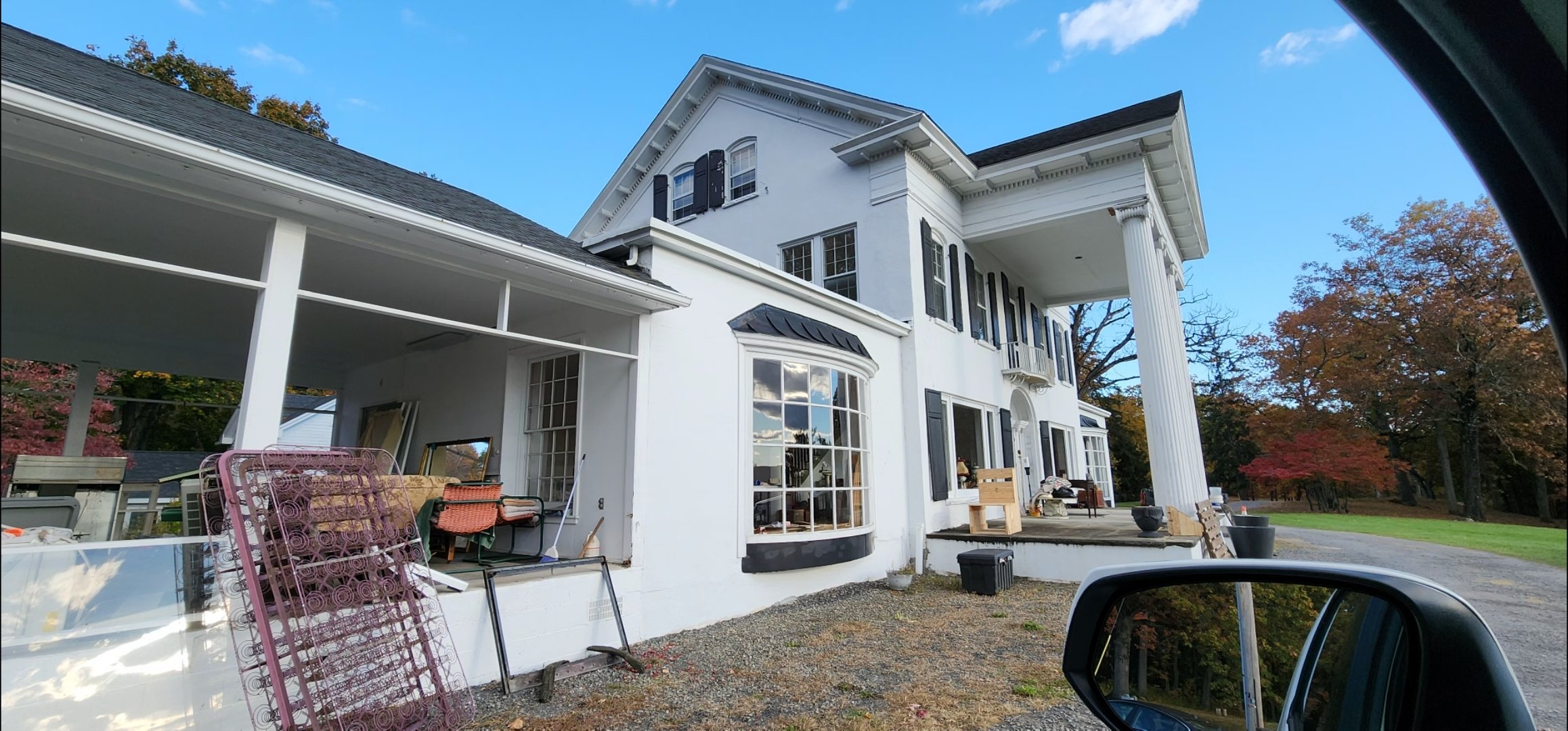

Please allow me to share a tale of woe. A sad set of circumstance that in part due to changes to the heating system by people not familiar with steam resulted in unneeded high heating costs and ultimately, the impending demolition.

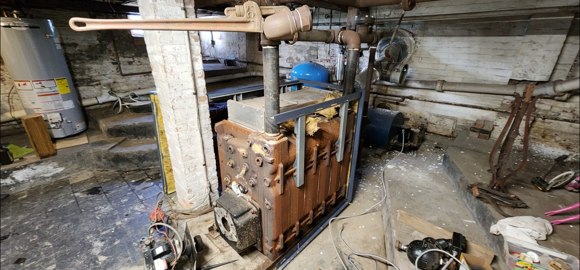

I just finished removing a Weil-McLain 680 that was installed in a beautiful neoclassical mansion that is being torn down to make way for an apartment complex, despite being in the same family for generations. Cost to run the boiler was around $20,000 for maybe 3000-3500 sq ft of heated area. This, combined with a high property tax bill, is why the difficult decision to sell their ancestral property wad made. The home owner installed the boiler himself in 2010, but did so supposedly under the advise of a steam expert. The boiler replaced one of similar size.
So either way, i finish loading up the disassembled boiler and I'm about to head out and notice a 2' section of copper baseboard convector with 1" radiator valves on either side and ask if it was representative of the radiators in the building. It was! Every radiator was similar to that aka: 4' of 1/2 finned copper.

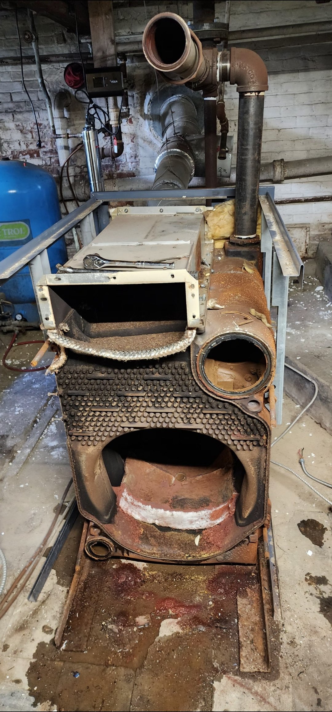

The boiler itself is ridiculously clean considering the hard well water- the home owner would drain and refill the system daily.
So the you have it. A steam boiler sized by the "its the same size as the last one" to heat entirely unsuitable radiators that replaced the orginals. Home owner changed his own boiler and installed a system designed by a remote expert who must not have seen the test of the system. It clearly would have been sized without measuring EDR.
Now the house is being demolished and nobody realizes a series of choices changed the heating system in to an oil guzzler when, in reality, it could be far better. Maybe if somebody got there sooner things could have been different.

    I suspect a few iterations of 'the old boiler only lasted 10 years, and the house is cold, let's get something bigger' were responsible for the 19 hp stream plant installed in a relatively small mansion.
    I don't know if the boiler would have been oversized for the orginal radiators the house would have had (I suspect so), but certainly the replacement radiation was not well matched.
    i mean like 2 years of that 20k would have paid someone to put in appropriately sized emitters and fix up the boiler to bring the heating cost down to the coupe k that it should be.

    up the vent. that poor boiler was firing 24/7 on the pressuretrol because it couldn't move much of the heat out in to that fin tube.

    I'm not blaming the boiler or near boiler piping, this installation could have been photographed for a textbook from Weil McLain's steam course. Tall header, swing joints, reducing elbow that tied into the return and Hartford loop all were perfect. And yes, if the rest of the system was performing as designed, the large boiler wouldnt have been so bad on consumption. Ultimately, it is the poor advise and modifications done to the rest of the system over decades that wasted heat. An expert commissioned the boiler after the home owner installed it, and aside from the uninsulated supply pipes, this expert wouldn't have seen anything that was out of place in the basement. I can only speculate how so much oil could have been burned, but the pile of scrap copper convectors give a piece of the puzzle. I can't say if a cheaper heating bill would have saved this house but it certainly is too late to speculate now.

    @ethicalpaul If you run a steam boiler with poor venting the house cant heat. The basement will be very warm (yes heat goes up through the floor) but the boiler will constantly cycle on pressure, and the fuel bill will be extreme.
    It's like a car. Drive the bumper up against a big tree and keep the gas pedal down. You burn a lot of fuel but don't go anywhere.
    All the old steam jobs I looked at if the boiler room was excessively hot look at the venting

    A steam boiler with no vents or bad venting, no radiators etc cannot get rid of it's heat so the burner just shuts down. The heat isn't going to just disappear. IMO it'll result in a cold house, but not astronomical fuel bills, it goes against the First Law of Thermodynamics.
    $20,000 in a season, you're not talking about energy steam mains can dissipate.
    it goes up the vent. if it isn't going out in to the system, it is mostly standby loss from the air being pulled through the boiler and up the vent. what was 20% on a normal system becomes 80% or 90%
    The burner runs and pulls heat up the flue with it, it runs a higher stack temp because the system isn't taking heat out of the hx, eventually (or rather quickly) the boiler builds pressure and the presusretrol turns the burner off. That heat that can't get in to the system then is taken up the vent with heated air from the house(or in to the boiler room and out the vent for other appliances and around the sill) until the temp/pressure drops enough for the pressuretrol to kick back in and it repeats the cycle.

    If I had to guess, the house was over radiated with the orginal cast iron and to combat this the baseboards were installed. As far as i know the house was sufficiently warm, just with a huge fuel bill. Both inlet and outlet connections were 1" on the assembly. The pipe then split off into the two copper pipes in the convector. These weren't slant fin baseboards but rather 2 copper/aluminum finned pipes with a stamped sheetmetal cover that resembled cast iron baseboard heaters. There wasn't any vent so i don't know where the air would escape to if not further down the line.
    convectors will work fine on steam if they are properly installed. Convectors are in no way shape or form baseboard.
