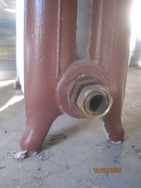

On FB Marketplace, I found this old thing for an attractive price, so I bought it. Its ERD is about 20 square feet, which is plenty. Looked lighter than its 160 lbs but I got it home.
The seller is a nice guy but when he verified the inner diameter of the condensate fitting for me at 1-1/4", he must have gotten confused. It's one inch ID, and my new Legend radiator angle valve is 1-1/4.
I'm pretty sure none of the old iron fittings will move with household-type motivation.
My guess is that I'll have to take out the brass one-incher and replace it with some kind of adaptor piece. Worst calse, I'll have to find a way to get the steel reducer out and replace it. That will be work, and likely require a blow torch to heat everything up.
Before I go to all that trouble, does anyone have a better idea? A steel adapter could be made to fit easily enough. Obviously, there'd be condensate trapped, but I don't think that'll be a big problem.

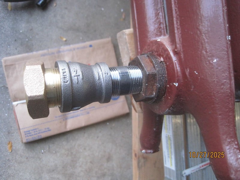

    Rather than use a lot of words, let me simply ask:
    Okay to connect like this?
    People might say that the water trapped by the bushing will be a problem, but I don't think it will. I think it will work but if it were mine I'd try like heck to get that bushing out just based on principle
    Agreed. Kind of a kludge, but it will work OK.

    Just a quick update. Spurred on by Paul and others, I got out the three-foot wrench and a mallet, and with the appropriate encouragement, two of the bushings came out. I would have loved to remove a third, which has probably been in this radiator since the house it came from was built in 1900, but no dice. All I did was create marks on the 1-1/4 square wrench flats.
    Which means I can use the radiator, no problem, and install a vent on the opposite corner of where the steam comes in, BUT I can't use the pretty side and instead have to turn it 180 degrees, which means painting. This being in the upstairs office, which nobody uses but me, I'm not inclined to make much of art project of it. Does anyone have experience with simple spray paint? I've used regular "up to 180 F" paint and regretted it, because it outgassed and smoked for quite a bit before settling down. I'm not doing that again.

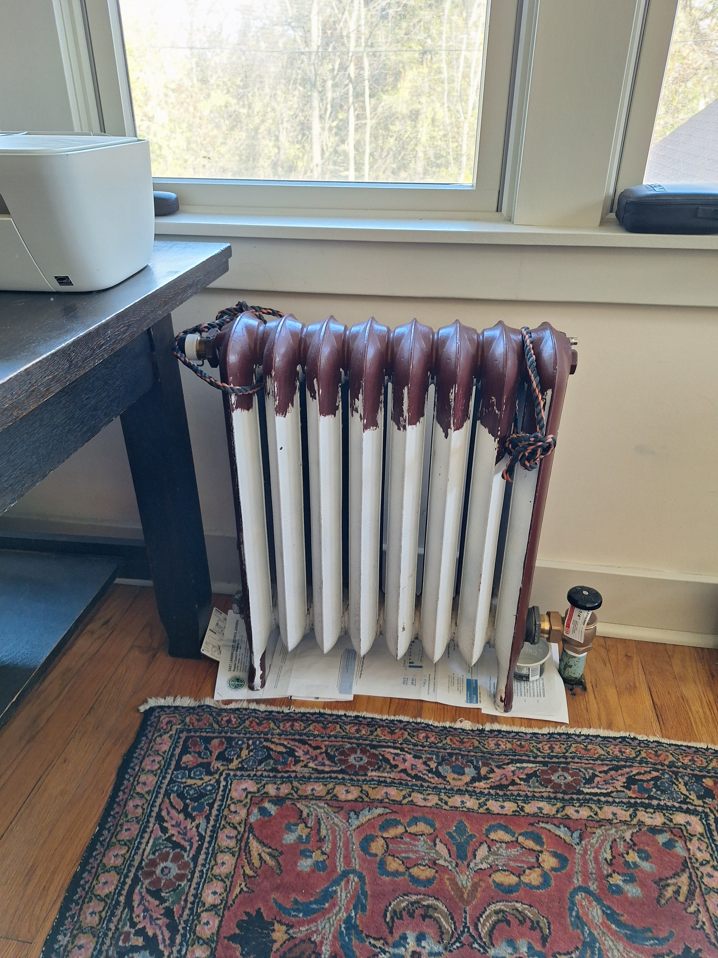

    After inquiring about sandblasting & powdercoating, I decided to attach the radiator and make sure everything was shipshape before I increase my "investment" in this thing ten-fold. This picture is from the initial installation, and the clever closure on the former hot-water inlet served to keep steam from escaping.
    A 1" hole makes quite the vent.
    Any room is improved with a Persian Sarough even if it's tiny .

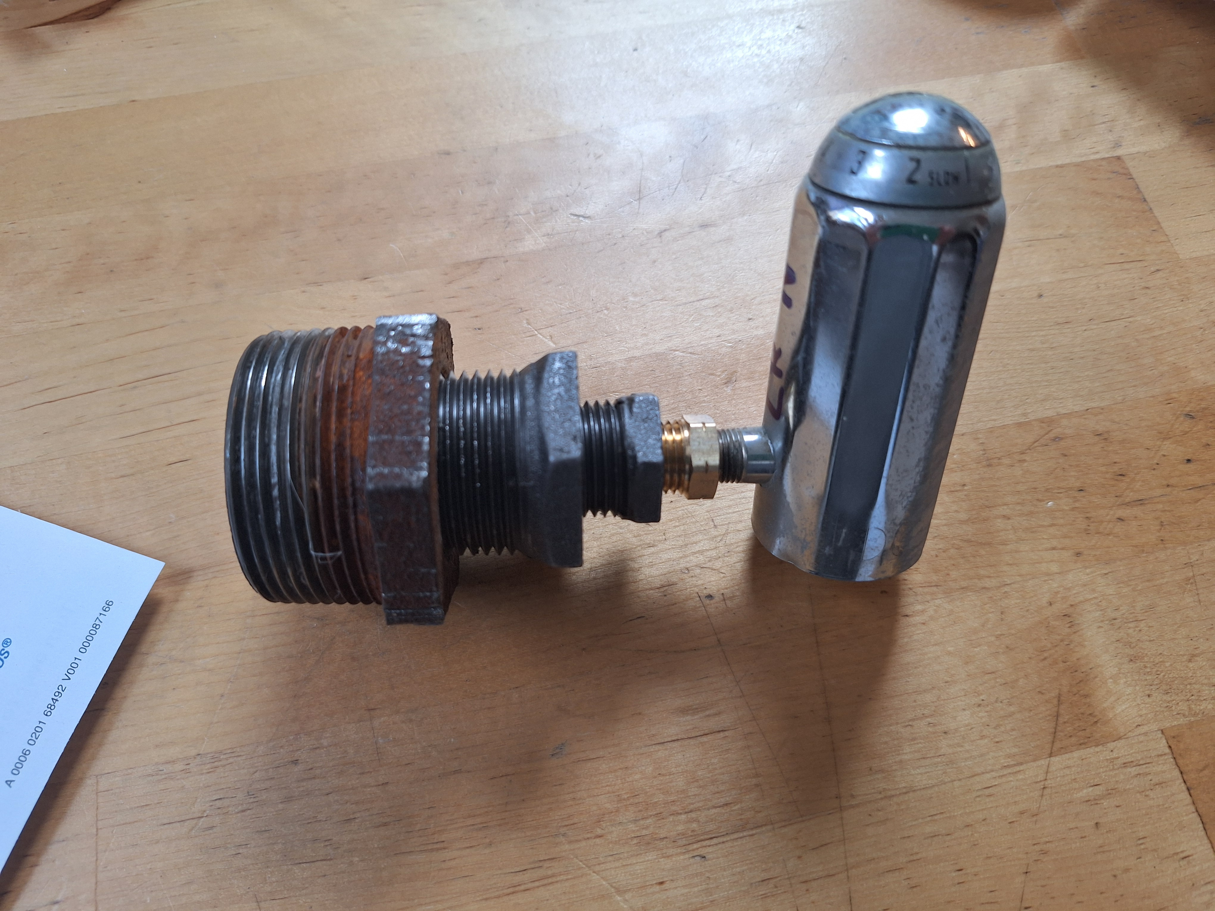

    After the successful initial test with zero leaks — that's what the paper was supposed to show — I went to Home Depot to LEGO together fittings for the vent. I took an ancient vent with me so I could make sure.
    It's the opposite of elegant but it works. By now of course it's all screwed together properly and much shorter — and wears a Maidomist #5 on the end, not this ancient thing. With the fairly large vent it fills quickly.
    The korrekt thing would be to drill & tap the hole that is sort of pre-cast into the end sections at mid-height, but I wasn't feeling the level of effort and mess. This way, only about 2/3 of the radiator actually gets hot, which is right for this small room at 8 x 14 ft.

    Next I'll follow Paul's advice and brush-paint it with acrylic paint — if I get another day in the 50s where I could open the windows for the initial outgassing.

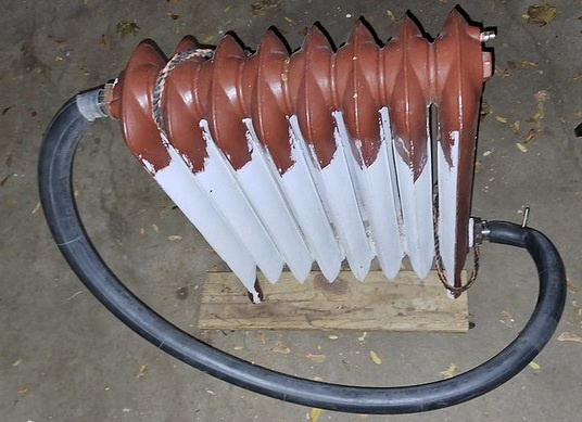

    And BTW I did a high-tech pressure test first. It's always good to have some bicycle inner tubes lying around.
