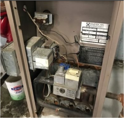

    Gentlemen/Pros, I need your continued support in regard to my AmStan GPM 1BJ1 boiler and control.
    I have achieved baseline. You may recall that I was struggling with control function. I was able to achieve baseline operation by removing the three terminal aquastat (that appeared to be a replacement) and installing a limit (L4080D 1010) that was original to the unit. I have also been able to neaten-up wiring allowing for thermostatic control and syncronized function of burner and circulator.
    HOWEVER heating function (temperature) and cycling are not what they should be:
    -Outdoor temp 40 with indoor thermostat set to 71;
    -Boiler fires…runs 5min…produces only moderately warm water 130 and shuts off (somehow the stat appears to be satisfied?)…cast iron baseboard only warm.
    ? The L4080D was used (in a box in boiler room)…specs are 180 upper limit; appears to have NO differential.
    ??Do I have a bad aquastat?? How do i ensure that the boiler produces a reasonable temperature in spec with boiler requirements and adequate heat in the house?
    Thanks all in advance!

    mattmia2 Member Posts: 16,744
    you need to measure the ac voltage across the various controls to figure out which one is open. if the control is closed the voltage will be more or less 0. my bet is on the thermostat having a very wrong heat anticipator setting. after it shuts off, does it fire again in 5-10 minutes? with a standing pilot i don't see much else that could do this other than an unusual defect in the wring or the contacts of a control. if it had electronic ignition i could see a couple other ways what you're describing could happen.
    can we see a picture of your actual controls, especially the gas train, not just some random picture off the internet that you think is the same?

    Yellowlab Member Posts: 22
    Gas Valve wiring. I forgot to mention that there is a power vent wired into the gas valve. This is the control wiring that you see. Works as intended.
    the proving switch on the powered vent is highly suspect here, possibly bad but more likely doing its job.

    pecmsg Member Posts: 7,053
