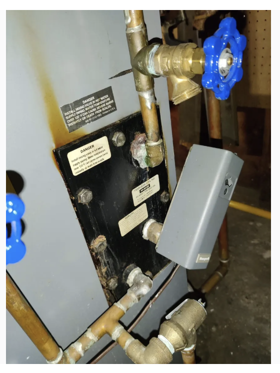

    I would want to see exactly how your water is heated. I'm not familiar with that boiler. Do you have an indirect water heater or is there a coil in the boiler? How often is the boiler cycling?
  • mclewis
    mclewis Member Posts: 4
    There's a coil in the boiler and it's cycling several times a day. I have not timed the cycles, and I can do that if it helps, but as I said, I do know that the boiler burned 160 litres/month this past summer to maintain standby DHW temperature. This happened even when there were no calls for DHW. (I did not adjust the aquastat temps and the hi was 180, the lo was 160, the diff was 20.)

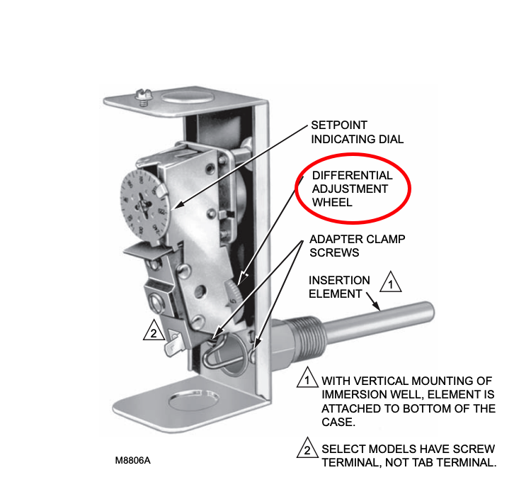

    Based on the age of the boiler and the way you are heating water there are several things you can do. Thew lowest cost option would be to determine what is the aquastat that is the low limit on your boiler.

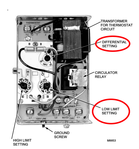

    On newer models that have a triple aquastat relay like the the Honeywell L8124 it is easy to find. It says LOW on the dial. First find the DIFF and turn that to the lowest setting. Now turn that LOW dial to 140°. See if that boiler temperature produces enough hot water. If you find that water is not hot enough for taking a shower, then turn the setting to 145° to see if that is good enough. keep turning up the dial until your boiler can produce the needed hot water. The idea here is that the lower the boiler temperature is the less stand-by loss up the chimney there will be.
    In most of the north east USA and Canada the cost of heating water with electricity is usually more expensive. (but not always) I
    If your boiler is very old you may find that there are two or three individual aquastats that will perform that function that may look like this
    The two aquastat wiring diagram will have the high limit, that is usually located near the top of the boiler to shut off the burner when the water temperature goes above that setting. That is always the higher temperature setting aquastat. there is no need to adjust that. The other aquastat will be the combination LOW limit/revers. This one has 3 wires connected to it. This is the one you want to set to 140°.
    Some older models (pre 1960) may have three aquastats. the high limit, the low limit and a reverse aquastat to allow priority for the DHW. To determine which one is the reverse aquastat, you can look at the mercury bulb inside it to see if the wires are on the opposite side of the High and Low limit.
    What ever wiring design you have, all you need to do is to lower the LOW temperature to 140°
    The high limit does not come into play for DHW. Only for space heating

    If you have the separate aquastat relay and you open it up and find that there is a differential adjustment, set that to 10°
    Hope this info helps

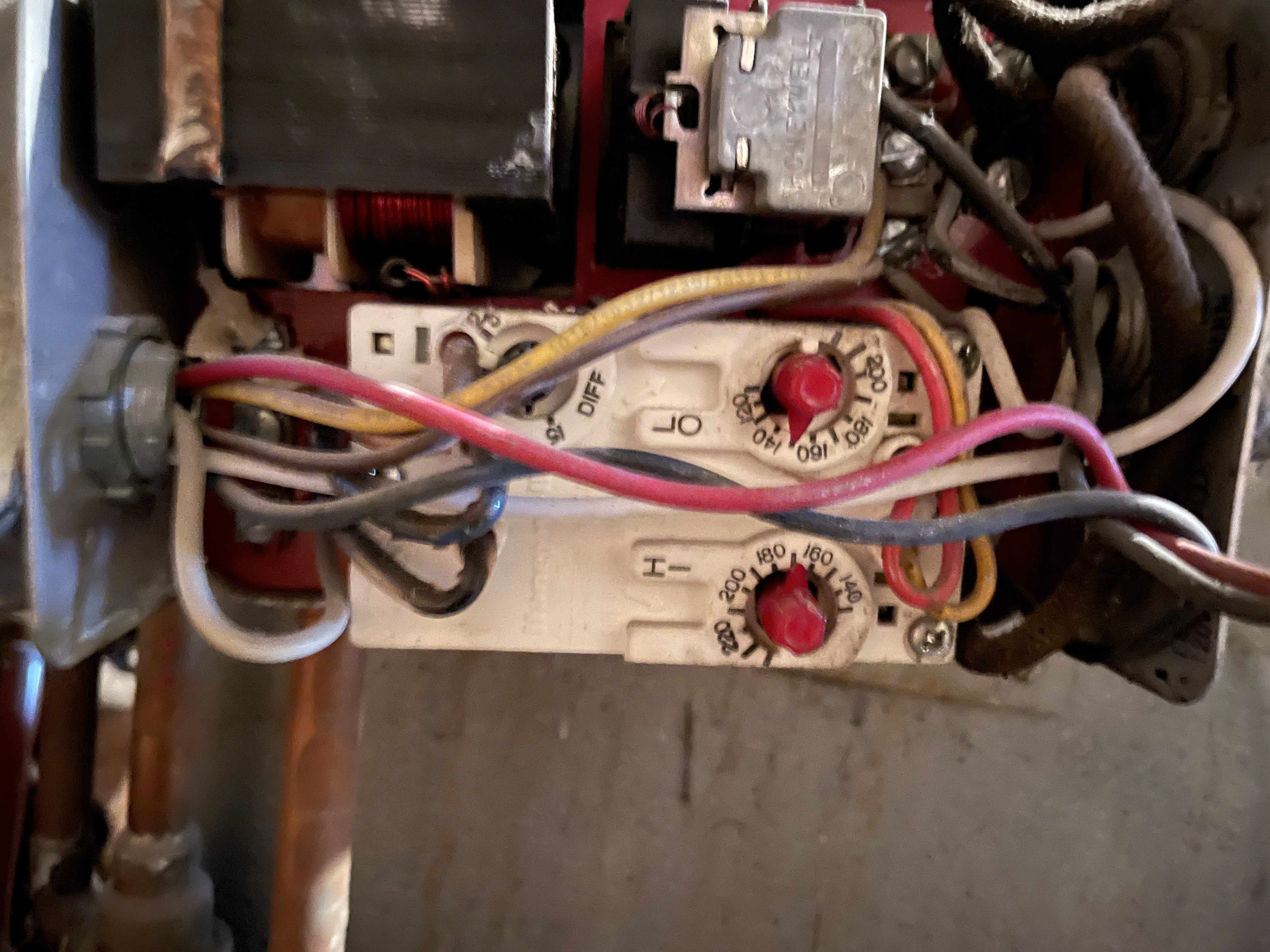

    Hello there Ed, and and thank you so much for your thorough response! To answer your question, I'm not in the southern hemisphere! I'm in north eastern Canada - Newfoundland to be precise. Thank you so much for those pictures of aquastats. The visuals really help. I've attached a photo of mine which is the Honeywell L8124.
    When I had the oil company service guys here recently, I asked them to check those settings. They were the ones who had set them at hi:180, low: 160, diff: 20 and they assured me those were the 'correct' settings for optimum performance. (Unfortunately, I've rarely found them to be helpful when it comes to troubleshooting ways to reduce oil consumption) I've taken your instructions and adjusted the low to 140 and the diff to 10. So far, I am finding the DHW temps just fine, but it's too soon to know whether (and how much) we will save on oil consumption under this regime. I'd be curious to hear from you how much you anticipate this will reduce the oil consumption for DHW?

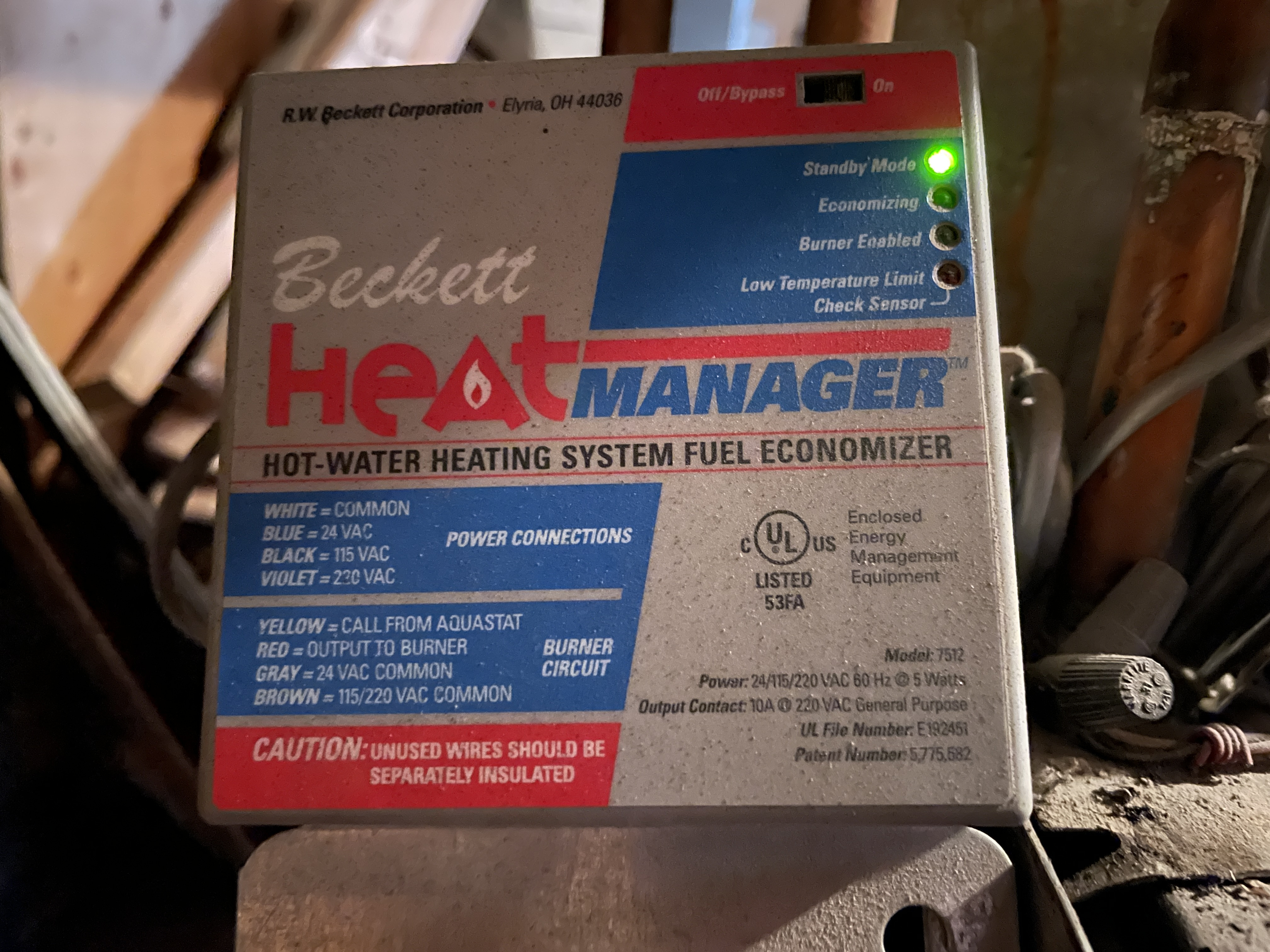

    The last question I have is regarding the "Beckett Heat Manager" that is pictured here. This control had been turned off (by the service guys). I turned it back on, but I have no idea what it is for, or whether it is doing what it should. Wondering if you have any insights to offer? Thank you in advance!
