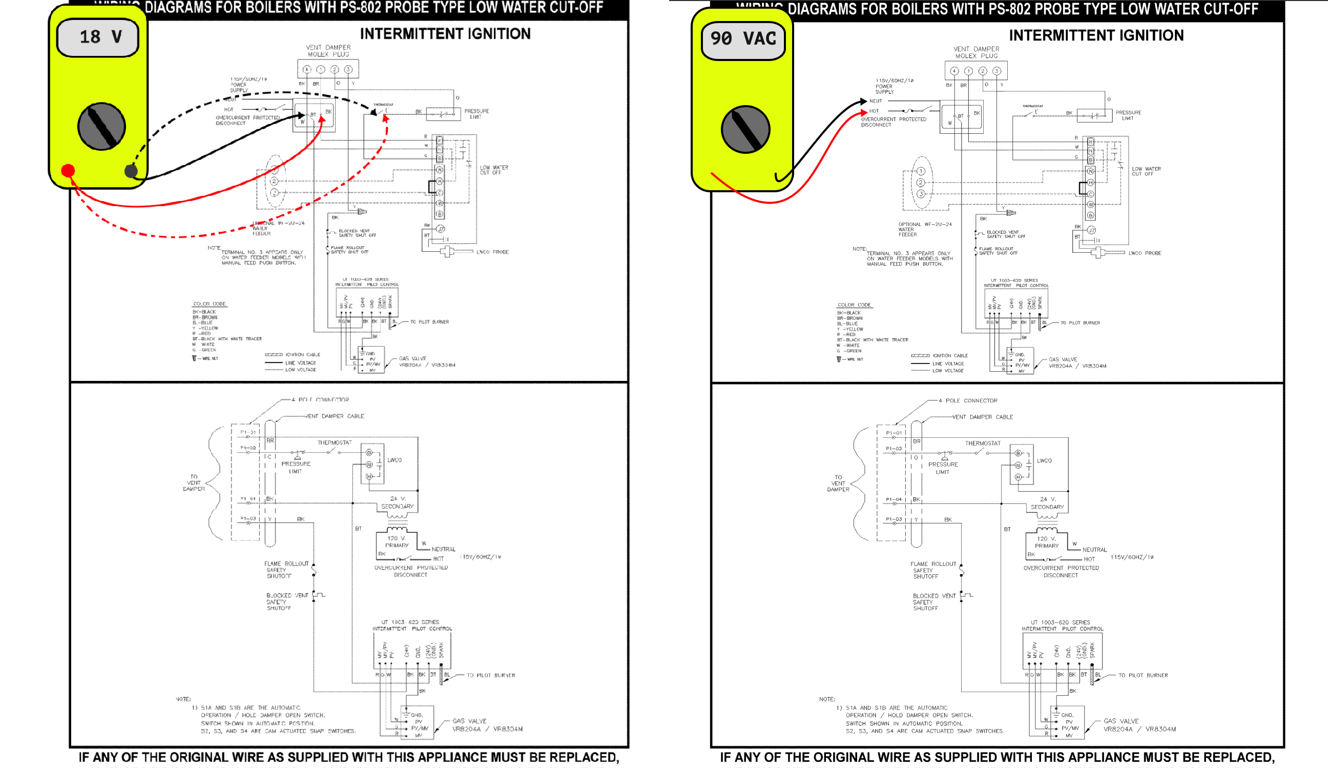

    where did you measure the voltage.
    Did you measure the incoming
    voltage?
    HotRod1975
  • I measured it at the transformer and thermostat wires both receiving 18v
    pecmsg Posts: 7,634
    What terminals it takes 2 points to measure
    and incoming voltage?
    At the transformer terminals you should get 24volts all the time. Anything below 21-22 volts is suspect.
    You can't read volts at the thermostat unless you have an R and C wire. The thermostat is a switch not a load
  • I believe that @pecmsg wants to be sure you are measuring the 18 VAC. at the proper terminals. LIKE THIS:
    On the left diagram you should be checking the transformer R and C terminals, with the thermostat calling for heat (solid leads) The thermostat should be checked at the thermostat location with the thermostat not calling for heat to get the voltage reading using the R and W terminals at the thermostat.
    Some transformers on some steam boilers have up to 5 terminals. You always want to check at R and C
    Also did you check the incoming voltage to the transformer? Right diagram if that transformer gets less than 120 VAC coming in then it will hhave less than 24 VAC coming out.
    Intplm.Alan (California Radiant) Forbes

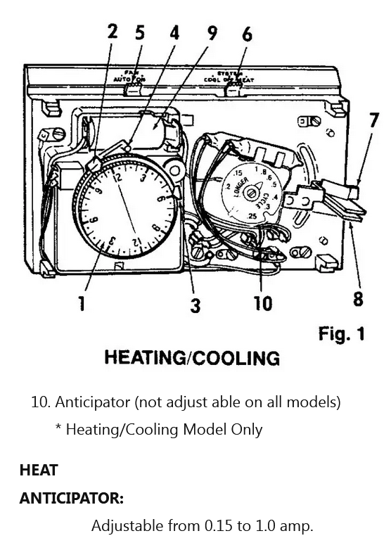

    now trying to set up my anticipator on thermostat to the right setting. Any suggestions?
    109A_5 Posts: 4,759
    Typically the starting point for the heat anticipator setting is the actual gas valve current.
  • What thermostat are you using that has a heat anticipator? The oldest 70 series thermostat I can find on the web is the 1F-75 and that one is digital no heat anticipator in that one.

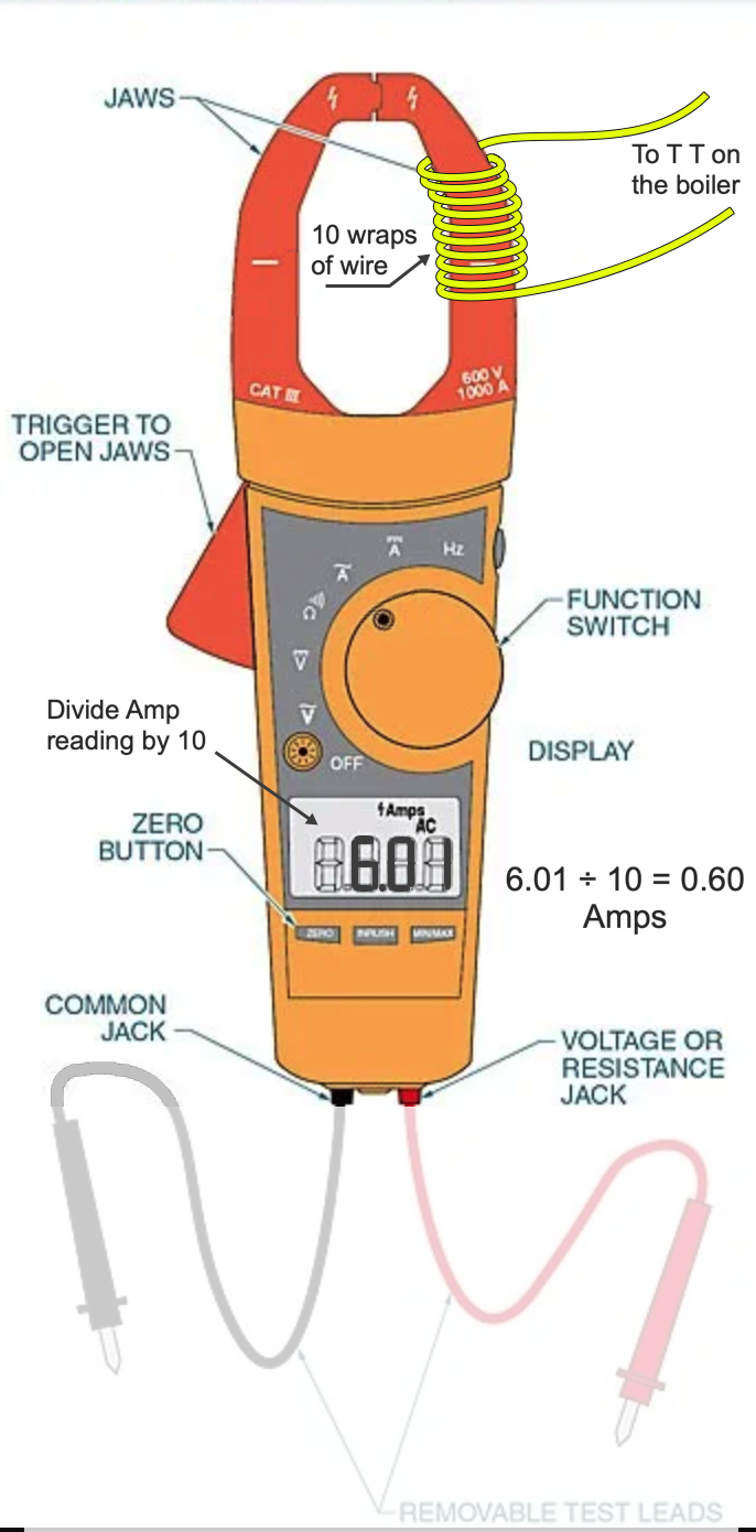

    If your thermostat is like the one shown in @109A_5 Post with the mercury bulb on a bi-metal coil then that is the old school heat anticipator. To check the current draw on the thermostat circuit you can use an amp meter to see how many amps the circuit draws during a call for heat. If you have an electronic ignition control, that may draw more amps on the trial for ignition (Start Up) portion of the call for heat, then drop down to something less than that for the operation portion of the cycle. You wan to know what the actual amperage draw is during the operating portion of the call for heat , not the start up portion of the call for heat.
    Here is a diagram of how to use an amp meter when the lowest scale is not low enough for a proper reading. You can make 10 wraps of thermostat wire (yellow) around the clamp and read the amperage of the thermostat circuit., then divide your total amp reading by 10.

    109A_5 Posts: 4,759
    @EdTheHeaterMan
    https://manuals.plus/emerson/emerson-1f70-series-autometic-set-back-set-up-thermostats-manual
  • That's the one I thought it was. Installed many of those in the 1980s
