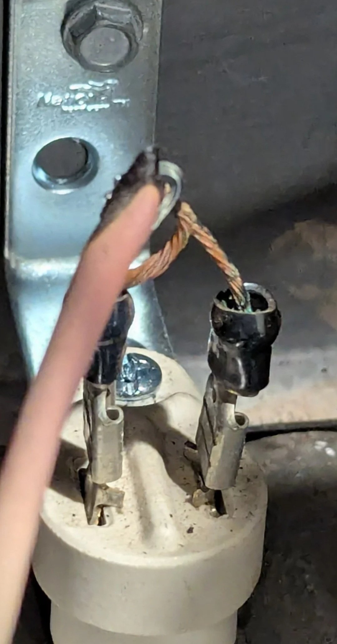

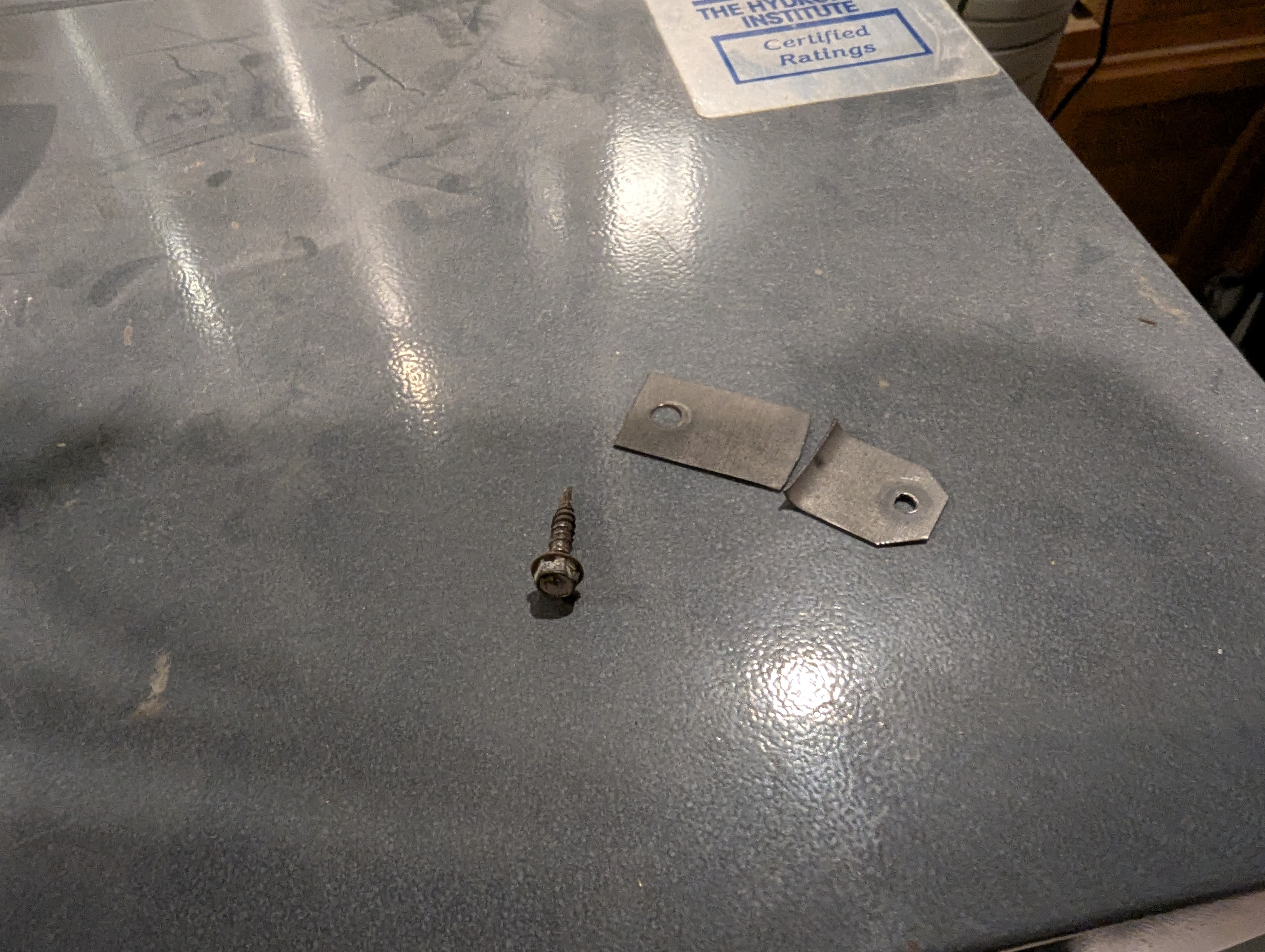

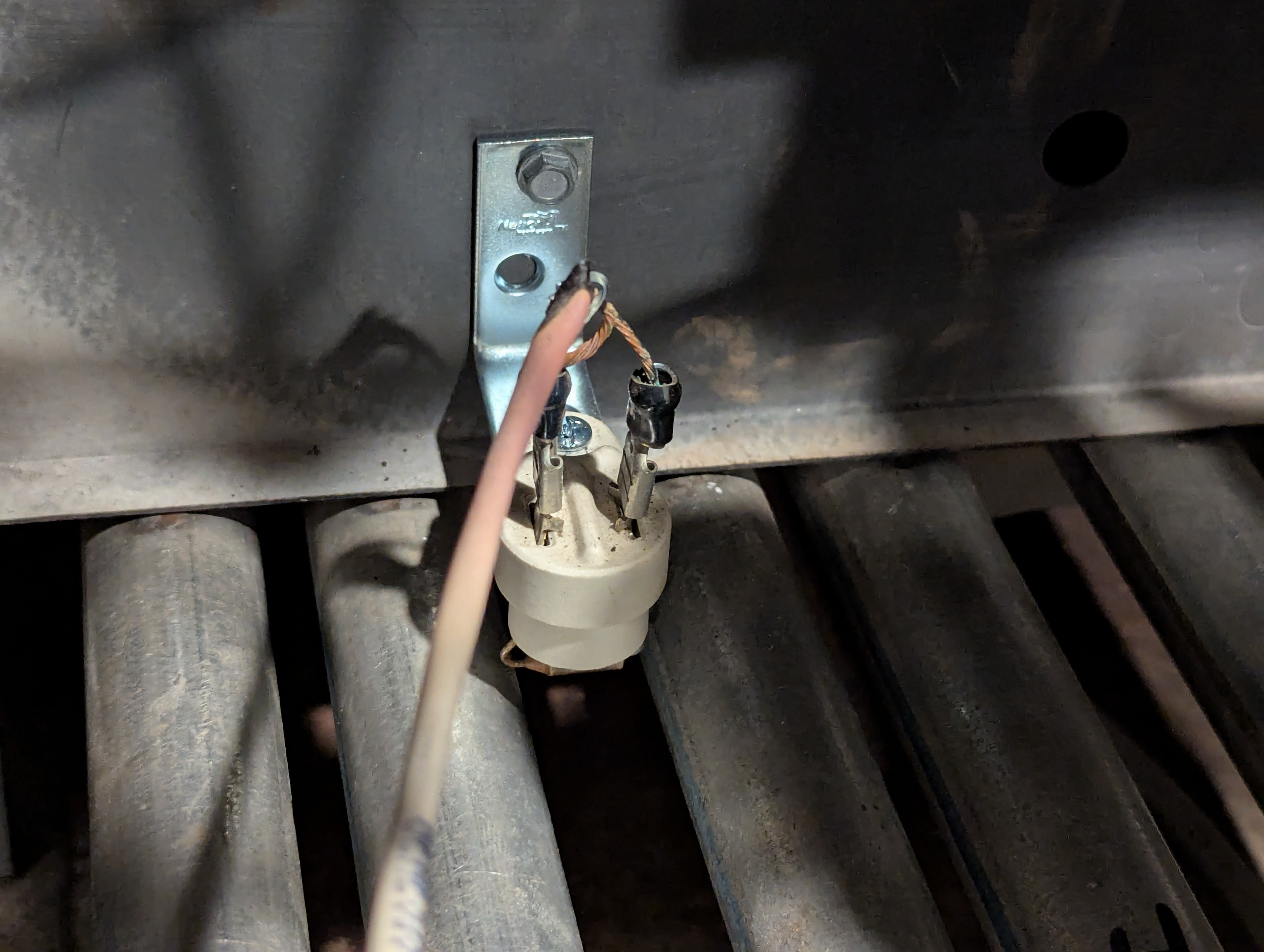

The bracket for the flame roll out sensor snapped in half while cleaning inside the firebox. This was my solution.
Effective? Or is there some unforseen hazard I've created?

    The bracket looks ok. The wires and crimps not so much.

    Yea, I noticed that, they look at a little over done. I would cut it back and recrimp but it'll probably just happen again. I made sure the wires are not touching so the circuit is cut if the sensor gets cooked. This bracket also pulls the whole Assembly about a half inch further back from the cover plate. Maybe less heat now…
    put some fiberglass or similar sleeving on it when you reterminate it. if the wires to it short it will not sense rollout
    i would have used a little piece of hanger iron to make the bracket

    find out why the wiring is burned!

    that too. but strip the cable outer jacket back several inches and sleeve it with fiberglass, otherwise it will be the mr coffee situation.
    If you're getting roll out you need to find and solve that problem

    That looks like a new roll out switch, so I guess the old one must've done its job.
    IIWM, I'd be looking at why…

    The metal was brittle and fatigued. It snapped as soon as I lifted the cover off the keyhole screws. It would have broken for the next person regardless of who or how skilled. I would have exerted more force trying to take the wires off so I moved it as one piece.

    Even more *eye rolls*. The wire is bare. Something's not right, or (I suppose) wasn't right in the past.
    Flames might not have licked it, but flue gasses did.

    I'd say the new bracket is fine, probably more durable (thicker metal) than the original. Since it was not installed by the OEM, my question is, is it in the correct position. With normal operation the wiring should not be getting damaged. Damaged wires may compromise the safety benefits it was installed to perform.
    hot_rod Posts: 28,705
    the door that the bracket is mounted to looks like it has been pretty hot also? I’d wonder why the service company added two safeties if it was running and drafting properly.

    The wires are burned, the heat shield is discolored, It is an after-market control but your fixated on the bracket. There are other issues with that unit.

    Ok. You upgraded the boiler by adding the Spill Switch and Rollout. That's good. But the wiring to the Rollout is obviously suspect. It needs to be protected.

    The burns could be due to poor draft, or it could be due to poor crimps. Both need to be checked. Either way, by posting about the bracket, you brought a possible problem to the keen eyes of the people here, who are only trying to help make sure things don't go boom.

    I'm going with bad crimps. And with the insulation gone, are the wires touching each other?

    it is the current, not the voltage that generates heat so you can generate enough heat to burn connections at 24v but I think that is rollout that caused the damage in this case. the bigger danger rather than failure is that with the insulation melted the wires can short together and bypass the thermal fuse rendering the safety inoperative.
