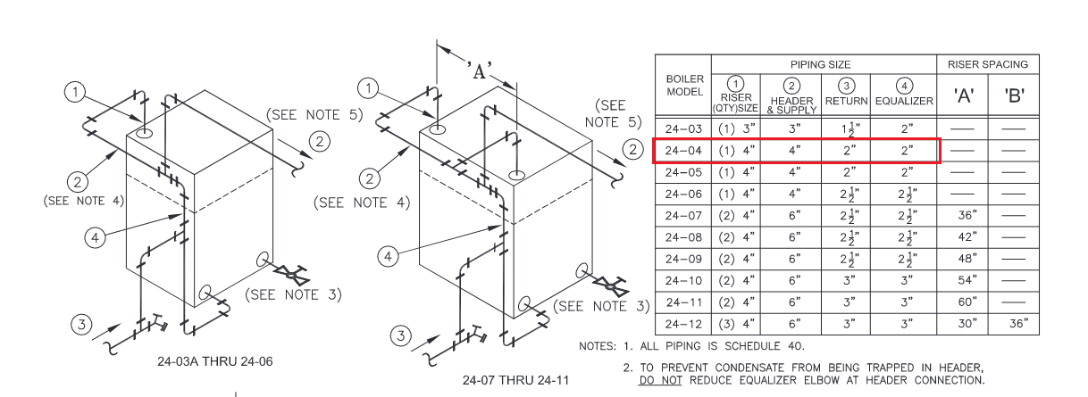

Looking for help.I just installed a new crown boiler with a beckett propane gun. When there is a call for heat and it starts making steam the sight glass goes empty and the low water cut off trips. What can cause this?

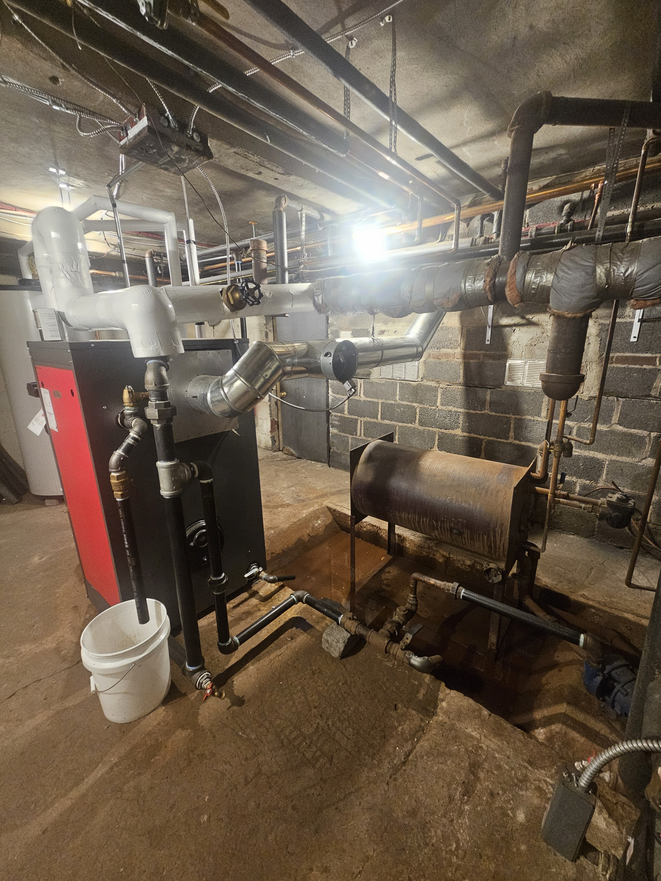

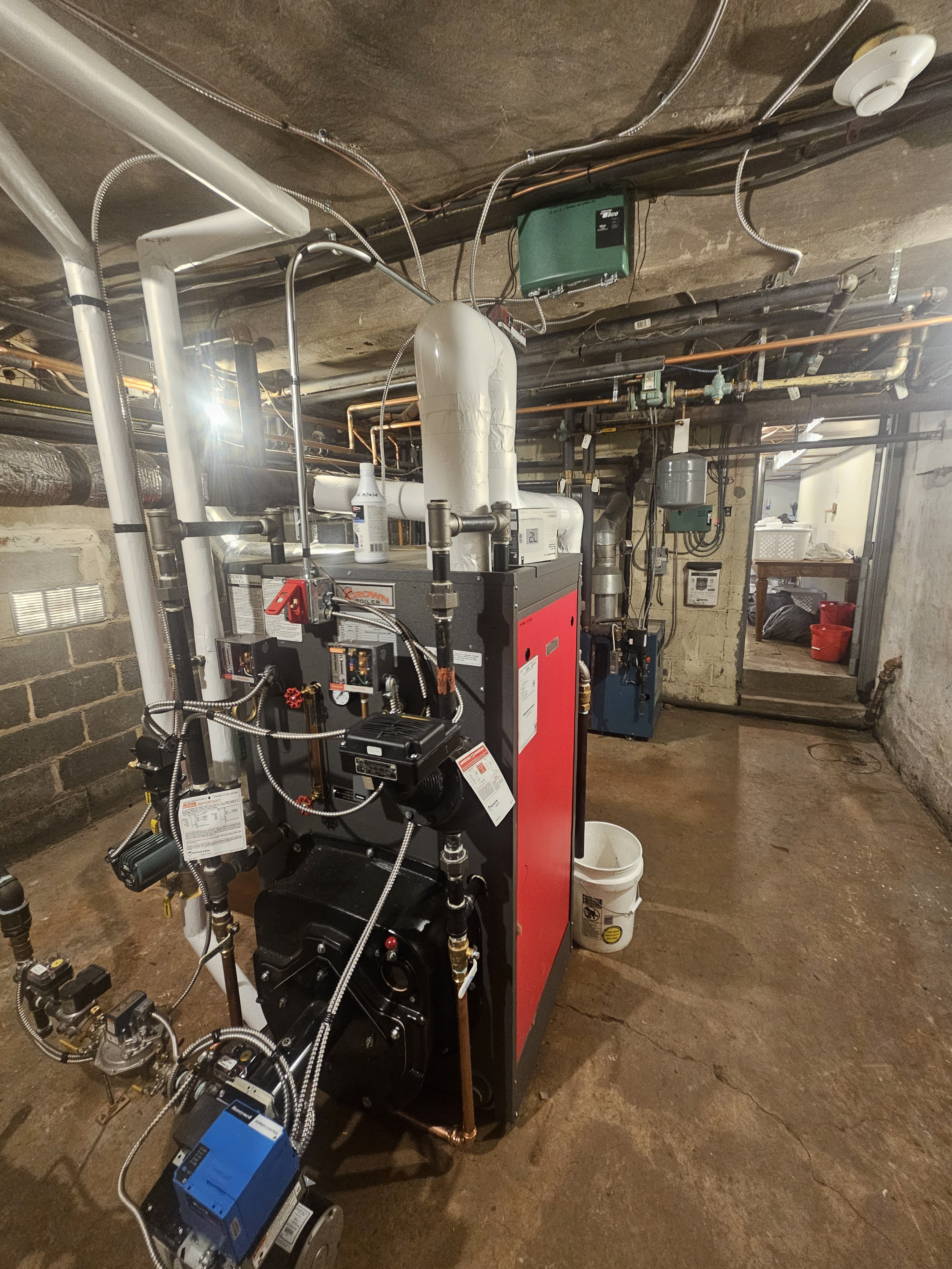

    oil on the water, improper near boiler piping. it may just need skimming. how long did the installer spend skimming it? show some pictures of the boiler and piping from several feet back.

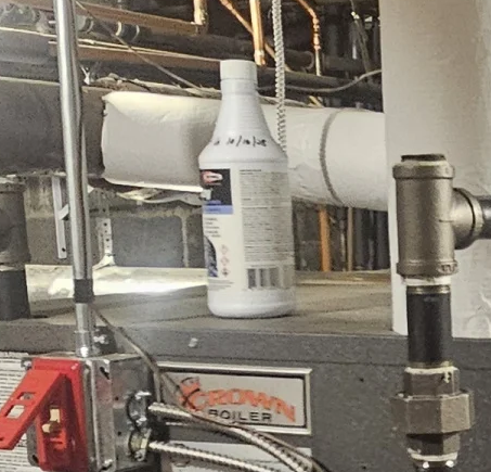

    oh, and additives in the water that make it foam.

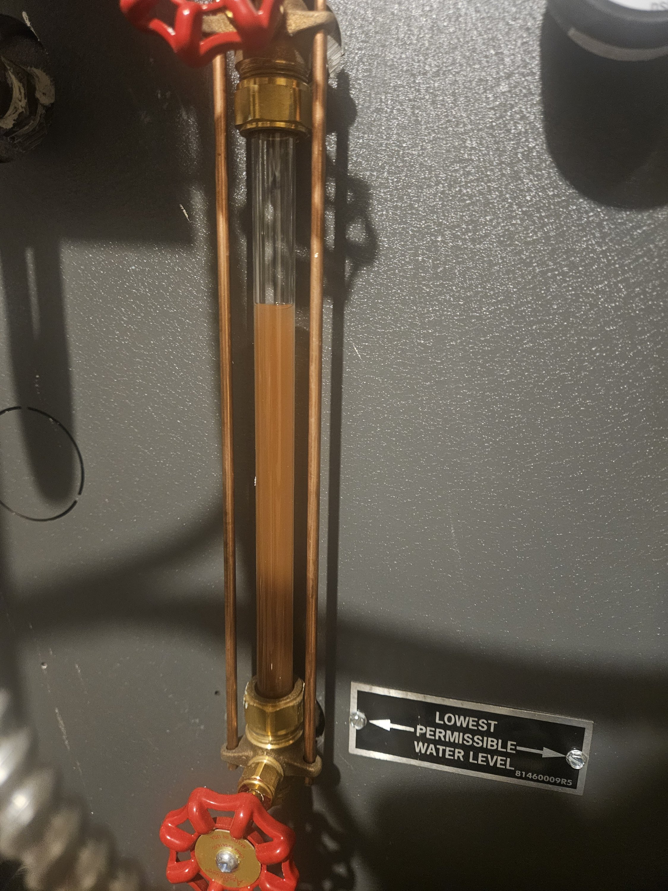

    When not steaming, how does the water in the sight glass look ? Any oil film at water line. Pictures may help.
    As other have mentioned the boiler and the water were probably not skimmed and cleaned. Or it isn't piped properly

    The water in the sight glass should be clear.
    Boiler model ?

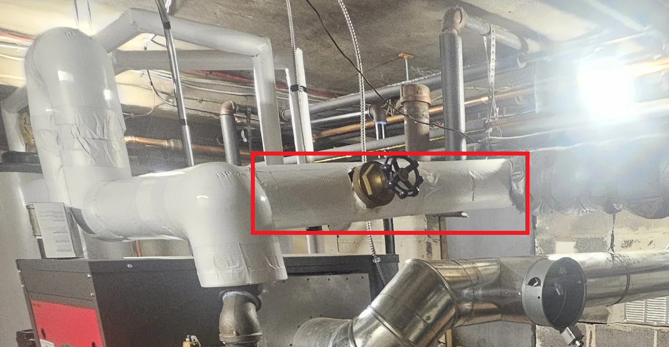

    That appears to be a drop header. With that size boiler it would not surprise me if there should be two risers coming out of the boiler.
    How much of this stuff is in the boiler ?

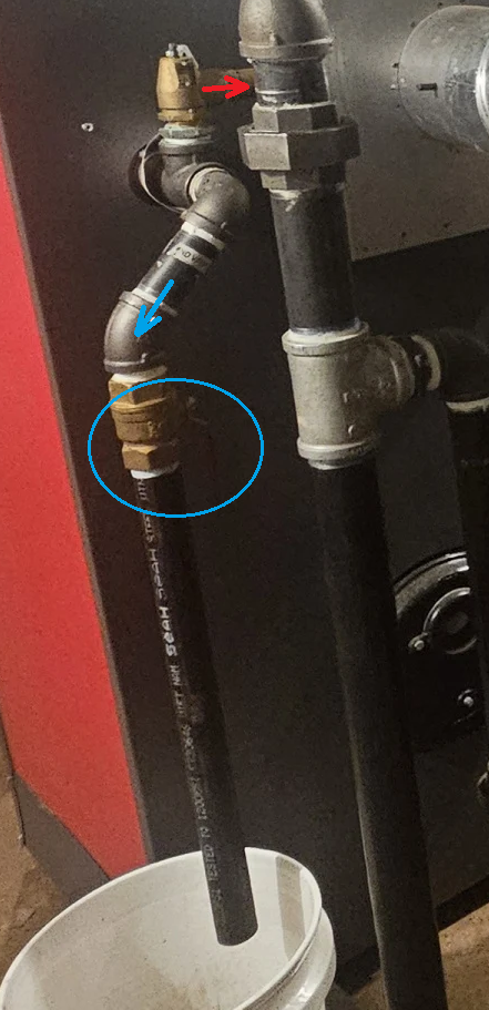

    I'm assuming the safety relief valve path is the Red arrow and the Blue arrow is the Skim port, why does the valve handle (Blue circle) look like the valve is open ?
  • Crown 24-04
    Only one bottle
  • That is correct with the path of the pipes

    also, it isn't really a drop header, the riser to the main has to be up, not horizontal. It is about equally likely that water that gets in the header will go in to the mains vs back in to the boiler through the equalizer.

    Is the riser and header both 4 inch pipe ?
    109A_5 Posts: 4,759
    This does look counter-flow ish, could be better.
    Would have been a cinch to make it right. Should have dropped the heater below the steam supply. If they had to swing it to miss the boiler jacket so be it. Then the steam could have come off the top of the header.
    Then drip the counterflow if it is really counterflow,
    109A_5 Posts: 4,759
    Not sure if the mains are counter-flow, I just meant the part in the Red box is.
    @109A_5
    True but the supply should not be coming off the side of the header, it needs to come out the top
    or at least at a 45. the steam should have to go up so the water can't follow it.
    what is happening one way or another is liquid water is being thrown out of the boiler and in to your mains.
    if the boiler is surging (producing steam in violent bursts instead of an even steam because there is oil on the surface of the water) or priming (foaming because of too much additive in the water or other water chemistry problems) or just normal carryover of water droplets entrained in the steam, that header with the riser to the steam main horizontal isn't going to separate the steam and water very well. that water takes some time to work its way back to the boiler and that is why your water level is falling. over time that liquid water will rot out your steam mains in addition to the other operational problems.

    Thanks Jamie. if a bottle of 8-way (shown in a picture and briefly mentioned) was put into a non-skimmed boiler it will surge.
    only put in maybe a quarter or less and only after the water is clean
