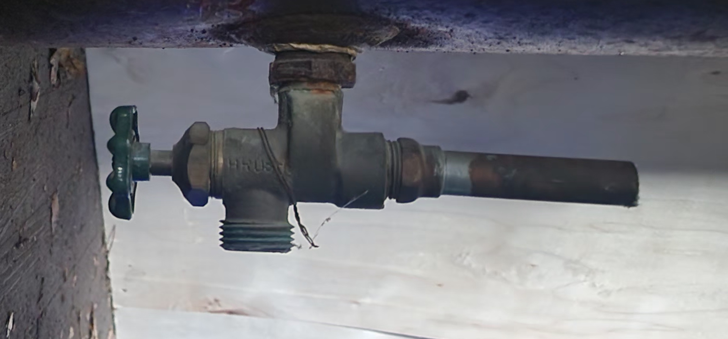

I have a steel compression tank for a 1930s gravity system with a 1950's american standard boiler. The connection for this was made in 1/2" copper. Before I bought this building, tweakers had stolen all of the exposed copper pipe including this connection. Should i redo this connection in the same size, or would it be better to make it in 3/4"? Also, there is only one connection on the compression tank with the other bung plugged. Is this a specific valve that allows the tank to be drained without draining the rest of the system or do i need to also have shutoff inline between the boiler and the tank? I know that normally there are 2 valves, one to isolate the tank from the system on the inlet of the tank and a second valve on the other bung to drain the tank periodically.

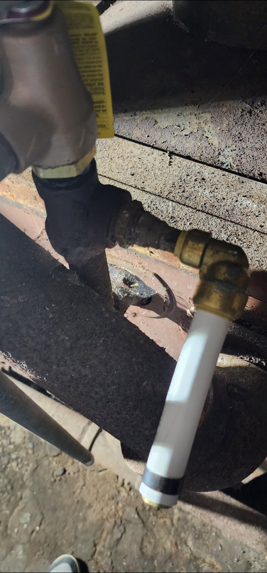

    Disregard the shark bite and pex, that was only to test the system for leaks

    That's a "tank drainer" and you don't need another drain or valve. There should be a small plug in the other side of that unit. You hook up a hose, open the valve to depressurize the tank, then remove the little plug to let air up into the tank so the water will drain.
    1/2" pipe is fine in this instance.

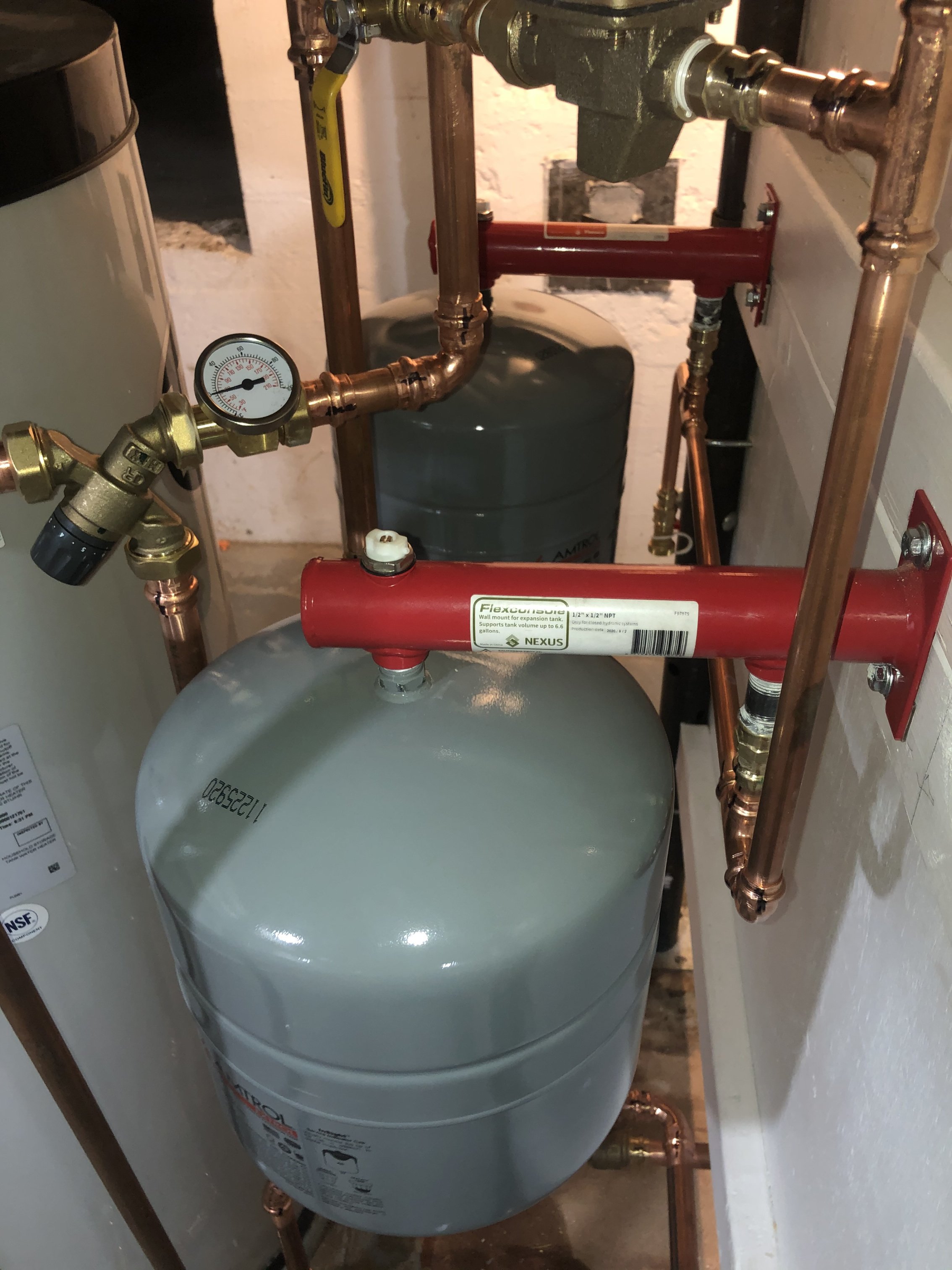

    or just replace it with a bladder tank and microbubble air separator if you're already this far in.

    Wouldn't i need to plumb in an air separator somewhere in the 2-3" black supply pipes coming out of the boiler? I assume I would need something considerably larger than a 2 gallon membrane tank since it is replacing a 25-30 gallon steel tank.
    hot_rod Posts: 28,705
    typically a diaphragm tank will be 1/3 the size of the compression tank. Due to the captive air space.

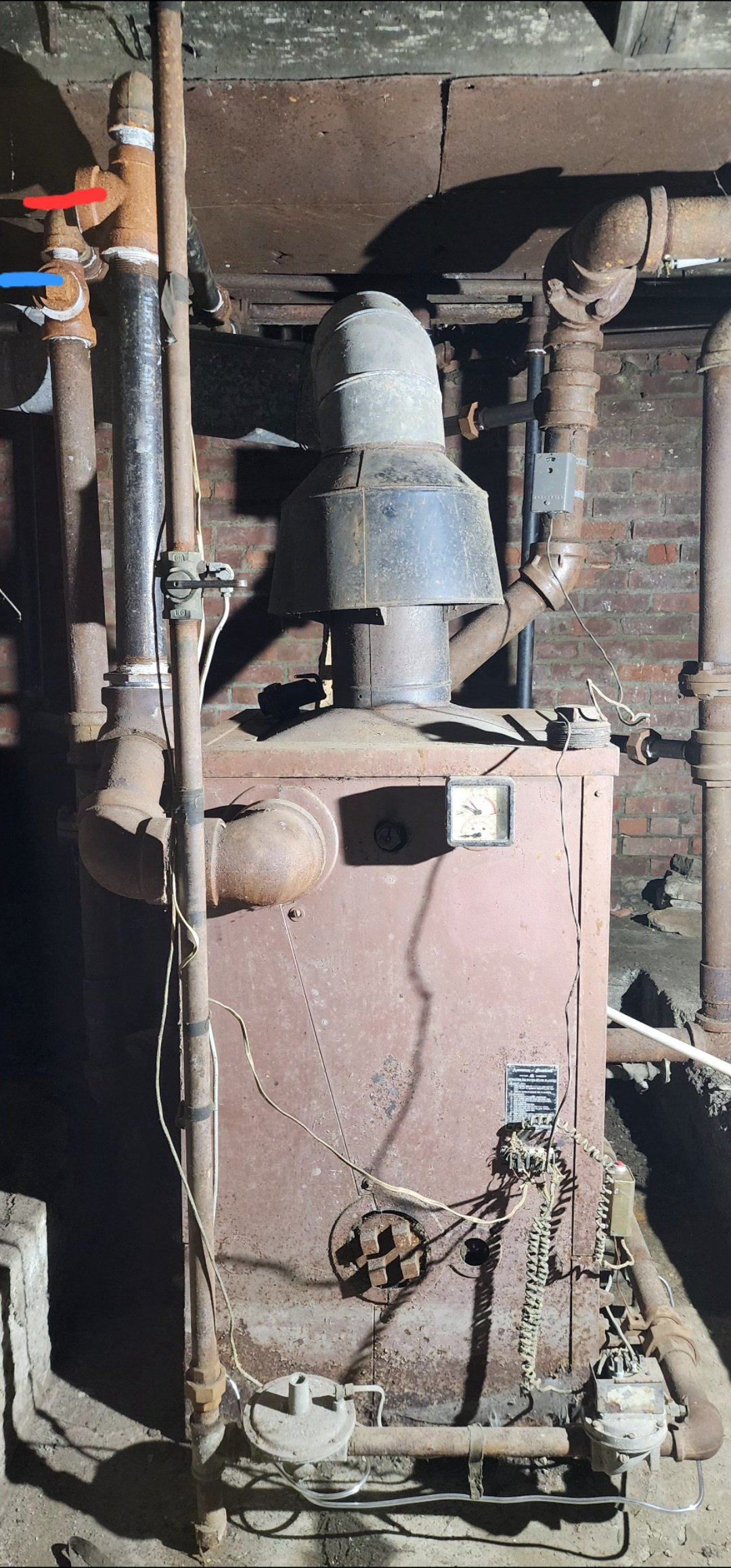

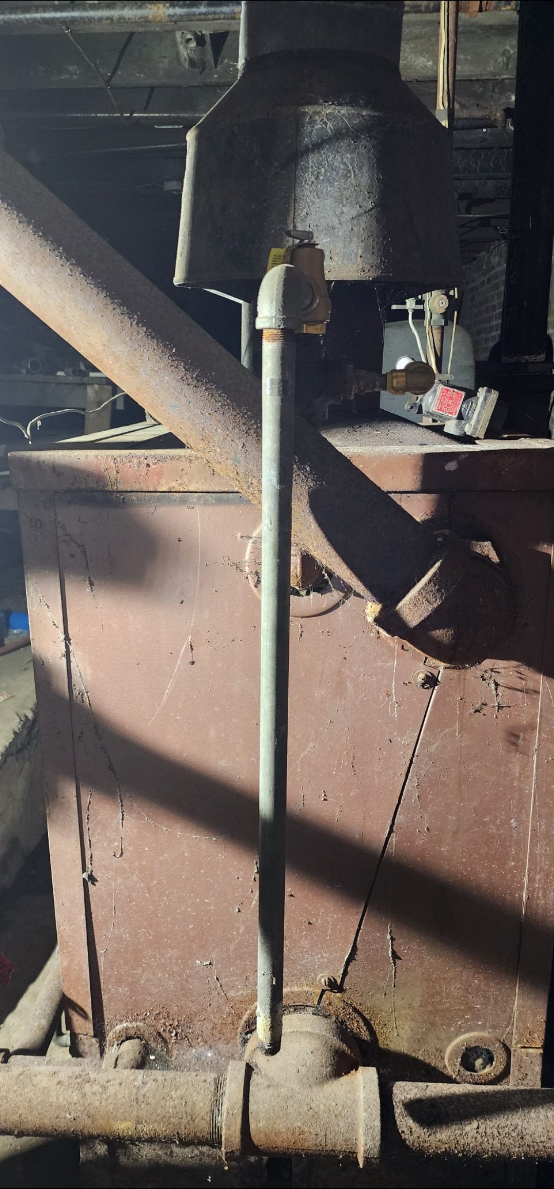

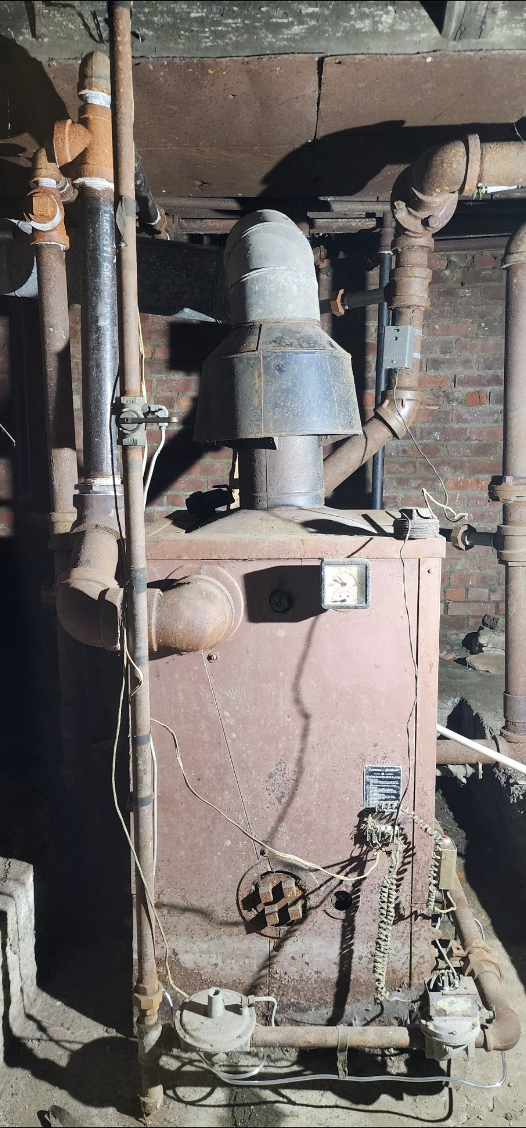

    Here is the dinosaur. It will be replaced sooner than later but first i want to make sure that the radiators a were placed actually heat the whole house comfortably. This heating system is installed on a ny style row house with the boiler located nearest to the street with the brick wall being parallel to the street.
    From left to right: the piping coming of the boiler goes Return Supply Supply Return. The returns both come back to the same tapping on the far side on the boiler through a large tee. The pair of pipes on the left aregoing to the front of the house and feed 4 radiators. 3 with 1" connections, one, on the third floor with a 1.25" valve.
    The 2 pipes on the right go straight back and feed additional radiators with dedicated 1" pipe teeing of for individual radiators and 1.25" pipe for 2 radiators that are subsequently plumbed with 1" After teeing at the ceiling of the floor below.
    You can also see additional photos in my other thread reanimating Frankenstein, however, if you like, i can provide a photo of every radiator.

    From the opposite side you can see the pressure relief valve attached to a tee with a 1/2" stub of copper i assume was previously connected to the steel tank. (Next to the red square label of the old pressure relief valve). The large tee at the bottom has both returns. Barely visible on the lower left is a 1" tapping that connects to the fill and the drain.
    If it is gravity the bladder tank will work but the microbubble air separator won't do much for you.

    You can save all the existing piping to feed your system "if you are not going to use circulators" it just needs some work done by someone that knows how a beautiful gravity hot water system like the one you have functions.
    You have a simple clamp on external aquastat that was used to control the boilers water temperature which most likely can still be used.
    This building had a either a hand fed coal boiler or a coal stoker boiler originally and it was replaced with a gas fired boiler.
    The plumber that installed that boiler knew what he was doing and how to properly connect it to the existing piping with unions and gasketed flange piping.
    If my memory is right about this type of gravity system, the radiator's in this home are used to create the point of no pressure change holding by holding an air charge to maintain the point of no pressure change by running the piping bottom to bottom on each radiator and avoided or eliminated using an open to air expansion tank due to the flat roof on this home.
    If you have time your please upload pictures of your radiators on all the floors and any more heating piping.
    The way the plumber installed the piping for this gas boiler will simplify replacing it as it all can be reused quickly due to the flange fittings and pipe unions he used to assemble it.
    He used heavy schedule 80 pipe for most of it because the previous coal system had this weight of pipe and it is entirely possible much of this pipe was original to the coal boiler too.
    Mr. Holohan or Mad Dog please correct me if I made mistakes about this

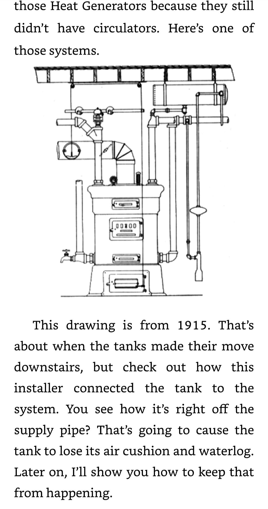

    As far as i can tell there is nothing wrong with the steel tank. Others suggested a modern bladder tank and i was offered a used bladder tank (mentioned above) which should be suitable. I've read Dan Holohan's books and while he has a diagram of a gravity system with steel compression tank on page 36, he says the installation will inherently cause a waterlogged tank eventually, and i didn't see the correct way he alluded to later in the text. Since this is a large bladder tank that sits on the floor, I'm still not sure whether it should be connected at the top of the boiler where the old tank connected or if it is better to connect it higher, and whether it should be in the on a supply line or a return line.
    As @Steamhead said, the compression tank should connect into the system at a high point near the boiler, and ideally an Airtrol fitting.
    However, with a pure gravity system (no circulator pumps anywhere) it may sometimes lose its air charge — but that's not all that common. What you do need to watch out for is to not have any other air removal fittings anywhere! Yes, you need to bleed the radiators on startup, but once bled if the pressure is correct there should not be any need to bleed again.
