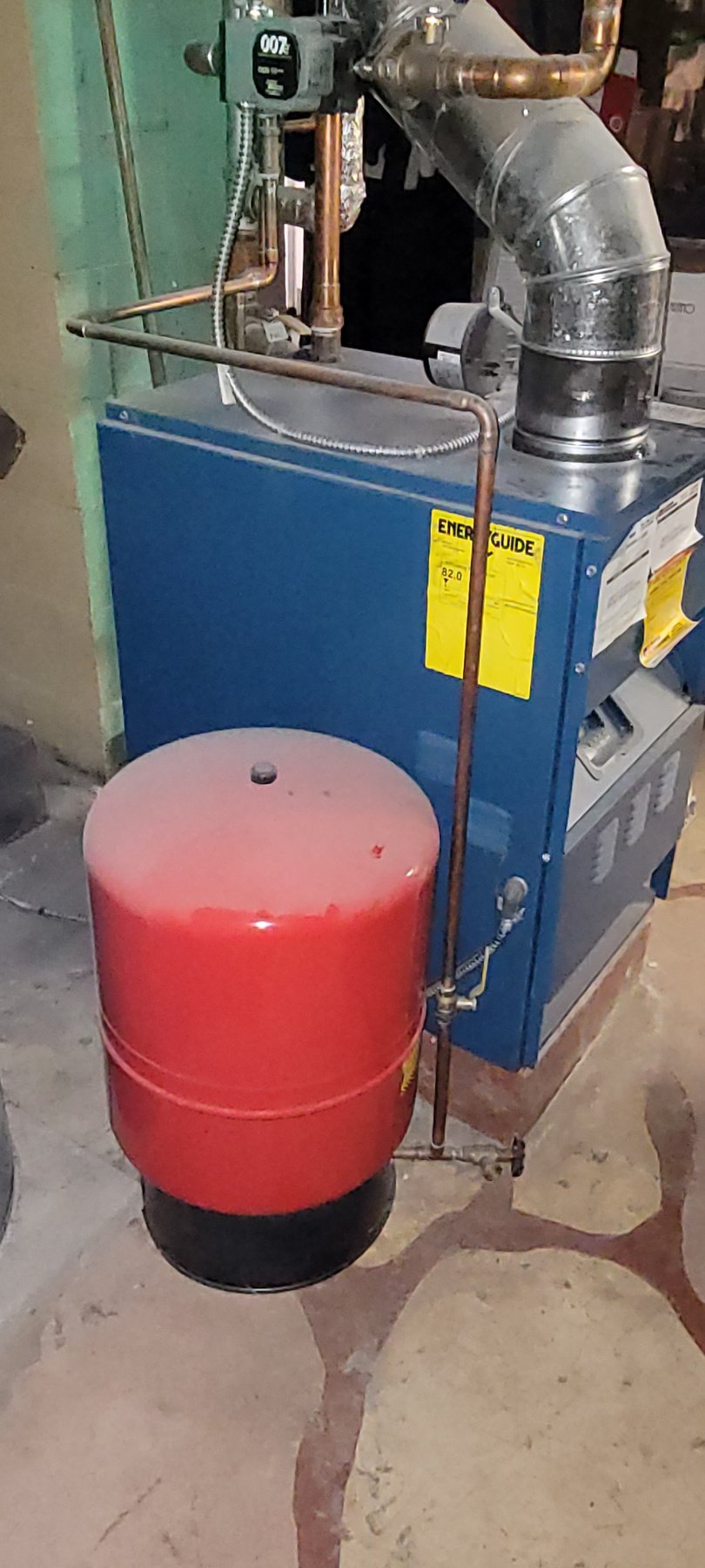

I have a 6 year old Dunkirk Series II model # DXL-125 hot water boiler that has been making a loud rattling noise and vibrating the pipes when it runs for the first few times each heating season for the last three years now. The whole boiler system was replaced, including the expansion tank, and they added a device which removes air from the incoming water supply so I don't have to bleed all of the radiators at the start of every heating season. I had the installing HVAC company out twice, the first time they said they had to see the problem happening to work on it, and of course it had already happened a few times already, and didn’t do it when I turned up the thermostat. They said don’t worry about it wait to see if something breaks. Is this a safety issue that I need to get fixed, or just an annoying glitch with the system starting each season?

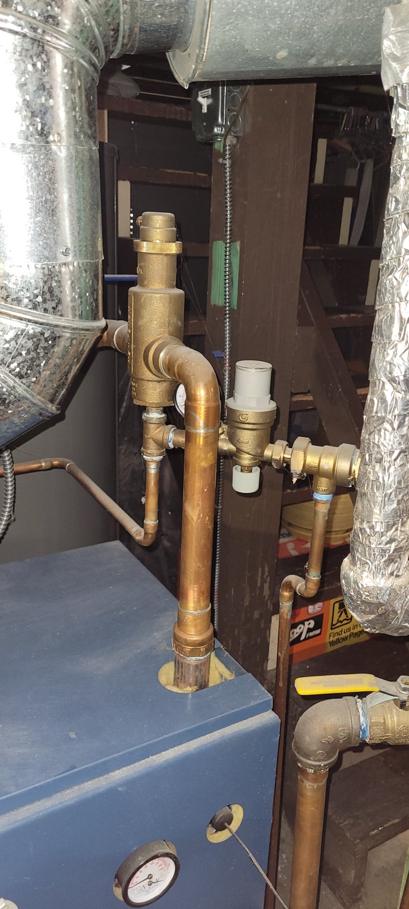

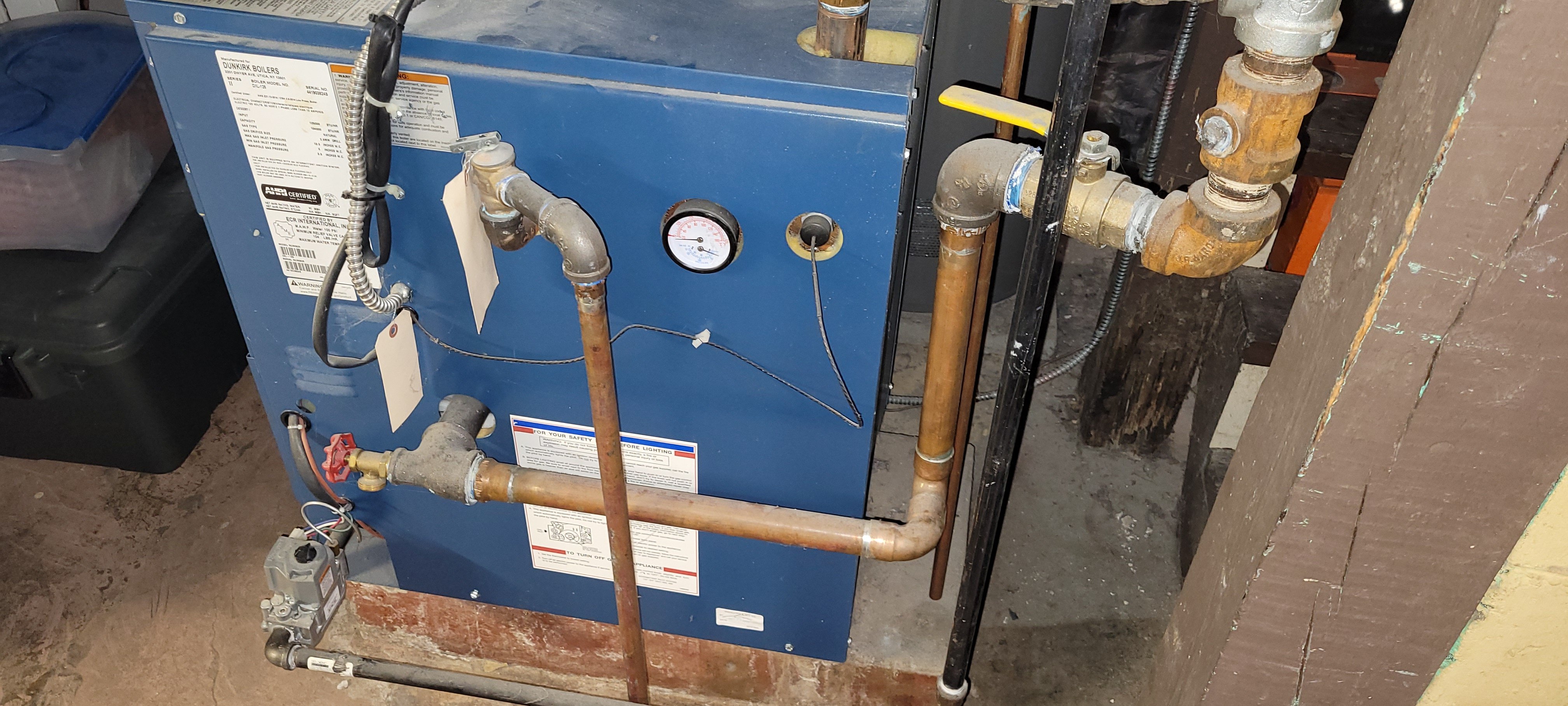

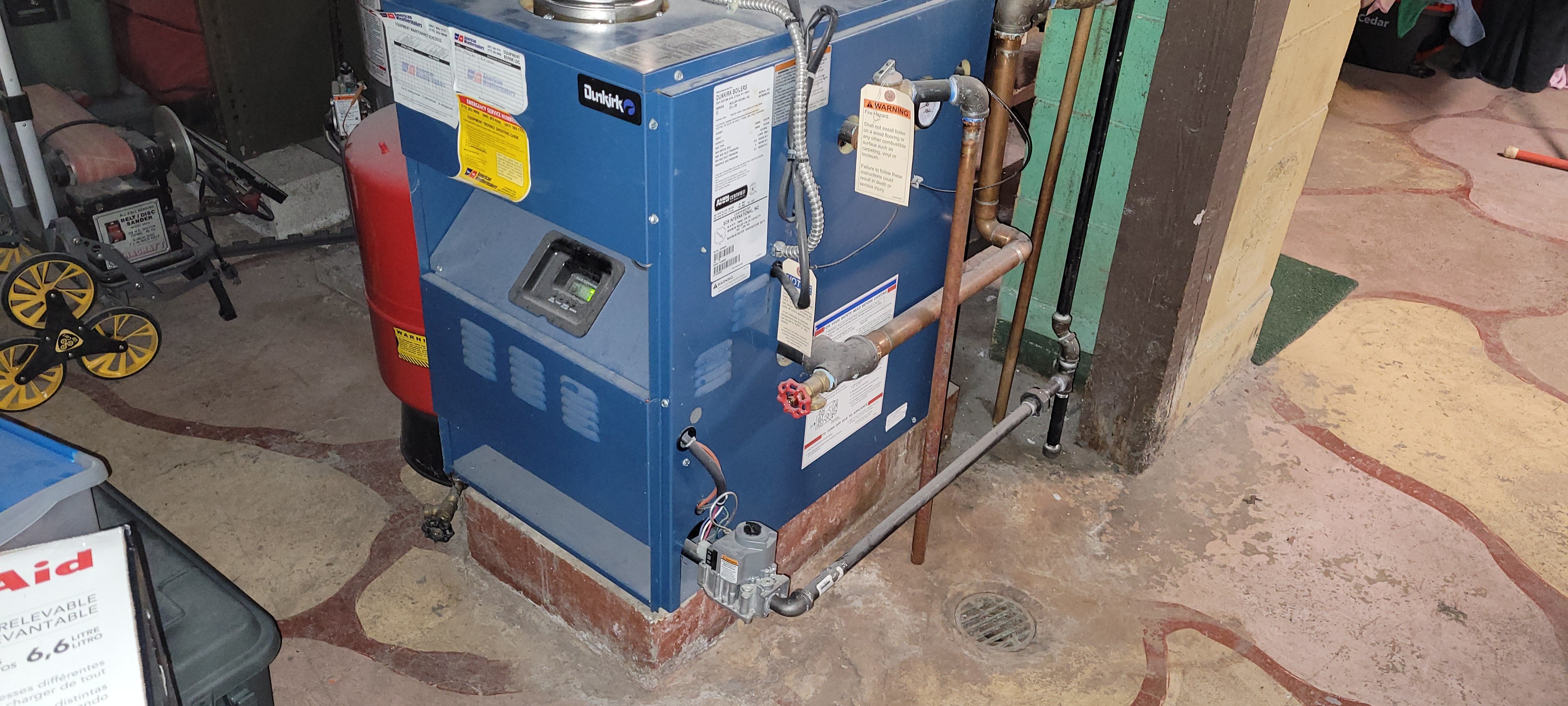

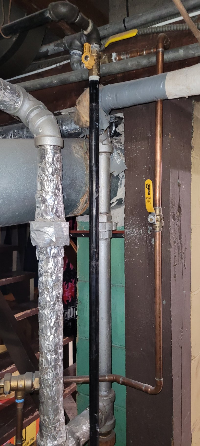

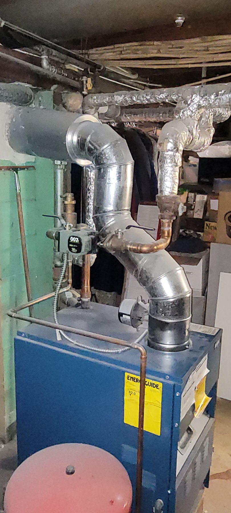

    How about posting some pics of the boiler and its near piping?

    The vent damper makes a squeaky door hinge sound when rotating. But you must be used to that. Its a simple boiler. Quiet circulator. Expansion?

    I don't think it's a vent damper. The rattling is most pronounced at the regulator, and the entire gas pipe and regulator are vibrating loudly. See attached video.
    109A_5 Posts: 4,761

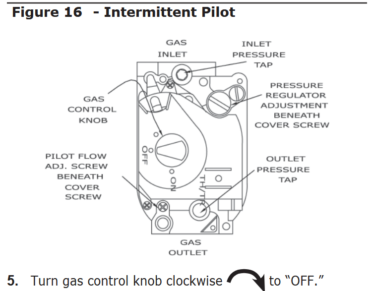

    WoW that is impressive !!! Sounds loudest at the gas valve. Kind of wonder what the burner flames look like when that is going on. While it is happening I'd probably disconnect the wiring connector at the gas valve to see if it instantly goes away.
    HVACNUT
    109A_5 Posts: 4,761
    Also while it is happening you could turn the gas valve to Off and see if it instantly goes a way.
    109A_5 Posts: 4,761
    edited October 2025
    Here you go, looks like others had the same issue. As long as the 24 Volts AC is good at the gas valve, I'm starting to be convinced it is a bad gas valve.
