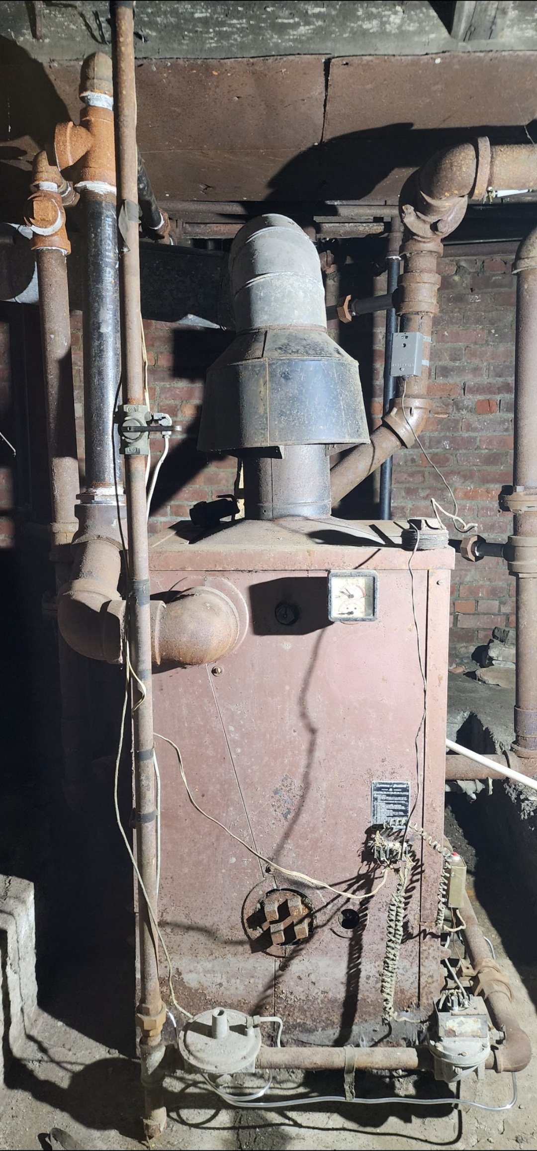

And this is where i came in. Now most people would have taken one look at what's left of this heating system and wrote it off a hopeless. No radiators, all pipe connections cut and in disarray. An ancient boiler half buried in basement rubble. Tear it all out and start fresh.

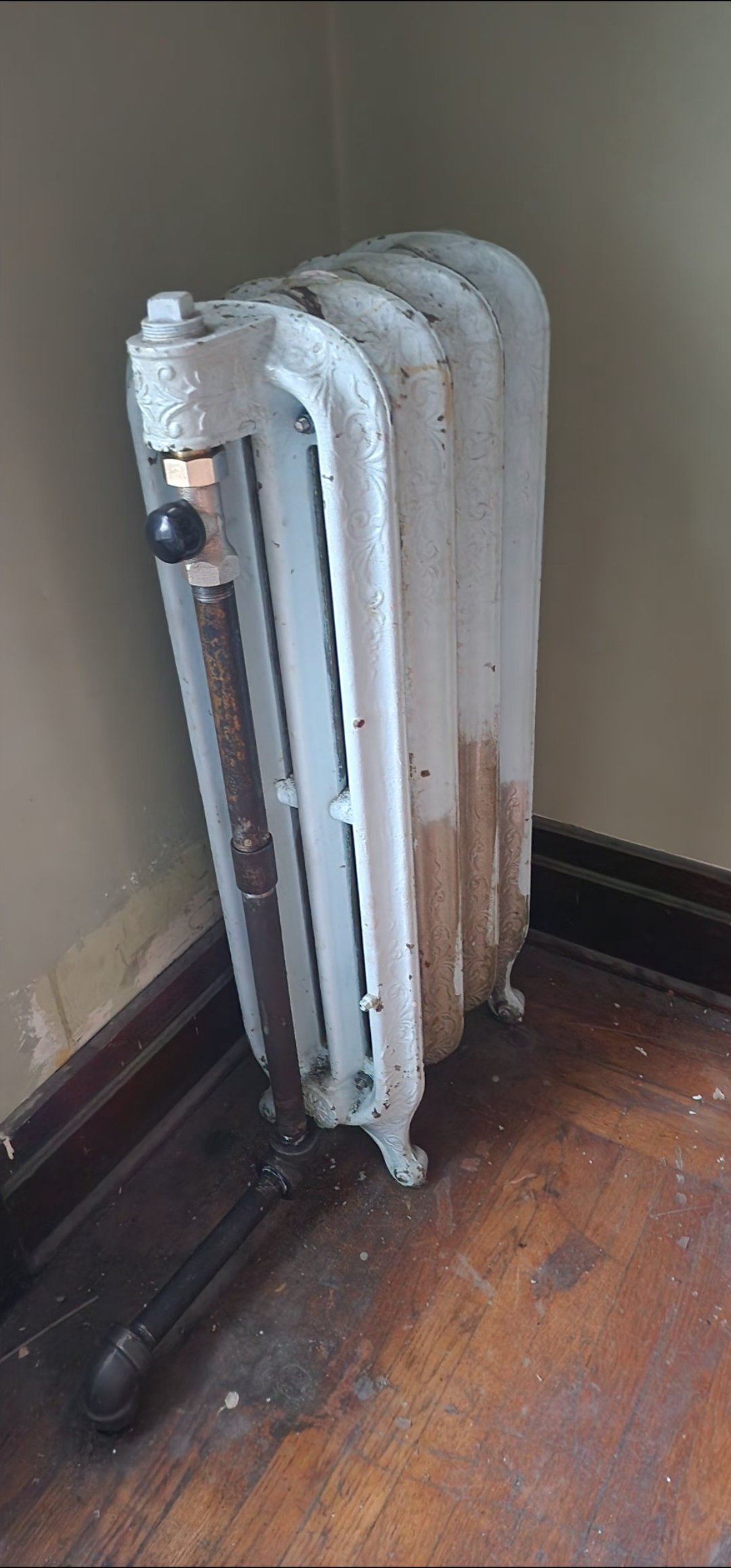

My first big break came in the form of 10 used radiators for $200, of these, 6 ornate ones were particularly useful to go where the orginal gas space heaters were located. There were three with 6 sections and three with 10. They happened to be the correct height and configuration of inlet and outlet. The only downside was they were all tapped for 3/4" fittings and the pipes were almost all 1". I needed 6 equally sized radiators. I stripped the paint, cut the tension rods seperated the sections, retapped to the larger thread and ended up with six 8 section radiators. If i were to detail how i accomplished ask that it would be another 10 horrors. These radiators went in with v110 thermostatic regulator valves. I picked up, stripped and installed several more radiators and sorted out that aspect of the heating system.
Finally, I had a matching game with the basement boiler plumbing: Remove the plug/ reducer with copper stub within the 4" pipe union, and cut new black pipe to connect to the corresponding vertical riser going to the radiator(s). I filled the system with water replaced the pressure relief valve, fixed minor leaks. The altitude gauge still registered pressure. I cleaned the burners, installed a new baso, thermocouple and pilot and double checked the wiring. Then I got the power company to turn on gas and electricity. Aside from the minor hicup of a closed needle valve on the vent of the diaphragm gas solenoid valve, she lit. The temperature also registered on the combination gauge.

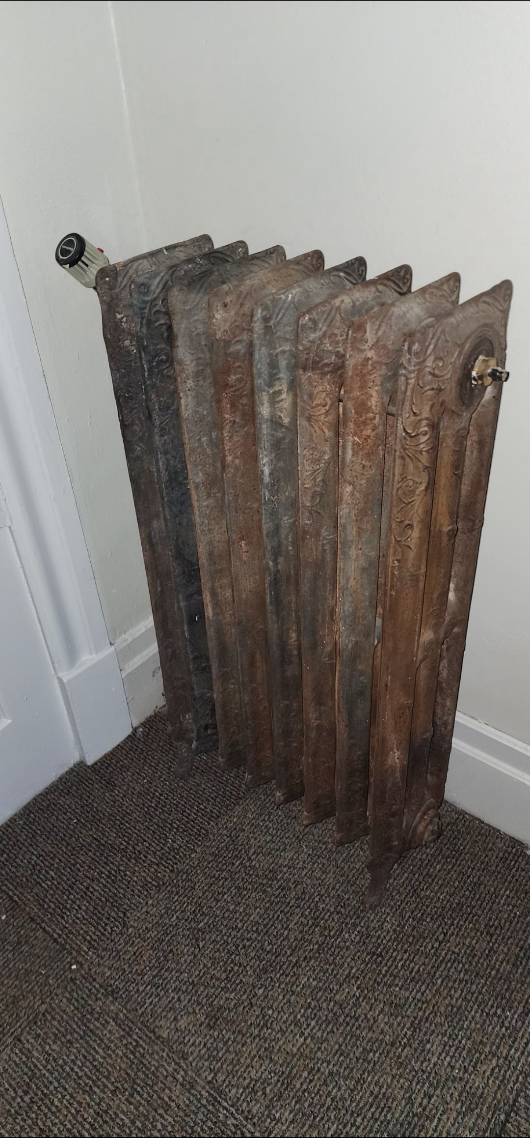

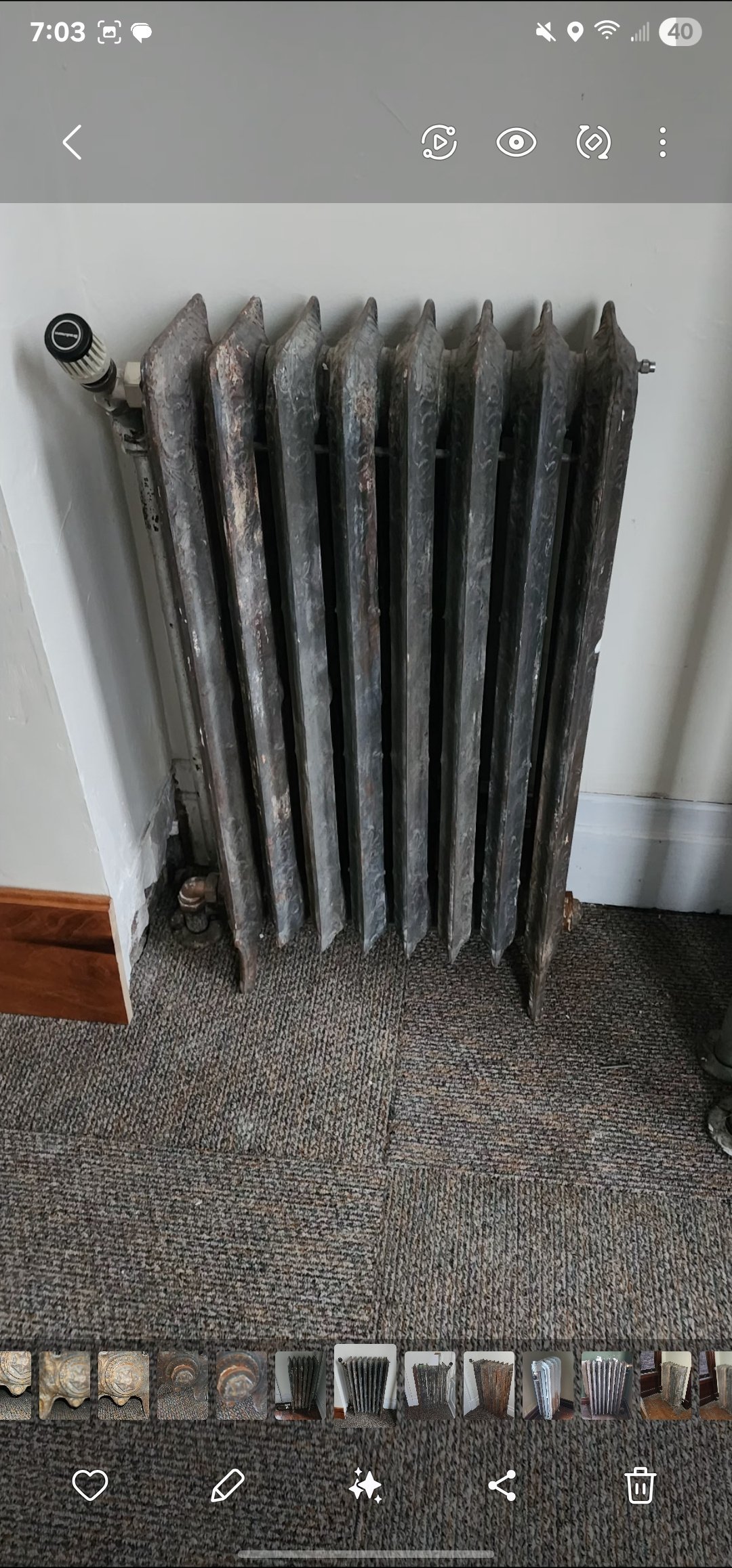

    I figured the trvs are the modern way of adding restrictions on the upper floors to balance heat between the three apartments. There are no trvs on the first floor. Remember, until recently, this boiler only heated the first floor. I'm not saying that was correct, but I'm hoping this will prove to be more appropriate for the boilers size to have more radiators hooked up. Each radiator feeds of the main trunk individually so one shutting off will not prevent another from heating.

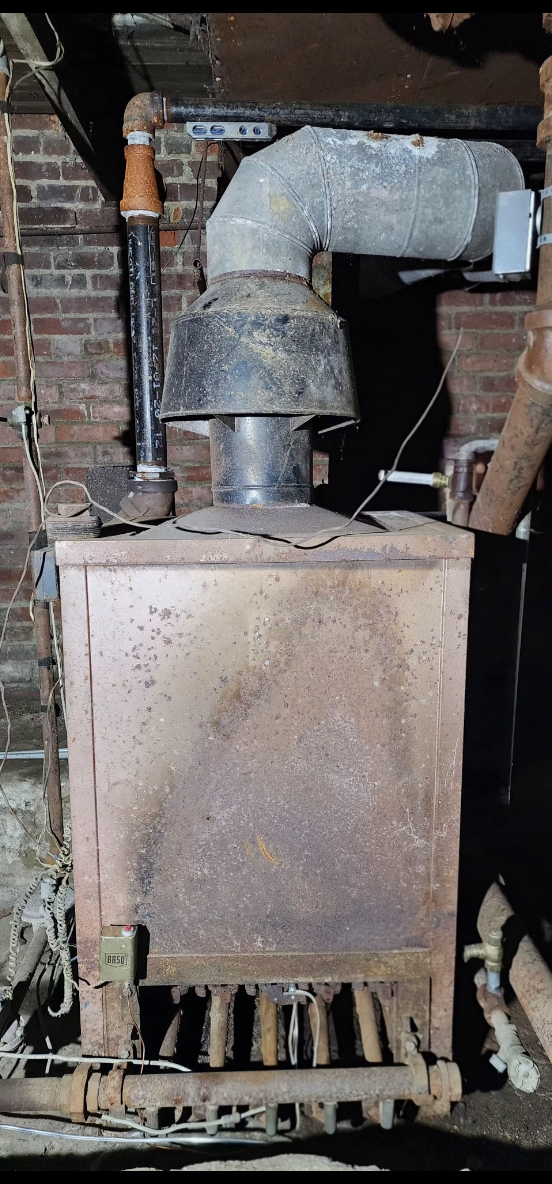

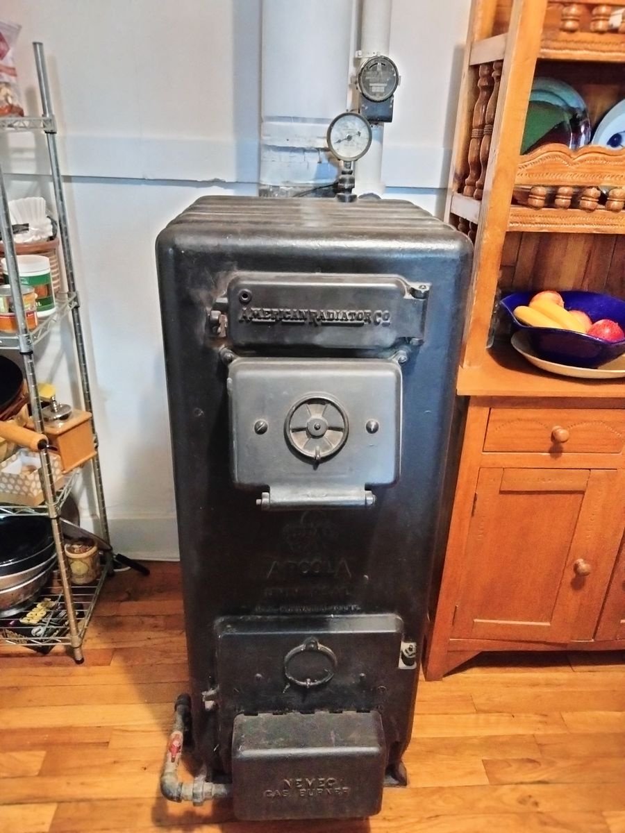

    @novajke , that boiler is missing its "roll-out shield", a cast-iron plate that goes over the front opening where the burners are. I would not recommend operating this boiler unless you have this shield and can put it back on.

    I remind you, this is a Halloween special, meant to induce nightmares in y'all! But yes, i have the shield, It was buried in rubble behind the boiler. I hadn't placed it in the photo because i just installed the cleaned burners and new pilot components. The building is currently vacant and I do not intend to let the boiler run unsupervised until a low water cutoff is installed. Clearly judging by the jacket, rollout has been a problem on this boiler in the past.

    At the time the obsolete trvs were cheaper on ebay than radiator valves. I'm running the dinosaur boiler as a proof of concept for now to see how well the slow moving gravity heat plays with the trvs. Ultimately, I'll get some quotes to replace the boiler, but first I'll see what the system does. If valves with insufficient valve flow coefficient are giving you the heebie jeebies, good! It is all in the October spirit of the new genre of hydronics horror!

    Please don't fire it up , I just reviewed your photos of the boiler . For your safety .
    Please excuse this old grunt …
  • novajke
    novajke Posts: 41

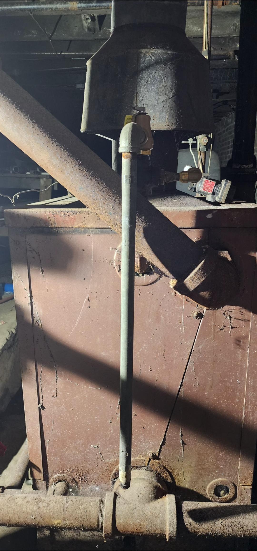

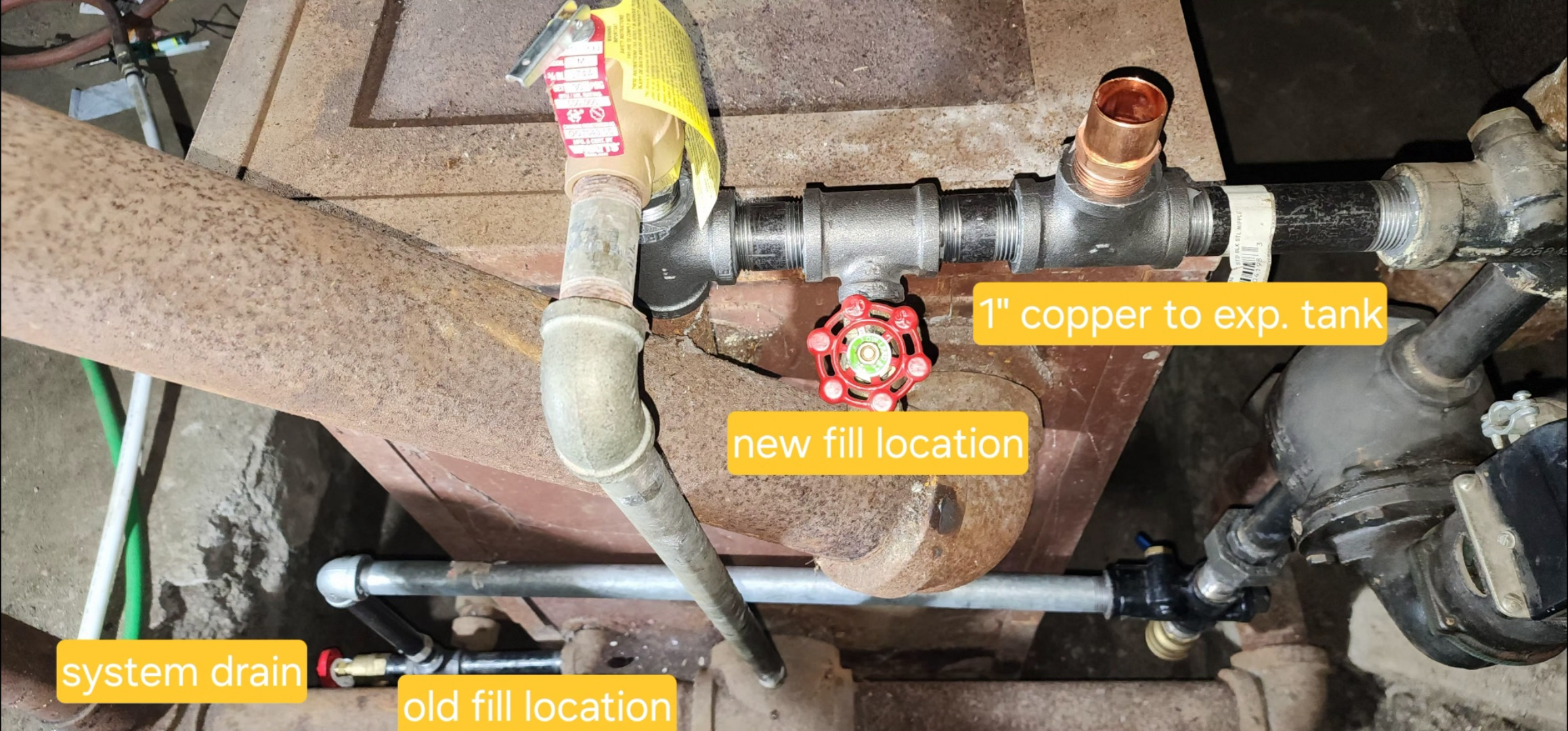

    I'd love to know what specifically concerns you? I've done all the layman approved repairs: new pilot burner, new thermocouple and baso. I cleaned the burners and inspected/ brushed the inside of the boiler. It had almost no soot. The gas safety inspection passed and the utility turned on the gas. A mason rebuilt the top part of the chimney and inspected the rest for obstructions. When up and running, a combustion analysis will be performed.

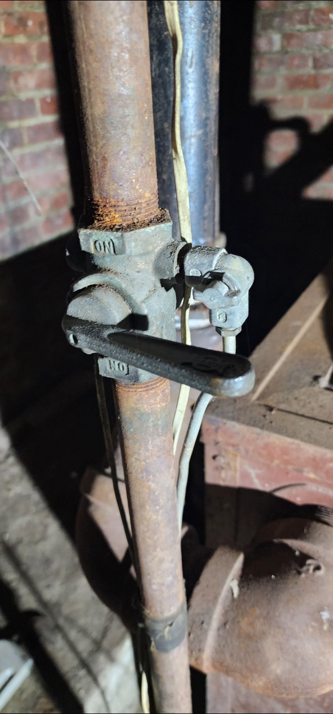

    The only thing that gave me pause was the lack of a low water cutoff- something that was rectified in the photos below.
    The orginal fill location was at the bottom next to the drain. It now connects to the lower port of the LWCO. The tee on the top tapping below the pressure relief orginally hooked up to the steel compression tank. Now it has a 1/2" port for the new fill, a 1" port for the new 33 gallon bladder expansion tank and the upper connection of the LWCO.
    Short of removing a steel plug from a 75 year old boiler, i believe this a good way to get some modern safety to this old system.

    Low water cut off switches for hot water systems using my boiler as an example:
    1. are wired to be the first control of the boiler where it will shut the electricity off on the boiler completely in the event of a water loss
    2. have the LWCO probes threaded into a steam chest tapping or in the hot water riser.
    3. have a manual test button that breaks/opens the power circuit

    This boiler only has a single low voltage signal wire control. Every safety cutoff and control is wired in series on this 24v circuit. If i keep this system, an upgrade in the future will be to convert to a millivolt gas valve and thermopile to operate independently of grid electricity.
    Yes, a probe style would be installed as you say, however, maintenence on a yearly basis to clean and inspect the probe requires draining all the water from the system. A drain and refill introduces a lot of oxygen. Also, all probe style LWCOs I found require external power.
    The blowdown valve with additional test-n-check valves allow for quarterly verification as recommended by the manufacturer McDonnell & Miller. This results in minimal water loss.
    There is no autofeed on this system.
  • leonz
    leonz Posts: 1,966
    You do not have to clean a probe type low water cut off switch annually, the float type low water cut off switch will have to be disassembled and cleaned and parts replaced as needed depending on your water quality.
    Who is a going to wire up that low water cut off switch for you?

    Not disagreeing with you, he could install an RB-122-E in the riser with 2 ball or gate valves to segregate the probe type LWCO to allow for removal and cleaning.

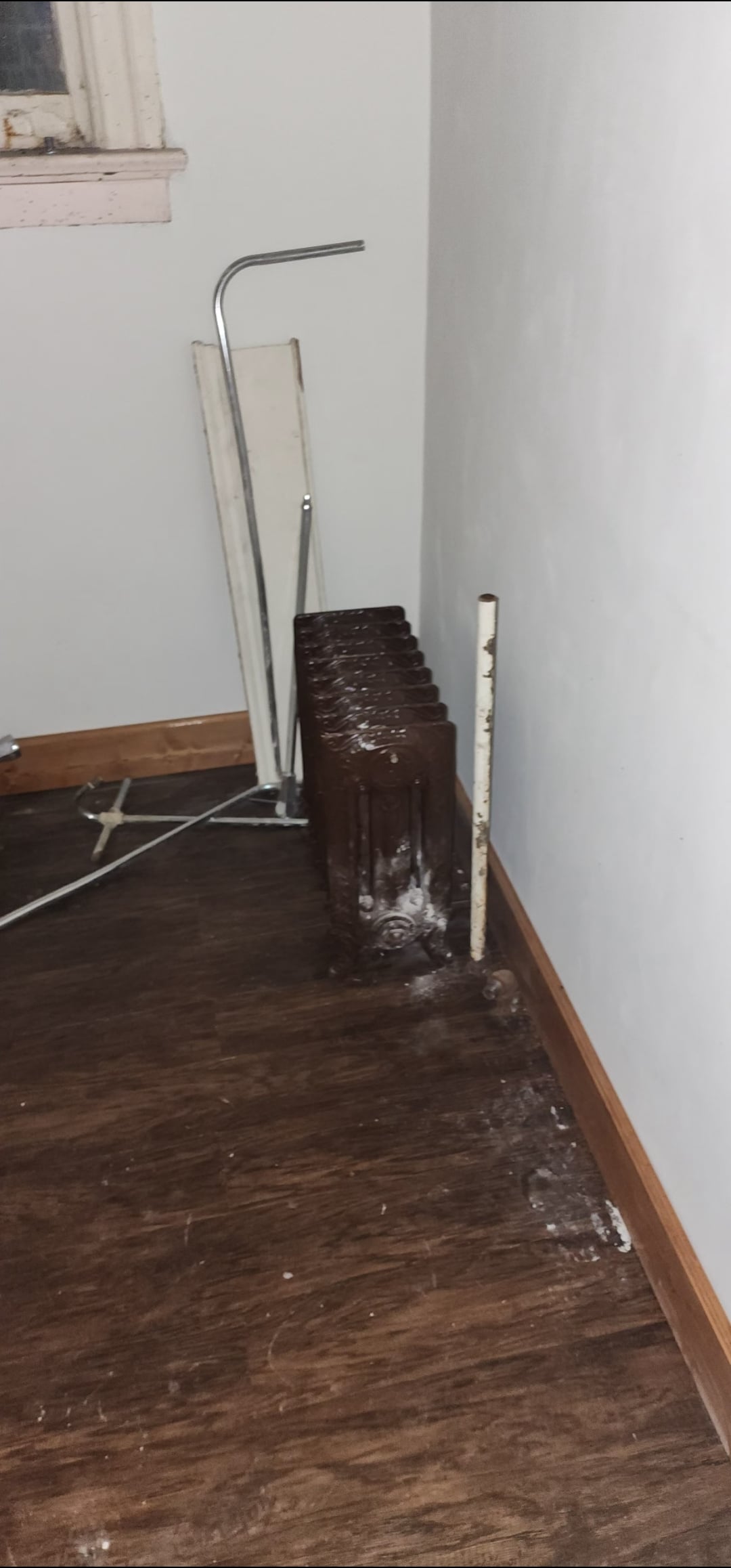

    There is no vertical riser- just 1" or 1.25" pipes coming off the large horizontal supply and return pipes in the basement. The individual pipes go to a wall and supply either one radiator (for 1") or 2 radiators (for 1.25") an attic atmosphere vent exists in the bathroom, which has the only 3/4" pipes coming up. If there ever was a tank, it would have been in the bathroom on the wall above this radiator. The vent pipe was located above a drop ceiling and still goes through the attic and out the flat roof.

    You need a licensed plumber to find all the hot water heat piping, fix this the right way and add back an open to air expansion tank.
