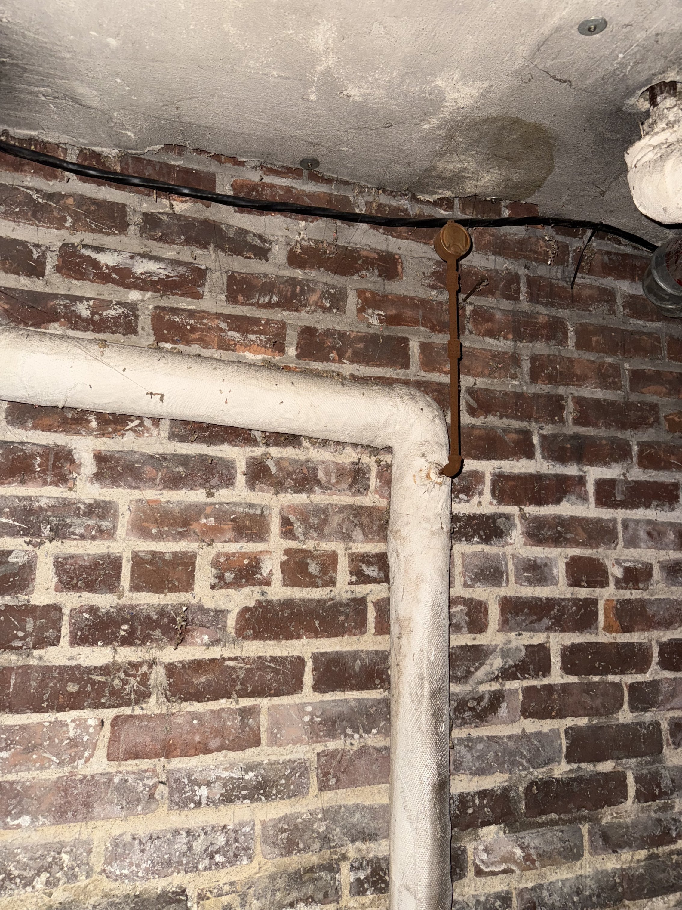

    Context- rads are 772 EDR. Thinking of a W/M SGO-7 with an EZ Gas running full bore- 275k. Just don't wanna get pinched😁

    Steamhead Member Posts: 18,735
    Are the mains well vented and insulated?

    Jamie Hall Member Posts: 27,600
    Make sure the mains are well insulated and that is in range of should work well.
    GW
    Oh. And near boiler piping! Meticulous!

    The Steam Whisperer Member Posts: 1,325
    What they said above for 1 pipe steam! For 2 pipe steam, you usually can orifice down the radiator capacity to about 60% of the existing EDR and then add about a 15% factor. You'll need to check heat loss if you go to orifices to make sure you have enough radiator capacity once downsized.

    @GW
    I don't understand the question.
    If you rads are 772 sq feet and the boiler will do 758 those ratings are without the PU factor. The actual load is 772 x 240=185280 + piping and PU.
    The boiler can fire 280,000 input gross output is 240,000 after chimney and jacket loss. the difference between 240,000 and the radiation load of 185280 is 54720 which is what is left for piping and pick up.
    240,000/185280 so your left with a PU factor of 1.295 instead of the normal 1.33

    GW Member Posts: 5,211
    @EBEBRATT-Ed sorry Ed I am throwing different factors.
    The bigger carlins are not available off the shelf.
    The Carlin EZ will run at 275k max, am I slicing hairs and running thin?
    Can I still expect the .85 with a gas gun? Will the EZ gas truly pump out 275?
    275 x .85 is 233
    233,000/ 185,280 = 1.25
    let it rip?
    Jamie the current boiler seems to be a big ole 1970s Weil McClain, no header, no equalizer, no H Loop. I gonna try hard to make it better😊

    @GW, Got it.
    I think you will still be ok. I always question why the pick up needs to be so much. 33% is a lot. I can see needing more PU in the spring and fall when the boiler cycles a lot and sits off for a long time.
    When its really cold the boiler sits idle for a shorter time and the piping stays warmer and would need less PU in my opinion.
    The difference between 1.33 and 1.25 isn't much.
    Rather than taking the suppliers word for it it might be worth a call to Carlin to see if they can scare up a 201. Sometimes the distributors don't try hard enough

    mattmia2 Member Posts: 17,569
    If you really want to know, you can estimate the amount of different sizes of pipe and figure the edr of that, i suspect you will find it is more like 10%, not 30%
    GW
    The smaller boiler will be happier than the one with the 30% pickup factor. It will better match the amount of steam the system can consume and will shut off less on pressure if at all.
    include fixing the vents in your project.
