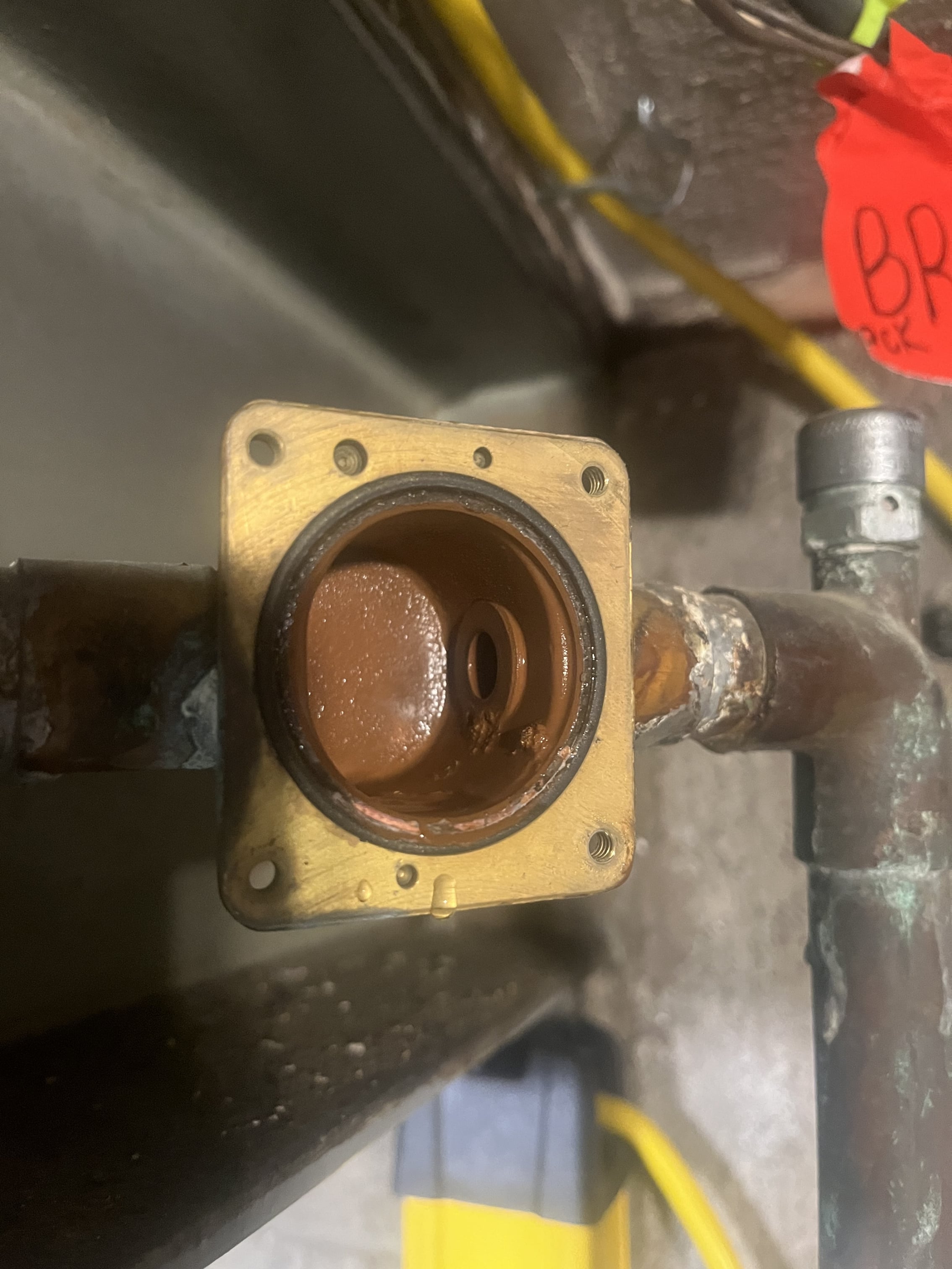

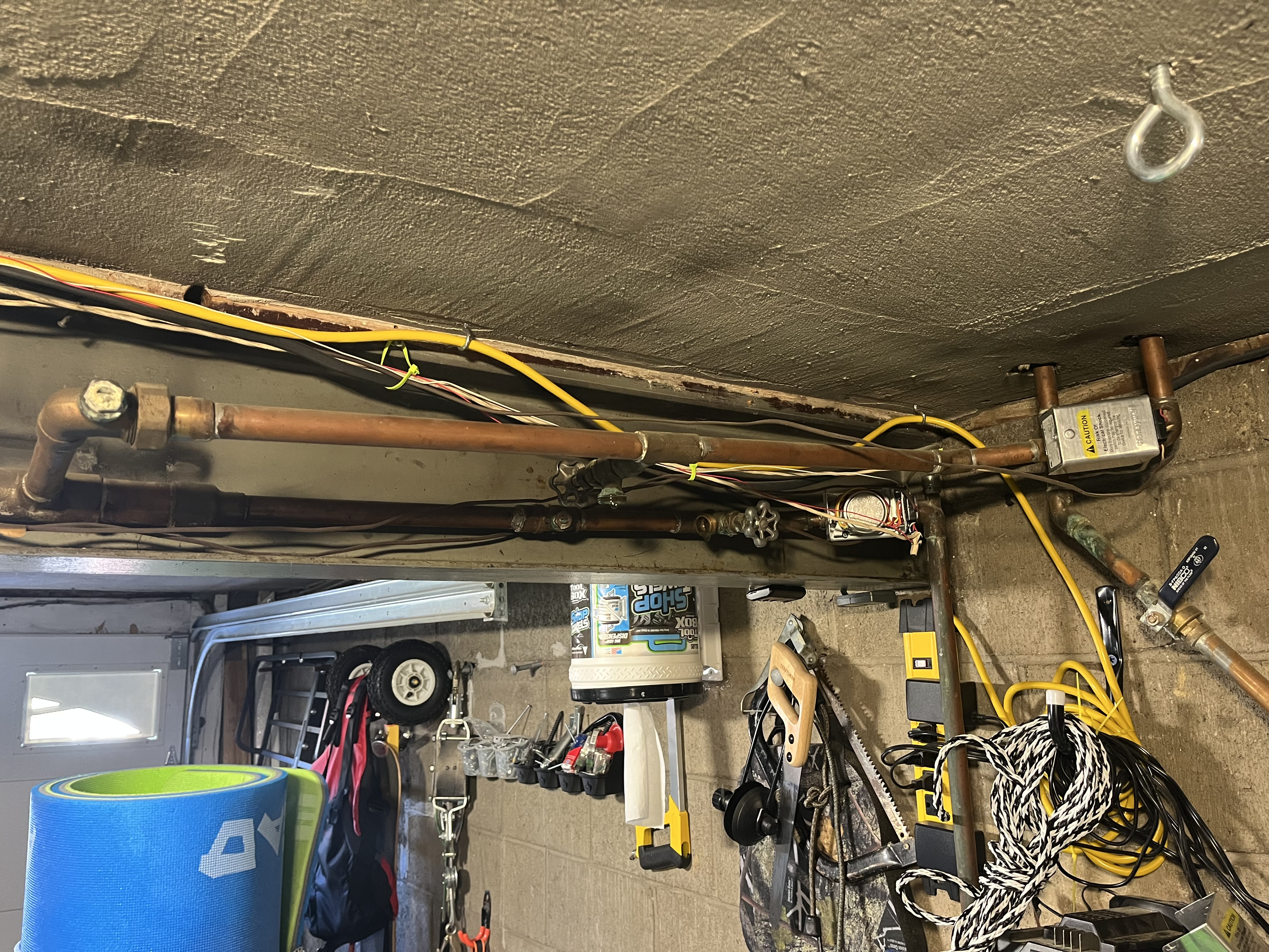

Hi, I have an older boiler, a slant fin se140 edp. Yesterday, I turned it on for the first time this year and the house became very hot, like 86 degrees. We have 4 zones, and the thermostats are pretty new. I reset all the thermostats and double checked the settings to try to eliminate them as the problem. The house overheated again throughout the night. The 4 diverter valves are also only a couple years old. Even with all of the thermostats turned off it seems as though the diverters are open and hot water continues to circulate. Only one zone seems to be working correctly, the second floor zone. The boiler temperature and pressure remain within normal range. The 24v transformers are all outputting the correct voltage. Is there a component of the boiler that could be keeping the diverters open and the furnace running without any input from the thermostats? My research says it could maybe be the control panel (aquastat-picture attached), but I’m seeking some advice for anything I might be able to check or what else it might be because that control is hard to find and $600. Could it be the zone switching relay? (Picture also attached) Thanks so much for your help.

    Some better pics from further back that encompass the boiler, its near piping and controls may be more helpful, but diagnosing a control issue requires a multi meter and the knowledge of how to use it.

    Can you take a picture far enough back to see the entire boiler and near boiler piping with the zone valves, circulator(s) and pipes in one shot?

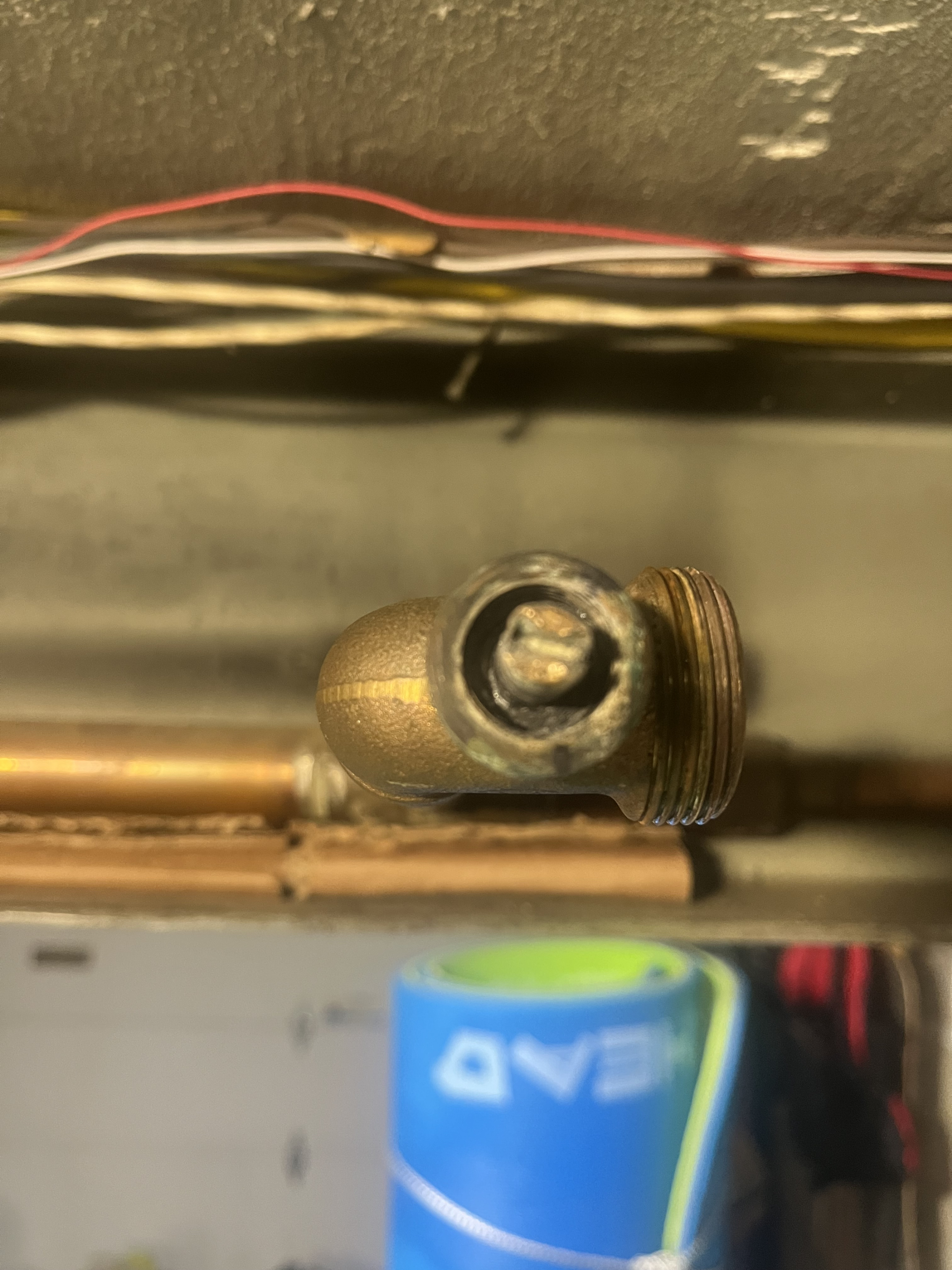

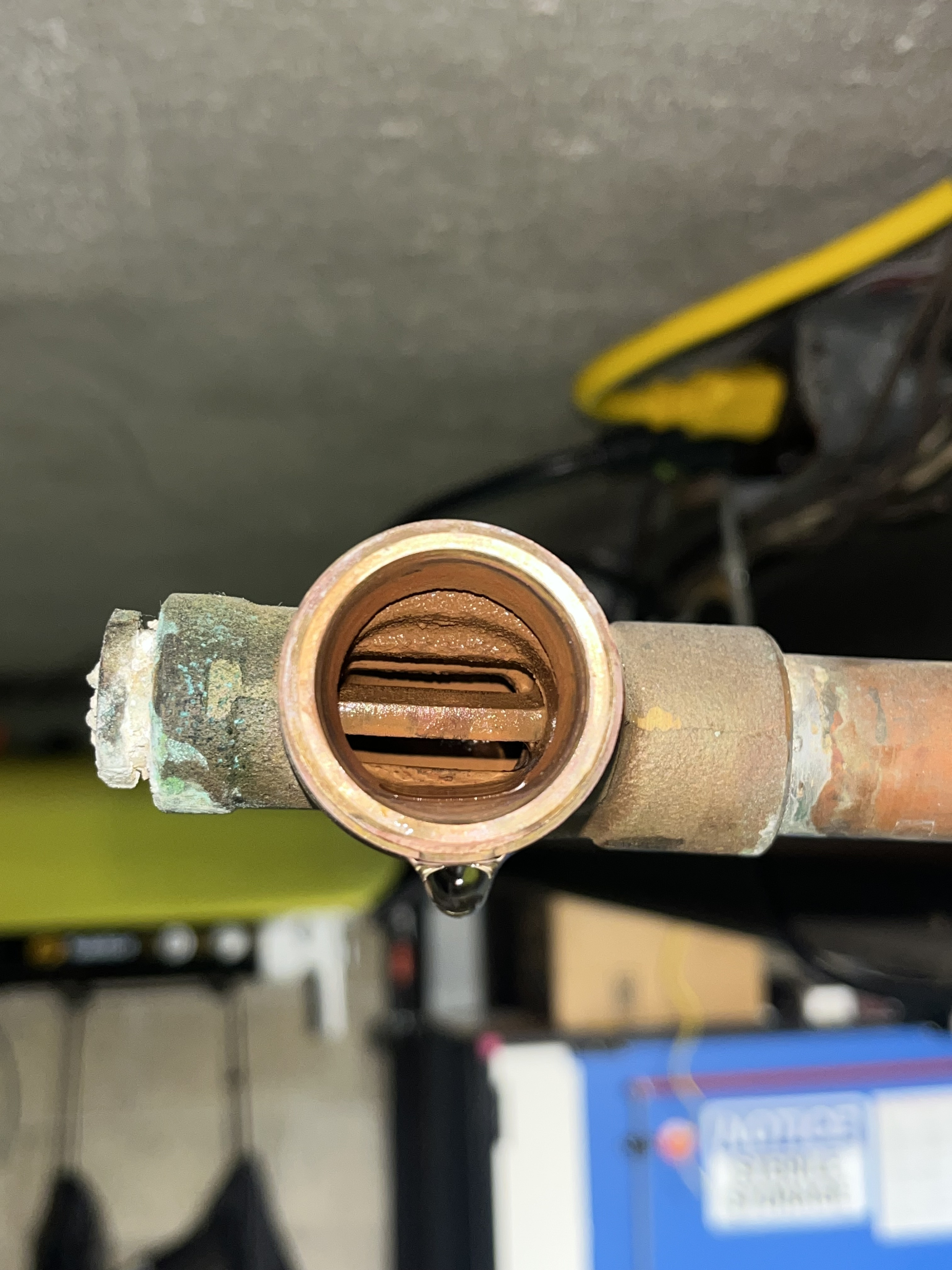

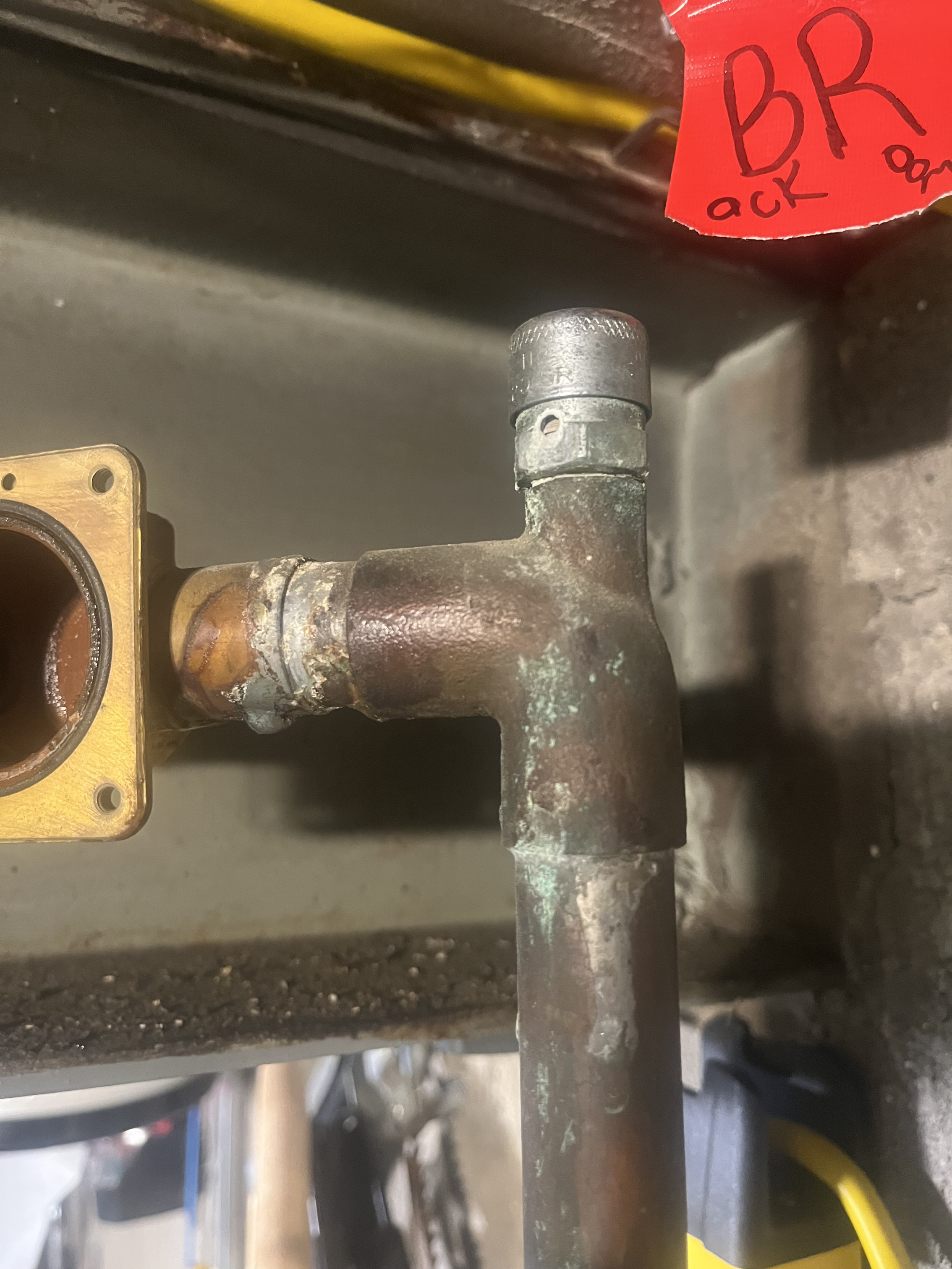

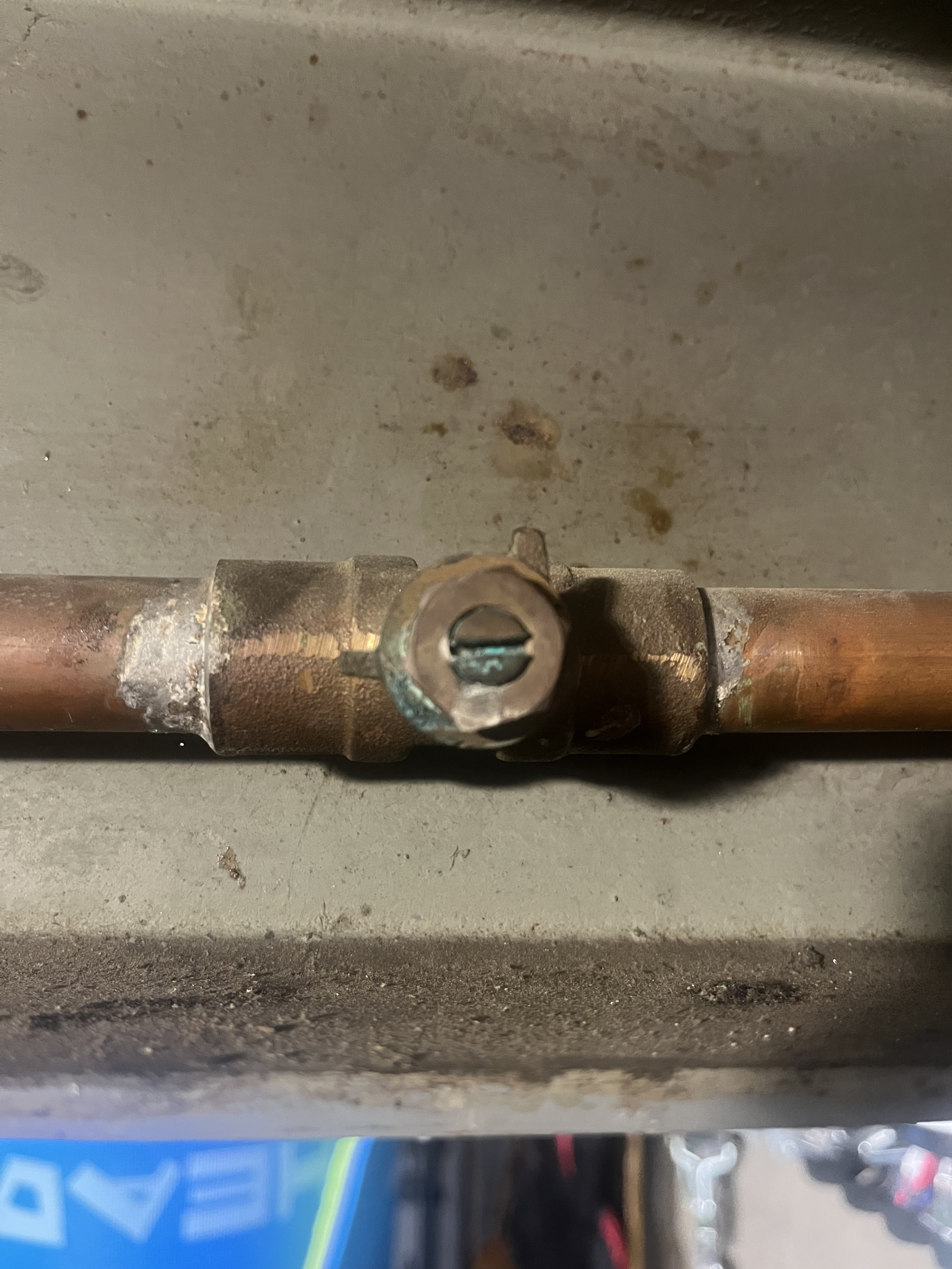

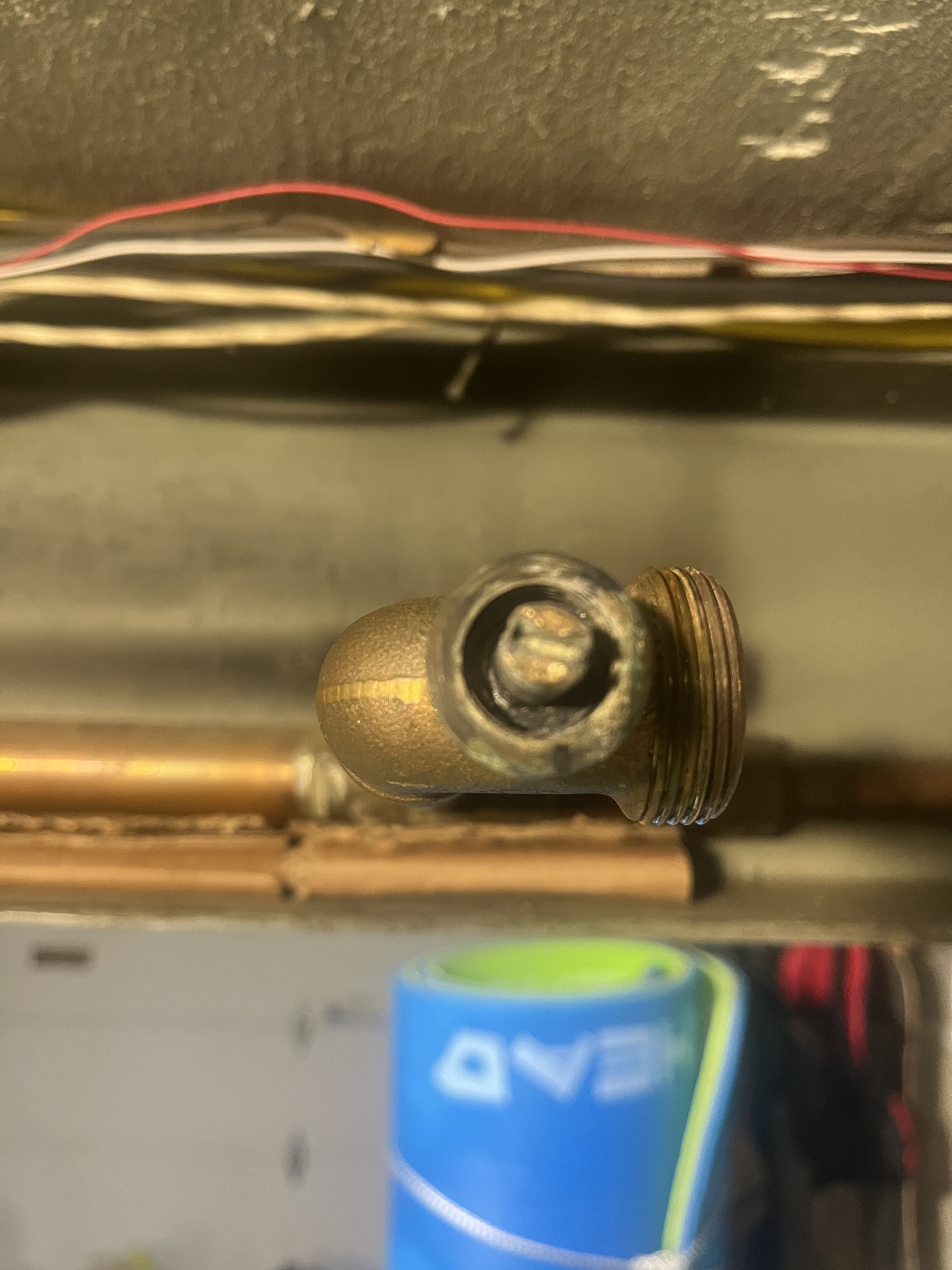

  • Thanks for all the replies. I just got around to removing the zone valves, and yes, two of them are bad. They completely froze up and the gears stripped out. The third and fourth ones seem to be working fine. I can only assume they developed buildup due to our hard water and the weird angle they were installed at. I will install the new ones in the correct orientation. I do have another couple questions. First, There are these two valves, one on each line, just past the zone valves. This is all on the return side. I believe these are balancing valves. I plan on just leaving the one straight horizontal one alone, but the corner elbow one was quite crusty. I was able to get the outer screw off without much problem. Do you think some pipe sealant and then tighten it back down might solve the leak? If I replace it with a new one I’m not sure how to set it correctly. I also plan on installing shut off valves after the zone valves. Second, on the top of the vertical pipe coming out of the radiator is an elbow with what I think is a vent on it. I am going to replace it. (I’m basically re-plumbing the whole section)Should I just use the same thing, or do you recommend something better? This whole system is really old, so some of the components like the valves I can’t even find pictures of online. Thanks again for your help.
