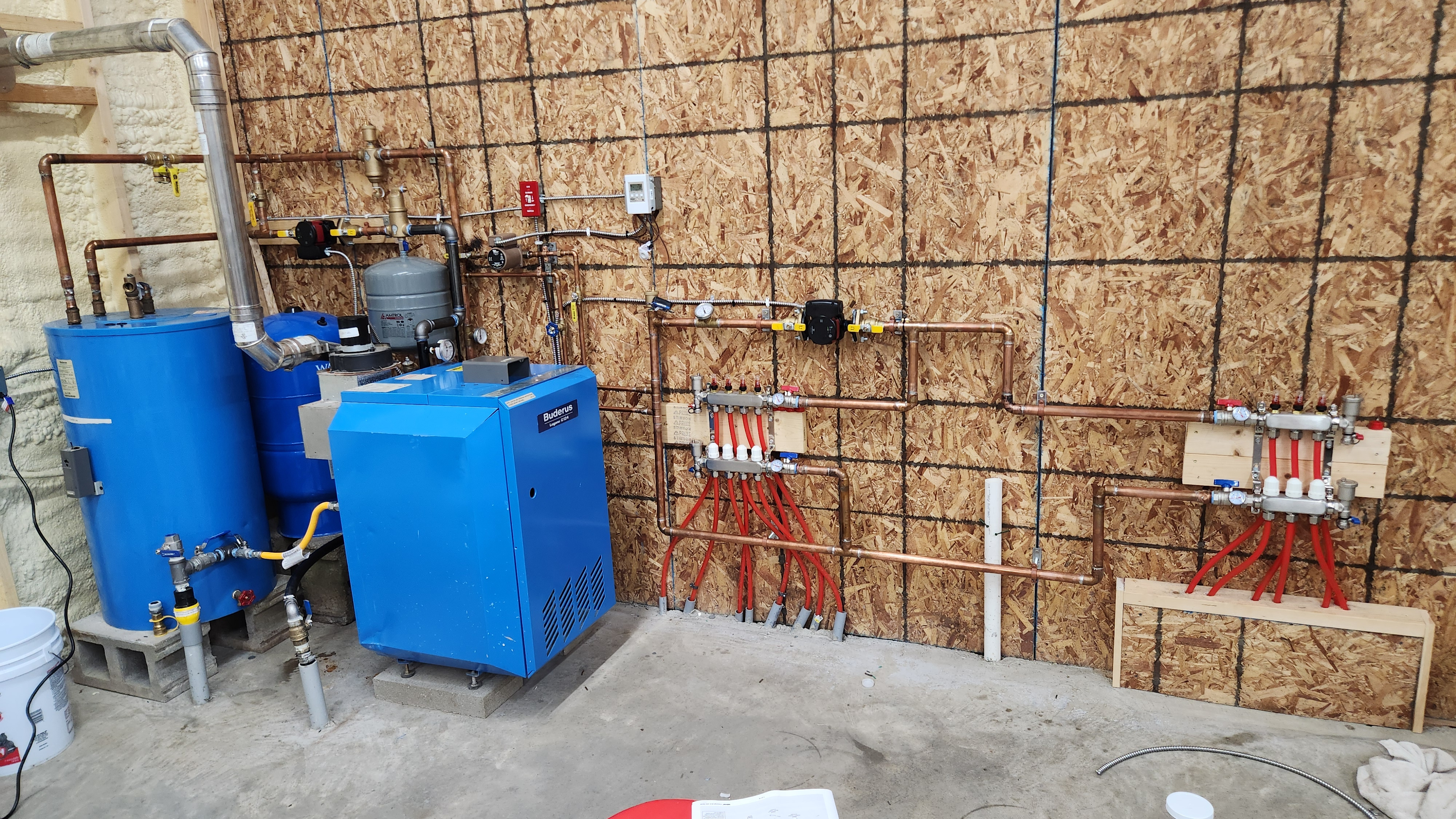

I have just finished a completely DIY (amateur) installed boiler system in our new build and am looking at options for combustion air. The boiler is located in the 30x40 shop that is very well sealed and insulated. I will be building a boiler room/closet around the boiler that will be about 6x15 with 8ft ceiling, the finished shop ceiling is 12ft high with R40 blown in. The boiler is natural gas 100k BTU in 85k out and has a draft inducer. The outside wall is to the left where the flue exits, the OSB wall has a living space on the other side.
I was thinking of putting a vent directly in the outside wall for the boiler to pull fresh air from, or possibly running a duct into the attic that would pull air in through the soffit vents.
What is the best route and how do I size and determine placement?
Western NY climate.

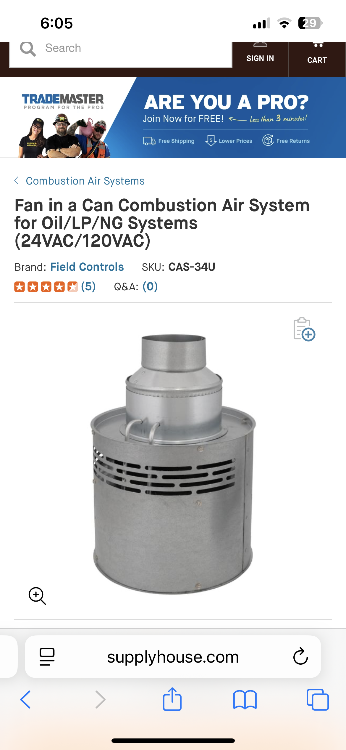

    Air in a Can , can be a option..

    A fan in a can is a good option. I believe it is a listed device that the inspectors would accept.

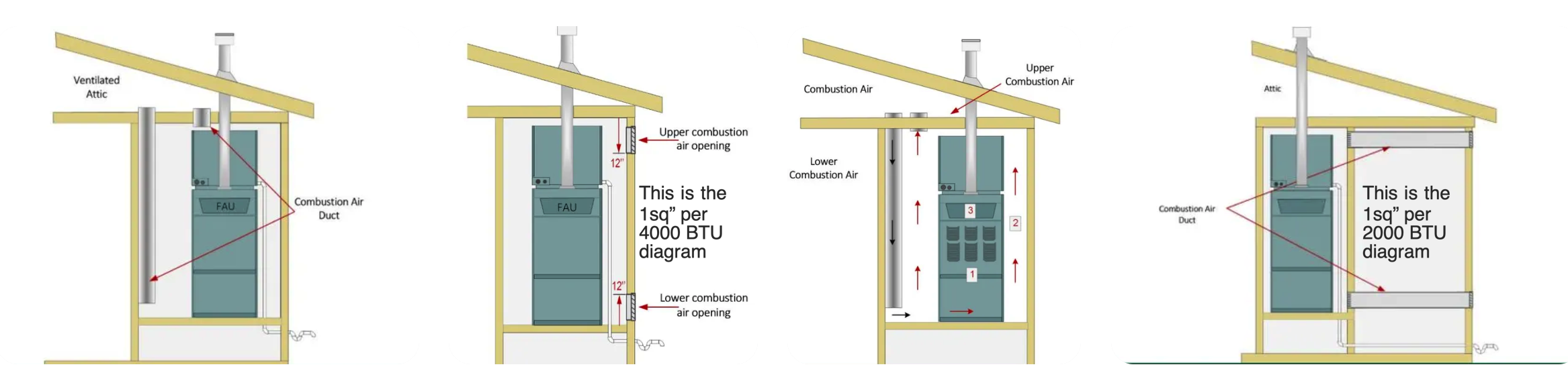

    The openings to the outside for combustion air do not need to have dampers. The openings can be permanent fixed openings with the minimum free area of 1 Sq" per 4000 BTU of input. so a grill that is 4x10 with 80% free area (not blocked by the louvers) will be more than enough. you need to put one at the top of the room and one at the bottom of the room that connect directly to the outside as illustrated in the diagram.
    Here are 4 different diagrams that show different sources of combustion air. two are from outside and two are from the attic. the Attic method requires that you drop one of the openings with a duct to within 12" from the floor. since that is a ducted combustion air inlet from the attic, the 1sq" per 2000 BTU number is recommended. The attic must also have sufficient ventilation to provide the combustion air. Some attics have exhaust fans that control the attic temperature in the summer. Since that burner will be making DHW in the summer, you can not use the attic if you have an exhaust fan moving air thru the attic.
    If you are afraid of that cold air causing the pipes in the boiler room to freeze, and you want to put motorized dampers on the openings to reduce the probability of freeze-up, then those dampers need to have a switch that will prevent the burners from operating if the campers fail to open. If you choose not to use dampers, that is ok too.

    One more observation: That looks like a Buderus G124X boiler. That is not designed to be a fan assisted exhaust system according the the manufacturer's instructions. I was wondering where you got that combustion assist fan? I don't believe that is a manufacturer approved venting option.
    And this is not the first time I have seen this setup. Is this something that is approved in Canada?
    At least this contraption is using a metal housing fan…. The last one I saw on this site the DIY individual used a plastic fan that is used for lower temperature condensing furnaces on a non condensing G124 Cast Iron boiler with a open draft hood below the fan assembly.

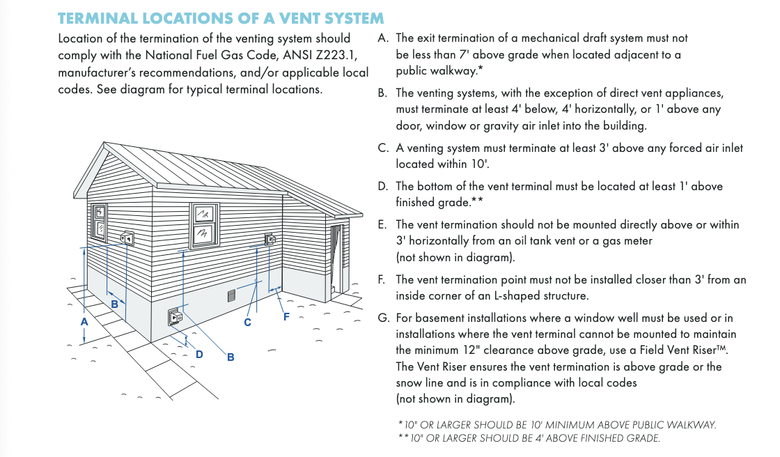

    And if @ajping3830 is going to use combustion air from outside the building, then the fresh air openings must conform to certain clearances form the exhaust vent so exhaust gasses are not easily sucked into the boiler room. That boiler room might need to be enlarged to allow for a 4 ft or longer distance from the exhaust to the fresh air inlet. Item B below calls for 4 feet from the vent to the gravity air inlet to the building. Item C calls for 10 ft (for a fan in a can) forced air inlet or be 3 ft above it.
    Designing a system as you go can sometimes make you cut new holes for the vent and air inlets.

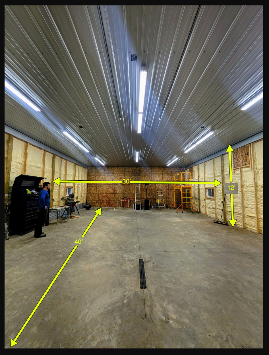

    Since it was mentioned, now I'm contemplating just utilizing the shop combustion air with openings in the walls of the utility room. I think it would be ideal to keep any extra heat from the boiler room inside the building instead of dumping it outside in the winter months. The living space is just a guest house so there isn't going to be a ton of DHW demand to worry about excess heat in the summer months. There could also be issues with the exhaust being to close to the intake if using outside air.
    I was already thinking about adding a heat recovery ventilator, just for the sake of having fresh air as I'll be doing some welding/cutting/grinding ect fab work here and there. But it seems like an HRV would also aid the boiler if using inside air correct?
    How can I figure if there is enough combustion air in the shop space? There will not be any additional rooms, just wide open.

    @ajping3830 asked: "How can I figure if there is enough combustion air in the shop space? There will not be any additional rooms, just wide open."
    A confined space is considered any space that does not have at least 50 cubic feed for every 1000 BTU of burner input. The Shop is much larger than that, so you have sufficient amount of combustion air if you use two 12 x 12 louver openings from the boiler room to the shop.
    The total shop + boiler room will have a total of 14,400 cubic feet volume to draw combustion air from. that means that you can have up to 288,000 BTU input and still not have a confined space. but as tight as you are making that space, I would not go much over 220,000 BTU. Since you boiler has a 100,000 input and it doesn't look like you will be adding a separate water heater any time soon, I think you will be fine.
    Now you don't need to worry about cold air from the outside louvers freezing any pipes. Some welding shops do however add exhaust fans to clear fumes from the work space. especially if you have the ability to bring automobiles or other combustion engine equipment inside to work on them. That can be a real problem. I was working on a problem boiler that was connected to a shop that was 5 times larger than your shop. The exhaust fan would wreak havoc on the flame and the venting system whenever they operated the exhaust fan with all the garage and shop doors closed. The exhaust fan would suck air the wrong direction from the boiler's exhaust vent pipe. That would blow out the electronic ignition pilot and cause a flame failure signal to stop the burners from operating.
