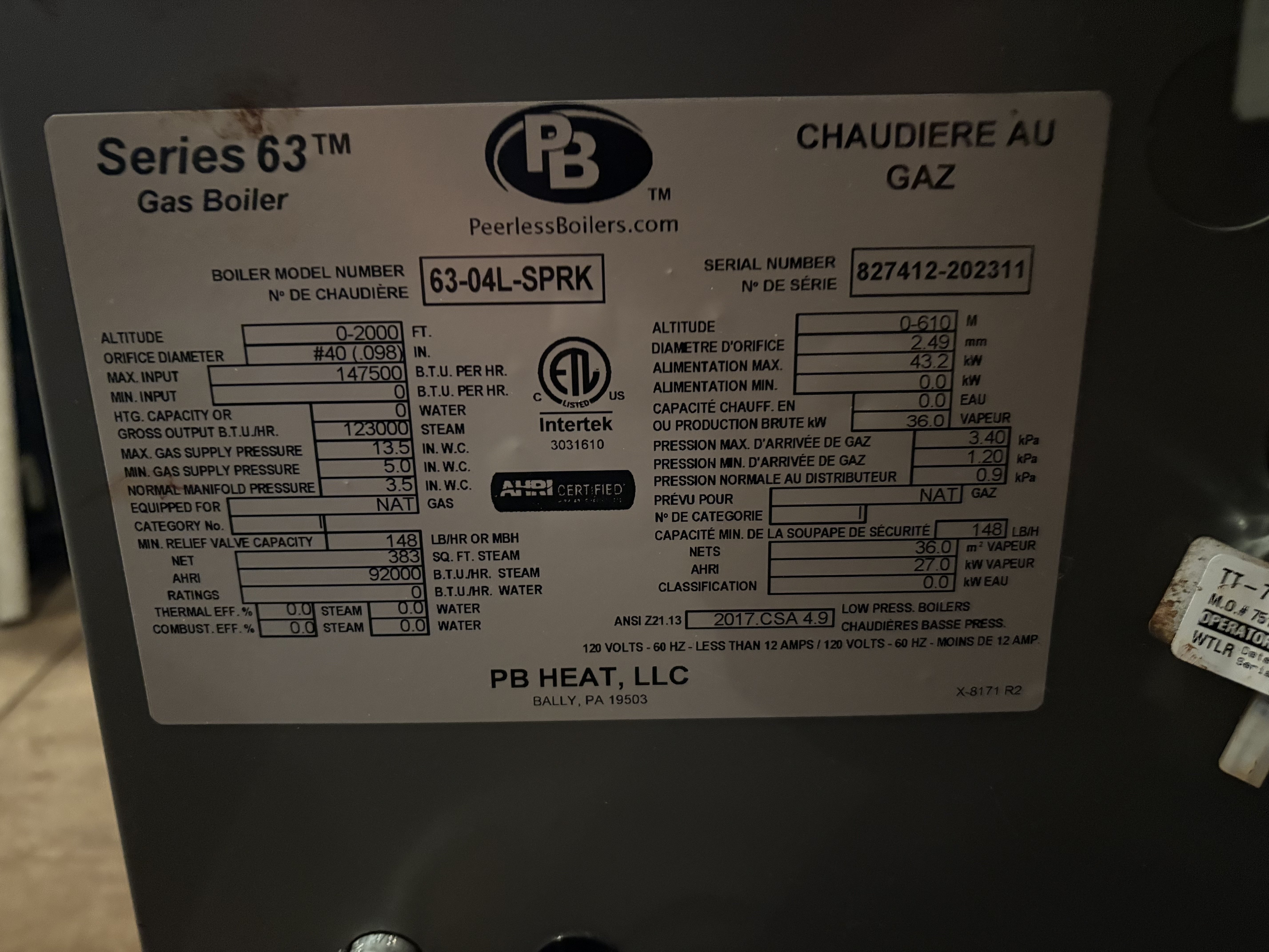

So a friend of mine had a someone start a job take their money and run. So I went did a load calculation on house measured all the radiators and used dan holohans load calculation formula. I did the numbers twice to double check and came up with 92,160btus and total sq ft of steam of 256sq ft. But the boiler says 147,000 but max input gross output of 123,000btus. And rating plate says boiler makes 383sq ft of steam.
My question is do you think this boiler will shoot water out the air vents if I hook it up for him? The guy that took those money and ran bought the boiler by just matching rating plates never measured anything. I have picture of the rating plate.
    Well, it won't shoot water out of the vents if you set it up properly including the near boiler piping and setting the pressure correctly. That won't be your problem.
    What will be is that the poor thing will short cycle, and there's nothing to be done about that.

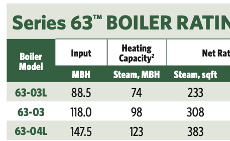

    Make your life simple and completely ignore BTUs in steam capacity calculations. They aren't necessary or helpful in a residential installation.
    Just compare the sq ft of steam from the rating plate directly against the total EDR of the radiators. And round down to the next smaller boiler if you are between two models.
    Your friend needs the very smallest boiler that Peerless makes, the 63-03L, see this chart:
    But I guess it seems like your friend already has the oversized boiler in their basement? You can hook it up and then you can plug a burner orifice if you want, that will reduce the short cycling.
    You can also turn the gas valve pressure down to about 3 inches of WC (nominal from factory is 3.5), that will make less heat which will also reduce short cycling.

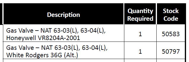

    Peerless boilers have two burner configurations for each boiler size. Unfortunately, the 63-04 is already downfired. From the parts list, it looks like the gas valve is the same for the smallest four boilers — 3 to 6 burner tubes — so I doubt it's a big deal to go from 5 burners to four:
