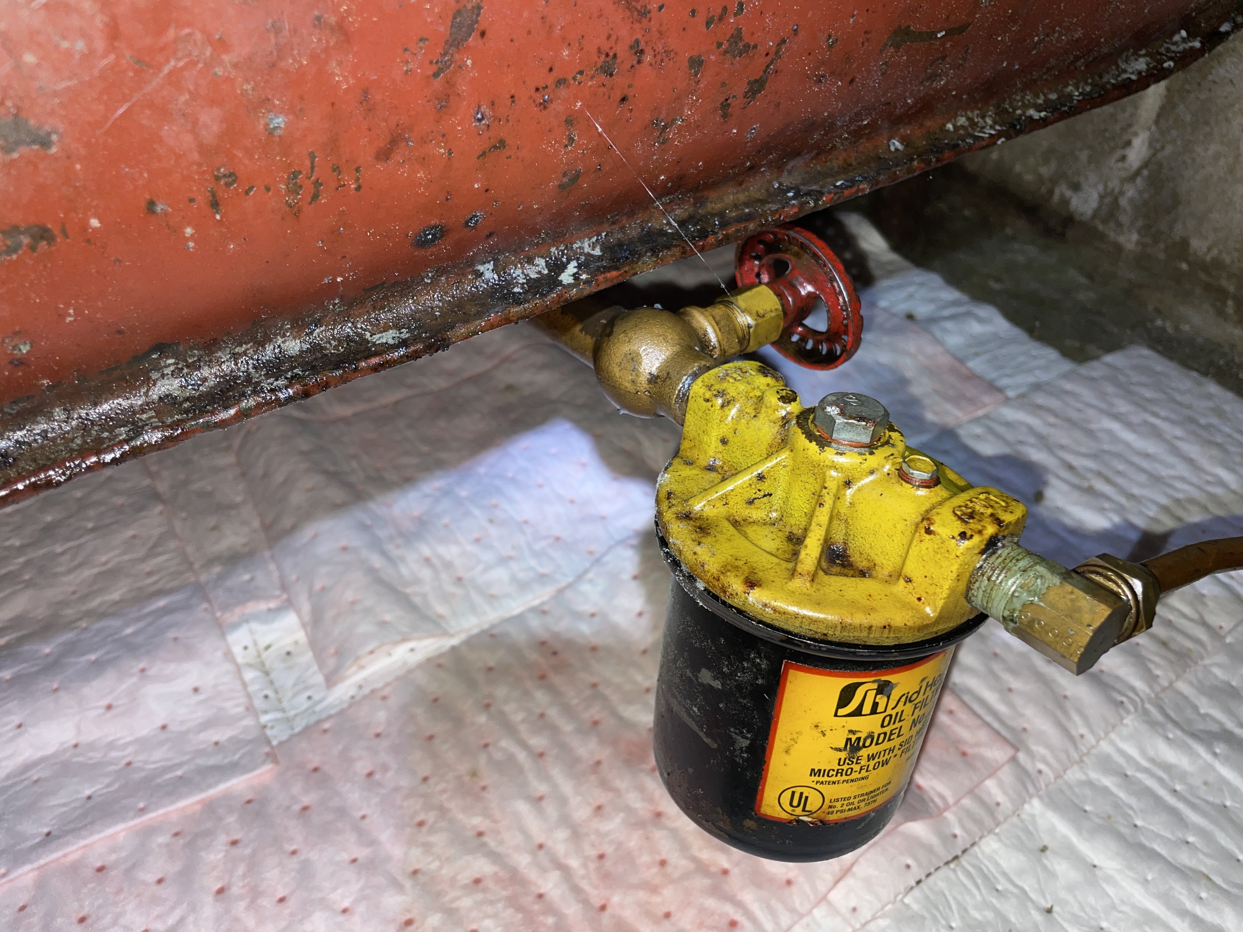

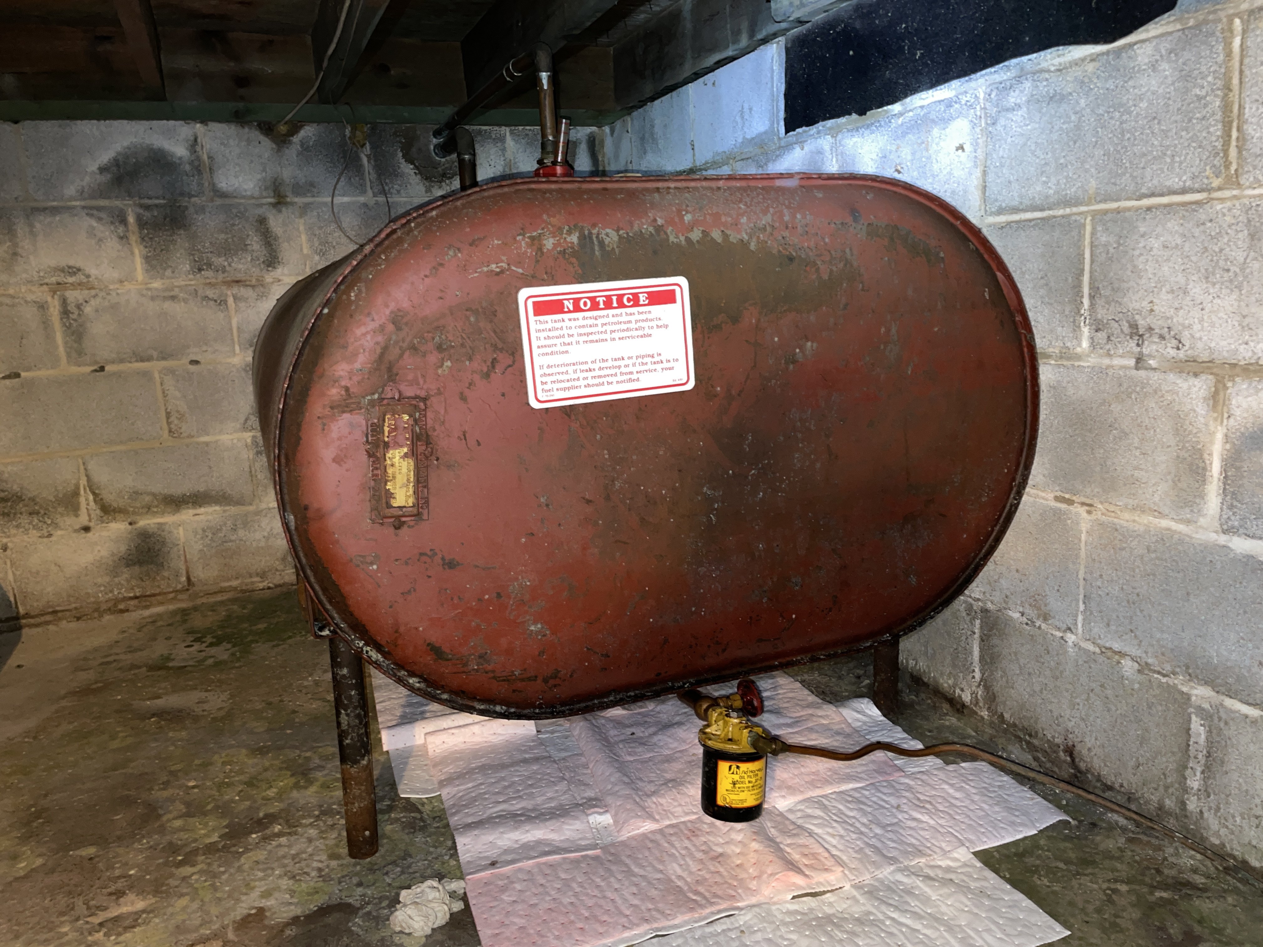

My oil tank is in my basement/crawl space. It started weeping, and I can smell it. I want to get it emptied into some plastic 55-gallon drums. It's an odd size, 225-gallon, and it's just under half full. I have two clean drums.
Can I easily, safely, use the burner's pump to drain the tank? Or, should I get a portable transfer pump? If I get a portable pump, should I hook it to the valve on the bottom-front of the tank (see photo), or should I drop a hose down in the fuel-gauge hole?

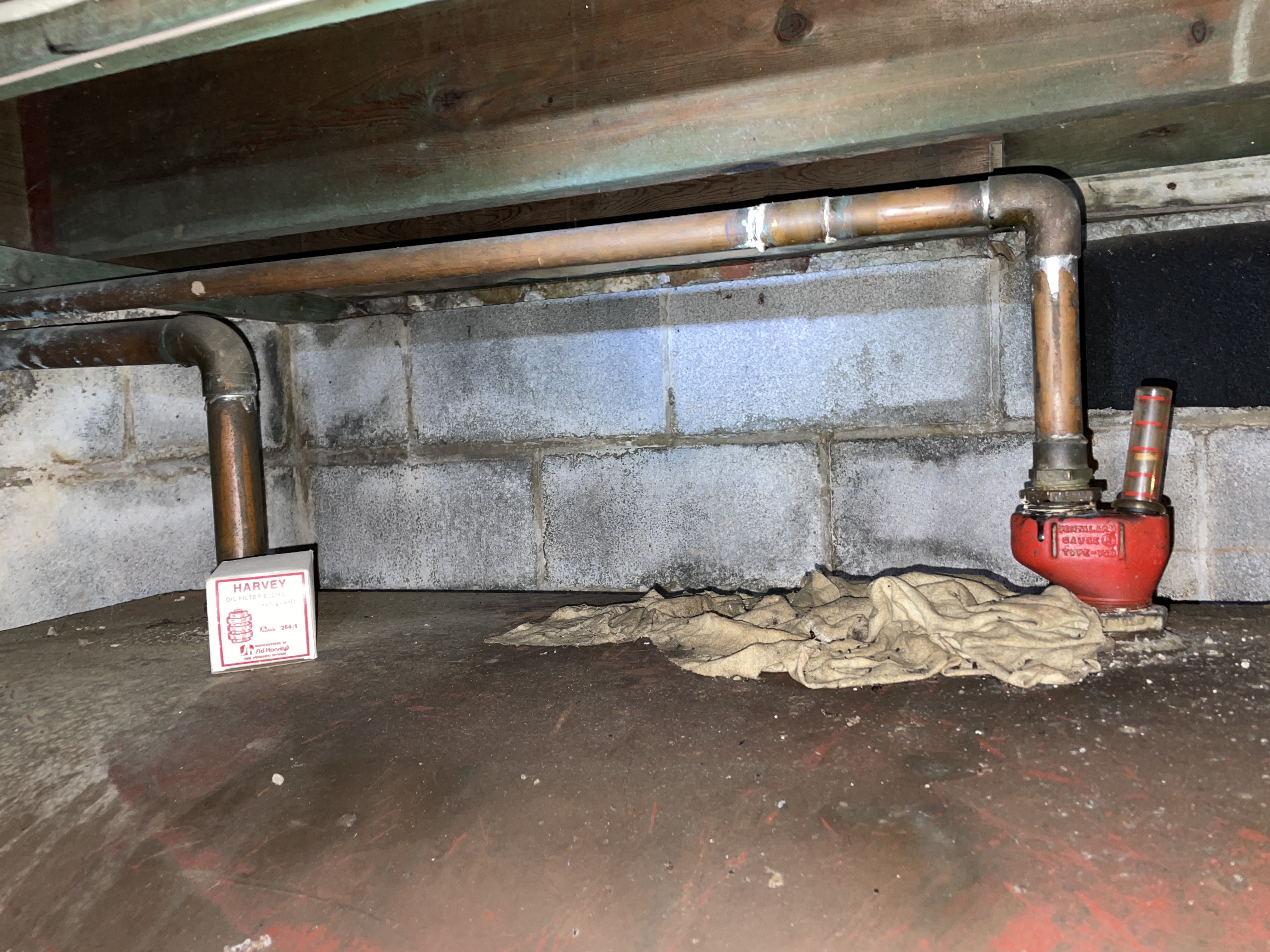

I'd be okay with draining it into drums in my basement/crawlspace; but, I think I'd prefer to put the drums outside. The copper pipe that goes through my foundation has the fill cap and vent just on the other side or the block wall, not even a foot above ground. Can I put a syphon hose through the filler tube or vent to drain the tank via a transfer pump?

    Unless your tank is an oddball its probably 275 gallons. If you find a barrel supply company, you can get 55-gallon plastic barrels with screw in plugs. That would be the best thing.

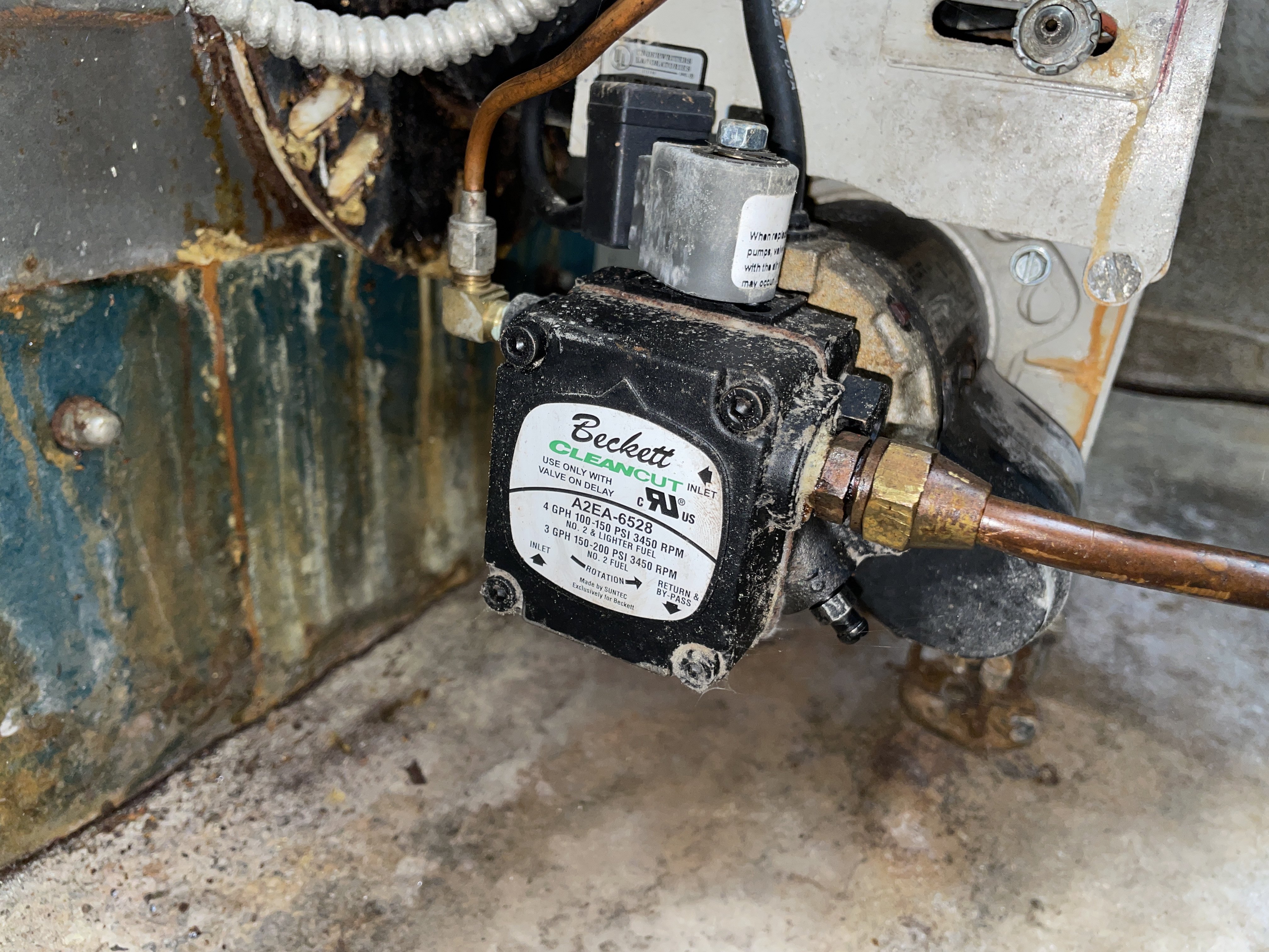

    You could use the burner pump but not practical it would take forever to pump that much oil.
    I would just get a cheap water pump. Harbor Freight has one for $17 that you drive with a drill and get some cheap garden hose.
    You may or may not be able to get a hose down the fill or vent pipe more than one elbow probably not. You should have a spare tapping on top of the tank you can take the plug out or remove the tank gauge and put the hose down there.
    When you have the tank empty and disconnected MAKE 100% SURE to cut out and completely remove the old fill and vent pipes so no one can put oil in the tank or flood the basement
    You can't imagine how many times that has happened and the clean-up cost is a number you don't ever want to see.
    All the oil codes require the fill and vent to be 100% removed when disconnecting a tank.

    I didn't realize the burner pump had the GPH right on it, and you're right, it would take a while.

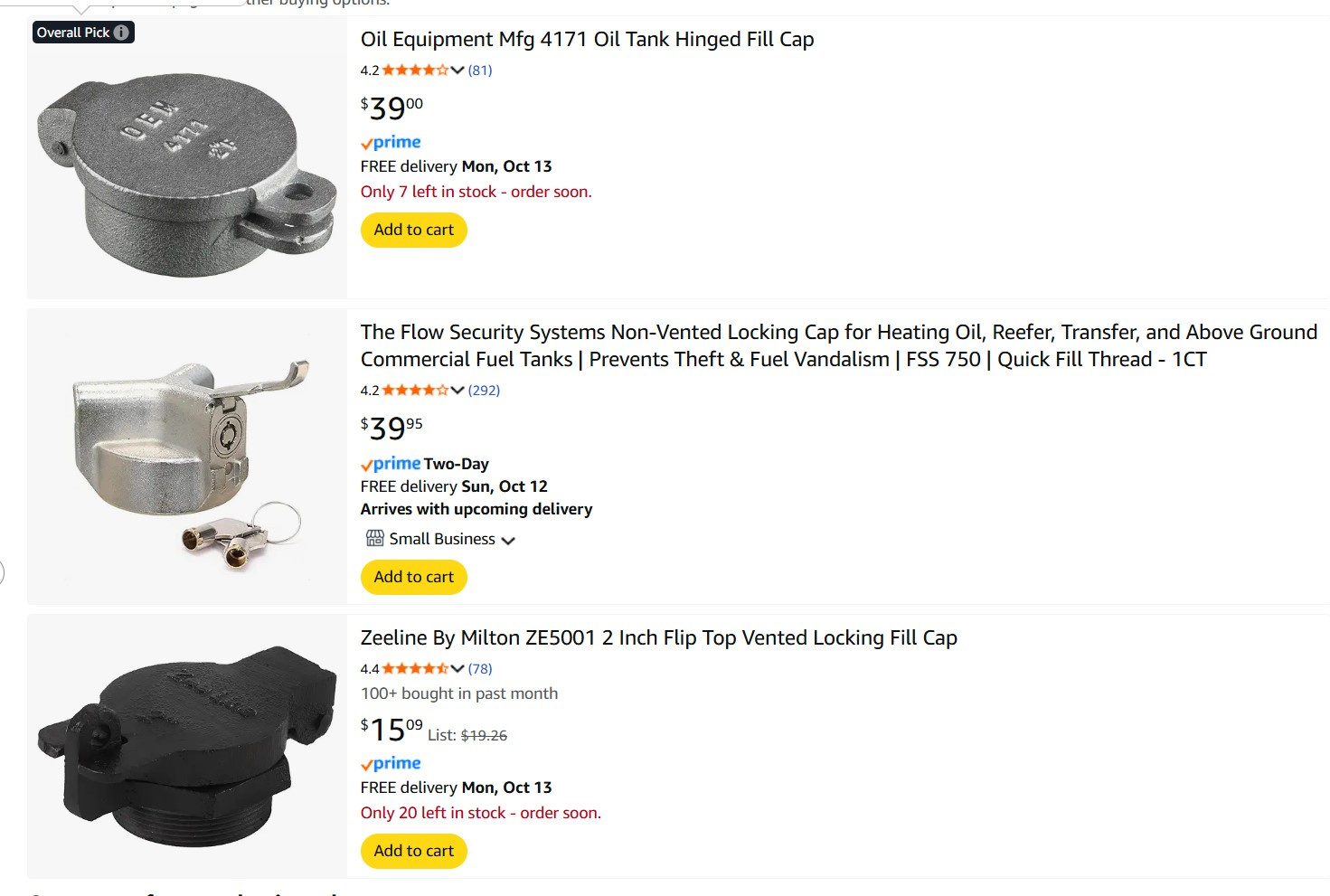

    Given that it is weeping, and I'm switching to electric, I was going to buy a locking cap for it ASAP.
    I read a couple horror stories of basements flooded with "oil" from wrong-address deliveries.
