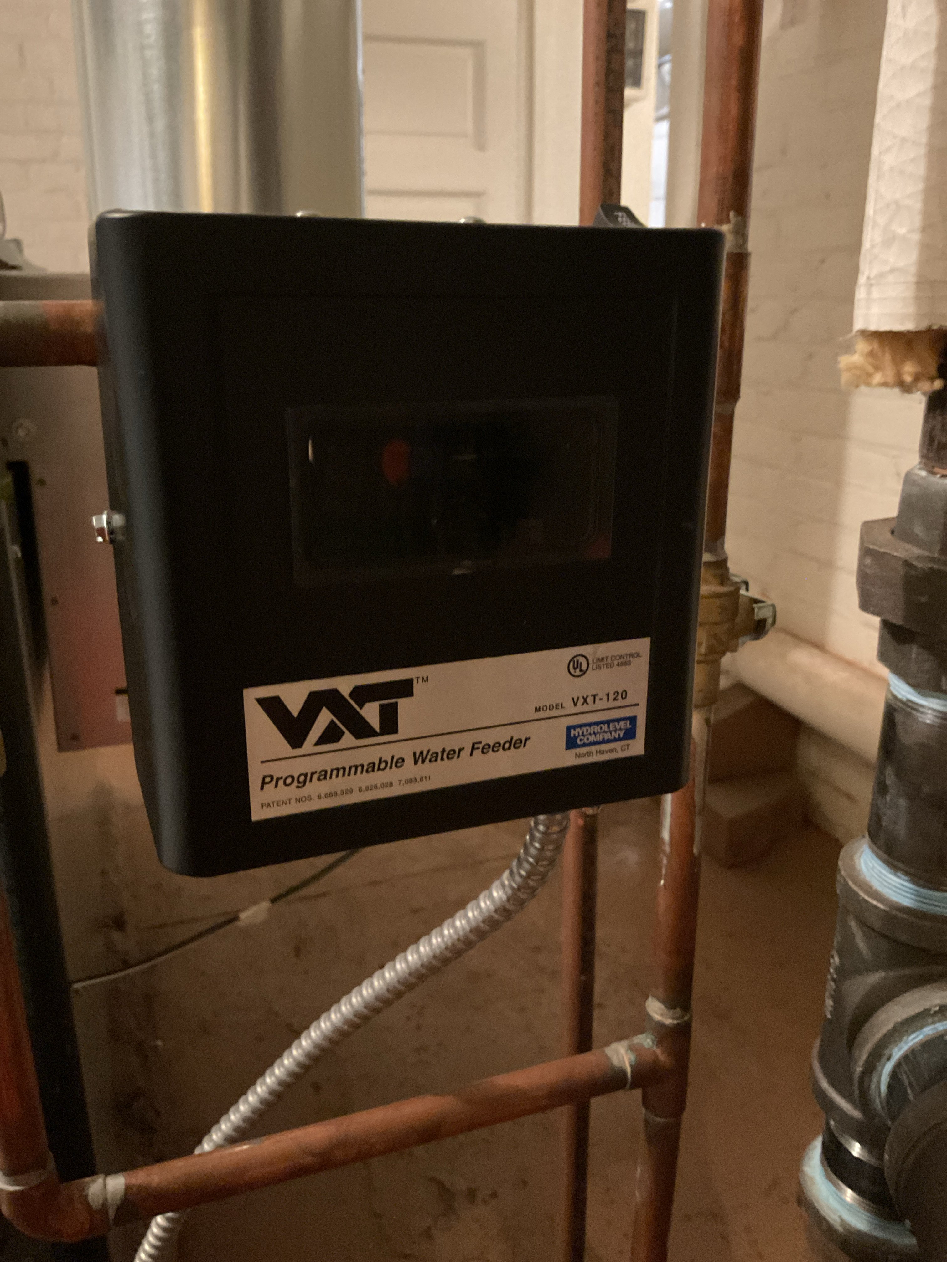

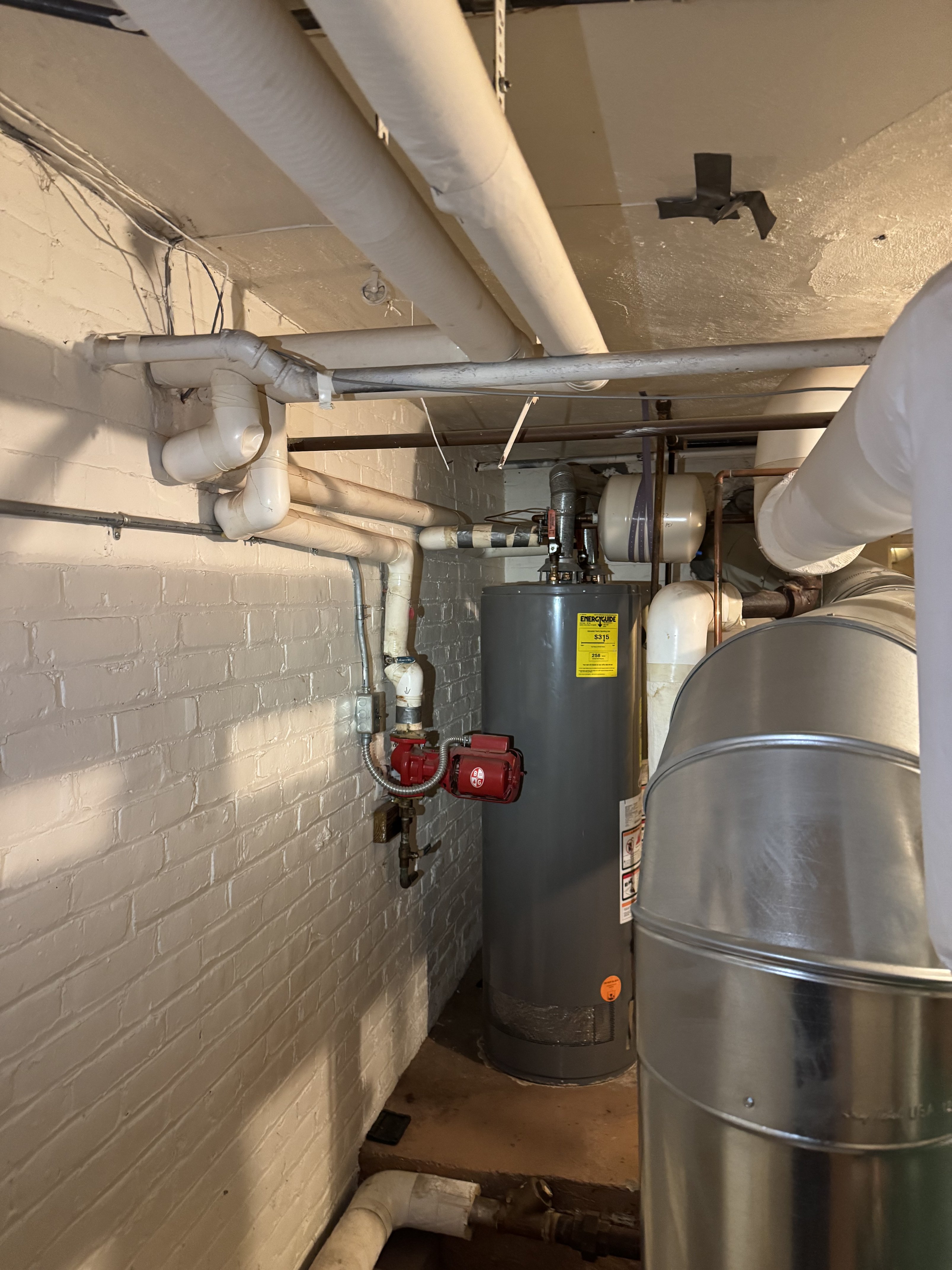

- This wall mounted pump attatched to the piping.

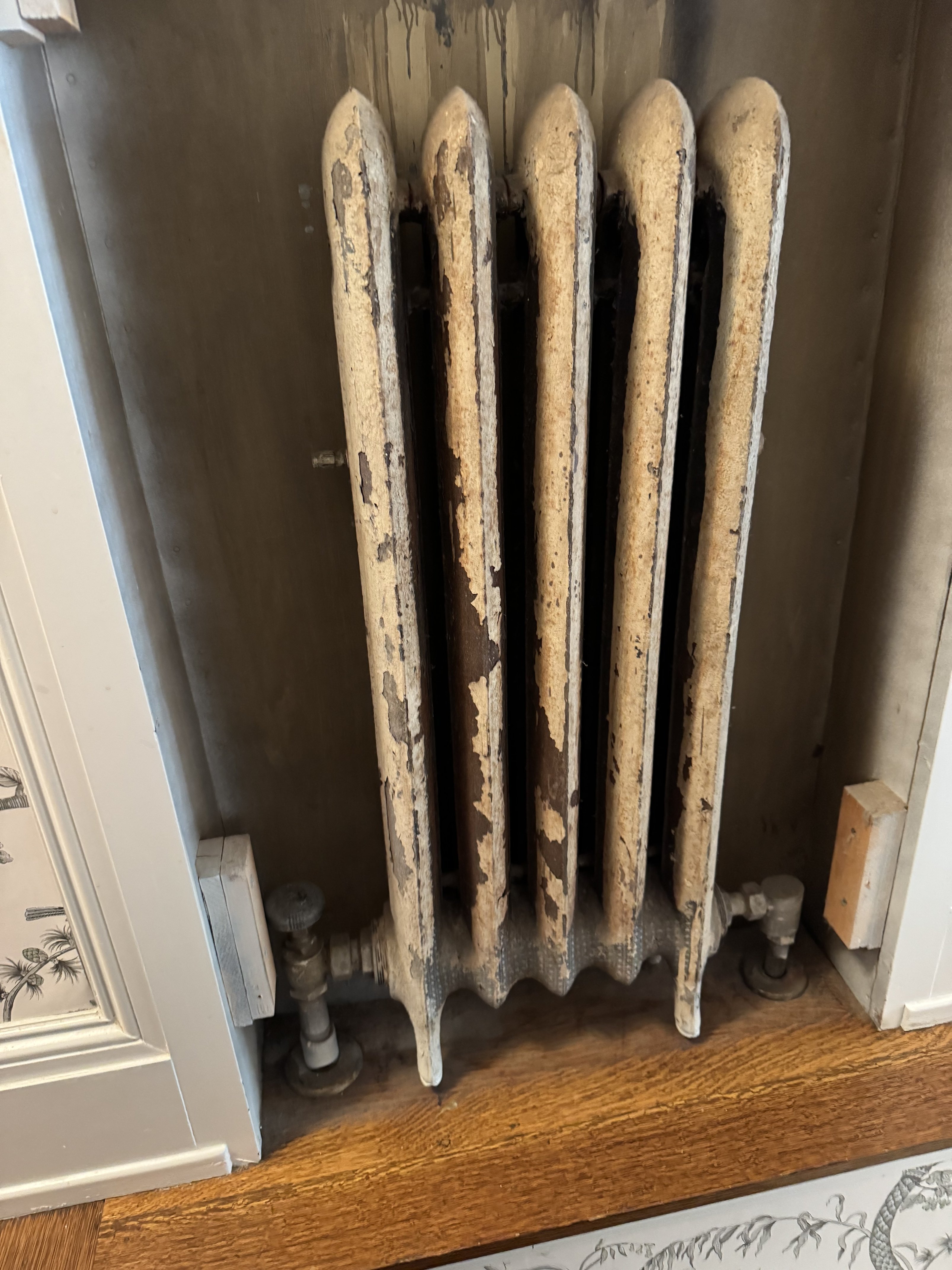

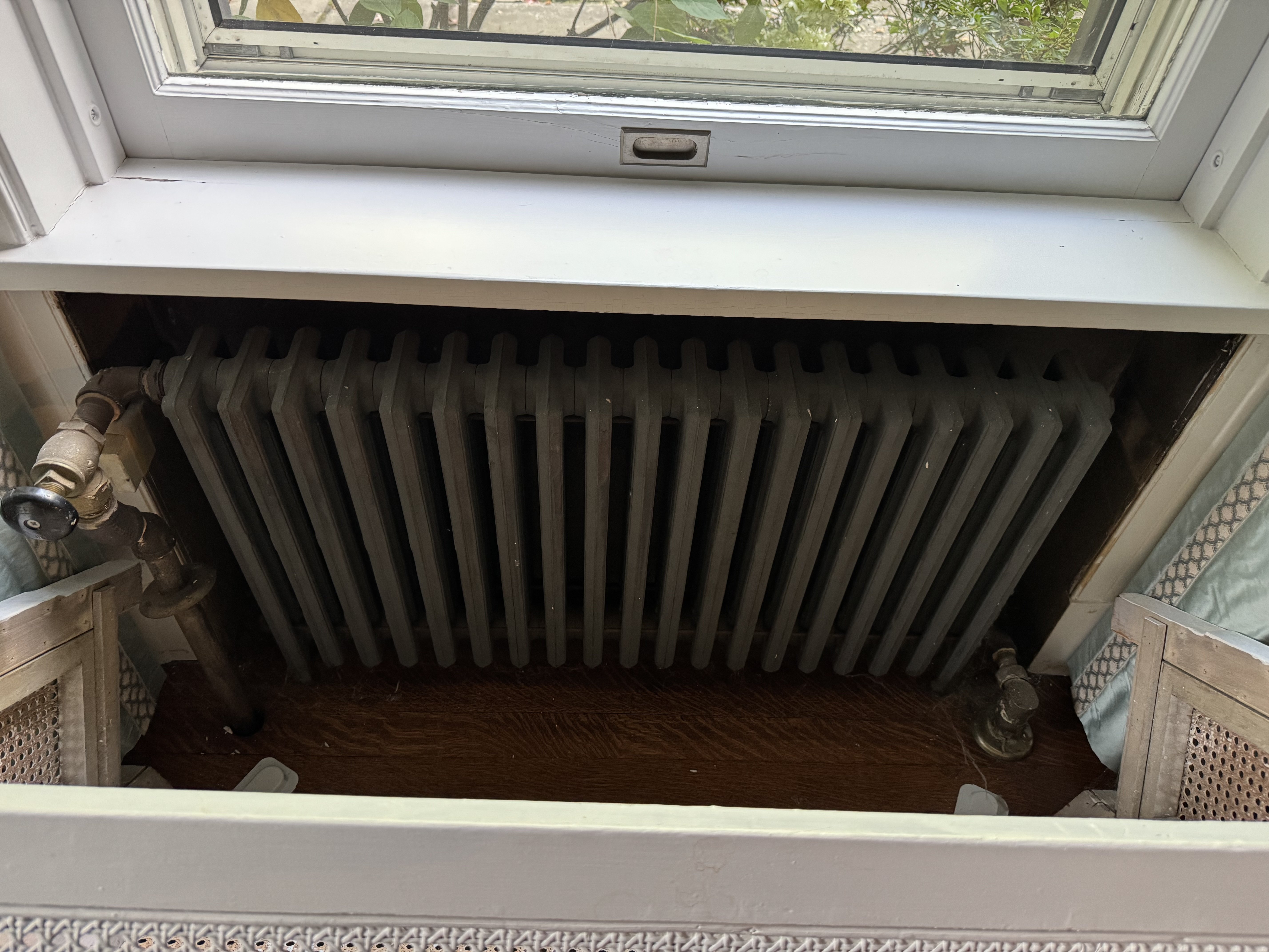

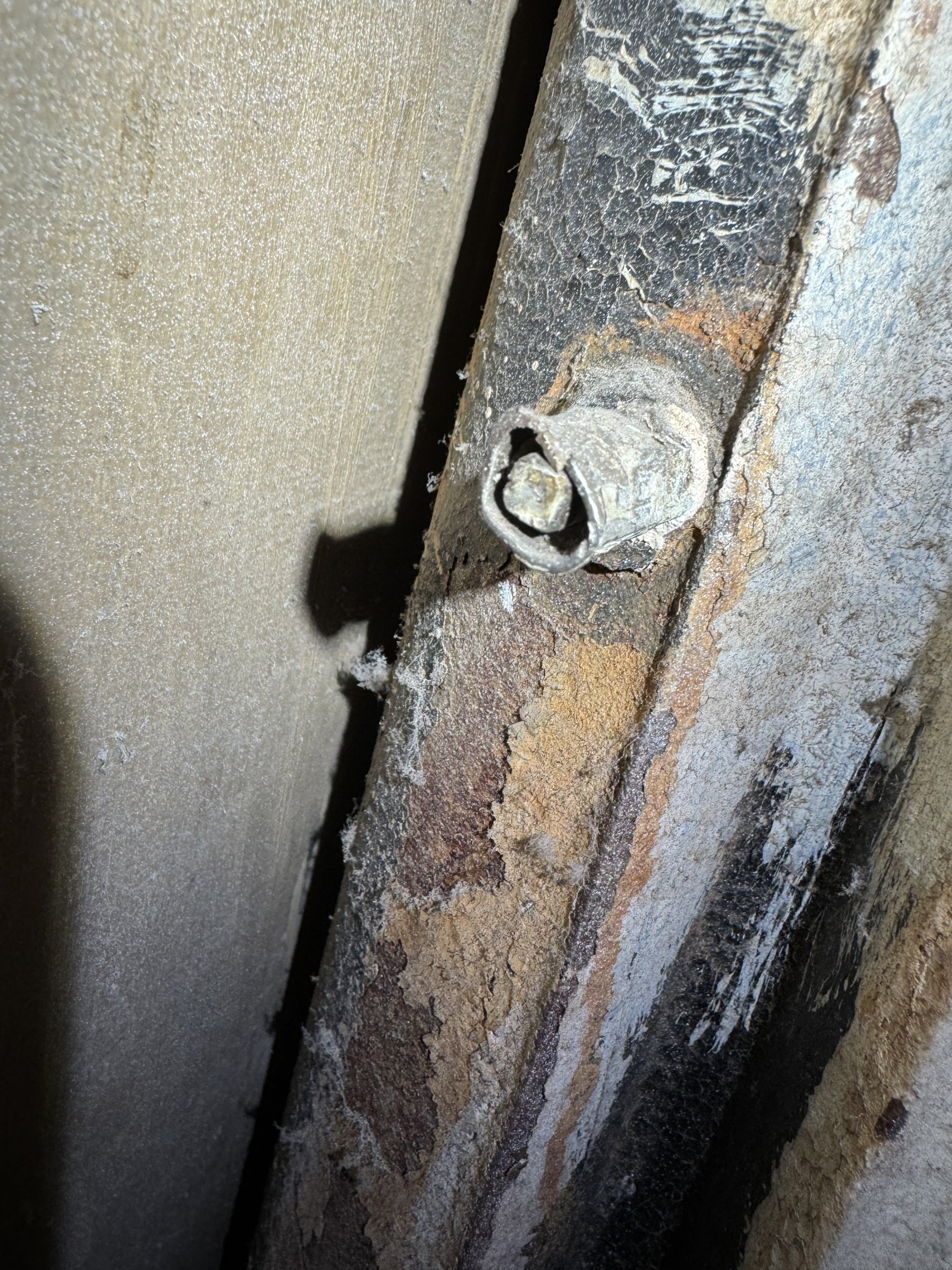

2. some of the radiators have the inlet at the top and others were at the bottom, with what appears to be a smushed air vent

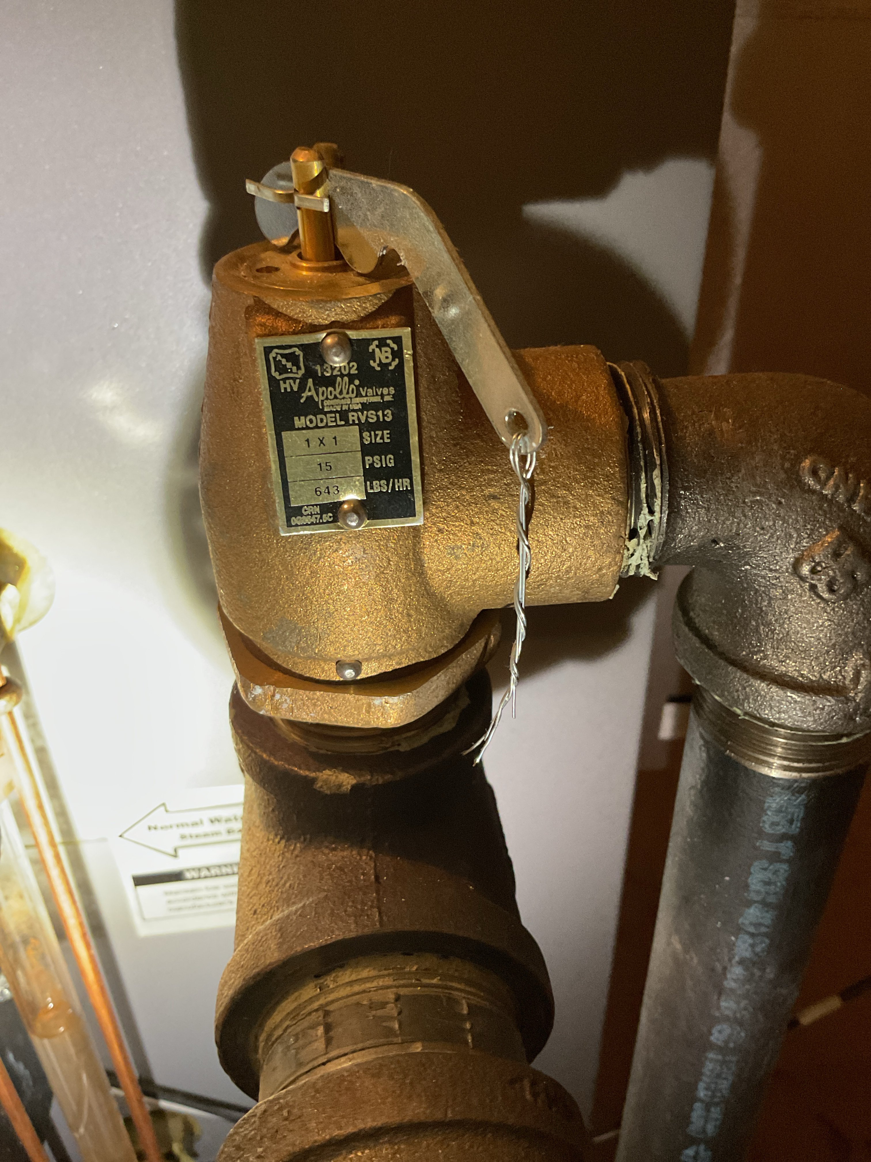

3. Cut out pressure was set to 15 psi. (lowered it to 2psi)

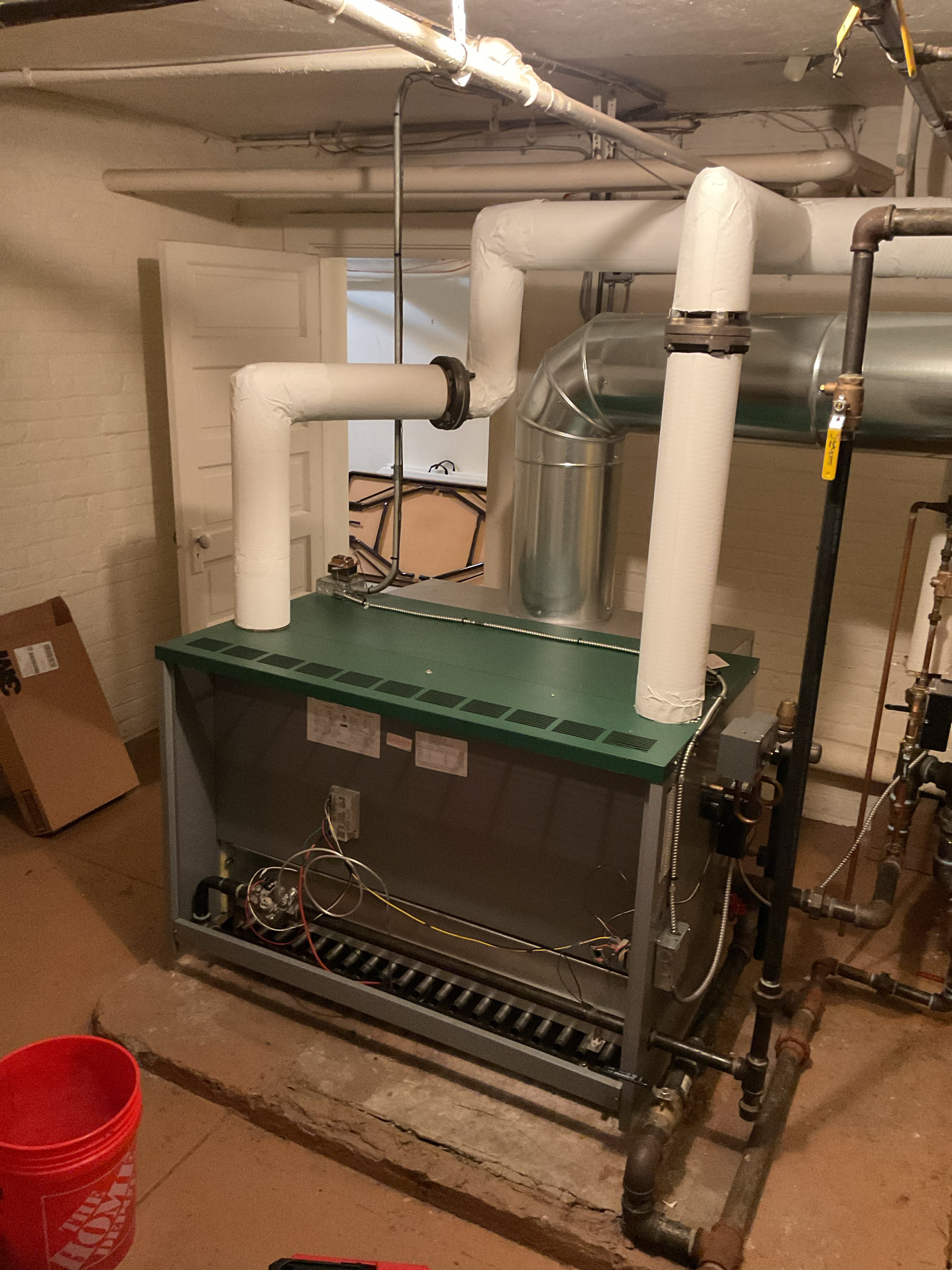

Will need more pictures, especially of the boiler and piping connected to it, but are you sure its Steam? Mad Dog
here’s the boiler. took a video showing the piping but not sure how to send that here.

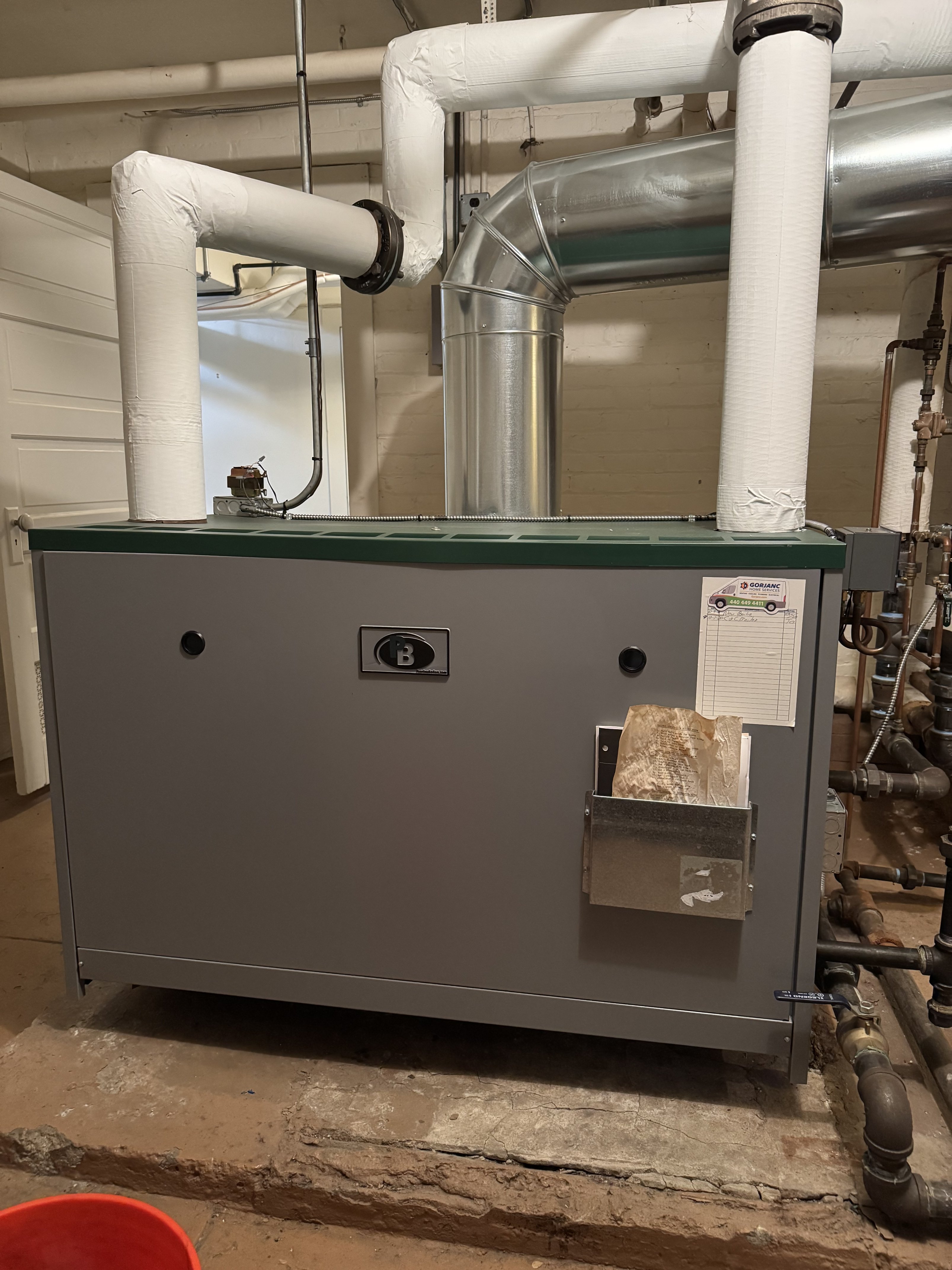

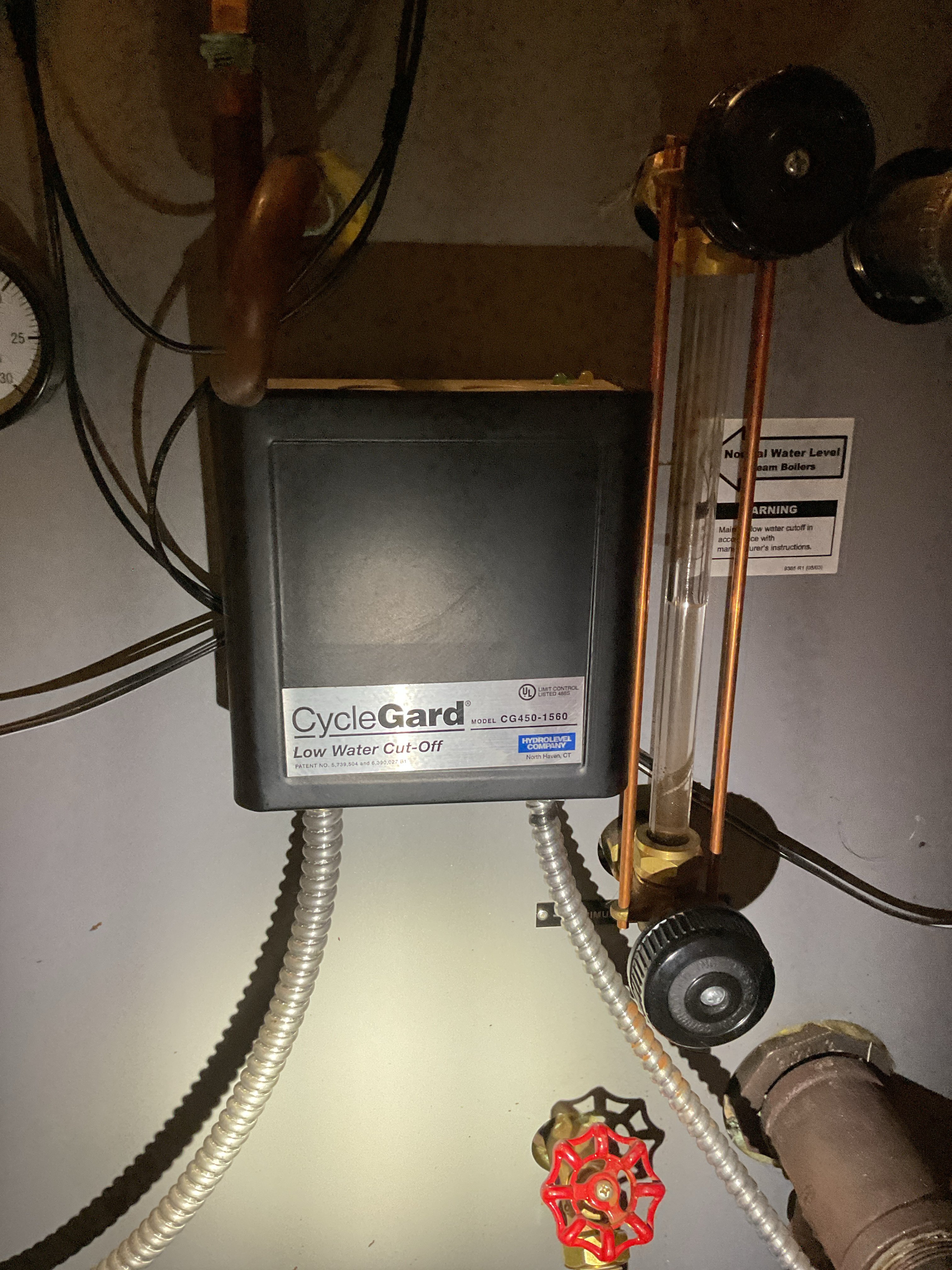

I want to see the front of the boiler…they left two pigtails and pressuretrolls on there if they did convert it
here are the rest of the photos i have. the 15psi relief valve and and sight glass made me believe it was steam but maybe there’s something that i don’t know. Radiators heated sufficiently when pressure was dropped to 2psi.
Look at those radiator return fittings- this is a Mouat Vapor system. @chrismus , where are you located? We know a Mouat expert in the Cleveland area- @gerry gill .
And whoever added those manual air bleeders is a knucklehead.

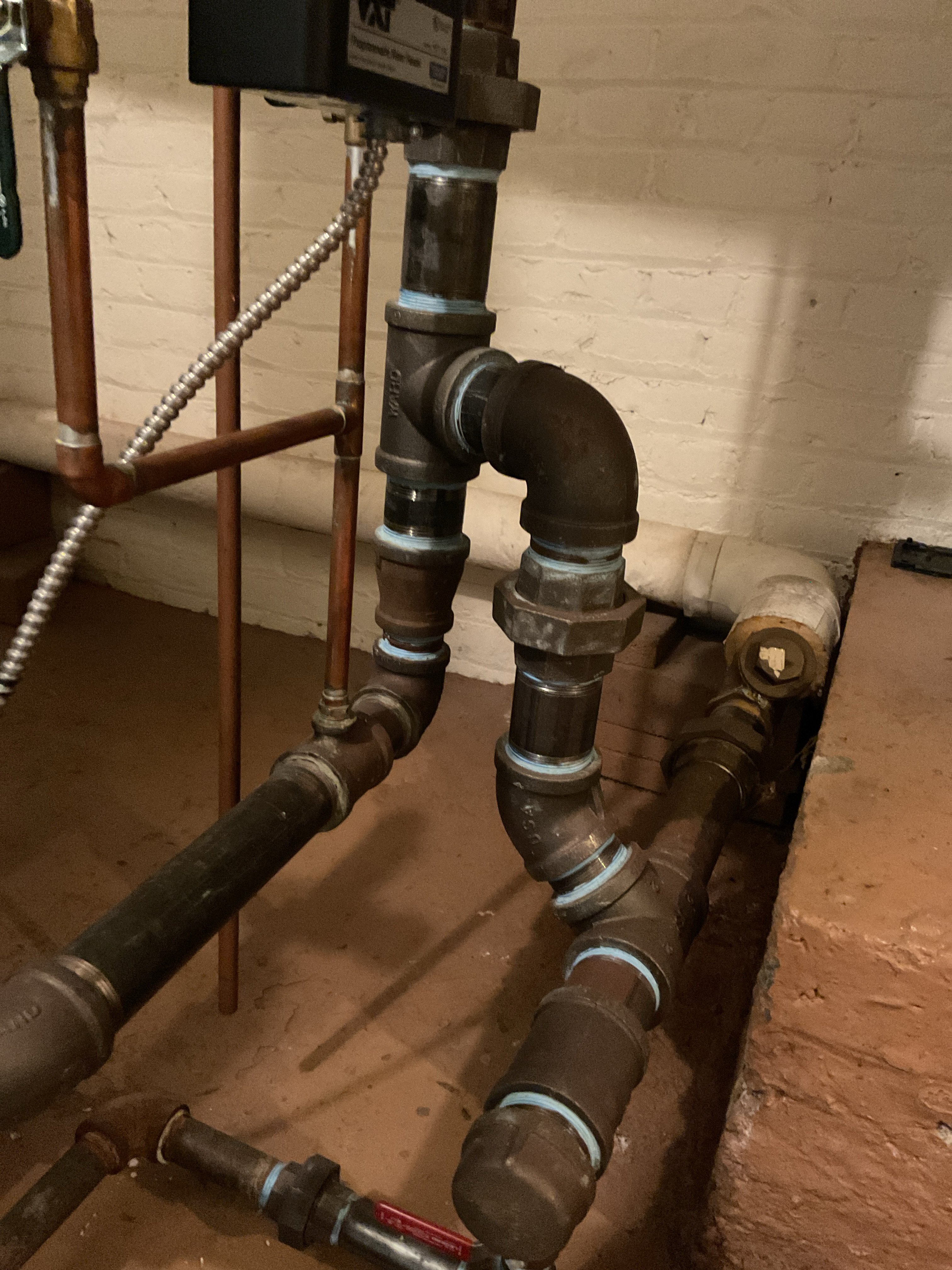

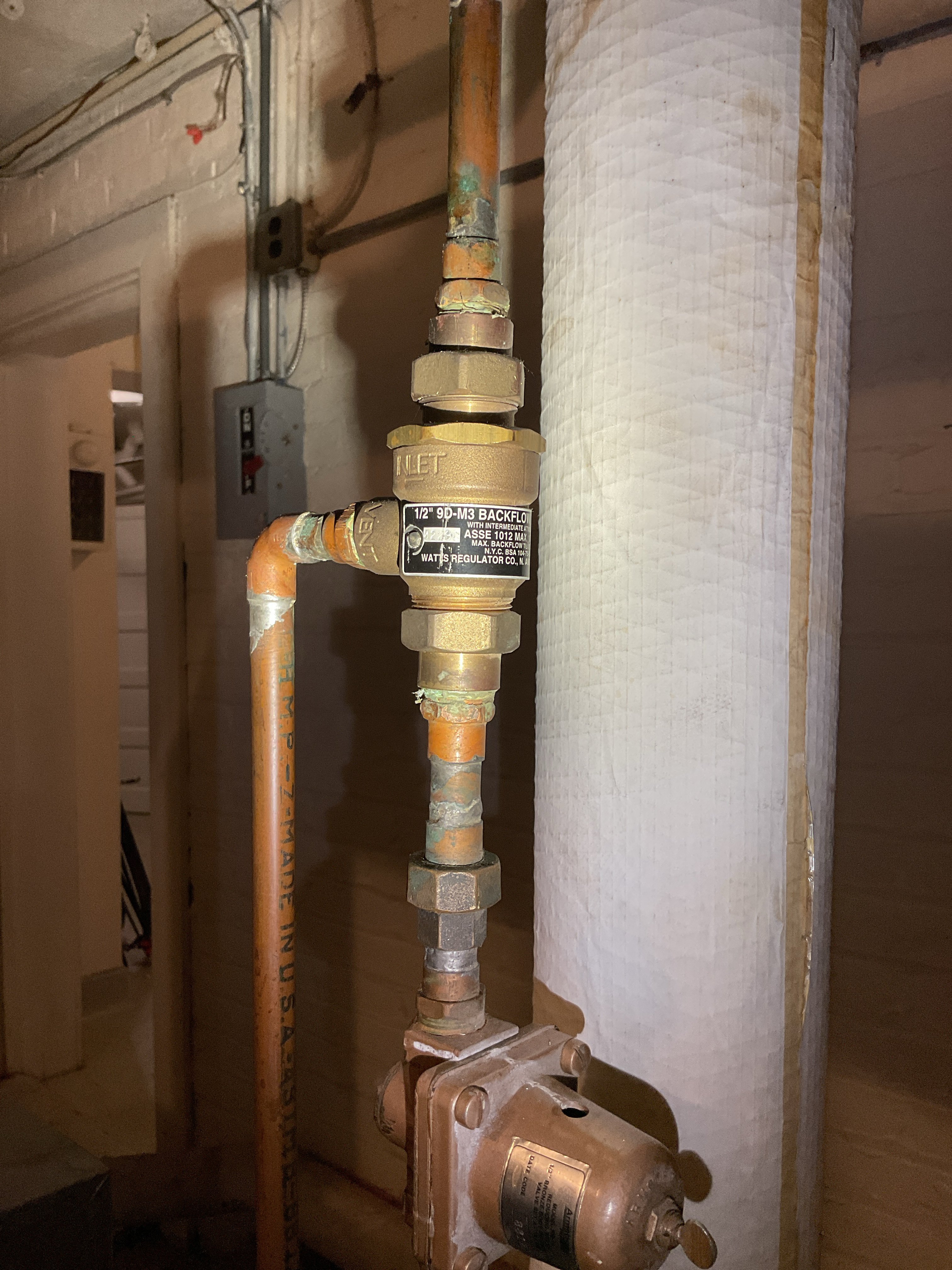

That is what I was originally thinking, but it looks like it is going up to one on the two paralleled pipes so I was thinking it was on the Steam condensate return side. Maybe there was a pipe pitch issue at one time. Looks like both valves are closed and the bottom pipe go nowhere.
One Pipe System0 -
